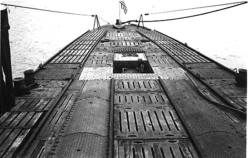

    Here are a couple of post inspection photos that show deck wear and patterns. I like these because there is a lot you can read into these, from traffic patterns to possible stains.

    Jeff, I read what you did about the darker paint. Looking at this shot you can see just how much darker it seems to be. I also read that the paint quality became a problem and did not withstand the weather. I am still pondering the light gray showing through. The photos do show a light gray, but also something brighter (whiter?) look at the guy scooting along the edge..
    Paul, there is so much to guess in a black and white photo, what seems like a shade of gray can be a patch of rust or what looks white good be yellow for all we know. I am enjoying this conversation, sure gets the head scratching, but it is fun.
    Here is a good shot showing how much darker the Turm was (granted this is wet while other photos the sail is dry and not as noticeable).
        Agreed that we cannot be 100% certain at this point. I also agree that the quality of paint used at this point in time did vary quite a bit....so those lighter patches could easily be different shades of the light gray.

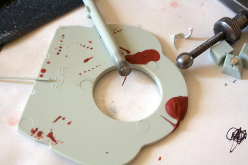

          Played with Nitro-Stan and making rivets, my success was spotty at best (I crack myself up).

          Merriman - Caswell fittings kit for the type IX includes deck morning fixtures that use magnets. I believe they began using magnets to hold down the deck on the Type VII when it was released and continue it for this sub.
          At first, I was getting frustrated with the pieces falling out of place or gluing my fingers together. Then I made a little holder.

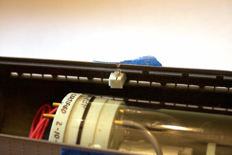

            #65

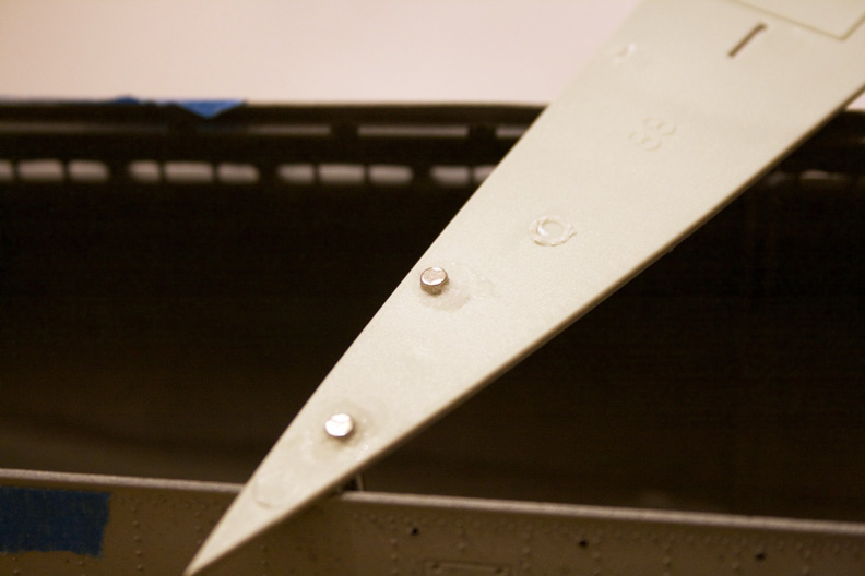

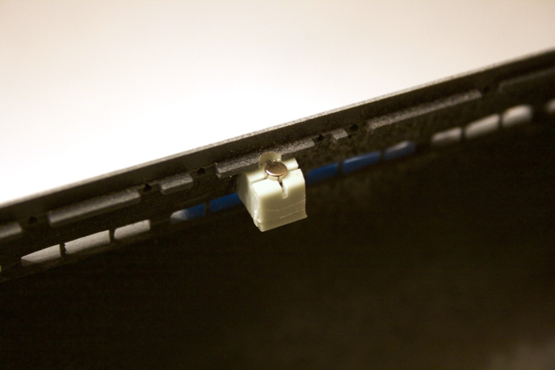

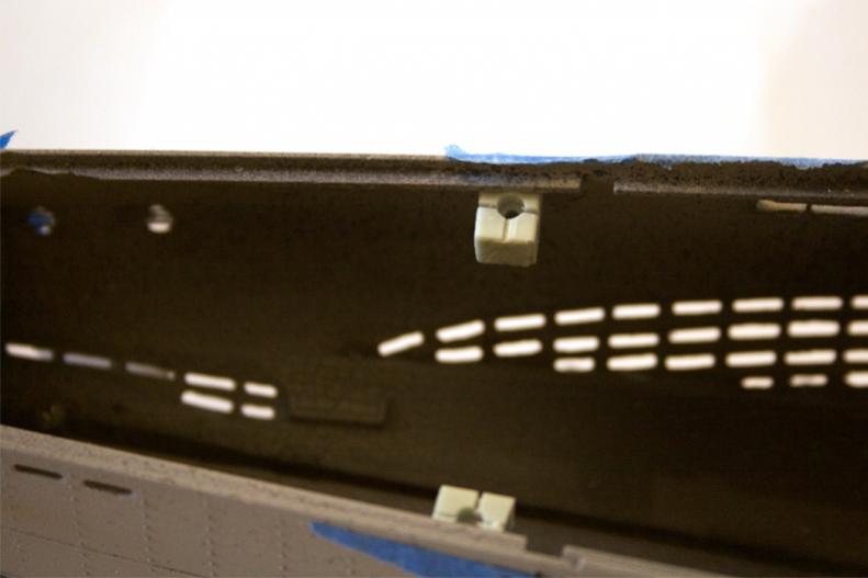

            Placed magnets (2) into each hole. Not pressing them in all the way just a little proud of the lip that the deck rests on in the hull.
Name:	Revell Type IX_105.jpg

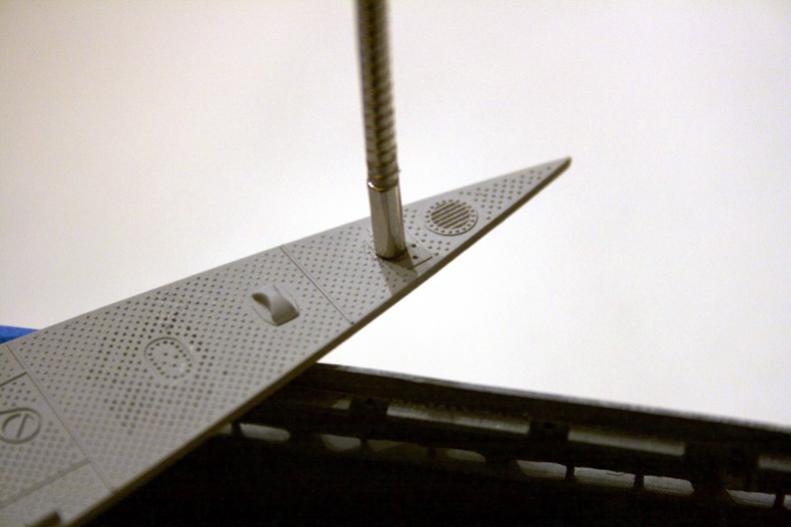

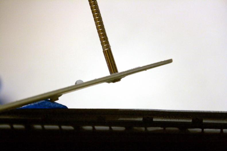

            Then press the deck down onto the hull, seating the magnets into their foundations. I took a longer magnet that I had and used it to mark on top of the deck where the magnet below it was with a pencil.
Name:	Revell Type IX_106.jpg
            Using that pencil guide, took the top magnet from the foundation and held it in place with the longer magnet from above the deck.
Name:	Revell Type IX_107.jpg
            A drop of CA and a pinch of baking soda and the magnet was set underneath.
Name:	Revell Type IX_108.jpg
            Test to make sure no mistakes were made and to see fit. So far, it looks good.
Name:	Revell Type IX_109.jpg
              #66

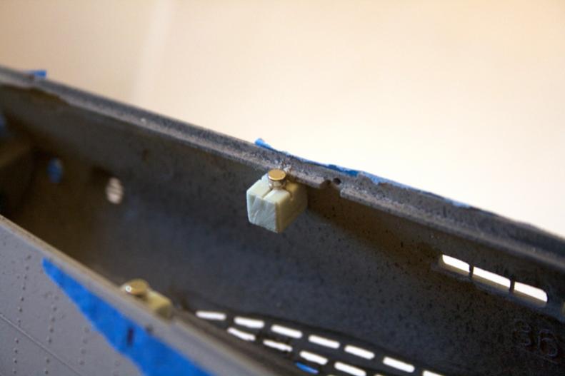

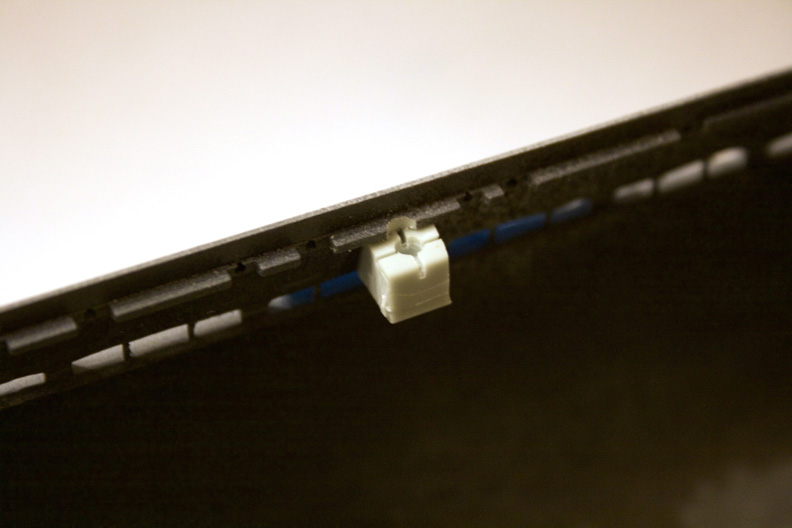

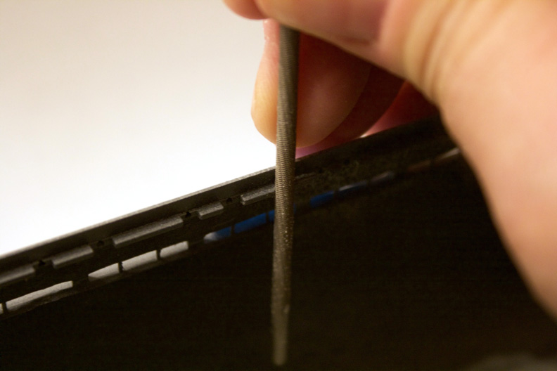

              Just a little more about the decks being attached.
              There are some magnet foundations that needed the lip filed out so the magnet will fit in.
Name:	Revell Type IX_110.jpg
ID:	128124 Click image for larger version
Name:	Revell Type IX_111.jpg

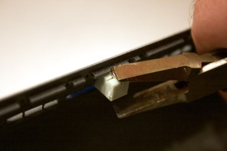

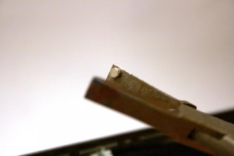

              I found that placing the foundation's magnet on a flat plier (not sure the name of this plier), then use it to press the magnet into the foundation. This made it a whole lot easier.
Name:	Revell Type IX_112.jpg
ID:	128126 Click image for larger version
Name:	Revell Type IX_113.jpg

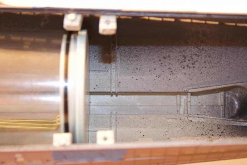

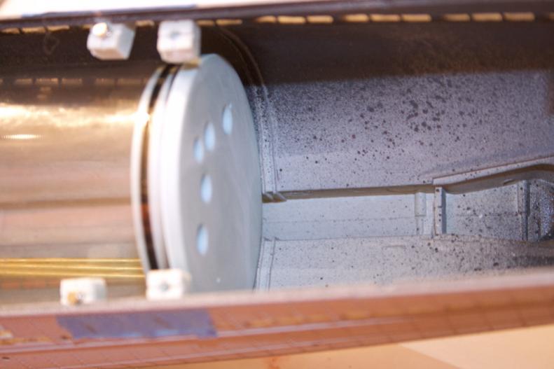

                The test fitting of the tube told me I needed to remove and relocate a couple of magnets. I will show that later.
                Another thing I learned in the test fit is I will need to remove these ridges that are for the models bulkhead. It prevents the tube from sliding forward.
Name:	Revell Type IX_116.jpg
ID:	128130Click image for larger version
Name:	Revell Type IX_117.jpg
                Now confession time, there are more foundations supplied than magnets. I got carried away before I realized my mistake. I asked David where I might get some more magnets and he said he would send me enough to cover my mistake. Thank you David!

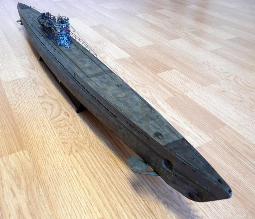

                  Hello gents,
                  Sorry to come to the debate a bit late.

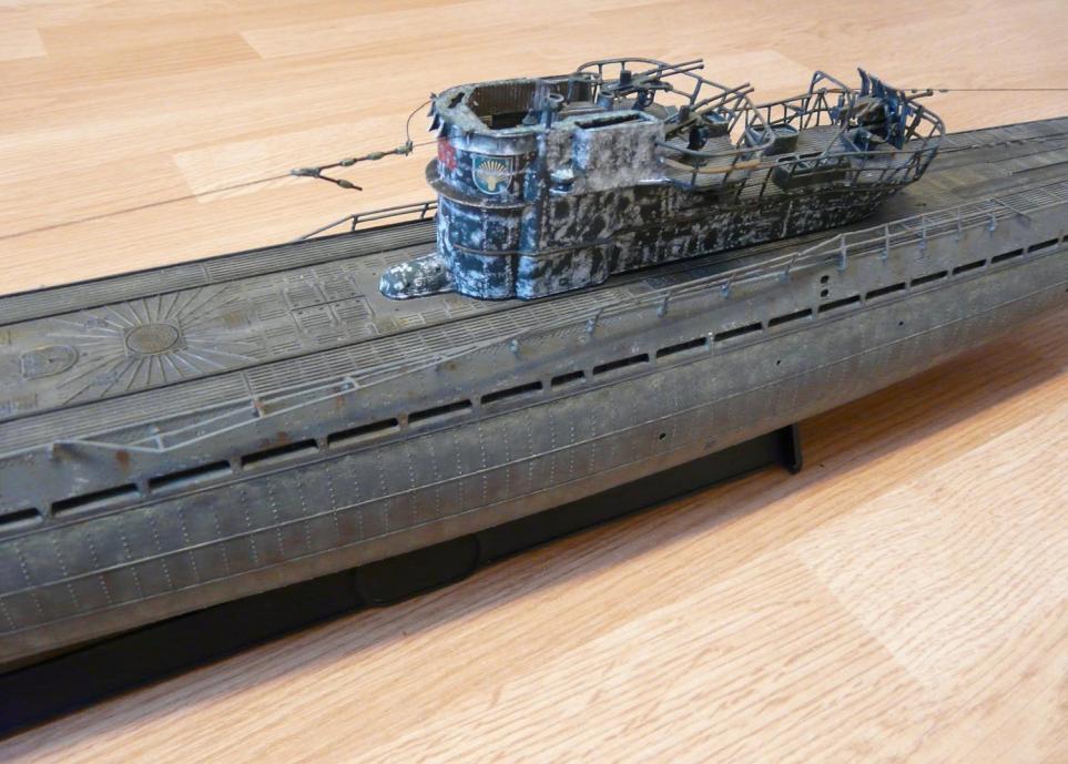

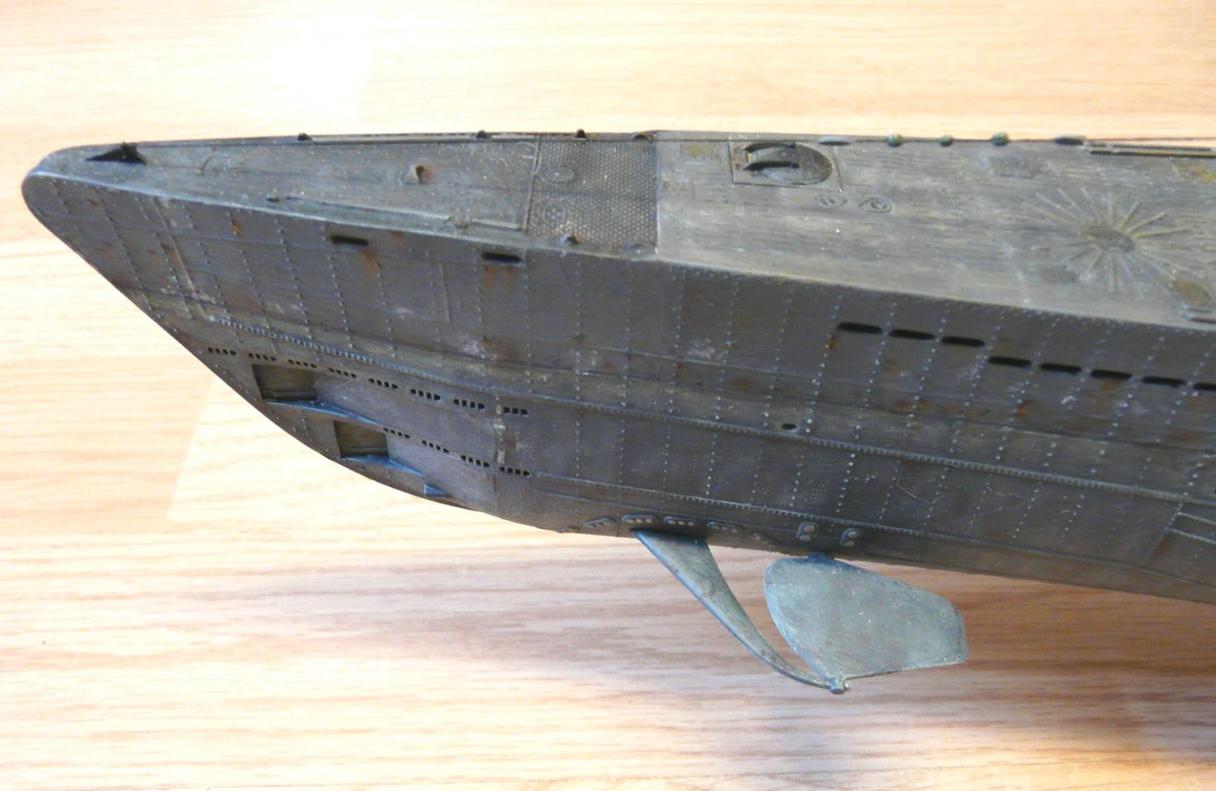

                  Thanks for posting the link to my U 505 modifications and colours article (http://amp.rokket.biz/lib_uboats.shtml). On page 44 you can see a colour photo of U 858 with shows the colour where the paint has peeled off the tower. The Kriegsmarine had a problem with paint adhesion on the towers - particularly the lower half of the towers - on the late war IXs (though the VIICs didn't seem to have the same problem). When U 530 got to Argentina the photos show hardly any paint left on the tower. It is very surprising just how bad the problem was.
                  I've discussed the subject of what the colour was after the paint has peeled with a few folks. The question is whether it was merely a light grey underneath or whether all the paint had peeled? A few of us think that all the paint had peeled off, leaving bare metal that was stained by salt, thus making it a white-silver colour. Does this sound reasonable?
                  On my model of U 505 I had a go at replicating the finish and used a whitish-silver colour.
                  The images show my attempt at weathering. Sorry that the quality isn't that good. I'm not sure you can see it that well but I added plantlife on the lower hull plus quite a few bits of salt staining on the upper hull. I also added battle damage too, hence why the deck railings are bent.
                  The other subject discussed in this thread was how the metal hatches on the deck appeared white in some photos. Now and again you will see the metal hatches on the deck shining brightly and looking white. I think this might just be the light shining off the metal in a different way to the rest of the wooden deck? Other factors may be salt staining.
                  If you look again at the U 858 photo on page 44 you will see a small square hatch on the deck near the edge of the deck. You will also see a large area that looks white on the deck ahead of the tower. This was a metal section that was added to the deck when the late war Askania fairing replaced the older magnetic compass fairing at the front of the tower. The metal here is shining white (or whitish-silver). It could be that this paint had not adhered well (just like on the tower) and that salt staining had an effect too.
                  Hope this helps.

                    #69
                    Dougie,
                    First your sub is beautiful. You went for the just captured look and I like the extra details you put in. Second, your opinions are always welcomed! Third, I will part from your thought on reflection on the hatches, and I thought that light reflecting was the cause too, but the inspection photo shows distinctive light gray color (smooth even color not splotchy) at the dock. I do not know we can compare the U 858 to the U 505 because each sub had it's own character. Jeff mention maybe the crew painted it, I do not know. I still will move forward with light gray on those hatches just to be different.
                    I admire your work and documentation you did on the sub. Thank you so much!

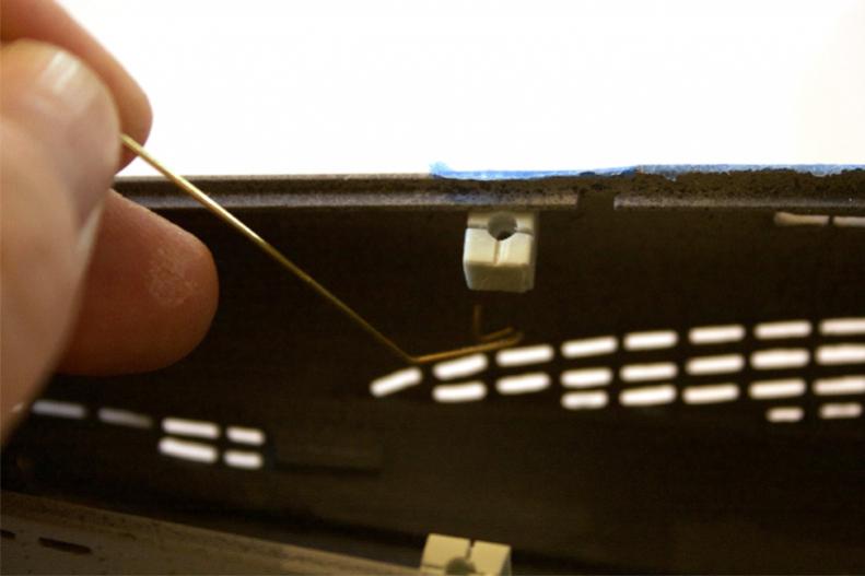

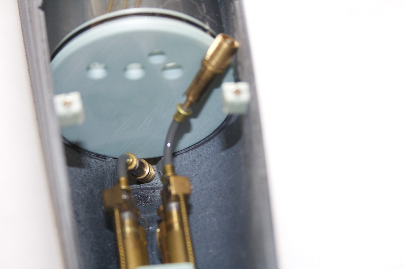

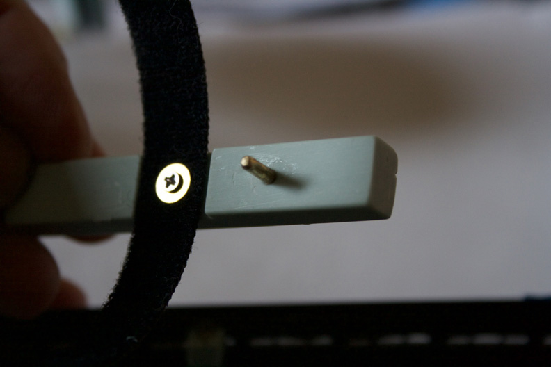

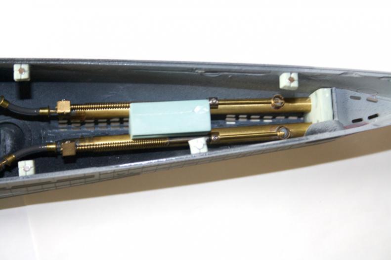

                            Worked on getting the Caswell/Merriman Sub-Driver in.

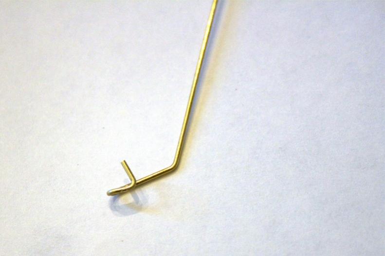

                            One of the parts included is the mounting bracket for the Sub-Driver. There is a threaded hole for a 2-56 screw to go into. also one for a brass wire to be inserted as a securing pin. I mounted the velcro strap with a washer and the 2-56 screw. Used CA to seal the threads from the bottom as I tightened the screw in. The Wire I used was a scrap piece I had in my brass box. I did not pay attention to the size, but cut it so it was flush on the bottom and plenty on top to hold the tube.
Name:	Revell Type IX_118.jpg

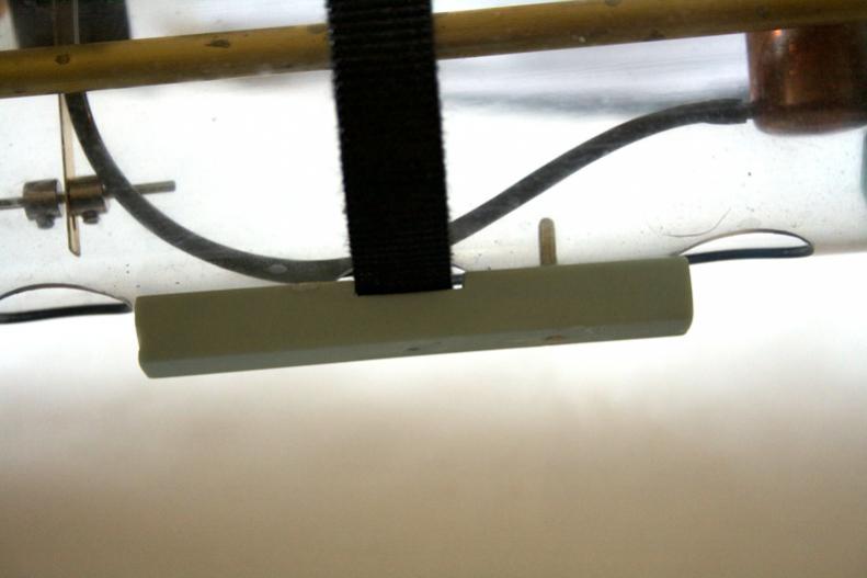

                            Wrapping the velcro around the tube, the piece is held in place ready to be installed.
Name:	Revell Type IX_119.jpg

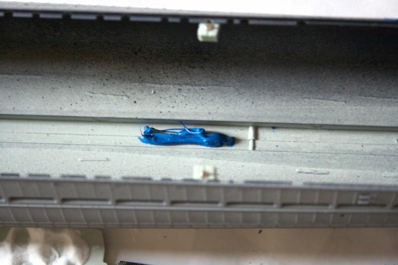

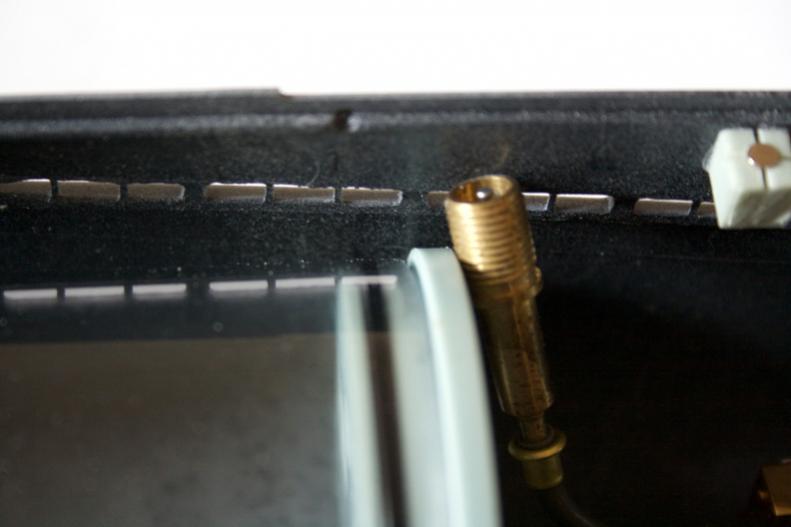

                            Placed a line of RTV silicon in the channel. This is where the mounting bracket or foundation will go into.
Name:	Revell Type IX_120.jpg
                            Placing the tube in, using the Dumas dog bone as the spacer, the tube is placed in and pressed down into the RTV silicon.
Name:	Revell Type IX_121.jpg
ID:	128233Click image for larger version
Name:	Revell Type IX_122.jpg
                            Pushing the tube forward, it begins to spread the bow area because the lip on the end is a little wide.
Name:	Revell Type IX_123.jpg
                            You might be able to see it pressed against the wall of the hull. Not sure if it is clear here. so it will need to be marked and filed down.

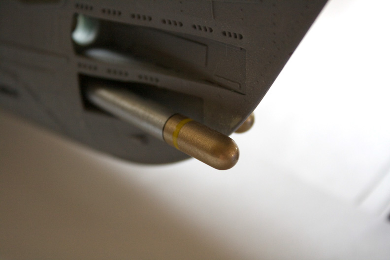

                                Now a first. I have not played with torpedoes and I thought this is the time to add a couple. When I do get a chance to run a sub, the question about torpedoes usually comes up by a passerby or someone mildly interested in getting involved. The desire to get experience in the many facets of our hobby precluded me from skipping this. There was not much to photo here and the steps to install the basic foundation were file open the Revell torpedo tube opening to fit the brass tube. Slide the tubes into the torpedo foundation included in the fittings kit. set the spacer in-between the tubes and that was it. Now I need to contemplate how I want to activate the launch itself.
Name:	Revell Type IX_125.jpg
                                I will put the top torpedo doors on and launch from the bottom doors. My thinking on that is to keep the weight low.
