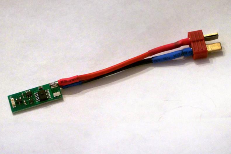

              Bob, indeed the way you mounted it is the preferred way. According to the instructions, if an overload happens, the solid-state relay might get hot. If it was against the tube's wall, it might damage the tube.
              This device is sweet. Soldering the battery leads to the switch.

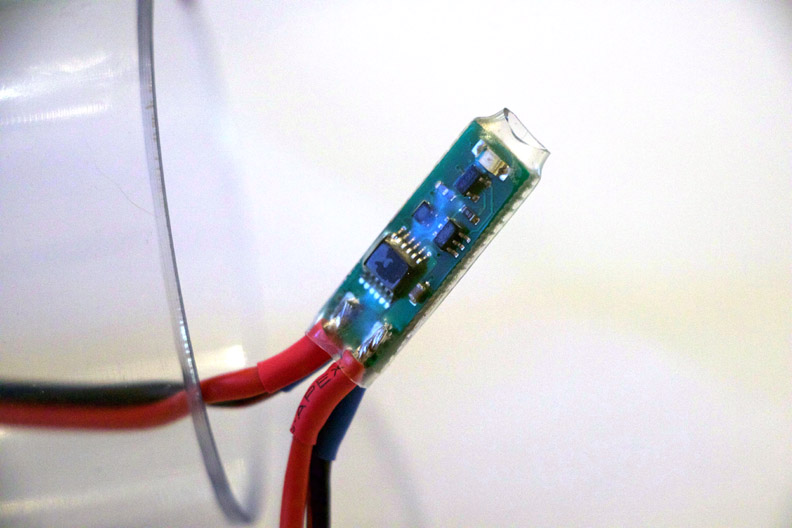

              Then the output to the engine room.
Name:	Revell Type IX_162.jpg

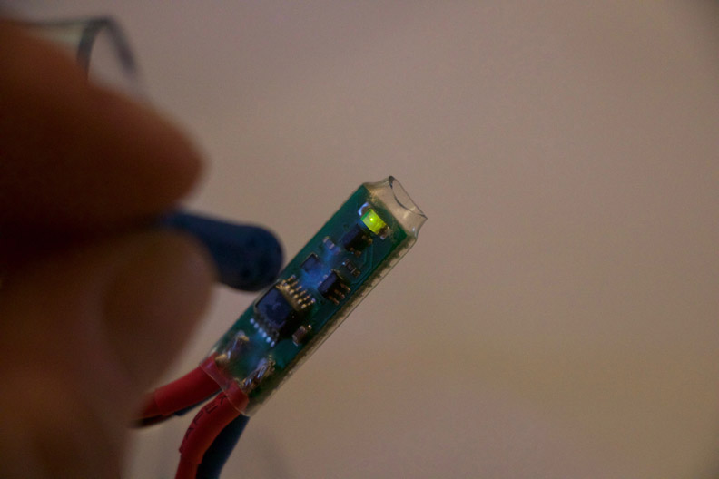

              Tested it and it works. How simple is that? There are two models a 5A and 10A. This is a 10A version.
              Once I got the magnet close the LED goes solid and as I remove the magnet it blinks showing me it is on. Then bring the magnet close again, the LED goes solid and then the LED turns off. Cool, that is it. No external switch, no, leaking boot. I like this a lot! Kevin this is brilliant!

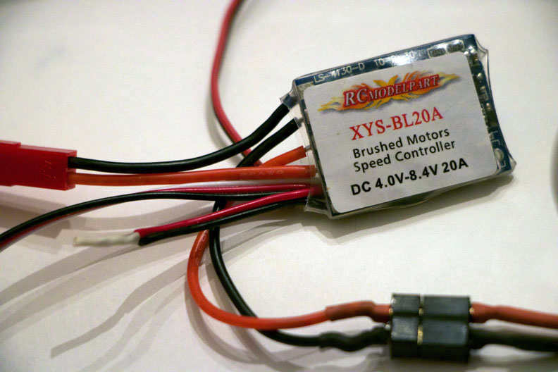

                So, after playing with the wiring, I got the ESC to work.
Name:	Revell Type IX_164.jpg
                Got everything wired in and the ESC does not work.What in the world? Bad solder job? Multi-metered my way around following the power trail. There were two areas that had issues. Not the solder joints at all, but the connectors. The Deans plug from the battery when plugged all the way in, power would cut off. Wiggle the plug out and it would connect. I made a bigger bow in the connector it works now. Next on down the line was from the ESC to the motor. I got power to the black Deans type connector. On the side to the motor nothing. No power was making it to the motor. The ESC was working. It was the connector again.
                Have you run into issues with Deans plugs?
                I am really enjoying the magnetic switch!
