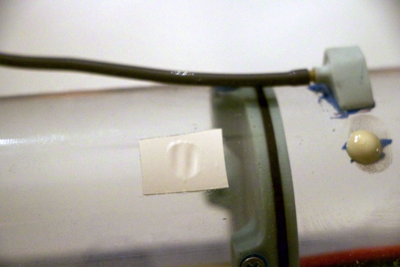

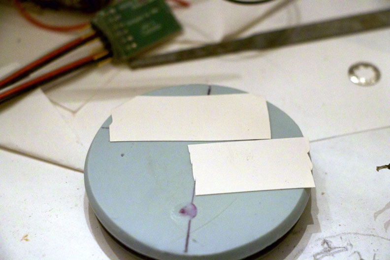

    Moving along that line, I moved the float valve forward and had the original hole covered with electricians tape. That is what David Merriman uses on any openings in the ballast area, if it becomes an issue, I can fill it.
Name:	Revell Type IX_165.jpg
    I did redo the tape and put on a larger piece.

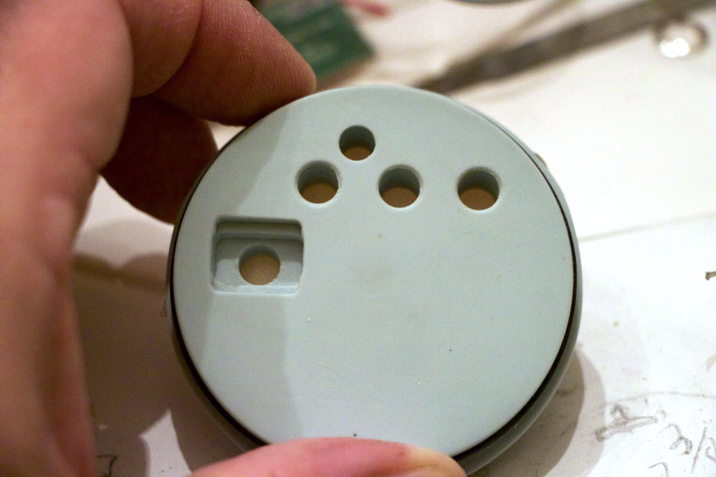

    Battery compartment has several holes that can be used for pushrods seals or the archaic manual switch (yeah I am loving the magnetic switch that Kevin McLeod makes).
    So I taped one end.
Name:	Revell Type IX_166.jpg
    Flipped it over
Name:	Revell Type IX_167.jpg

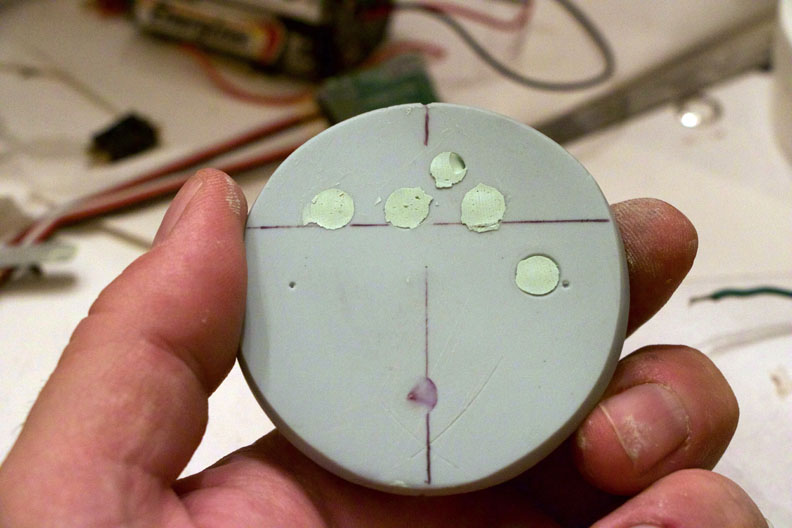

    filled with Metal Glaze (Bondo type material)
Name:	Revell Type IX_168.jpg
    Once dried I put some CA on the back side to seal it. The front will get a light sanding make it nice and flush.

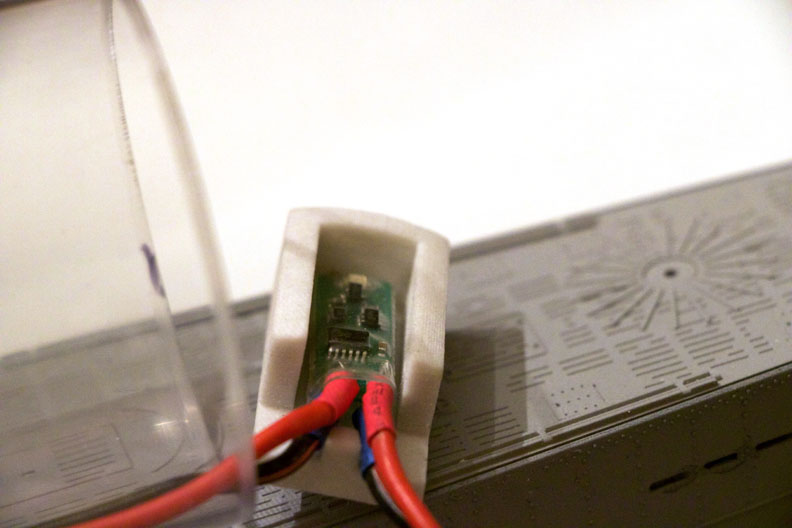

    For the Magnetic Switch, I made the holder. I am still debating whether to use it or not.
Name:	Revell Type IX_169.jpg

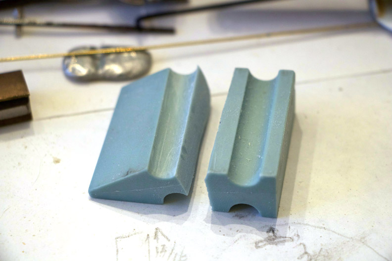

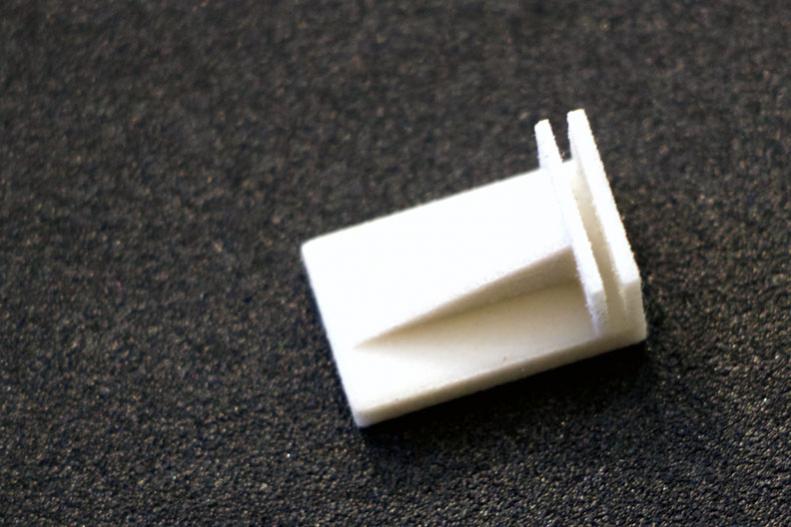

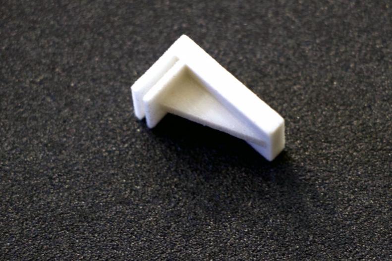

      There just does not seem to be enough "just right" spots for the equipment we pack into these little tubes. I thought I would try adding a tray.
Name:	Revell Type IX_170.jpg
Name:	Revell Type IX_171.jpg
      Installed it looks like this:
Name:	Revell Type IX_172.jpg

        Neat idea, and the part you made looks very crisp and functional. Nice workaround.
        TomK
          #124
          Thank you. I might make this with even a larger tray. It is one area of our hobby I really like. Coming up with ideas, solutions, and meeting challenges. Even if it is small steps like I have bending on this sub.

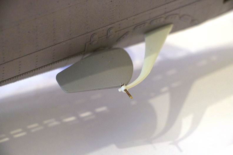

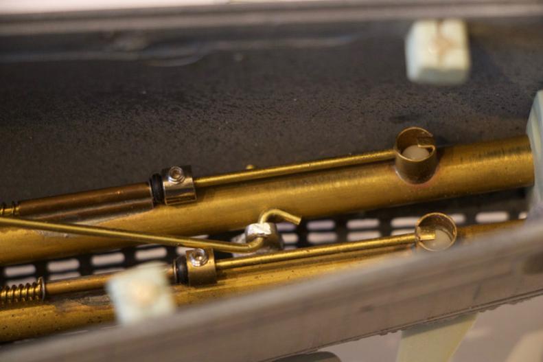

            Worked a little more on the bow planes.
            he initial install is really straight forward.
Name:	Revell Type IX_173.jpg

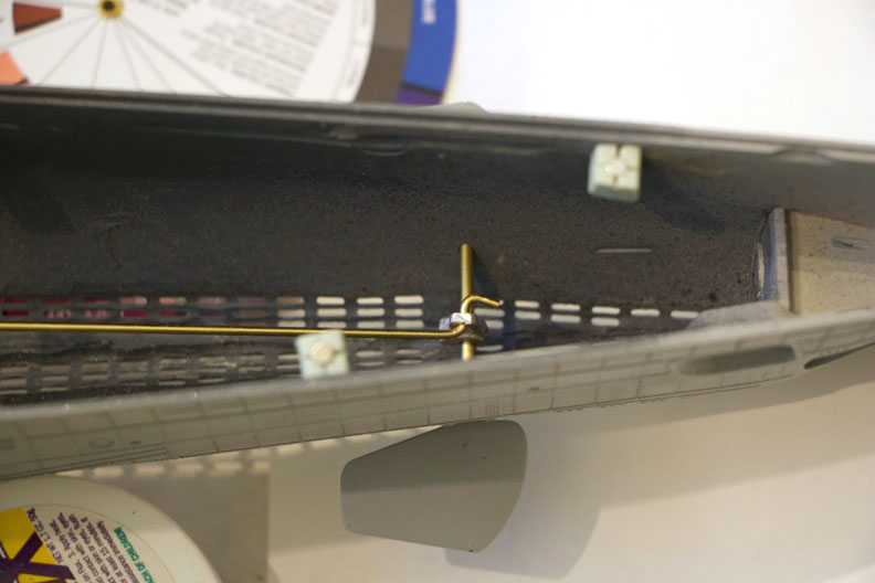

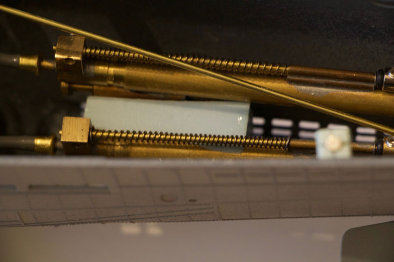

            The trickier part is once the torpedo tubes are installed.
Name:	Revell Type IX_174.jpg
            Since I am only putting two tubes in (and they are not being made anymore) I cut the top portion of the alignment piece.
Name:	Revell Type IX_175.jpg
            Doing that gave me more options of how I am going to run the pushrod.
Name:	Revell Type IX_176.jpg
            David's kit includes tiny brass rods to go through the plane guard and into the plane itself. Drilled out a hole in the guard and expanded the already provided hole in the plane. If I CA these little rods in, any damage or chance of disassembly is reduced to zero. I can use an RTV rubber, but pulling it out will be problematic.
Name:	Revell Type IX_177.jpg
            It is possible the guard can flex enough to allow the removal of the plane. I won't play with that until I need to (hopefully that will be never!)

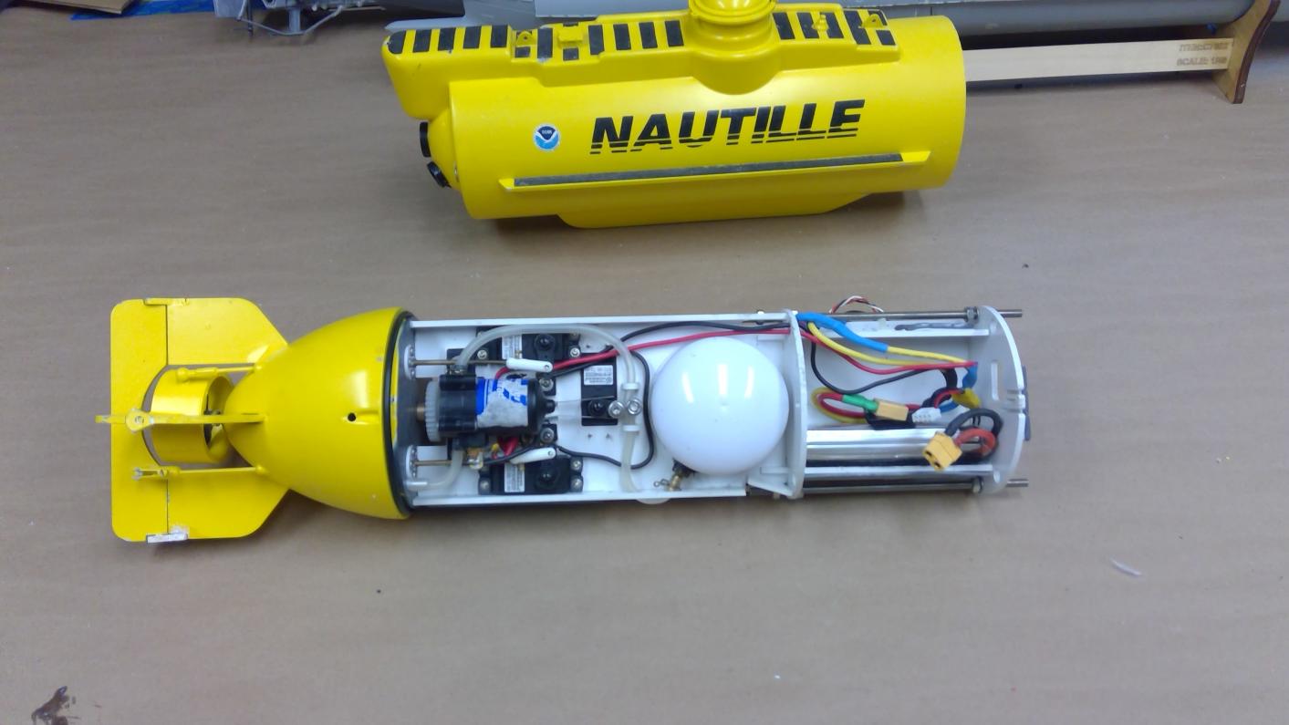

                          On my way to the pond now with my little Yellow Submarine

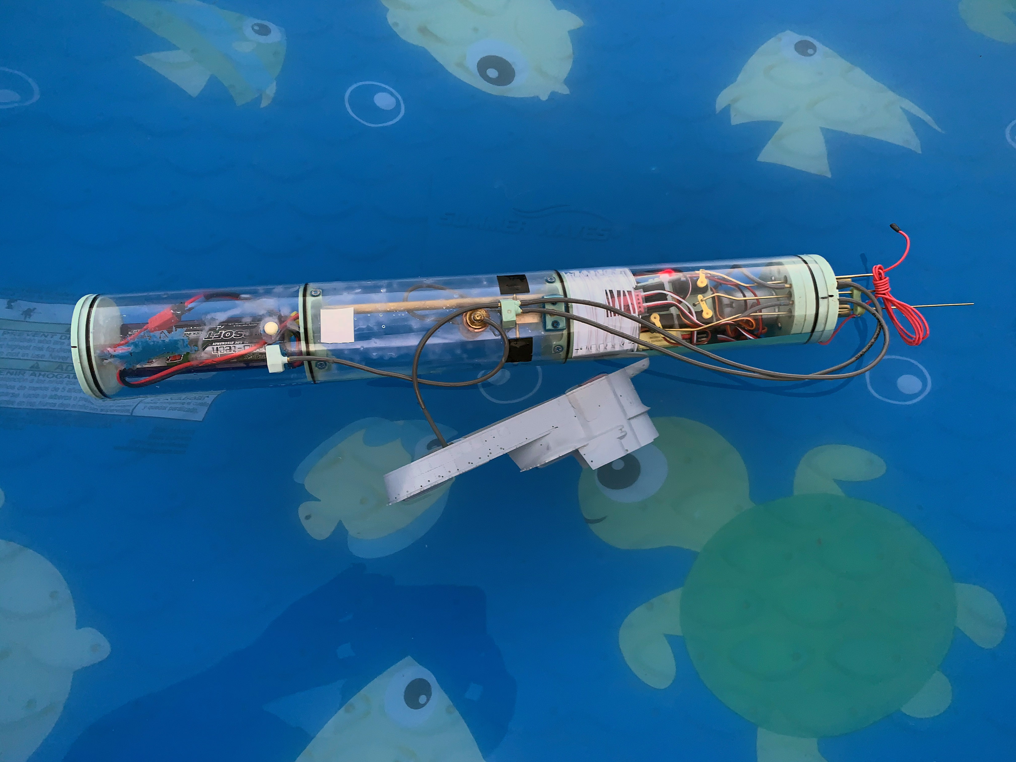

ID:	131969, will email when I return.
                          Again thanks

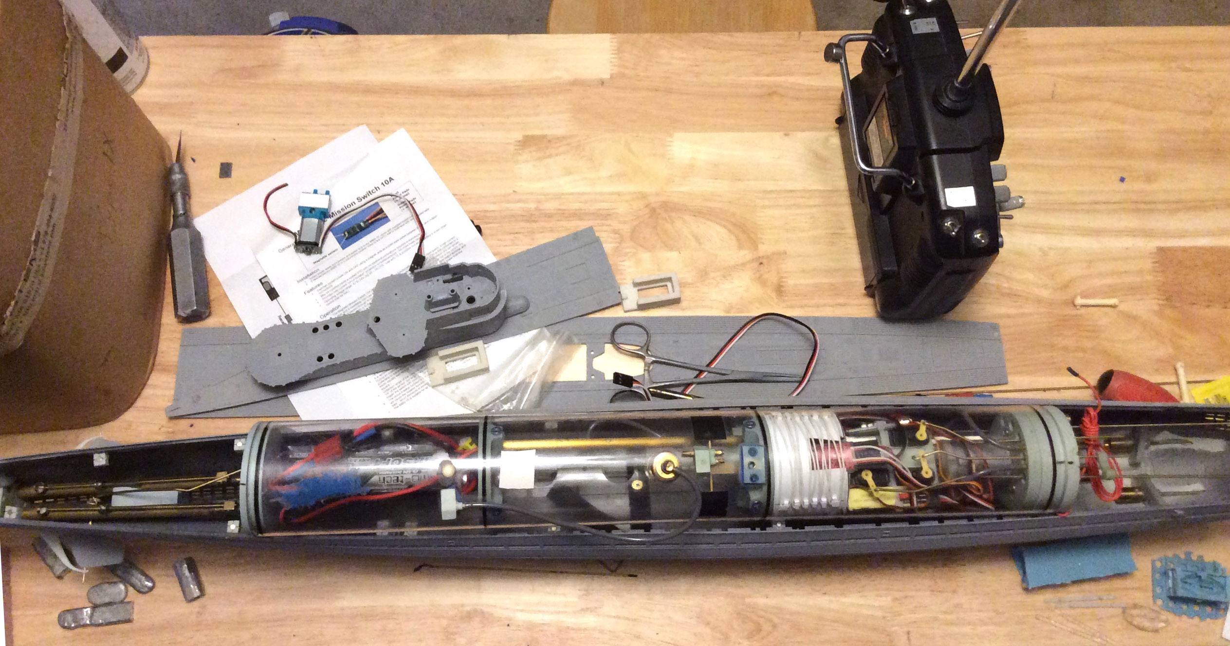

                            Time to get back on this sub. I have taken too many detours. Let get caught up
Name:	Revell Type IX_178.jpg

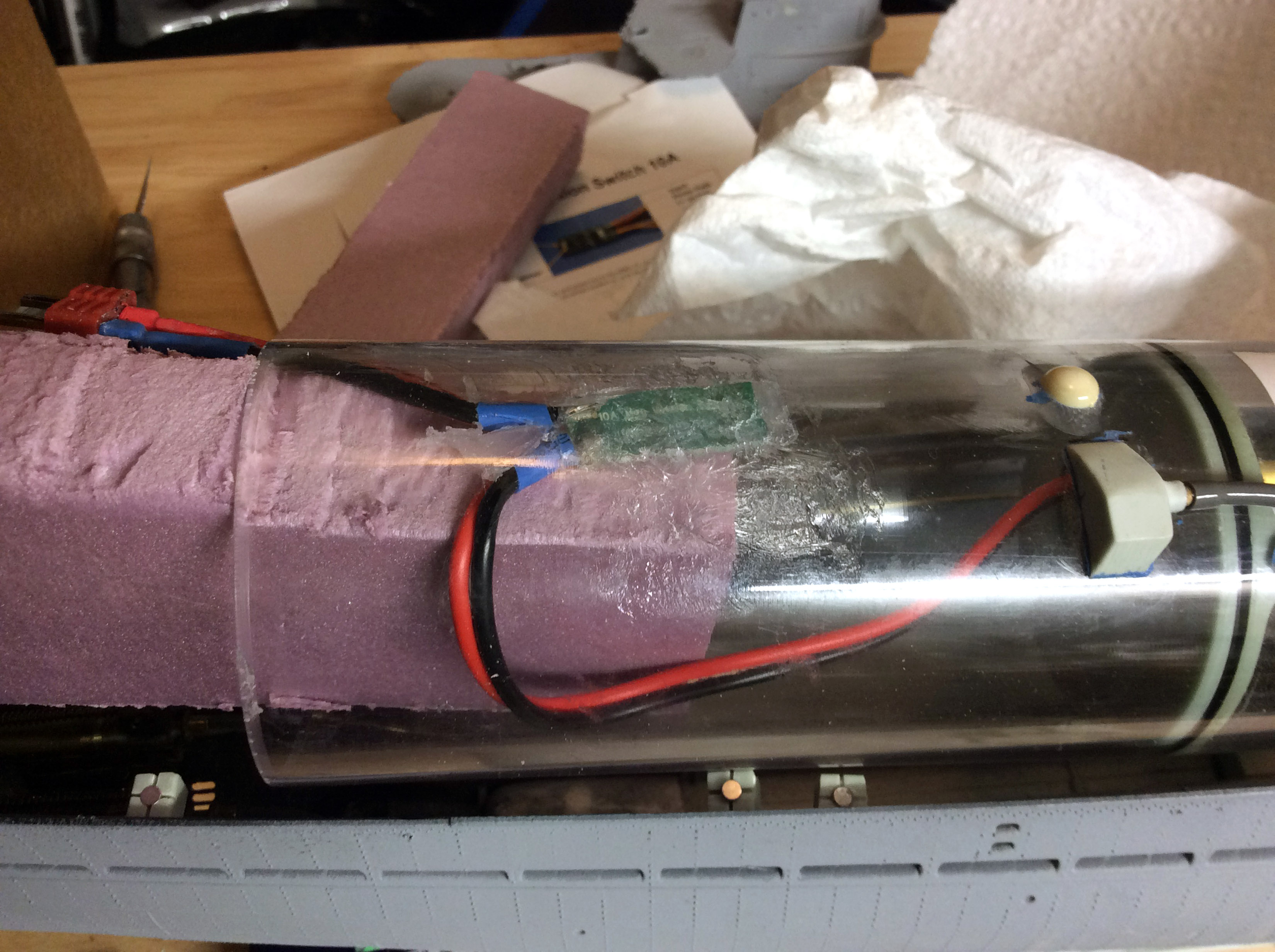

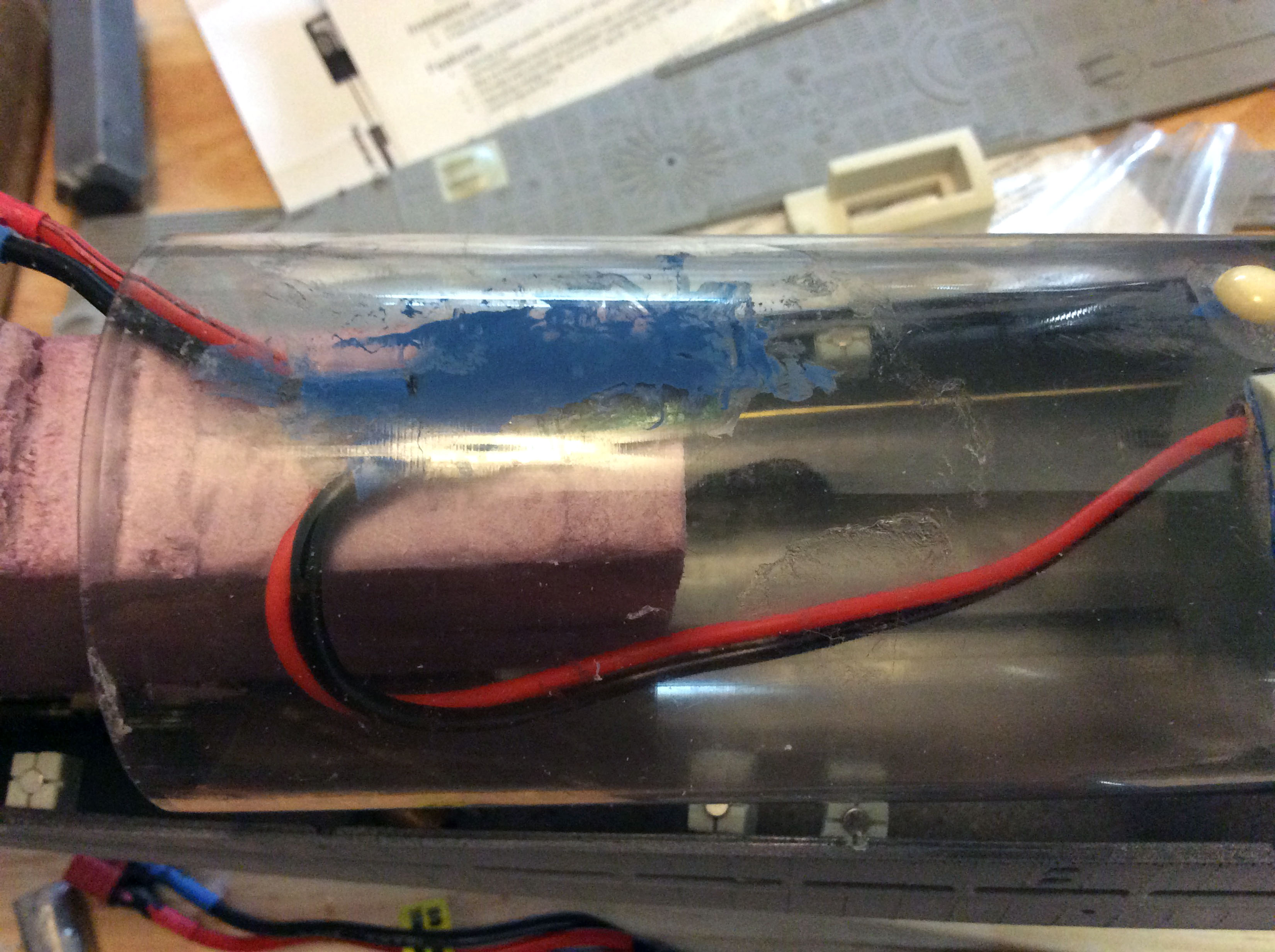

                            I originally was going to make a shelf to mount the magnetic switch, but it was suggested to silicone the switch to the tube. I did that, but the aquarium silicon did not hold for me. So, I used my blue RTV gasket stuff, not pretty...it holds!

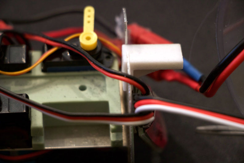

Name:	Revell Type IX_179.jpg

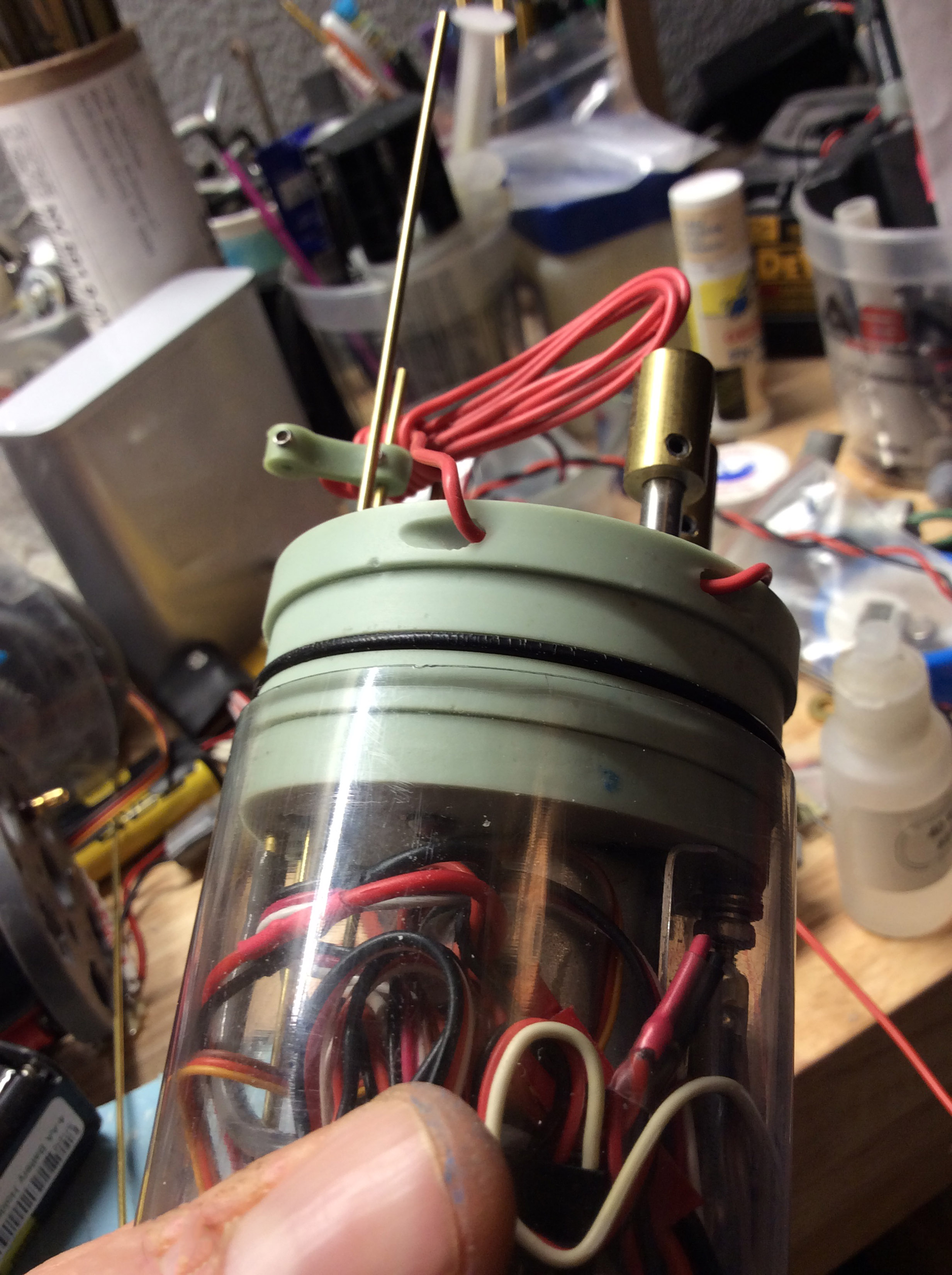

                            I wanted to create a neater way to manage the antenna, this monstrosity is what I came out with.
Name:	Revell Type IX_180.jpg
                            Servo horns are attached and positioned correctly, the other devices are all installed. The wires will be shortened or bundled later.
                            Everything is stuffed in place.
Name:	Revell Type IX_182.jpg
                            Before testing in water, I noticed the o-ring was very cracked - needed replacing. I had replacements so not a big deal.
Name:	Revell Type IX_183.jpg
                            The water test went perfectly. No leaks and all parts responded to commands.
Name:	Revell Type IX_184.jpg
                            Now we are all caught up.

                              I use Goop to glue the mission switches in. Also great for the lead weights. Similar to rubber cement but stronger and water proof of course.
                                #135
                                Bob,
                                If the RTV silicone does not hold, I will consider Goop. (although blue RTV has not failed me yet)
