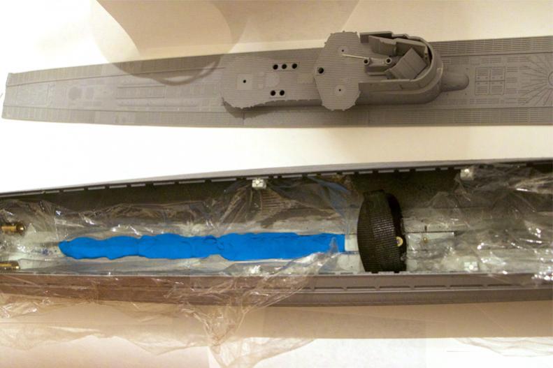

      Making ballast for the sub, I may over do it, but I have done it this way since I started. Usually I use potter's clay, but it was packed and since moving to this house, I cannot find it. The benefits to potter's clay is it dries hard, but can be made soft by placing it in water. This clay I used does not harden, so I knew I would have a chance to make it bend or get out of shape when transferring it to a board.
      A clear sheet of cellophane is placed down first. Clay is pressed into the keel.

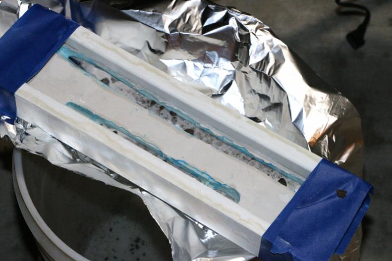

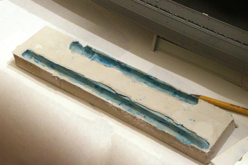

      Plaster of paris is poured over the clay and filled to the top. Once set, I put the plaster mold in the oven at 175 degrees Fahrenheit and let heat overnight. This softened the clay and dried out the mold. If you have a lot of moisture, when you pour the lead, there is a lot of sputtering, bubbling, and flying of hot molten metal as the heat from the lead creates steam. Once out of the oven I removed the clay with a wooden skewer. Unfortunately because the clay is not hard when placed on the board I could not press it down to secure it. So when the plaster was poured, the pieces moved. Parts got too close to the edge and broke when I removed the clay. I will need to secure the sides on before I pour in the lead.
Name:	Revell Type IX_150.jpg

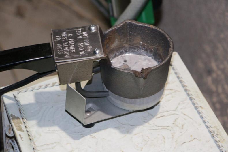

      The lead is placed into the hot pot (these steps are done outside - well ventilated).
Name:	Revell Type IX_151.jpg
      I place the mold over a bucket filled with water. This is done as a safety precaution. If something goes awry, I can quickly push it so it drops into the water. The lead is poured in.
Name:	Revell Type IX_152.jpg

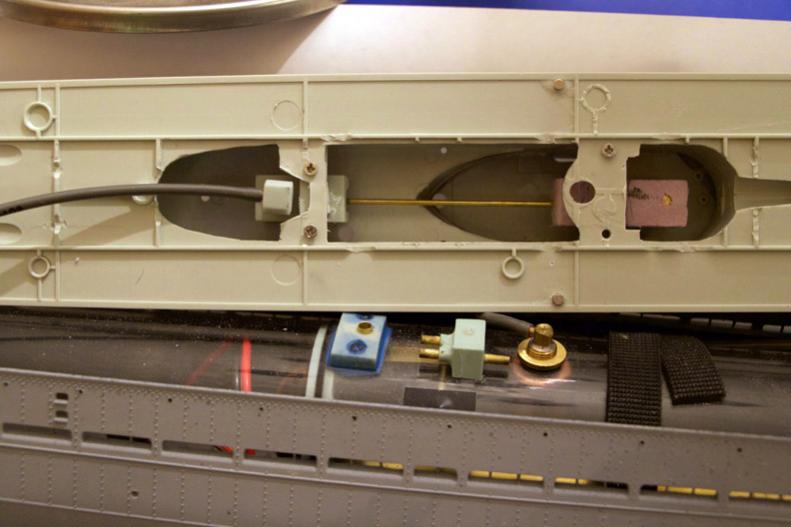

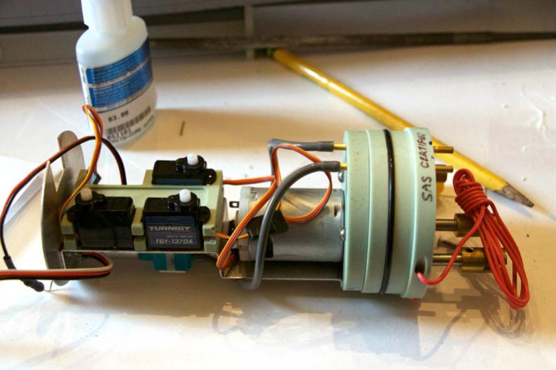

                Did a little work on the engine compartment by installing the servos. The one end of the servo's tabs is removed and the unit is siliconed in.
Name:	Revell Type IX_154.jpg
                Also worked on the installation of the float valve. The valve is mounted to the cross brace on a small styrene pad. I removed the periscope tubes (it is not needed now, before it was to keep the alignment of parts). The openings left were beveled to allow air to escape.
Name:	Revell Type IX_155.jpg
                Now all that looked simple, but I broke both cross braces and it was several hours of playing around. Even with all the contemplating, I still missed things. Like the piece at the end of the tube that the hose connects to, the hull cross beam needed trimming. I also swath float would not drop all the way because of the manifold towards the bow. Sheesh.
Name:	Revell Type IX_156.jpg
                Once adjustments were made, I tested the float to see if it dropped enough to open. I attached a hose and sucked in air. Tilted the deck upright and there is enough travel. whew.
Name:	Revell Type IX_157.jpg

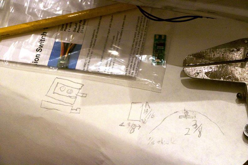

                              I have been hemming and hawing over the internals of the Sub-Driver. How do I keep the switch up high so the magnet can be swiped against the deck?
                              One of my many times sitting and not accomplishing a thing, I had an idea. I will try to explain it.
Name:	Revell Type IX_159.jpg
                              I made this non-scale crayon drawing to hopefully help. The idea is the frame is attached to the top of the tube. The switch can slide into the frame and there is a little block at the end that will hold it in place. The block will fit between the wires soldered to the solder pads.
Name:	Revell Type IX_160.jpg
                              If this works, maybe the leveler can be setup the same?!
