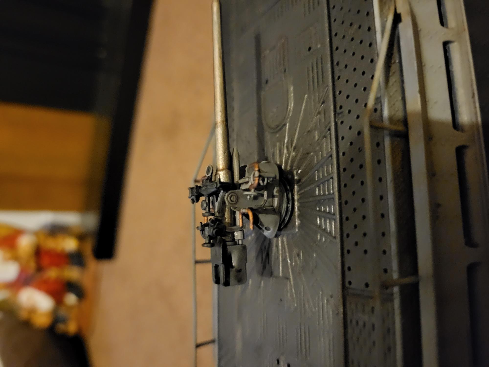

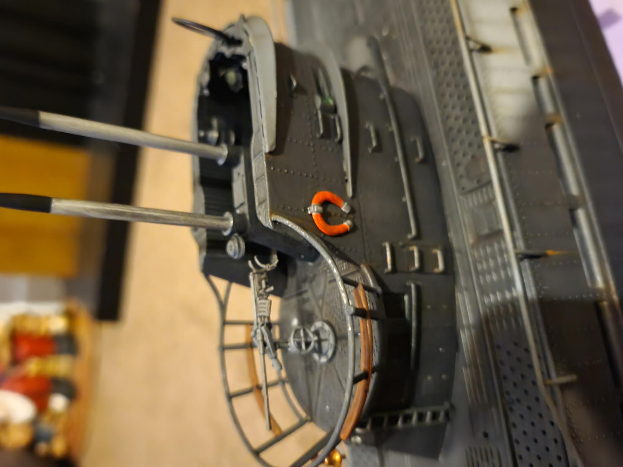

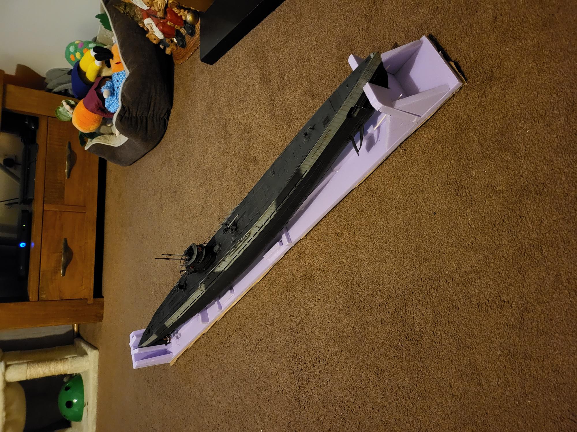

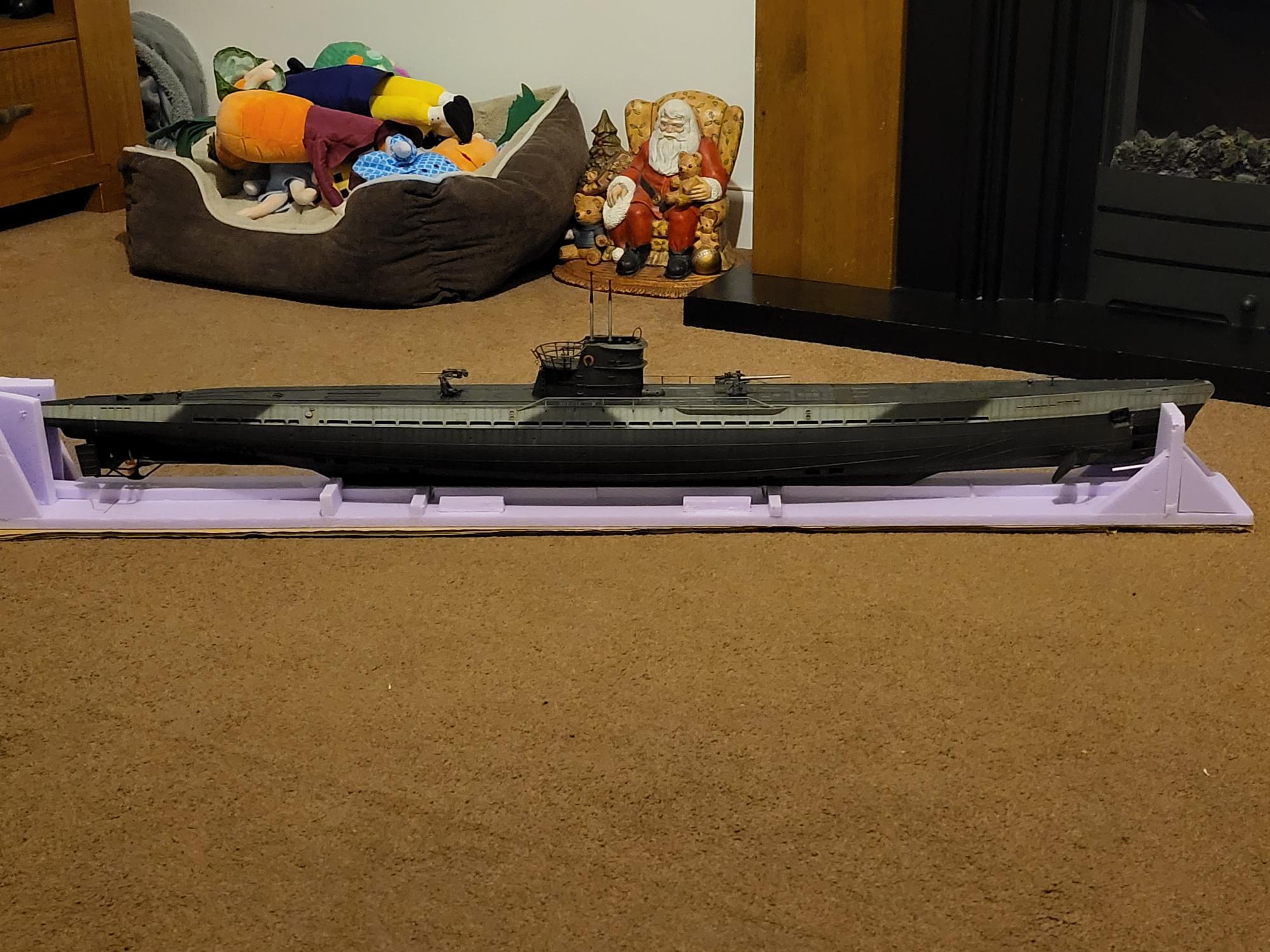

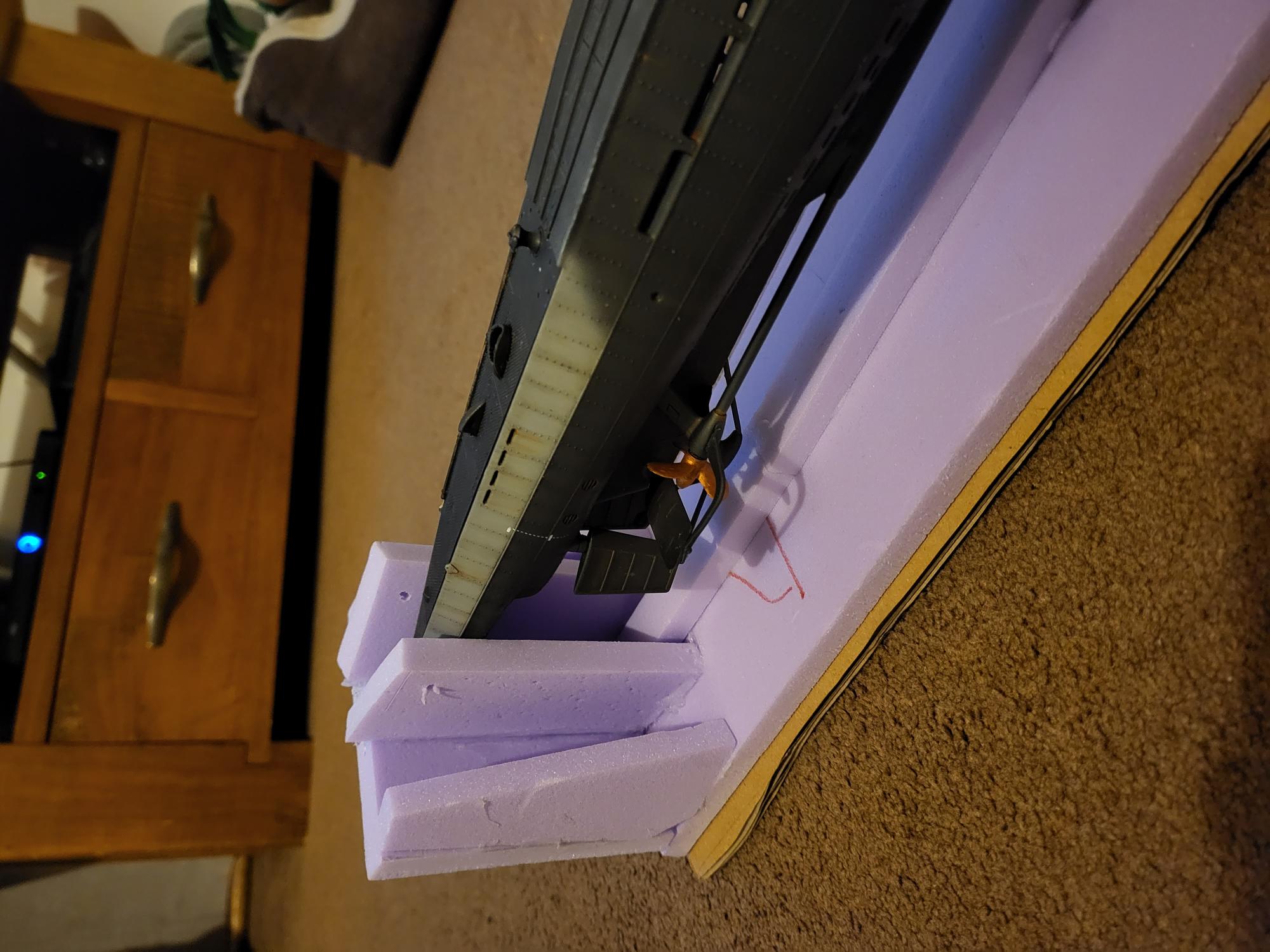

      Hello i just wanted to share some photos of revell 1/72 u154 just need to do the rigging but she is trimmed

                  For some reason the pics are at an angle , if you click on them they straighten up.
