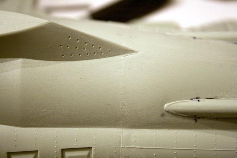

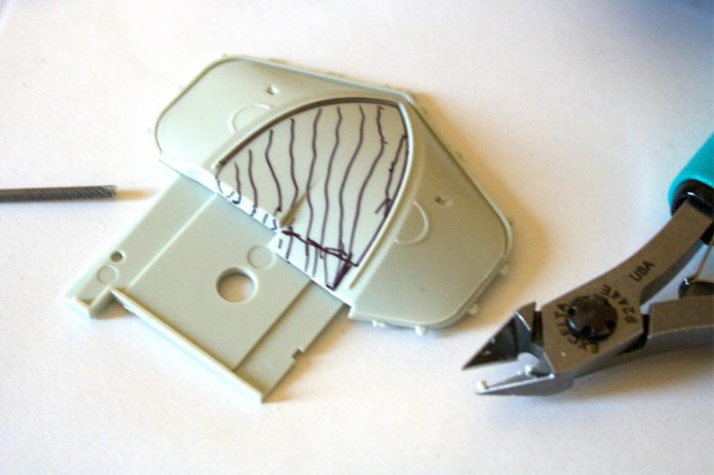

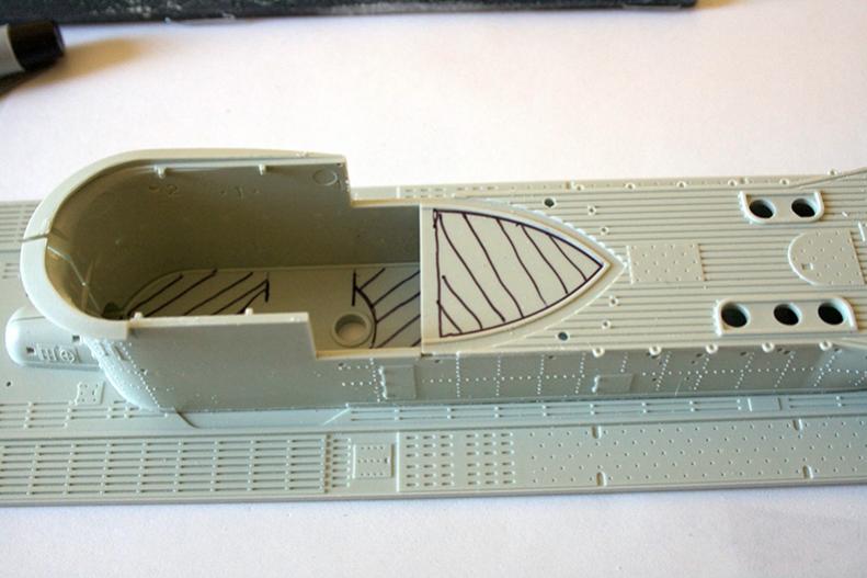

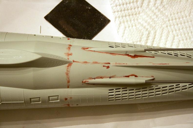

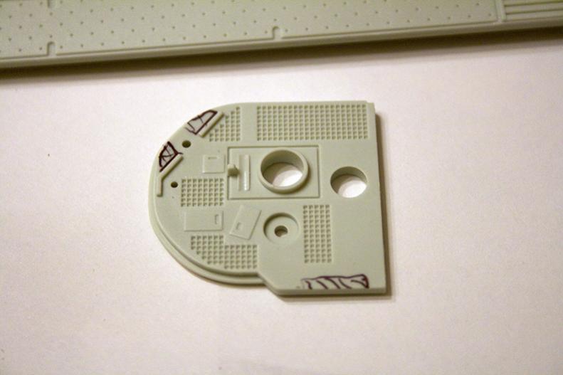

    Began to mark air escape routes and to remove some weight from the Turm.
Name:	Revell Type IX_063.jpg

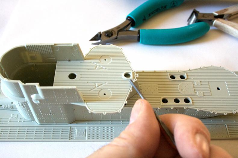

ID:	127861Click image for larger version
Name:	Revell Type IX_064.jpg

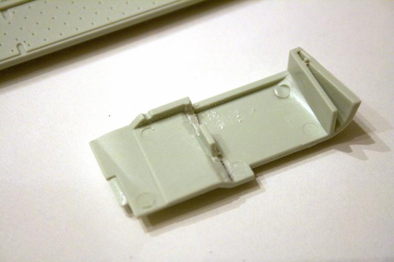

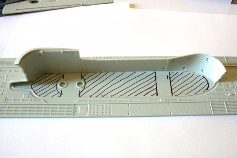

    More to remove
Name:	Revell Type IX_065.jpg

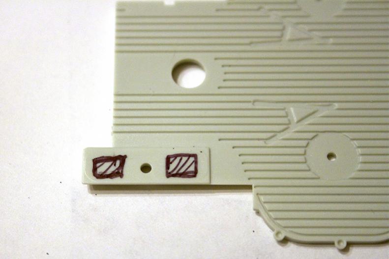

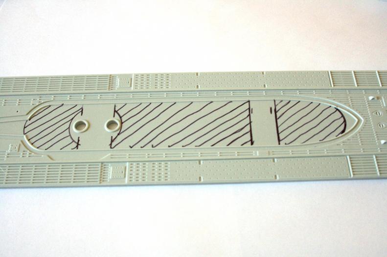

    Here there is an area that will block the flow, flipped over the piece and marked more areas to cut out.
Name:	Revell Type IX_066.jpg
ID:	127864Click image for larger version
Name:	Revell Type IX_067.jpg
      #32

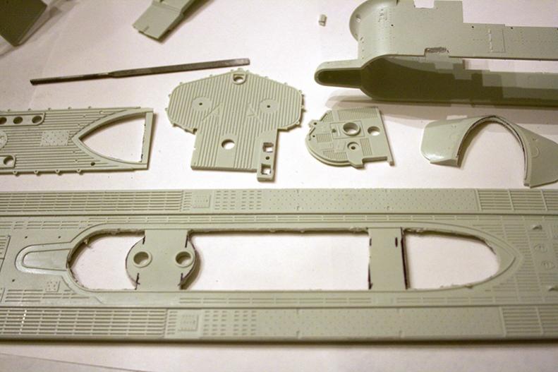

      Continuing to work my way around the decks looking for areas that might trap air and thinking about how air will come out.
Name:	Revell Type IX_068.jpg
      Marking more areas......I think I am obsessing
Name:	Revell Type IX_069.jpg
      Still more? AAAAAArrrggh
Name:	Revell Type IX_070.jpg

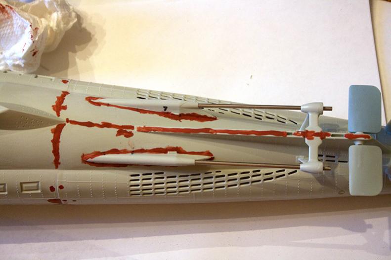

      O.K. areas cut out and here is what it looks like.
Name:	Revell Type IX_071.jpg

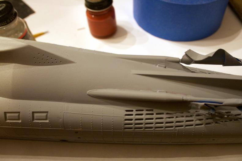

          #34
          Paul,
          I agree with you completely, the performance will tell. There are other I trimmed areas I will show. I do not know if it makes a difference, but if the sub works than of course it was designed to do that!
          I unfortunately did not have any primer so that photo will come later. That being said, I will go for a light color primer. In the coming photos, i will explain why.
          So continuing on seams and such, I applied Nitro-Stan that was thinned down with a bit of lacquer thinner. The thinned property seemed to have a little leveling quality.
Name:	Revell Type IX_072.jpg
          A little wet sanding and the finish came out well, I think, but when primer is applied that is when the real issues will pop up (if any).
Name:	Revell Type IX_073.jpg

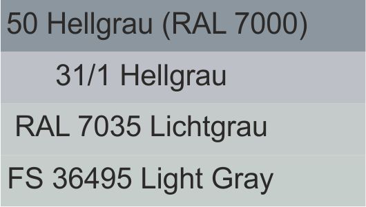

            Tom, it's just the other side. Rusty on the left / Port and colored on the right / Starboard one.
            These photos are from the capture. Now going back to the primer, if you look at the bow shot you can see chipping with a real light gray underneath, as well as the Turm which shows a ton of light gray coming out......do I want to do all that? Must resist.
            The light gray parts should be simmilar to RAL7035. FS36495 with a hue of blue comes close.
            Some color comparison (from web samples)
            Marco

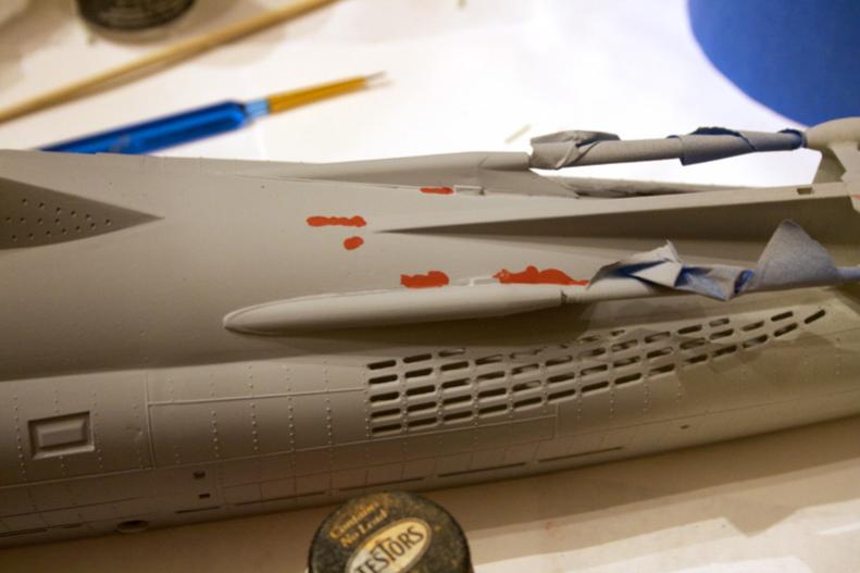

                              I went to get paint and saw an auto store. Went in there and they did not have a light gray, but they did have a paint I had not tried before. It was a filling and sand-able primer. Hmmm, got lazy and purchased it.
                              Shot a coat of primer down and let dry for a day or two. It sure is amazing how areas that originally looked great look ghastly with primer on. Several areas needed more attention and Nitro-Stan was painted on and let dry.
Name:	Revell Type IX_077.jpg
                              After wet sanding with 240 grit wet/dry and then used a wet sanding with 600 wet/dry the areas seemed pretty good.
                              Another light spray of primer. Looks good to me.
Name:	Revell Type IX_078.jpg
                              This is the paint I used. For my first time trying it, I am pleased with the results.
Name:	Revell Type IX_079.jpg
