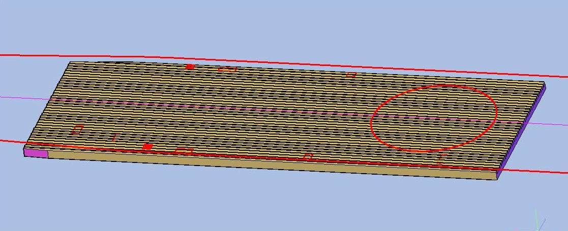

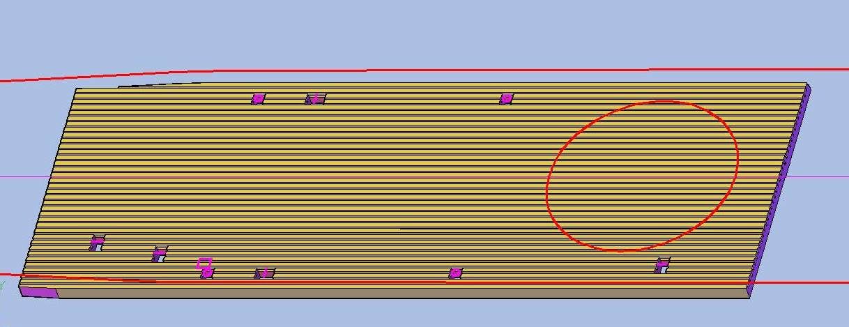

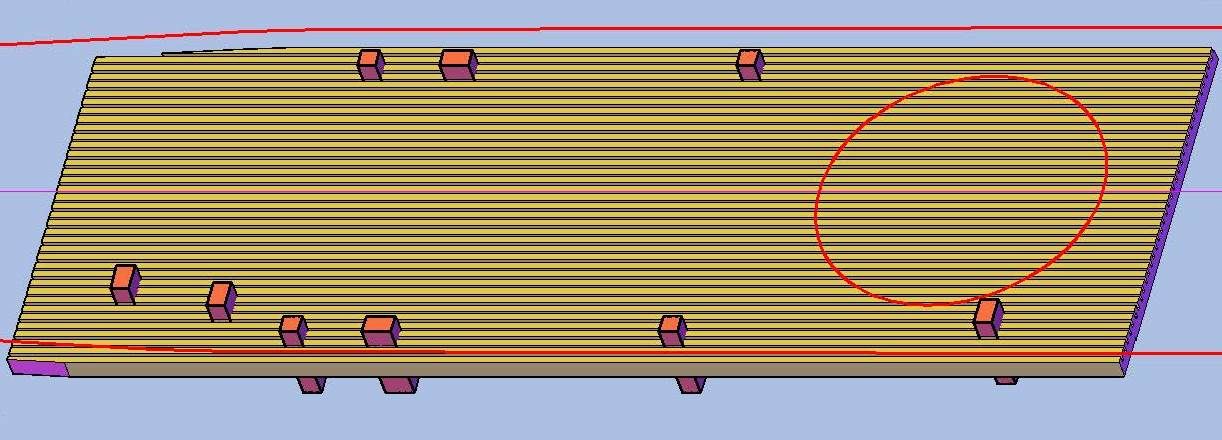

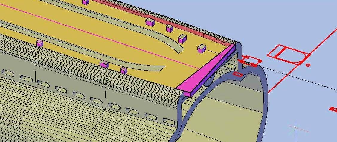

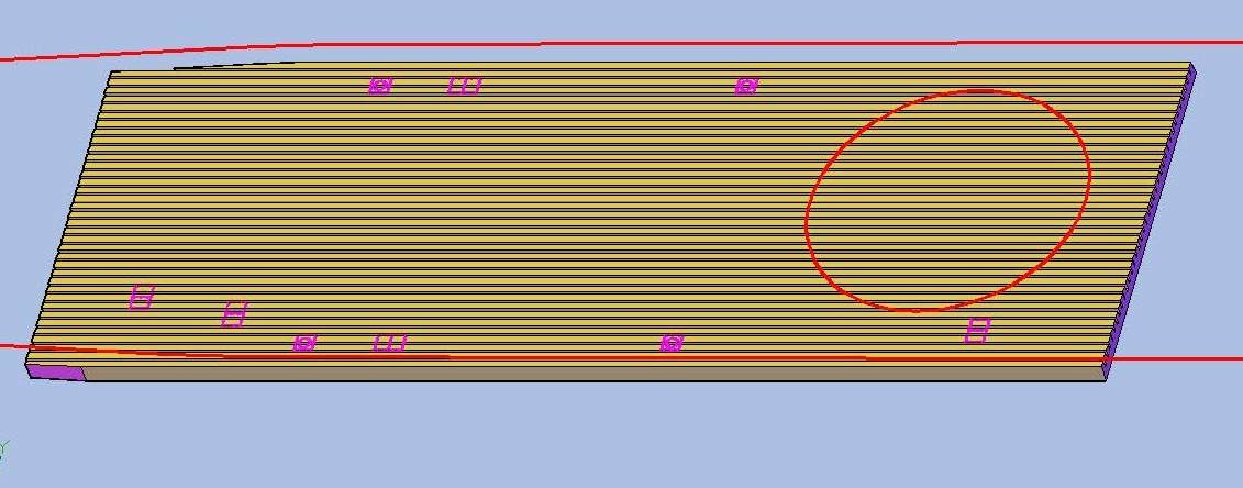

        UPDATE 106
        Hi Guys!
        It isn’t an “it” Scott, it’s a “they”, and there are 9 of them. According to the Fleet Type Submarine Online site they are located as follows][/url]
        I then copied them all to the model and the deck working area, I guess you could call it, copied Part 4 to the drawing, and sliced the deck section to match it.
        Here’s a close up of the Part 4 deck with the tracings positioned on it. The round circle is the location of the forward edge of the fairweather.
        As before the tracings for the AS’s had to be resized and moved slightly due to the off scale battens I had to use. In the image below the red line is the outline traced from the plans and the magenta line is the resized and positioned version.
        I had to do the same for the blow valves.
        The image below shows the deck with the modified features.
        These new outlines were extruded through the deck…
        …And subtracted.

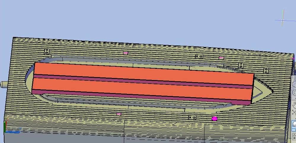

        At this point I moved the deck over the model, but as before the deck at thispoint on the ship is not flat, it is sloped, as seen in the image below.
        So I rotated it and as before, l copied it down in stages subtracting as I went, until it was in position.
        The end didn’t quite get cut off on the aft end, so I drew a polyline…
        …Extruded it…
        …And subtracted it.

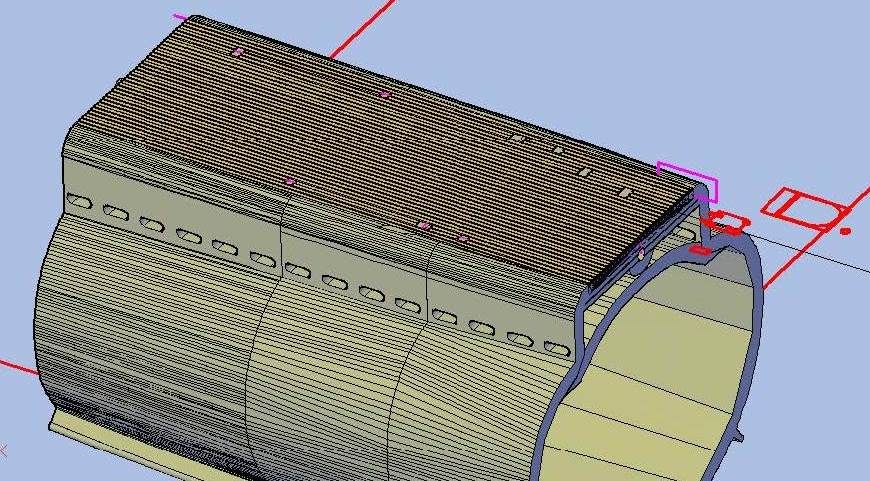

        Next I copied the fairwater to the drawing…
        …And subtracted it. For some reason AutoCad wouldn’t let me subtract it any lower than 0.01” above where it is supposed to be. I have no reason why, so I guess I will have to live with it.
        With the deck complete and in position, I joined it to the rest of the model and prepared to add the AS’s.

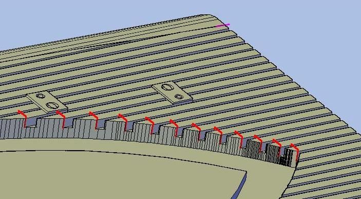

          #274
          UPDATE 107
          Hi again guys!

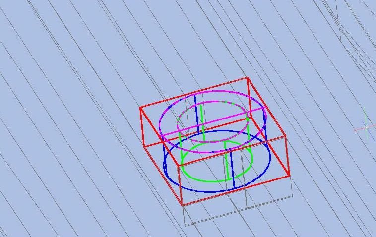

          This isn’t so much as an update as a presentation of options for the 10 pound blow valves. I see two options, although there may be more. The image below shows one of the blow valves with construction lines in magenta.
          The following images show the process for the first option with the first two images showing the extrusions used to make it, first in Conceptual Visual Style…
          …Then in wireframe to better see the extrusions.
          In the first option, the extruded rectangle is first subtracted from the deck…
          …Then the inner extruded circle is subtracted from the outer one. The resulting tube would be attached to the deck.
          The setup for the second option is shown in the image below. The extruded rectangle (red) wouldn’t be needed because the base would already be there. However, since I just subtracted it for Option 1, I had to re-extrude it. For the second option the circles were moved 0.005” above the platform then extruded.
          At this point the outer circle would be joined to the deck and the inner circle subtracted from it.
          The second option would be the easier of the two, and is the way I am leaning, but I thought I would bounce it off you guys before I actually do it. What do you think? Option 1 or Option 2? Perhaps Option 2 with the flange level with the deck instead of raised 0.005”? Or something else?
          CHEERS!!!

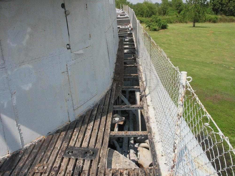

            #275
            We need Bill Lambing in on this one for sure... But, I think the ballast tank riser openings may not vent through the superstructure deck atop the pressure hull itself but actually through the ballast tank sides along the hull.
            I think what I have indicated below (red arrows) may be the riser openings (blanked off with a cover plate) on Lionfish][/url]
            If you examine the deck visible in this photo, I see no openings similar to the ones you created in the superstructure deck][/url]
              • 848
              #276
              Gents,
              Hi, Tom!
              The features Tom has highlighted are manway covers for access in fuel ballast tanks. The 10-lb. blow valves only are used in MBT group two and six tanks for list control and are operated from topside, on the main deck. Chapters 5 and 10 in The Fleet Submarine textbook in the HNSA website describes and illustrates the MBT and Salvage Air systems. The actual MBT vent risers terminate under the superstructure and can't be seen from outside or above. I'm not really sure what the 10# gate valve operators look like from the main deck. This will take a bit of research on plans or in more pictures.
              I would think that the deck wrench used to operate the 10# valves would fit into a socket similar in size to that where the ASS (Air, Ship Salvage on Nucs!) connection valve stem is. The textbook does tell us that there is an ID plate surrounding it and the plate has ID lugs to let a diver know where he is. There is no exposed handwheel there. Looking at rd's rendering, the size for the circular plate looks about right!
              Have fun with this, I'm going deep for a month!
              Bill

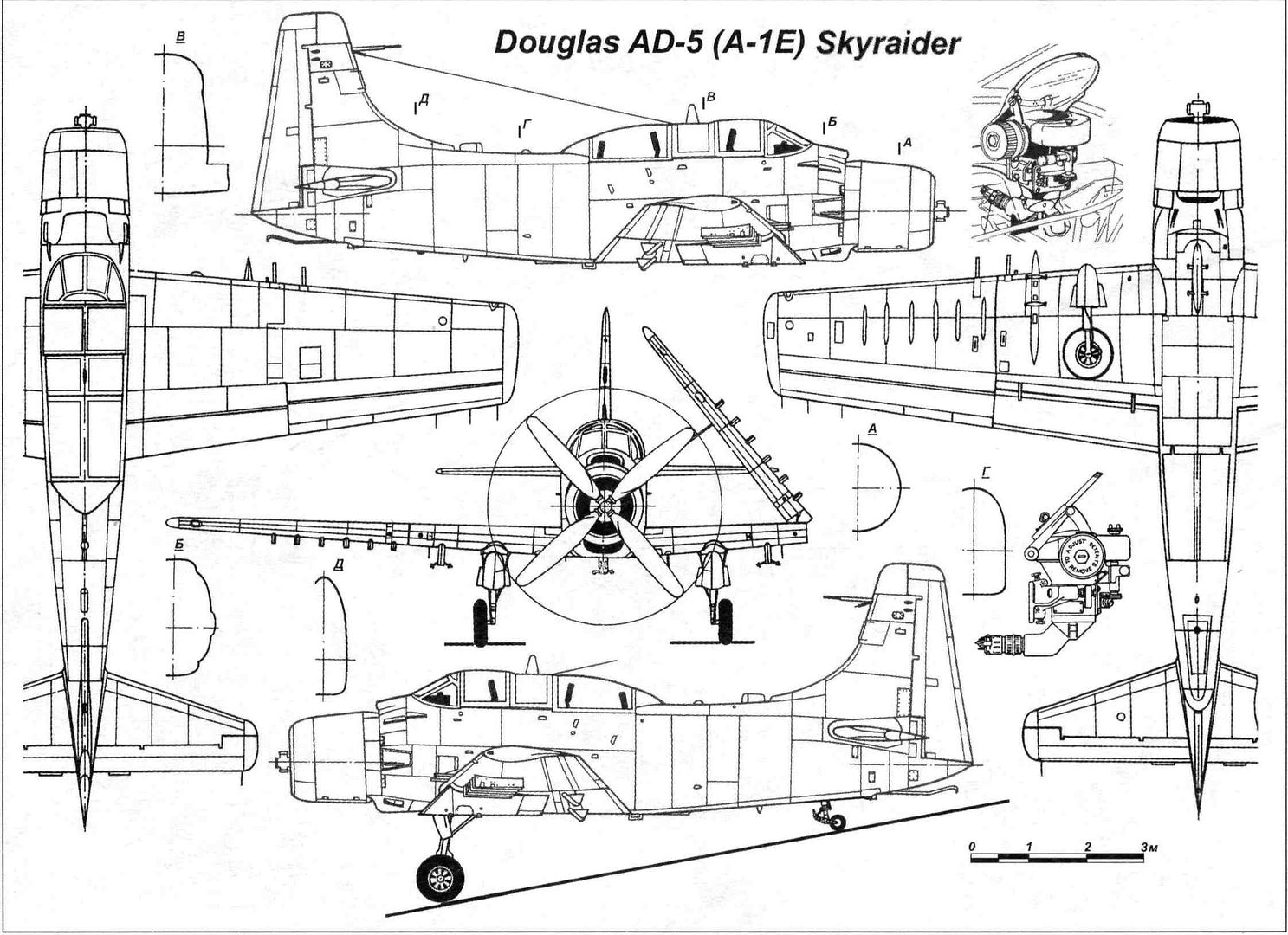

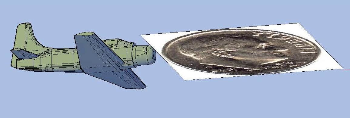

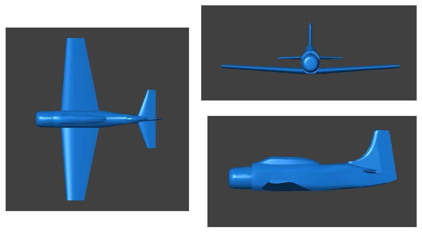

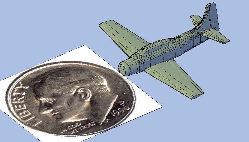

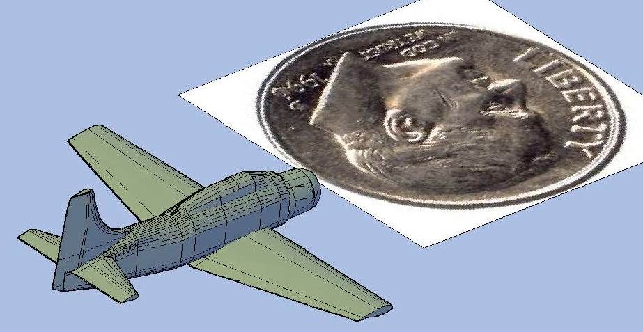

                      I was sent the plans shown below for the Douglas AD-5 (A-1E) Skyraider on Monday.
                      When I first saw them, I didn’t think I could do it, or that it would take a long, long time. I spent about an hour messing with it at the first of the week, but gave it up as too difficult. Yesterday afternoon however, it popped into my head how to go about it, and early this morning after about 8 hours of work I completed the first draft. Here are some images of it, including 4 from AutoCad…
                      …And 2 from SolidView.
                      I think I will take one more day, or at least part of it, and make the AD-5W that he also wants. It should be an easy modification to make.

                        #281
                        They all appear to be different and you can only see a small portion of them.
                        Welcome to the always confusing world of Fleet Submarines! Yes, some were built with complete teak wood decks, and some had partial teak wood and then metal deckplates. As time went on, much of the deck was metal plate, particularly in post war boats that were heavily used.
                        That is the case with Lionfish][/url]

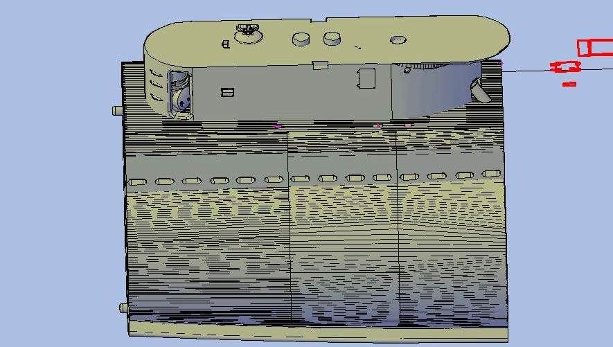

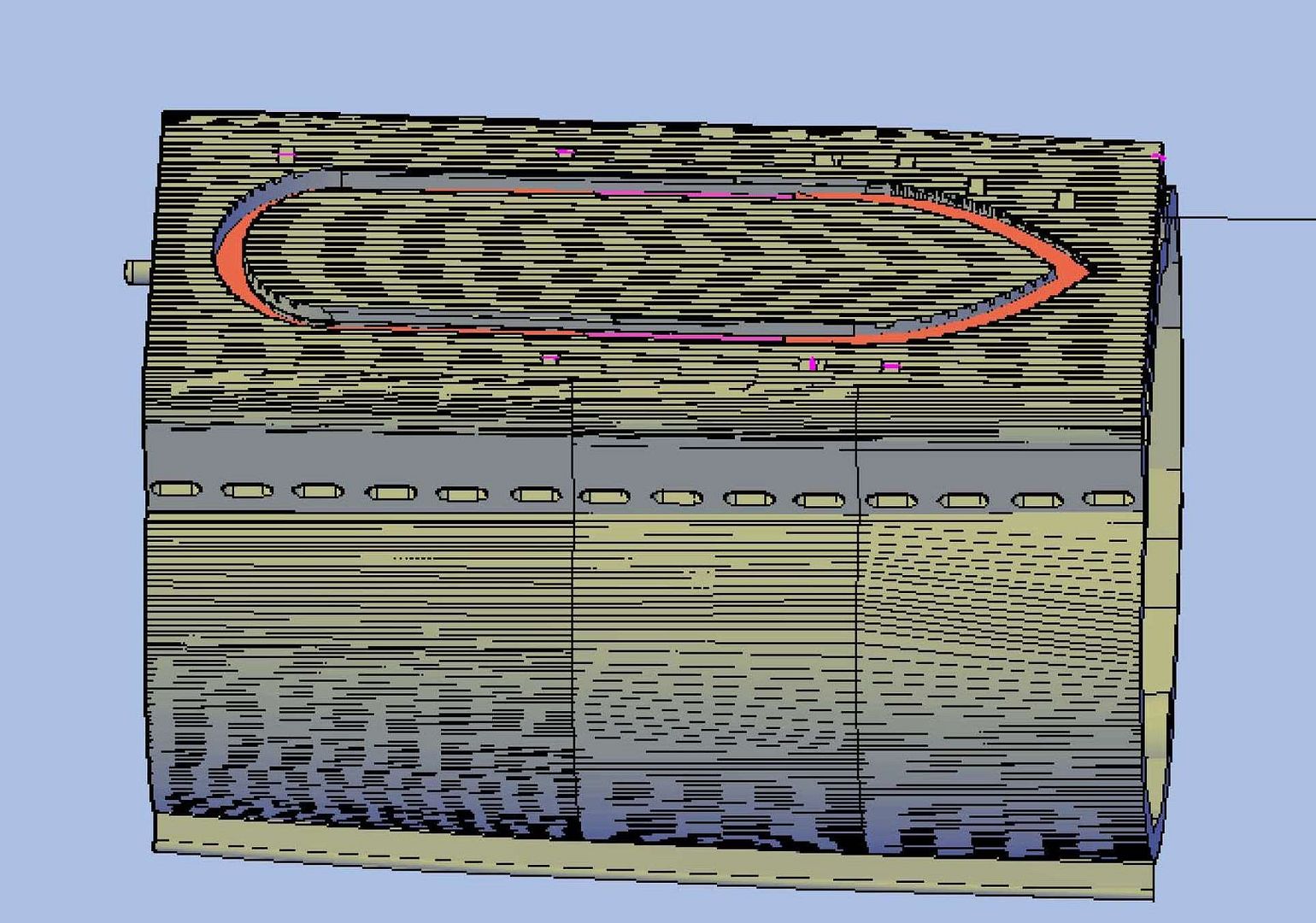

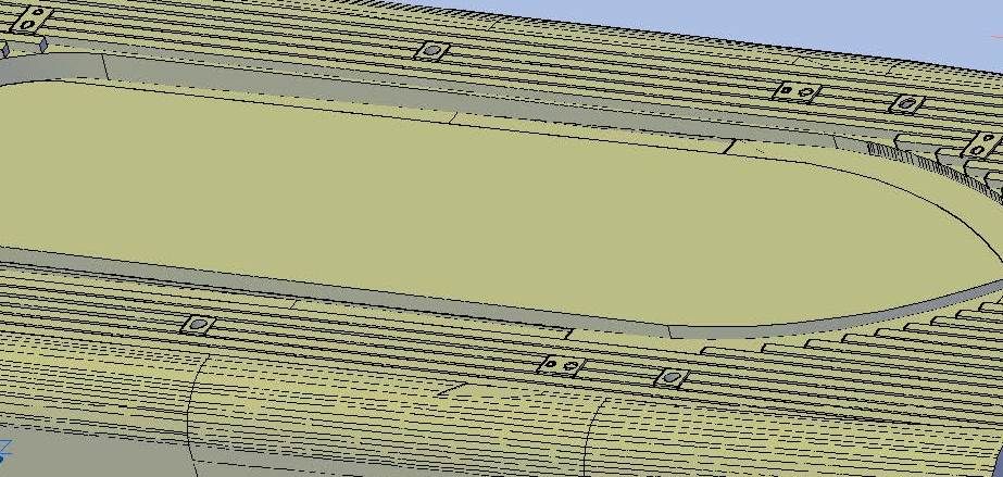

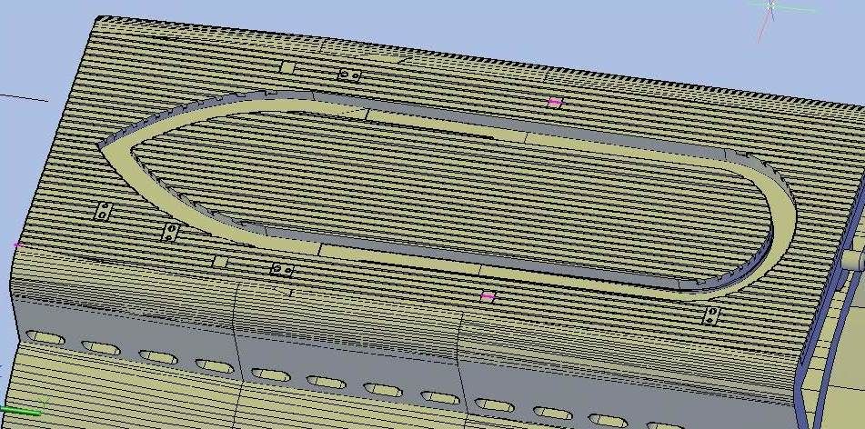

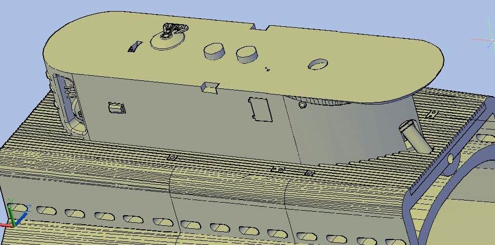

                              UPDATE 108
                              Hi Guys!
                              Great pix Scott! I joined Submarine museums.org after you mentioned them in an earlier post and have had some feedback from them. I hadn’t taken the time to go through past posts though, until your post here. When I did, I found this picture that I am pretty sure shows a 10# stop valve. It is the object in the second opening up and to the right of the SA. At least the plans show one here and it looks right to me. The square dark object is the plate that would be seen on the deck. It even looks a lot like the plate on the SA, but smaller, as it should be. The lighter portion would be below the deck.
                              I now know how I am going to do them, but first I did some modifications to both the deck on “Part04-Hull04” and to “Part11-Fairwater”. Starting on the deck I trimmed some tin sections of battens along the sides because they would be way too thin to print. The image below shows the extruded rectangle I subtracted to remove them.
                              Here it is after it was subtracted.

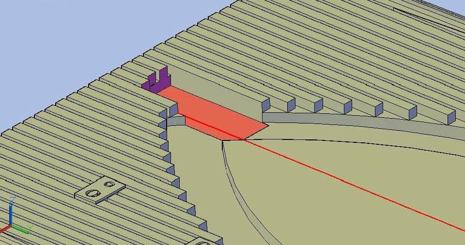

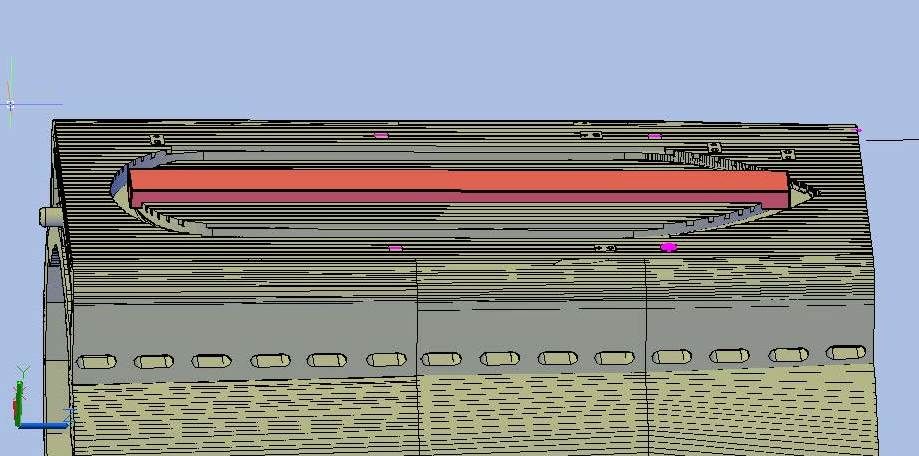

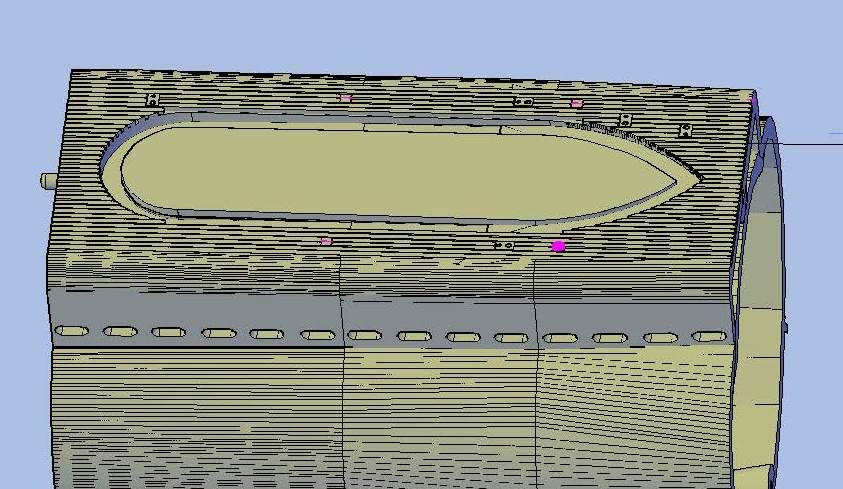

                              Next I removed the battens on the inside of the fairweather. I had to do this in stages, and I started in the middle first drawing a rectangle where I needed it.
                              Then extruding it…
                              …And subtracting it.
                              The next few images show the process repeated to remove all of the interior battens.

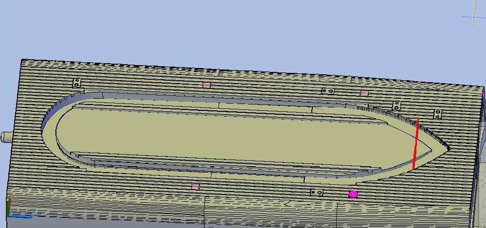

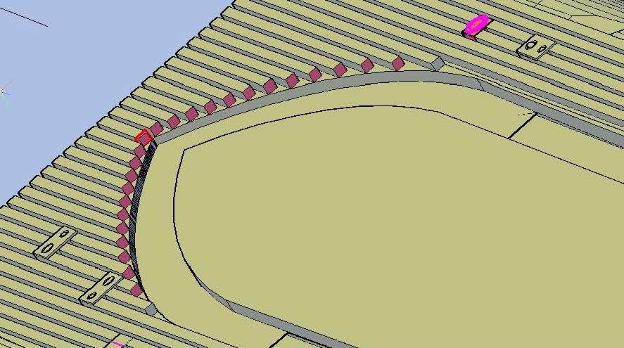

                              At this point I decided that I needed to cut the points off of the battens around the fairwater, because they too are too pointy to print. Besides that is the way they are cut on the real ship. To do this I drew a rectangle to encapsulate one batten, and copied it to the correct locations on the other battens. I started with the starboard side on the aft end.
                              These rectangles were extruded forward and subtracted.
                              I did the port side the same way.
                              I did the aft end all at once.
                              I think it looks a lot better, and I know it will print better.

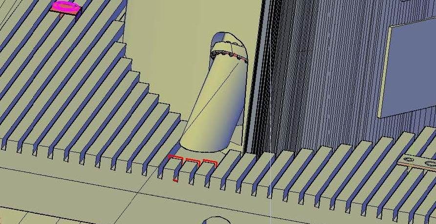

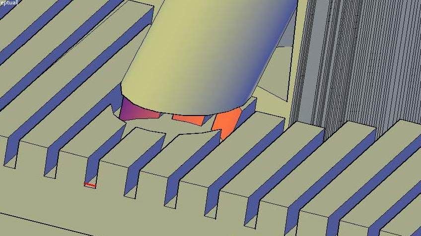

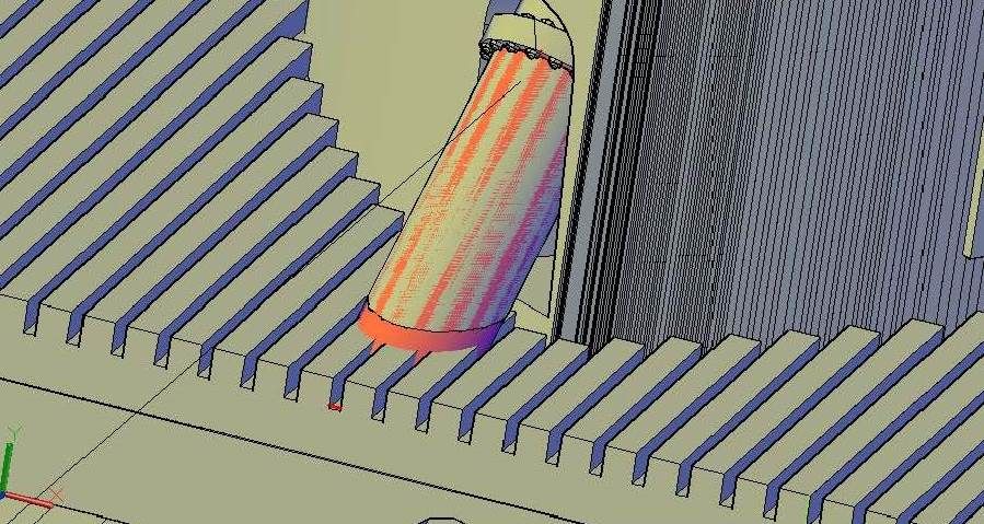

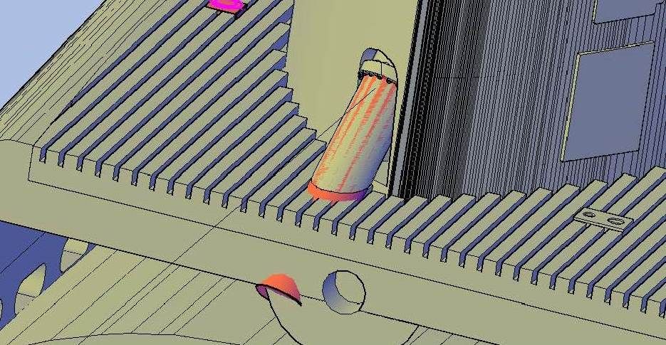

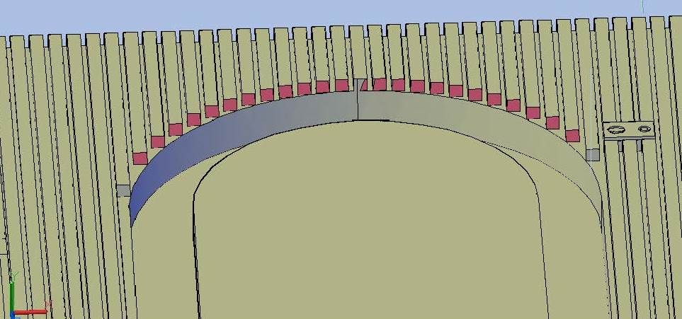

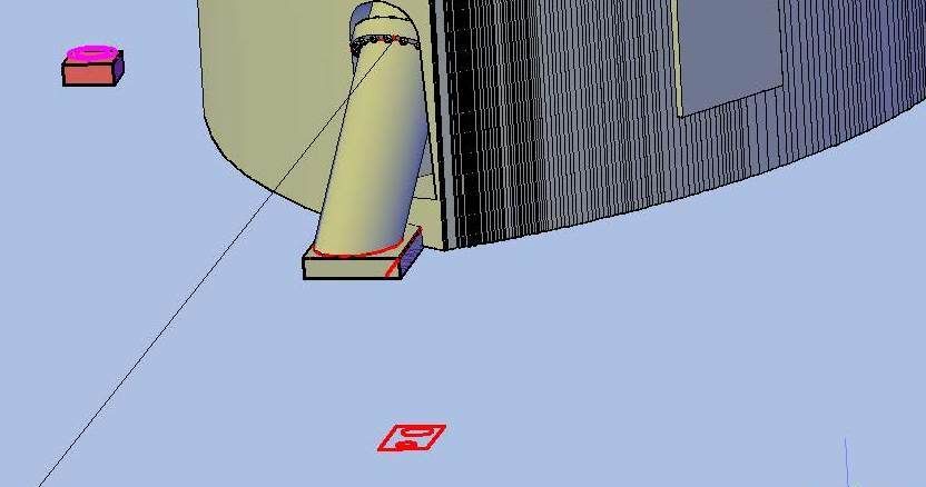

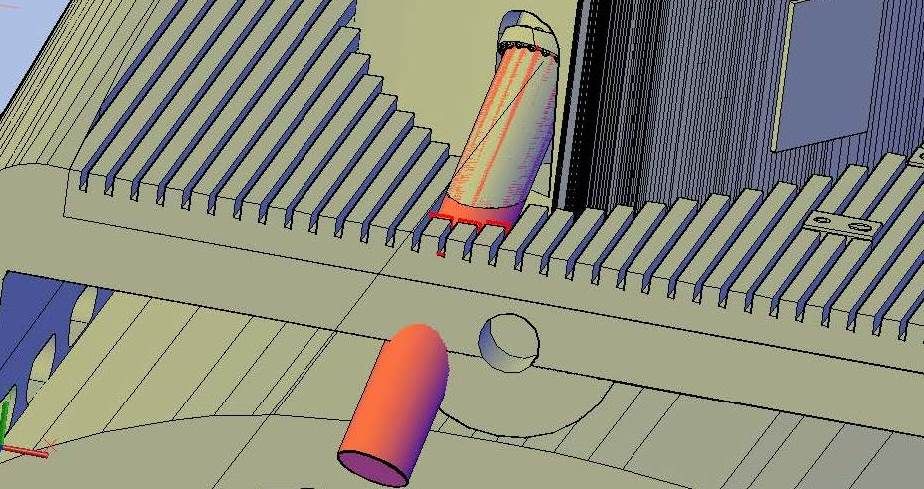

                              Next, I turned my attention to the ventilation induction line that was left high and dry by the deck mod. I started by aligning my coordinate system with the flange, drew a circle and extruded it.
                              I then sliced it at the bottom of the battens…
                              …And subtracted it from the deck.
                              Next I removed the battens between the pipe and the bulkhead in the same fashion that I removed the battens in the fairwater space.
                              This really left the pipe high and dry.
                              I re-extruded the pipe circle…
                              …And again sliced it off at the bottom of the battens.
                              At this point I considered making the ventilation induction line a separate piece, but instead decided to keep it part of the fairwater, but provided some support for the bottom of the pipe. I did this with a rectangle the same size as the area between the uncut battens, extruded down from the bottom of the pipe. This extruded rectangle was added to the bottom of the pipe…
                              …And subtracted from the deck.
                              In the following image, I colored the fairwater yellow so the match could be seen. Note that the extension should slide right in place so that the top of it will be right at the level of the bottom of the battens.
                              CHEERS!!!

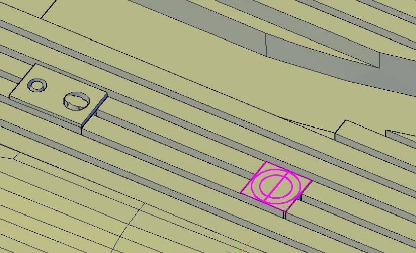

                                #285

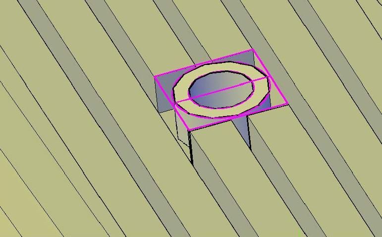

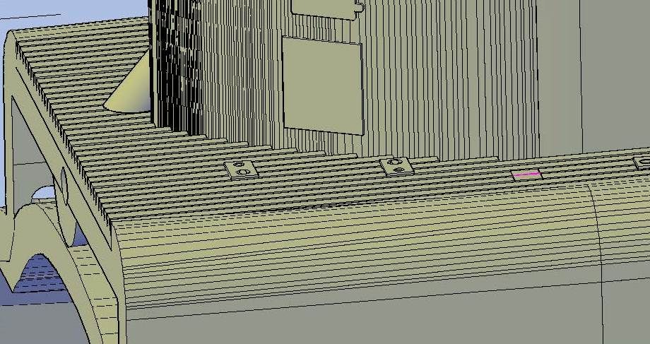

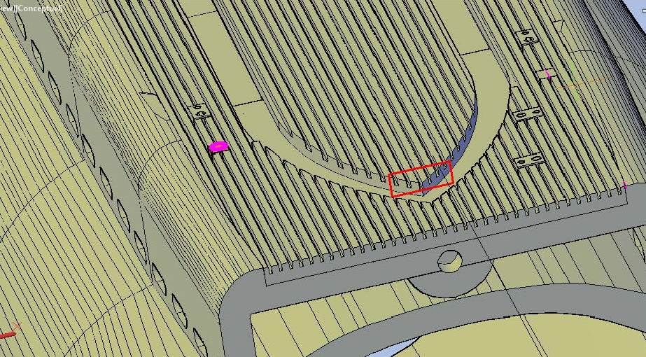

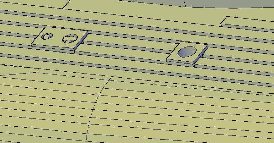

                                UPDATE 109
                                Hi again guys!
                                This is a short and sweet update as I just decided how to do the 10# stop valves, and not only were they easy to make, but there are only four of them on the Part 4 deck. The image below shows the design I settled on. It is the rectangle outline I defined earlier, extruded 0.004”. The diameter of the circle is from the plans and it is extruded to the bottom of the battens.
                                The process is to join the plate to the deck, then subtract the extruded circle. The following images show it on the part.
                                This last image shows what I think is the stop valve and AS (middle one) seen in the picture in my last post.
