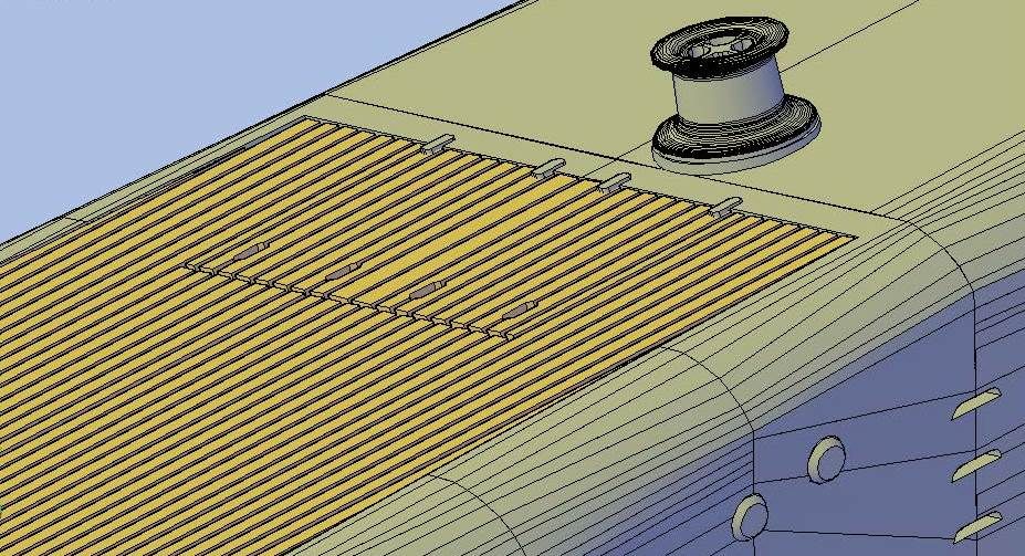

      Last night I was going to start on the decking for Part 3, but got detoured to some issues I noticed on the Part 2 decking.
      First, I forgot to ass the davit hole (?) just aft of the forward hatch on the starboard side. The image below shows the guidelines I prepared to remedy this, including two circles and a rectangle.
      I extruded the rectangle…
      …And subtracted it.

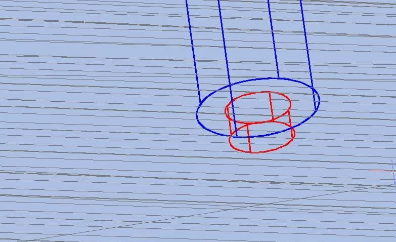

      I next extruded the circle through the deck down into the hull (layer turned off in images).
      Next I extruded the small circle down quite a ways…
      …And subtracted it from the larger extruded circle.
      I should perhaps say that the circles have radii of 0.015” and 0.025” so that the wall thickness is 0.005”. I think this will print, but the collar probably won’t be durable enough to survive the cleaning process. The hole should survive OK though.

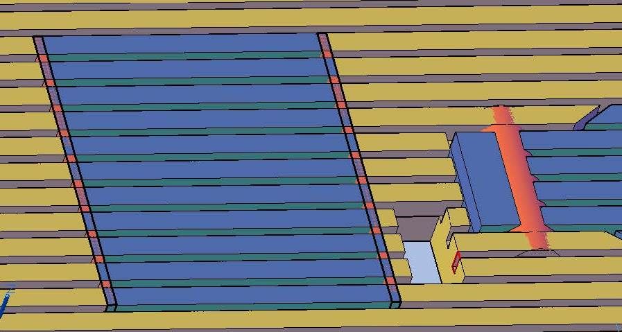

      The next thing I did was slice a groove perpendicular to the slats for the aft edge of the hatches.
      I then added hinges using a rectangle filleted at 0.005”, extruded into the deck.
      The resulting solid was copied to the other locations seen in Tom’s pic.
      The 4 hinges were then joined to the deck.
      I think this is better as it makes the hatches stand out a bit more from the rest of the deck.

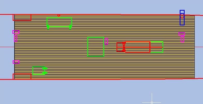

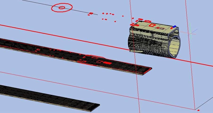

              As I had already copied the tracings of significant objects to the wood deck template, the first thing I did was copy Part 3 to the file.
              This was followed by slicing it to match the part…
              …Then extruding the wood deck outline through it (I guess I could have done this just once for the whole template, but oh well)…
              ...And using the Intersect command to create the Part 3 wooden deck.

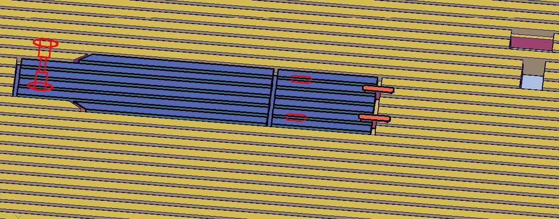

              The image below shows the various items on the deck (some mislocated as it turned out, but more on that later). The salvage air (SA) plates (thanks again Scott) are magenta the toroidal hydrophone is blue, various access hatches are green and the torpedo loading skid is in red (as are the cleat base outlines.

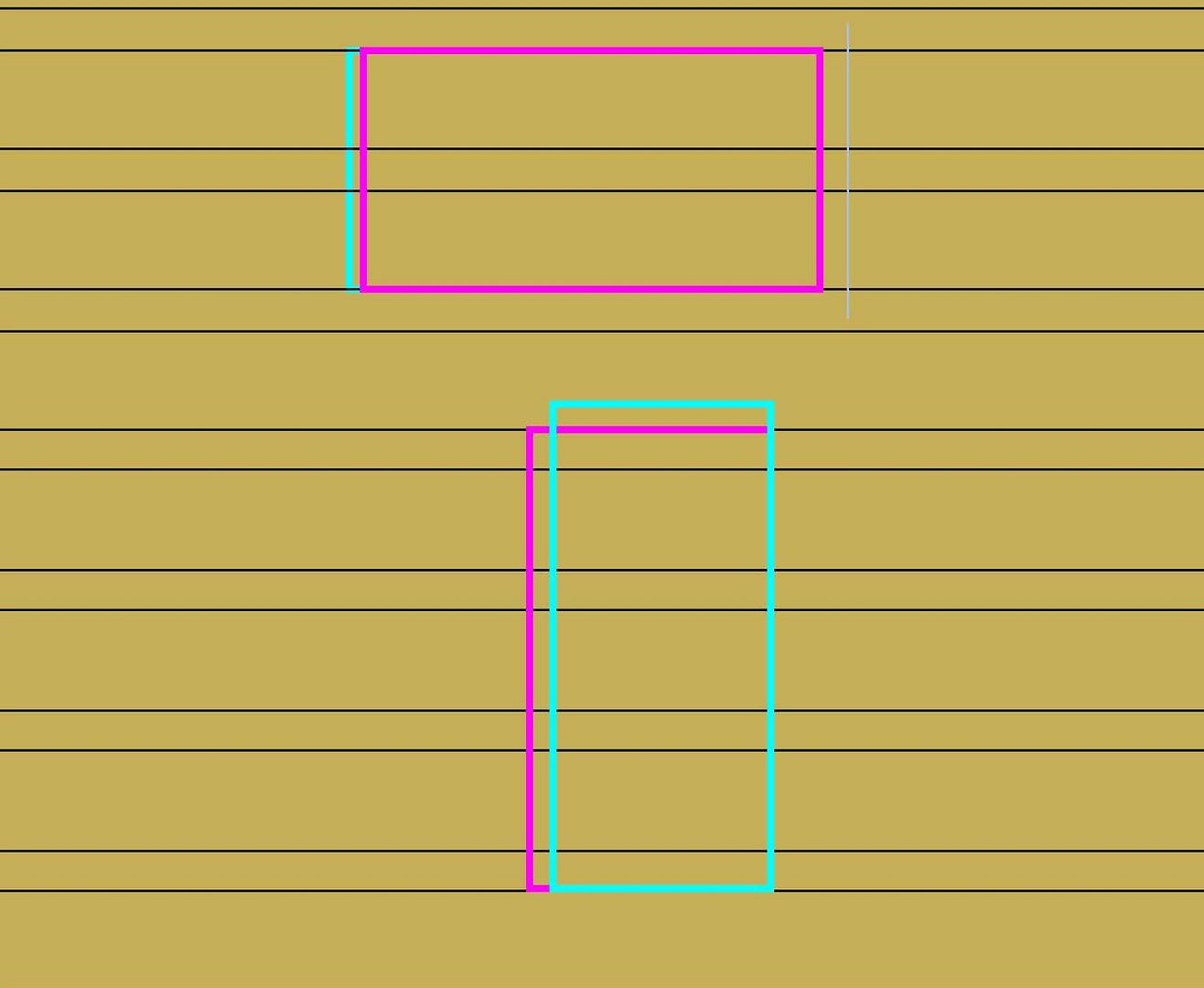

              Two of the SA’s are shown below. The bottom one is as traced, the top one was stretched to match the battens.
              In the image below, I have copied the top one down, rotated it, and stretched it to match the battens (magenta). The original tracing is cyan.
              In the next image (perhaps a little confusing) the cyan outline on top is the magenta outline on the bottom that has been copied and rotated. This outline will be used for all the SA’s on the ship as it will fit with the battens no matter how it is aligned. This is modeler’s license at its finest. )

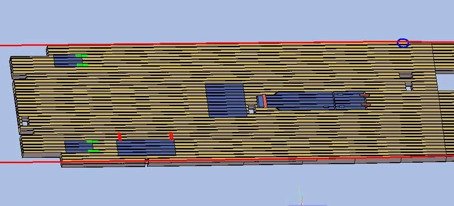

              Next I extruded all of the outlines through the deck…
              …And subtracted them.

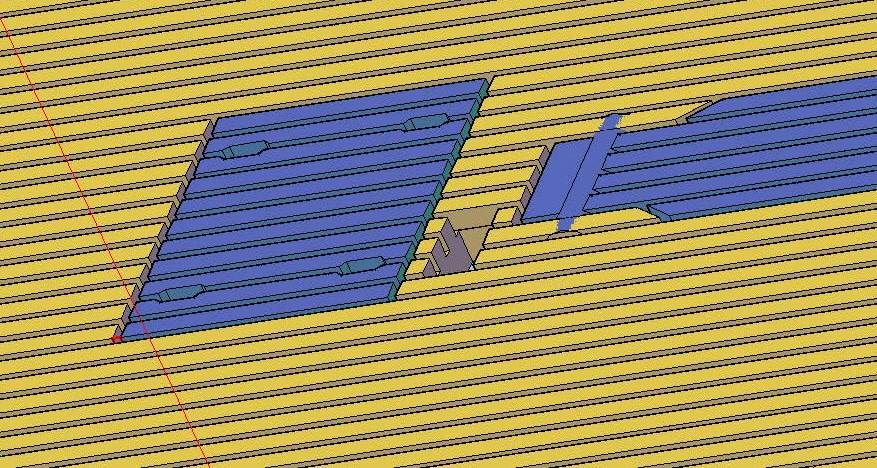

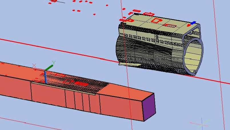

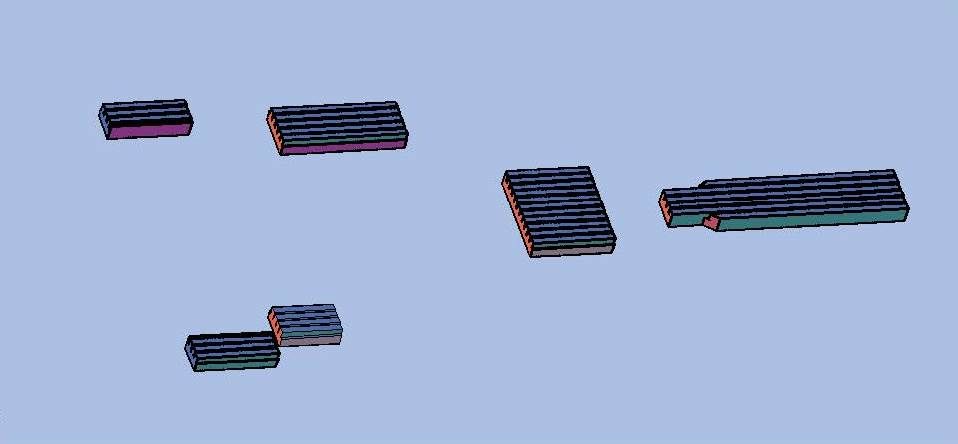

              Next I copied the uncut Part 3 template (which I had copied to the side) over the top of the cut one…
              …And subtracted the cut one from the uncut one to make the cutouts in 2 easy steps.
              I then separated the items and deleted all but the hatches and torpedo loading skid (I forgot to delete the cleat base outline).
              Next, I moved the cutouts back to the wood deck…

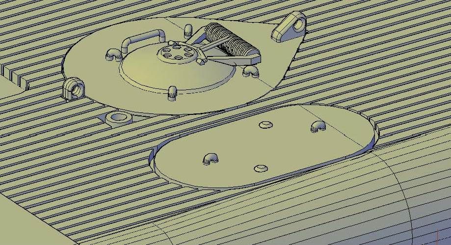

              …And started detailing the skid and “Hatch No. 1”, first cutting a 0.008” slice out of the forward end of the hatch, and then preparing to add the hinge. The one on the top right was copied from the wildcat access hatch and it was too small, so I made it longer (lower left).
              I extruded the long one…
              …And copied it to the other side.

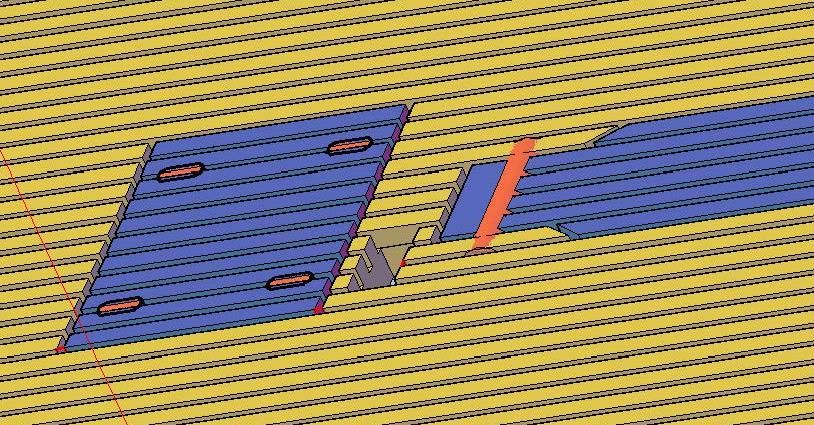

              Next I copied a handle hole outline, again from the wildcat access hatch to the proper position on the hatch and copied it to the other side. I also cut a 0.008” slot between the skid and hatch and along the angled lines and aft end of the skid…
              …Then extruded and subtracted the handle holes.
              Next, I added the skid hinge by first extruding a circle…
              …Then lowering the circle into the deck until it was just above the surface.
              At this point I realized that I had incorrectly located a few items. They were mirror images of where they should have been. The reason for this I think was that I was looking at the drawing from the underside. I discovered this because the frigging letters were bass-ackwards. So I had to redo a lot of what I had just done. In the image below, the outlines for hatches 2 (right) and 3 (left) have been extruded.
              Fortunately, I didn’t have to move the remaining hatch, instead I had to mirror it because hatches 4 and 5 are the same. The image below shows everything corrected and the cleat notches removed.
              The image below shows the 0.008” wide extrusions along the forward and aft edges of the No. 2 hatch over the battery cell to better define it. Note that I also slightly changed the hinge area of the skid.
              The extrusions were subtracted and handle holes were prepared…
              …And subtracted from the hatch.
              This process was repeated for hatches 3, 4, and 5, and hinges were added to them. On hatches 4 and 5 you can see that my seat of the pants design of the hinge closely matches the tracings from the plans (green).

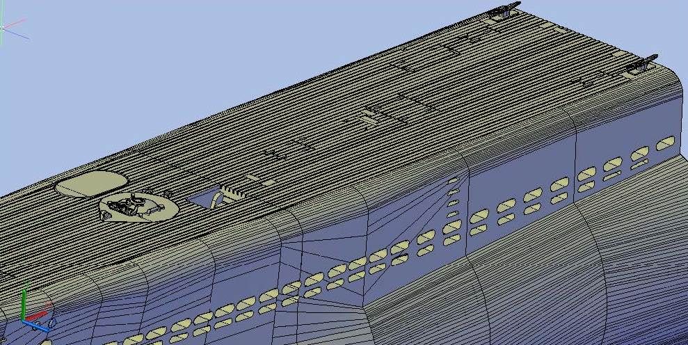

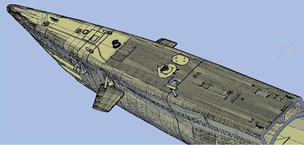

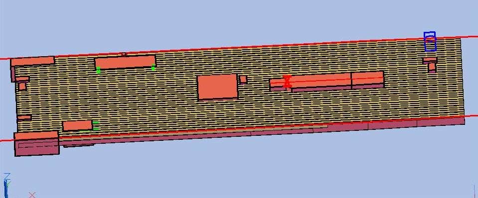

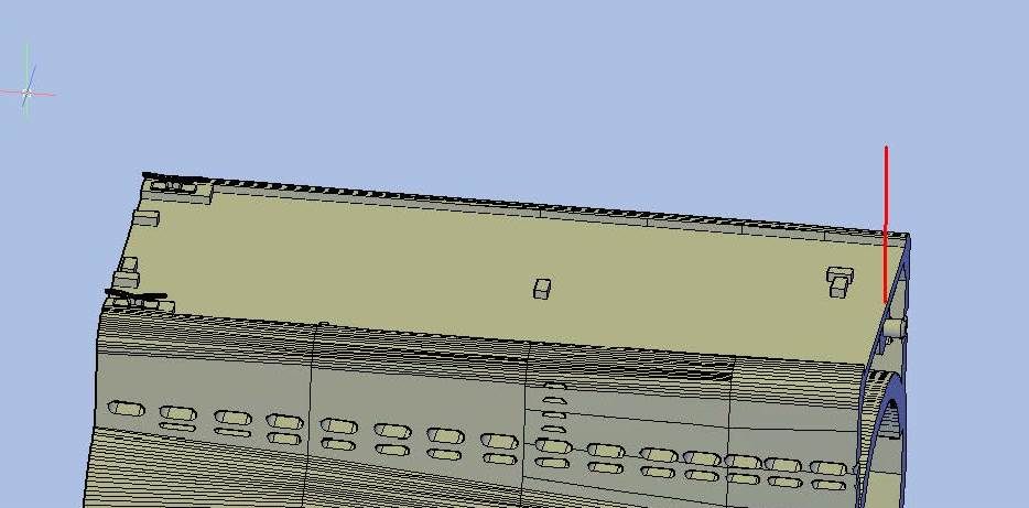

              With the detailing work mostly completed, I copied the whole thing to the part.
              As with part 2, the deck had to be rotated for alignment due to the slope of the deck. And as before after the wood deck was aligned with the part deck, I moved it up, then lowered it in small increments into the hull subtracting it as I went. The image below shows the deck cutout without the wooden deck in place. Note that the SA’s and cleat bases are high and dry to the cuts I made in the wood deck.
              The image below shows the wood deck in place.
              The last image shows it joined to the part.
              I should point out that although I have attached the wood deck to the part, I am saving the parts in a separate file prior to joining them. The reason I am doing this is because I am thinking that I might need to make all or part of the deck separate parts to avoid having distinct seam lines where the parts join. More on this later.

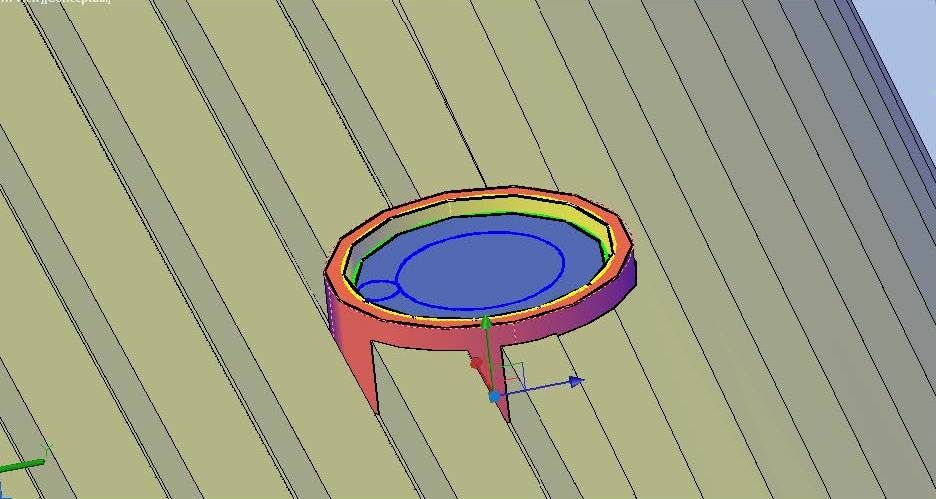

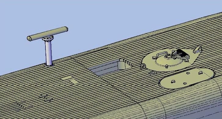

                You may have noticed that I didn’t do anything with the outline for the toroidal hydrophone. That is because I wanted it to be square to the world and not the sloped hull. I don’t know why. I just did. Anyway, I had 2 pictures that I used for this, the post part that I took on Batfish…
                …And one Scott sent me.
                The image below shows the hydrophone tracings on the model.
                I started by moving the circle up and extruding it into the deck.
                Since the hydrophone will be a separate part, I made an attachment point for it.
                I joined the attachment point to the extruded circle and subtracted them.

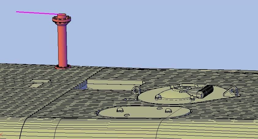

                Having made the female connection, I next made the male part. The male connector has a diameter that is 95% of the female diameter. The lower part of the post has a diameter 98% of the cutout diameter.
                The image below shows the lower part of the post.
                I subtracted an extruded circle from the base post leaving 0.005” diameter “walls”. The smaller blue circle in the image below has a radius of 0.005”. It will be used to locate and size the nuts and bolts. The larger blue circle has a radius of 0.02”. It will become the post.
                The picture shows there to be 8 bolts, so that’s how many I added.
                I’m not sure how tall the post is in real life, but it is about the same height as the fence which I would guess is 2-1/2’ to 3’ tall, probably closer to the latter, so I made mine 3’ tall, or 0.25” on the model.
                I didn’t document it very well but I next added a collar, a flange and 10 nuts and bolts, with the bolt heads on top and the nuts on the bottom. There appear to be 12 in the picture, but I tried 12 and it looked to crowded, so I went with 10.

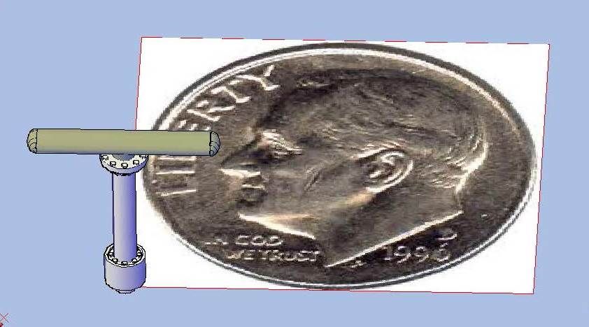

                I didn’t document making the business end of the hydrophone either. I get on a roll, and forget to stop to take screen shots. Anyway, I made it with an extruded ellipse, with sliced ellipses of the same size revolved to make the ends.
                The image below shows the part removed from the model.
                Lest we forget what size we are talking about, here’s the hydrophone with the scaled dime.

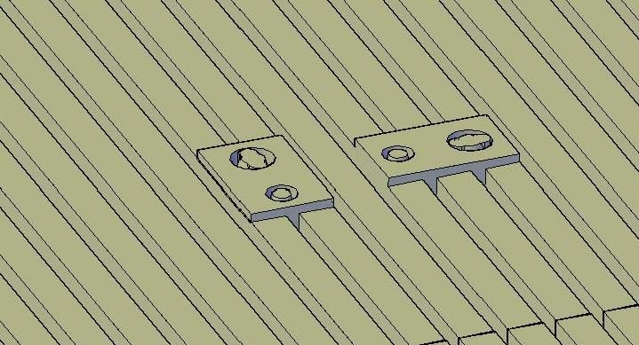

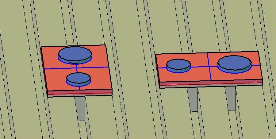

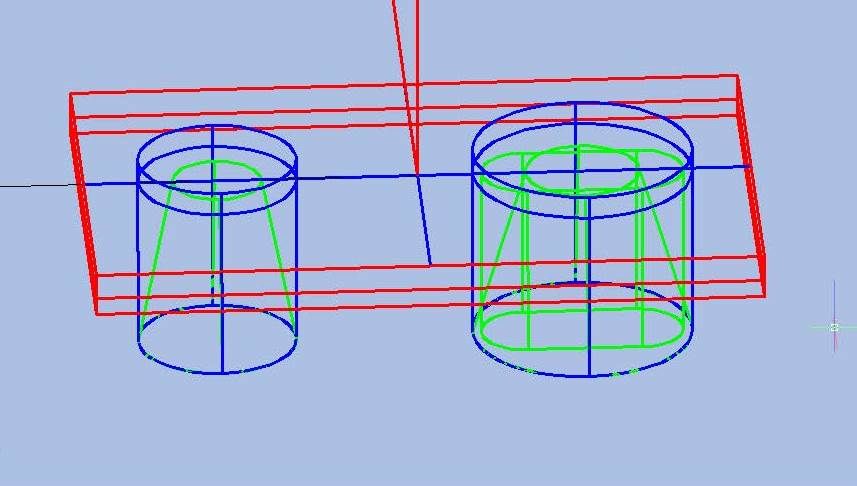

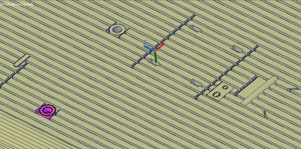

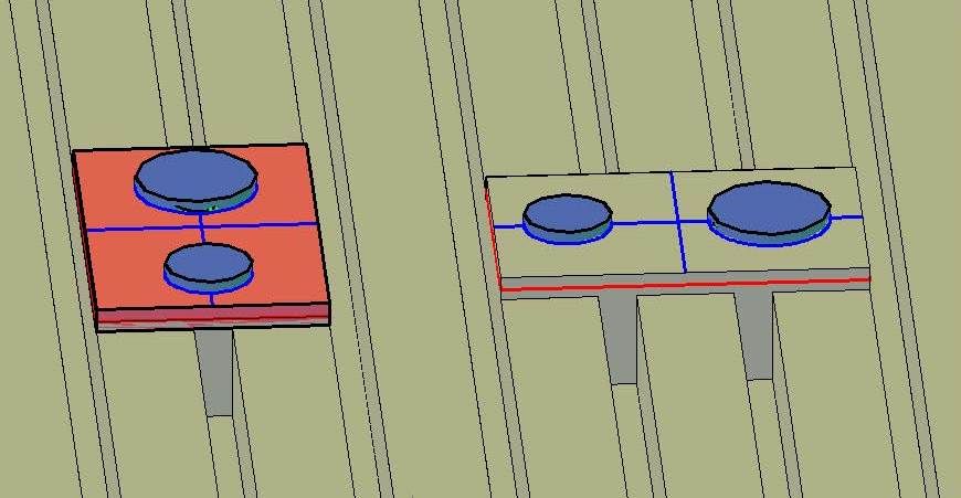

                            Anyway turning to the design of the SA’s the image below shows the way I did it. The red extruded rectangle is a 0.002” plate. At 0.002” it will barely be noticeable and will essentially be level with the deck. The blue cylinders will be cut out after the plate is joined to the deck. The green is a very crude replication of the connection and valve stem extension. The smallest circle used is 0.005” for the valve stem extension. To give it more support I made it cone shaped. I did the same for the connection and added wings in the form of connected 0.005” circles. The outline of this feature is best seen at the bottom.
                            Here is what the assembly (that I copied to a reference point) looks like in solid form…
                            …And with the cylinders subtracted.
                            Here it is on the model.
                            …And copied to the other position. Note that I didn’t just copy it, rather I used the blue lines to orient a coordinate system and copied it using the clip board and a base point that I selected as the intersection of the lines. Then I realigned my coordinate system to the blue lines where I want to copy it to, and again used the clipboard to paste it.

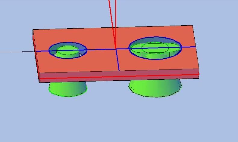

                            After copying it, I first joined the plate (red) to the deck…
                            …Then subtracted the circle…
                            …And joined the inner workings to the part.
                            This process was repeated for all of the SA’s on the part.

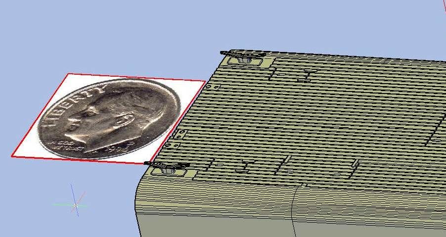

                            Here it is with the dime.

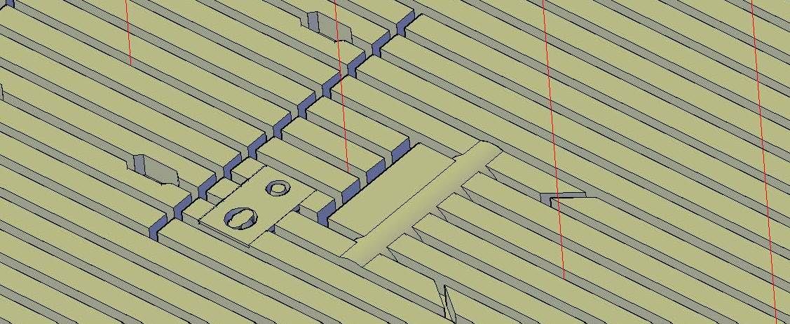

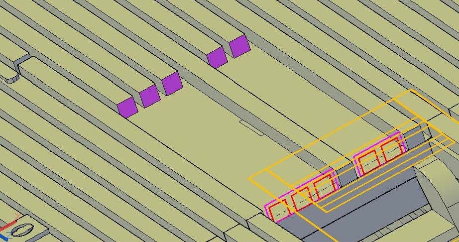

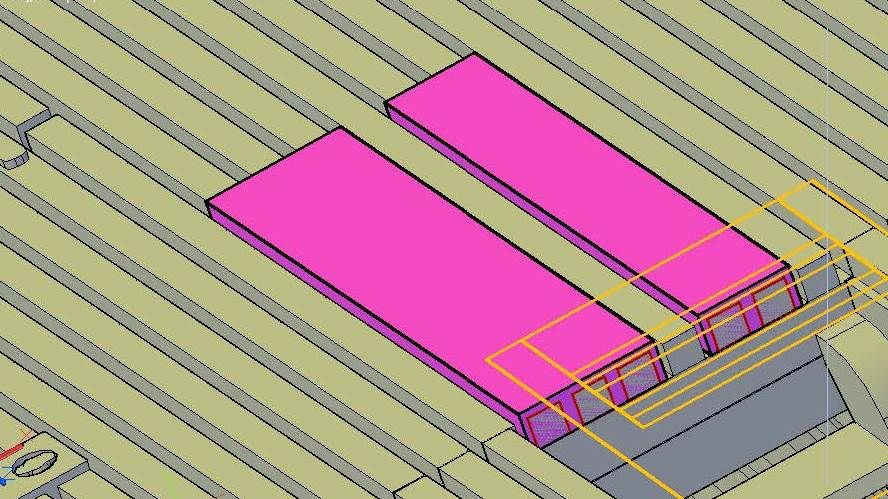

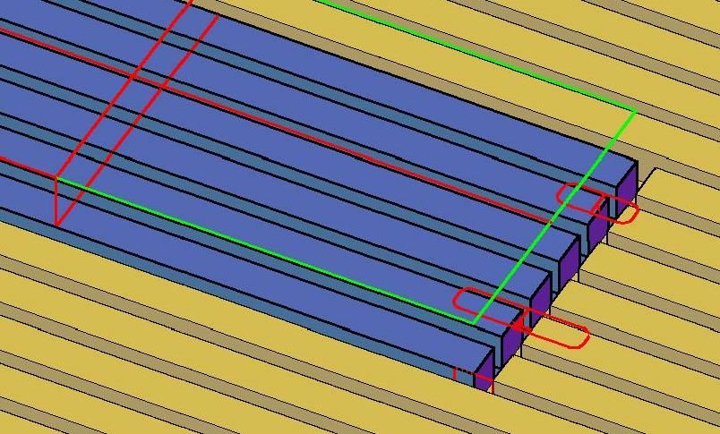

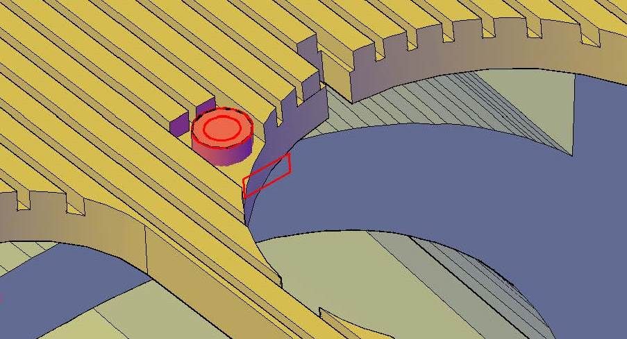

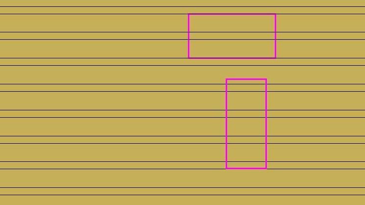

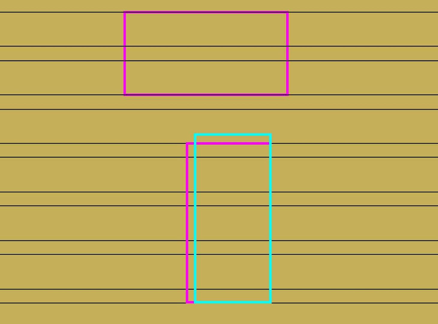

                              First I repaired the area where I removed the mis-located AS, starting by drawing a couple of polylines and extruding them.
                              I then moved them forward slightly to make sure the ends were removed…
                              …And subtracted them from the deck.
                              Next I extruded existing square batten sections that I had previously drawn…
                              …And joined them to the deck, which did the trick.

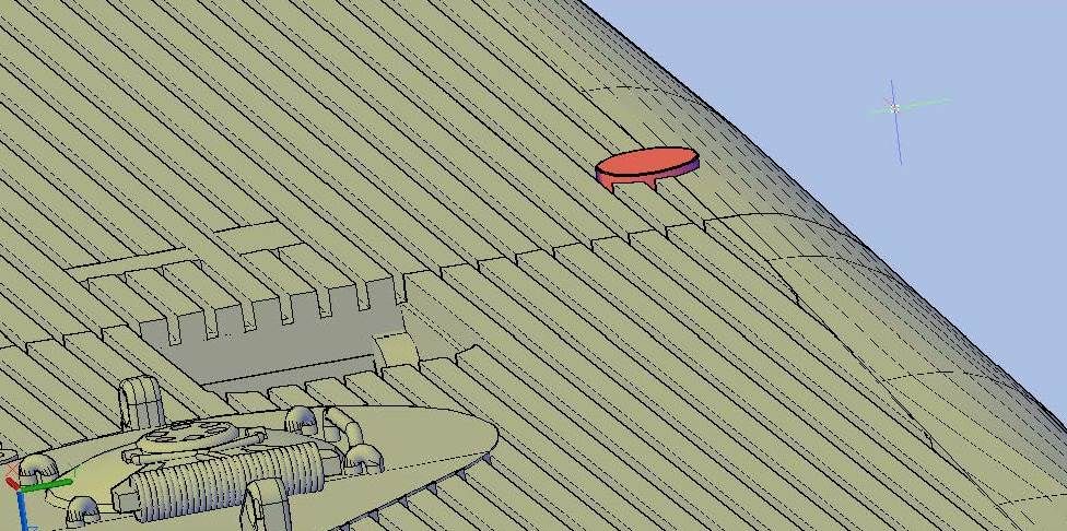

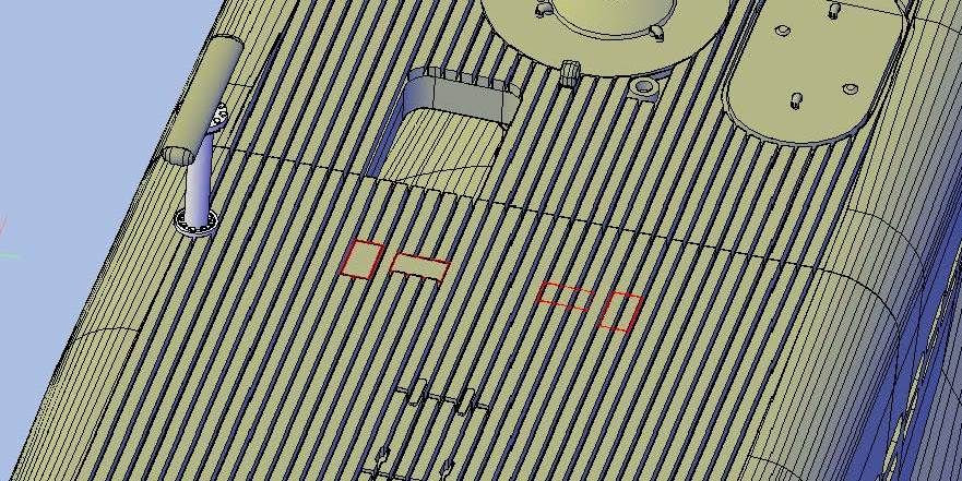

                              The next touch up I did was to add an AS aft of the skid hinge that I had missed.

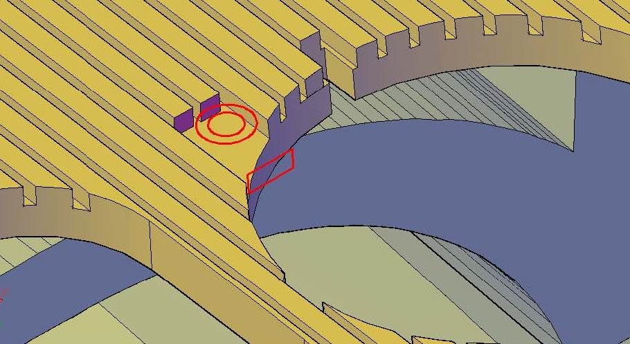

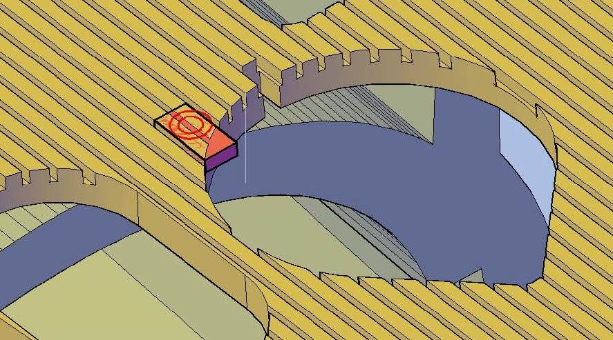

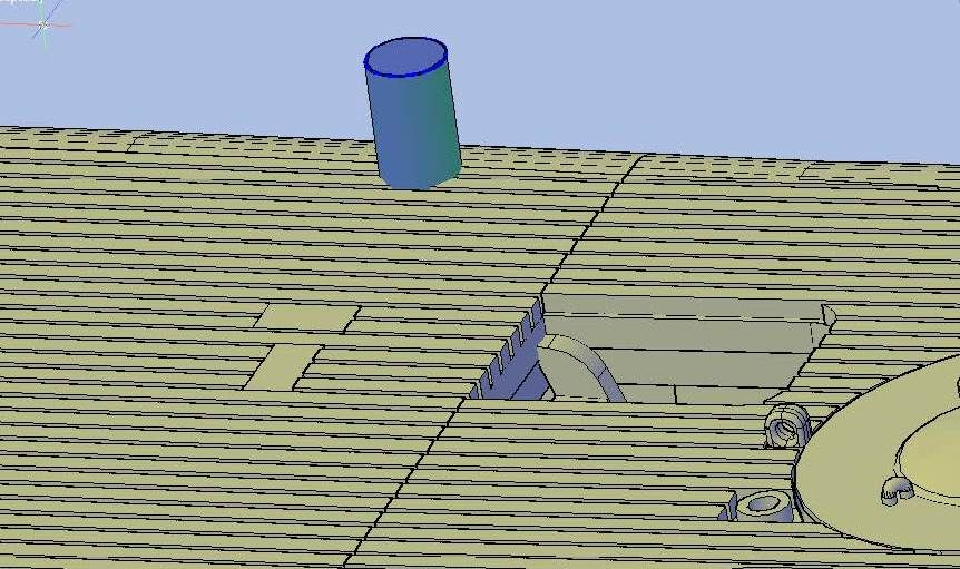

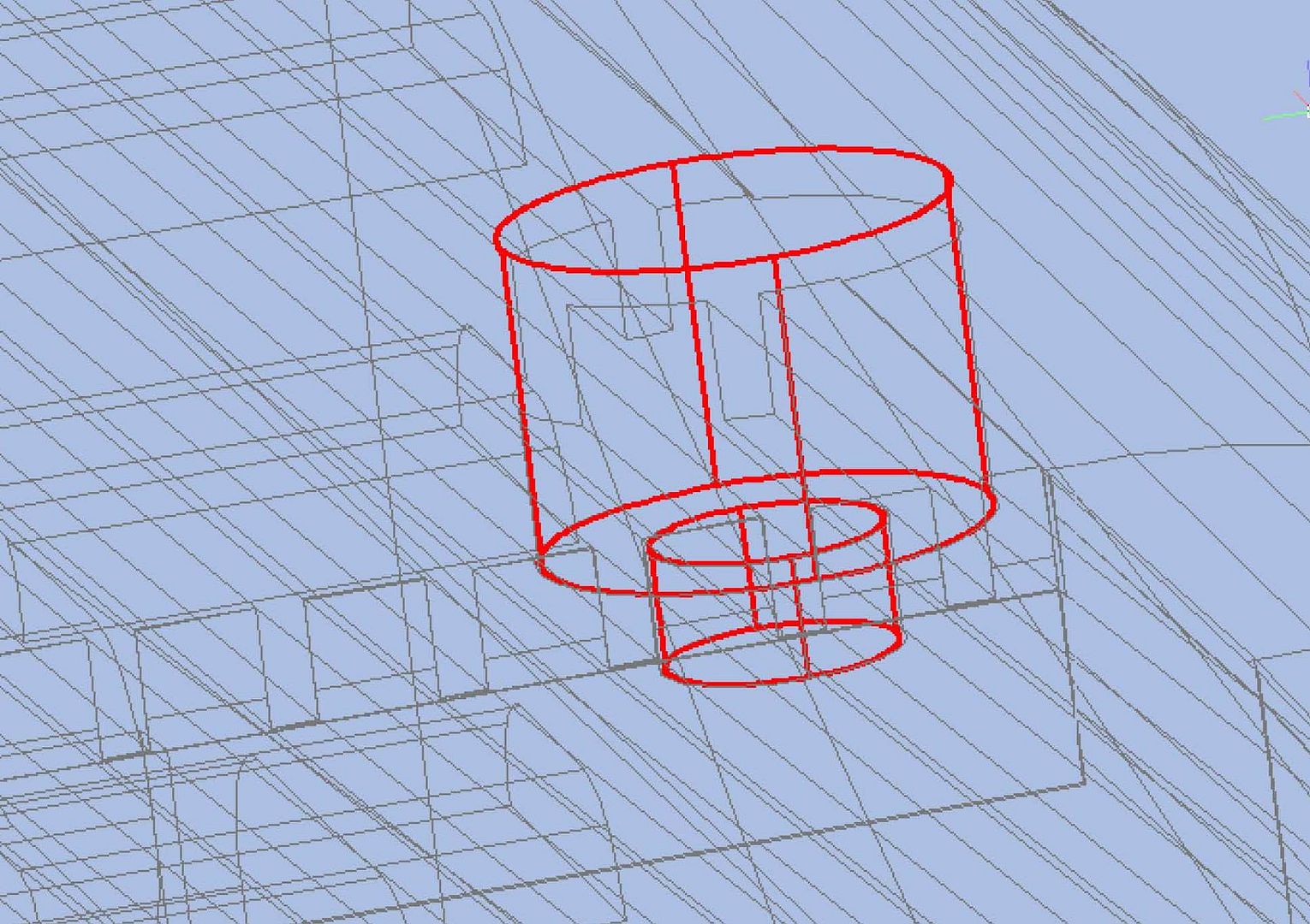

                              Looking at the wood deck plans again, I realized that I had missed a davit socket aft of Hatch No. 2 and a Kingpost on the starboard side. To make these, I used the outlines I had previously drawn for the davit socket aft of the forward escape hatch. I copied it to the proper location and then prepared to cut out the wood deck around it. To do this I drew a rectangle on the cut end (because it is easier to assure proper alignment of the section), and copied it to the forward and aft sides of the socket.
                              I then lofted between them…
                              …And subtracted it.
                              I then did essentially the same thing for the Kingpost.

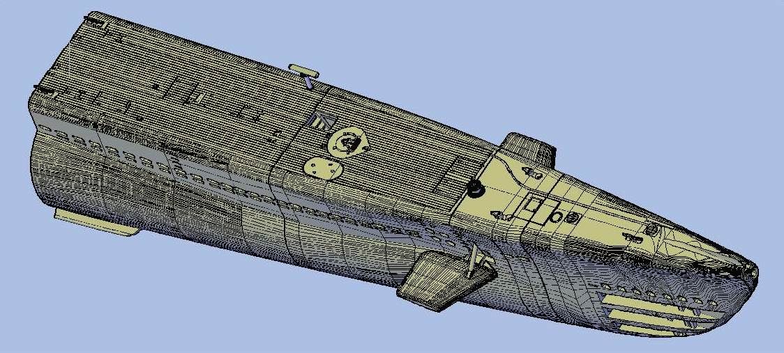

                              At this point, I believe that the first 3 hull pieces are completed, unless I decide to make the deck, or parts of it separate, which I think I will probably do. For now anyway, they are completed, and here are a couple of images of them.
