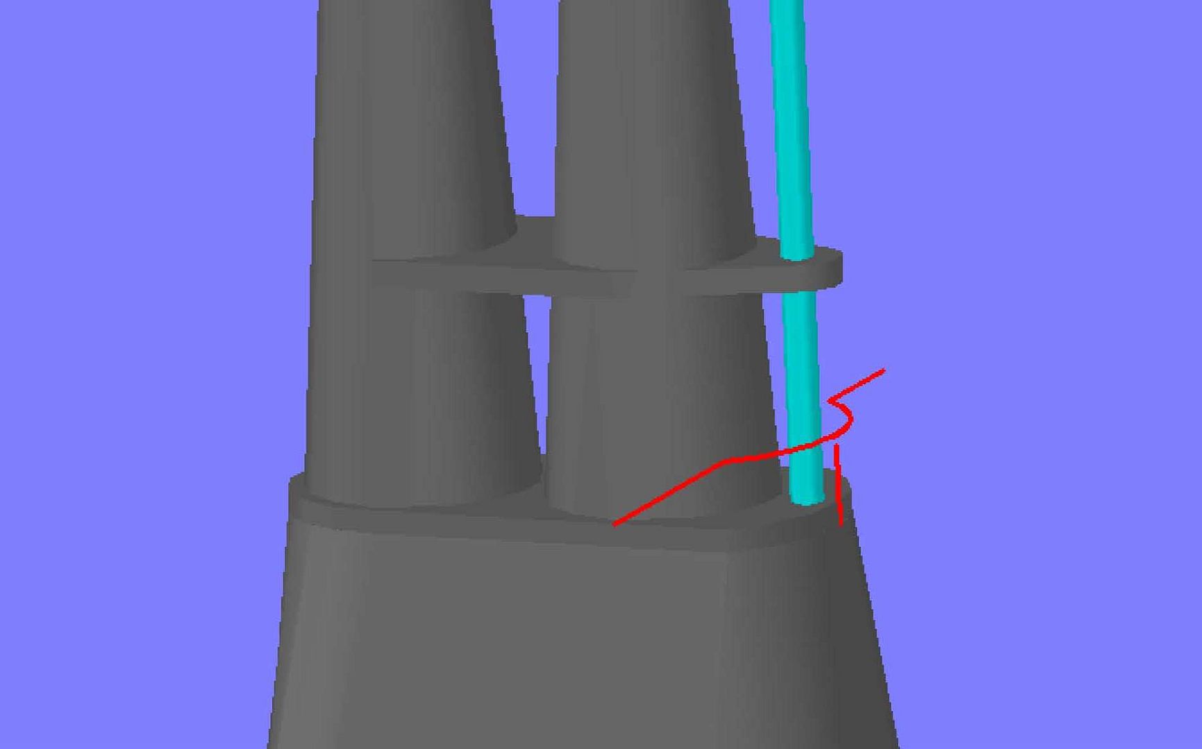

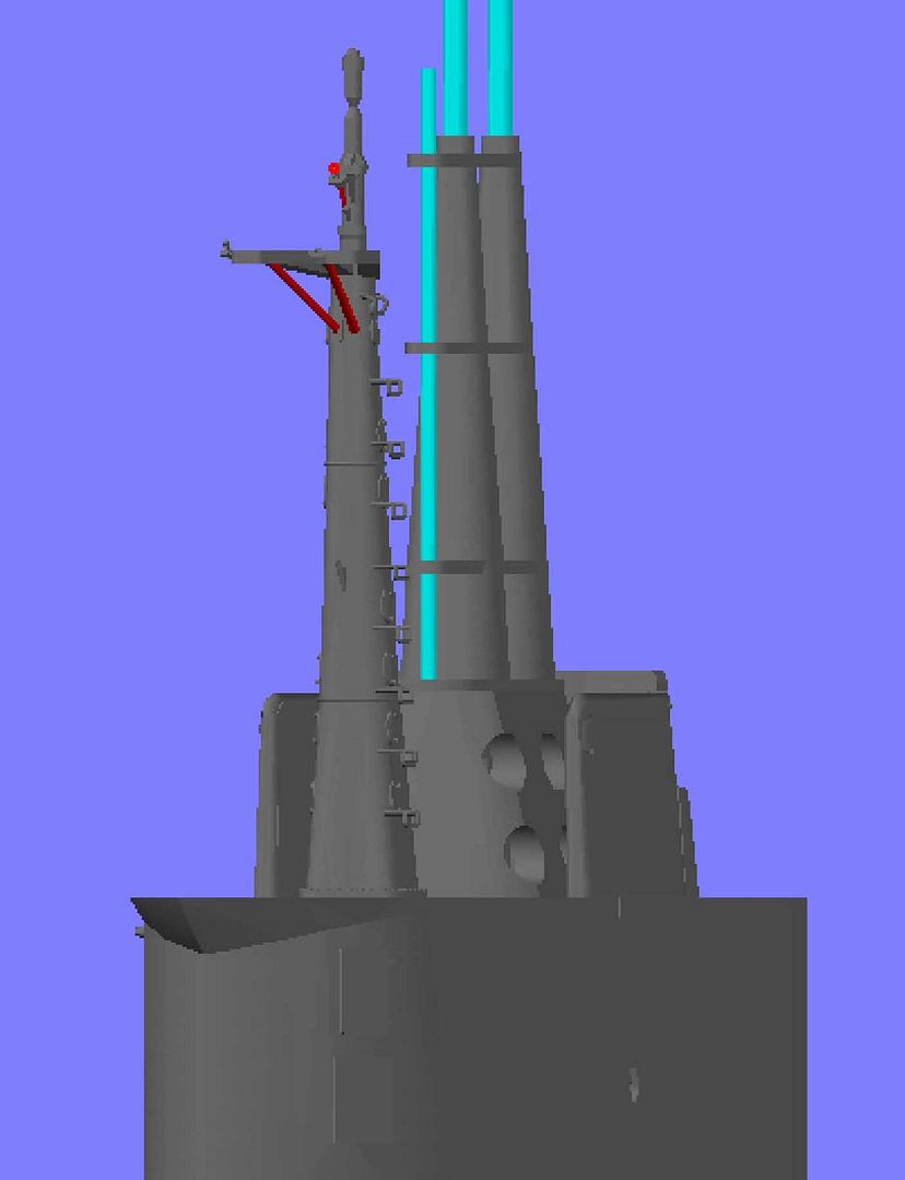

      Well Scott, I don’t know if the method you describe would be any easier or not. Raised weld lines are about as simple as it gets, because it is easy to do a project geometry command to put the outline on the surface. This creates, as you probably know, a spline that you can loft any shape along. When I was working on Greenling, I tried various shapes and found that circles worked the best. Plates, or other surfaces, that protruded from a curved surface, or are recessed into it, are not so easy, because no matter how hard I try, I cannot extrude or loft splines to form a solid. I always just get a surface, even when my spline is closed and my settings are set for a solid. I went through multiple gyrations before I stumbled on to the method I am now using.
      This just goes to show that the only thing more numerous than the different ways to accomplish a task in AutoCad is the multiple configurations of fleet boats. The SD Mast seems to be another prime example. As you guys may remember, I used the very picture that Tom last posted to do my mast design, as I posted in Update 11 on March 27, 2013. I was really happy with the design, until I started looking in detail at pictures of Batfish sent by Tom and Scott, and then it became a matter of who am I going to believe, the plans, or my lying eyes?

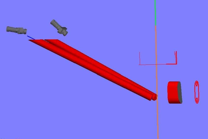

      Below are two of the pictures that prompted me to change the design., with the second one being the coup de grace. Note the weld seam. They are clearly round, as is the mast, down to the lower seam. From there it transitions from the circle to the 28” rounded square that you mentioned Tom. Interestingly though, the new design still follows the plans you posted, because the only sections provided on the plans are at the very top and very bottom. Both of my designs have the end sections shown on the plans, the only difference being that the first design transitions from a circle to the rounded square over the entire length of the mast and the new design remains a circle down to the lower weld seam and then transitions to the roundish square from there. Both are vertical on the tailing edge.

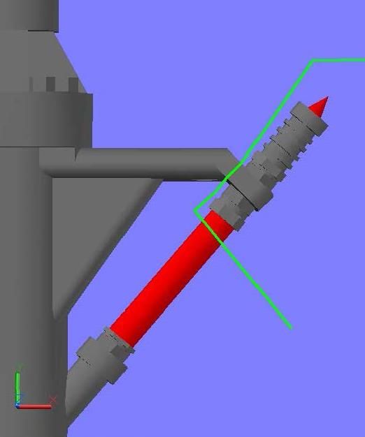

          I next worked on another unknown object and the bracket that supports it. I suspect it is some sort of directional sensor because there are similar sensors on the sides of the support platform positioned seemingly for this purpose. Maybe?
          Anyway the bracket was made using lofted traingles, rectangles and a subtracted circle. These plates are only 0.03” thick so I think they will print, but they will be delicate. I left them unattached because it may be better not to print them and add them during the build.
          Next I made the conduit and connecting hardware for the sensor, starting with the lower one, which is a combination of lofted circles and hexagons…
          …Followed by the ones on the underside of the sensor bracket…
          This was followed by the hardware on the top side of the bracket…
          …And rounding the bracket edges.
          Last, I made the sensor itself. I left it red and unattached too, because I again think that it may be best to make these pieces during the build.

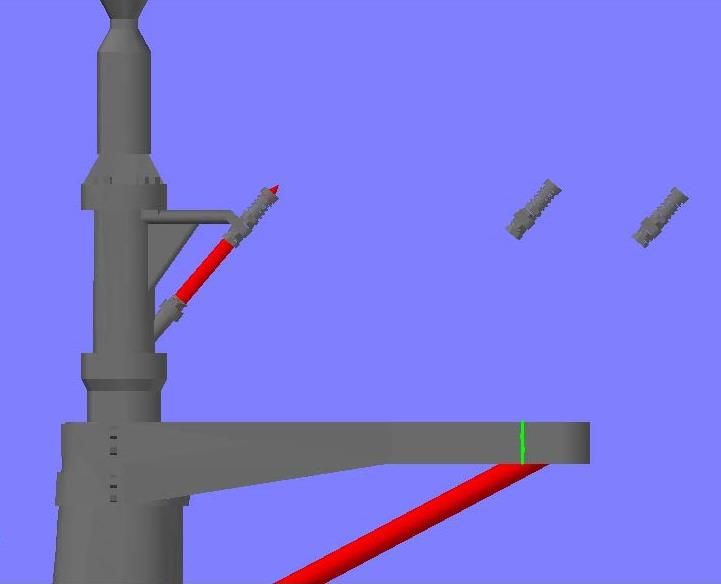

                  UPDATE 42

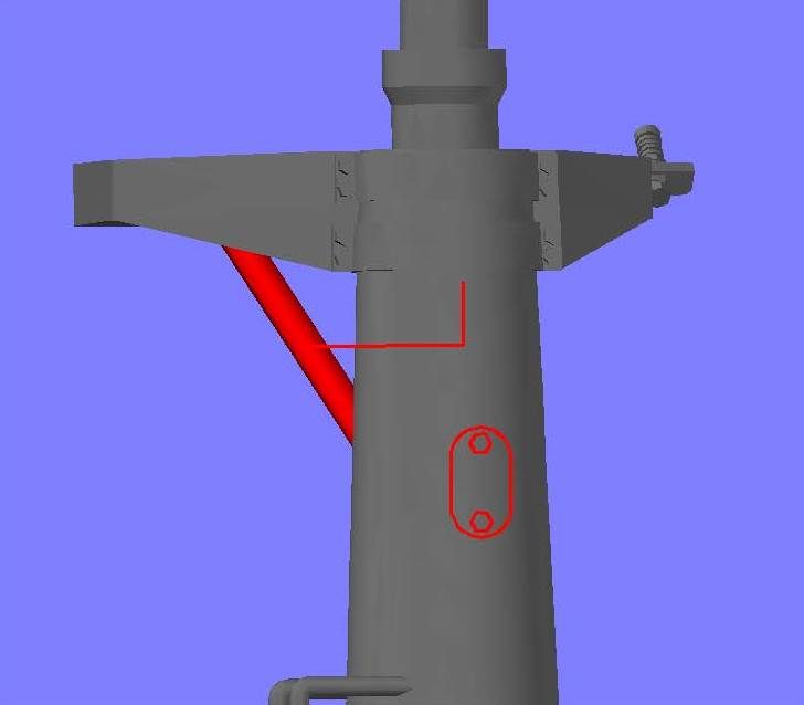

                  Thanks Tom and Scott! I appreciate both the kind words and the feedback. I think I have come to the same conclusion, if for no other reason than the fact that making some of the bends I think requires skills beyond my ability. Even if I could do it, the nature of the cabling conduit has irregularities that I couldn’t match. Plus, I think the small size makes them more suitable for stretched sprue, or thin wire.
                  So, I decided to scratch the cabling, but keep the sensors, at least for the time being. The sensors were made by slicing off the one I originally made and making two copies.
                  I then moved them to the correct locations and rotated them to more or less match the pictures. Again, they are a little big, but I think I will keep them. If they don’t come out good, or are too dominant, I can always cut them off.
                  The next thing I did was prepare to make the access plates and top grab.
                  After drawing the plate and positioning it correctly, I lofted it into the mast…
                  …And like before copied the mast to the side and used the intersect command to make the plate wedge, that I then moved out 0.06’. Note that I hadn’t attached the sensors yet.
                  I then simply moved the copied mast back in place and I had my plate, so I extruded the bolts. In actuality these would be nuts, with a bolt sticking out, and not bolt heads, but I am already at the limit of the SLA with the 0.06’ bolt heads
                  The bolts were then moved into the plate using the guidelines to leave 0.06’ sticking out.
                  Since the mast is circular at this point, rotate/copied the plate and bolt 90 degrees and then mirrored it to the other side.

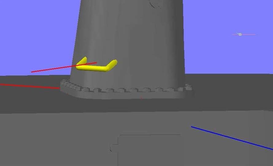

                  Next was the top most grab. I started by using the project geometry command to project the location lines I had drawn onto the mast.
                  I then opened my grab drawing and copied it to the projected line, but since the top one is bent down I rotated it until I thought it looked right. It’s not exact, but it’s pretty close.
                  This pretty much does it for the SD mast, unless of course I see something later that I missed, which is very possible. I think that the SLA should be able to print all of the details I have made, with the possible exception of the sensors and the bolts on the end of the platform bracket. I know that I will be adding the support flange and bolts to the base of the mast at some point, but I have yet to see good pictures of them and I am mostly working on vertical surfaces so far.

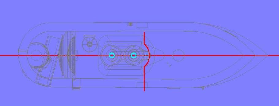

                    #114
                    UPDATE 43
                    Good afternoon everybody!

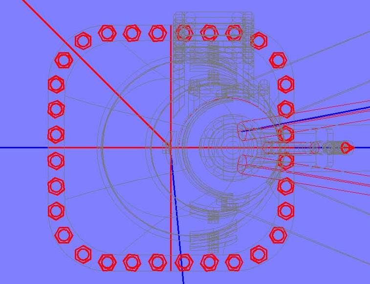

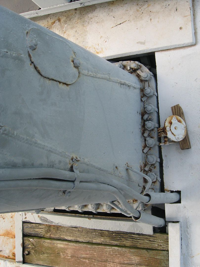

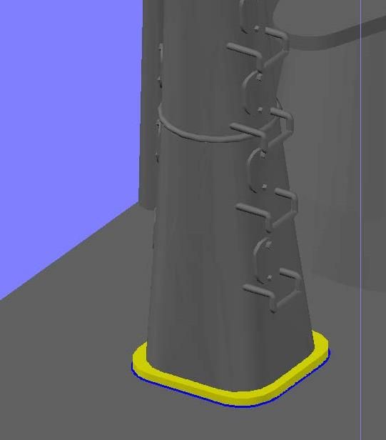

                    After my last post mentioning the support flange and bolts at the base of the mast, and my lack of pictures of the feature, Scott sent me the picture shown below, that clearly shows the flange and bolts.
                    Thanks to Scott and the great picture, I was able to add the flange and bolts to the mast. I started with the flange, and figuring that each bolt would be 0.12’ in diameter I made the flange so that each side would be 0.16’ wide.
                    Next I drew a 0.6’ circle, inscribed a hexagon in it, and lofted it.
                    With one bolt completed, I used the copy and mirror commands to make the rest of them.
                    That’s it for now - Short and sweet!

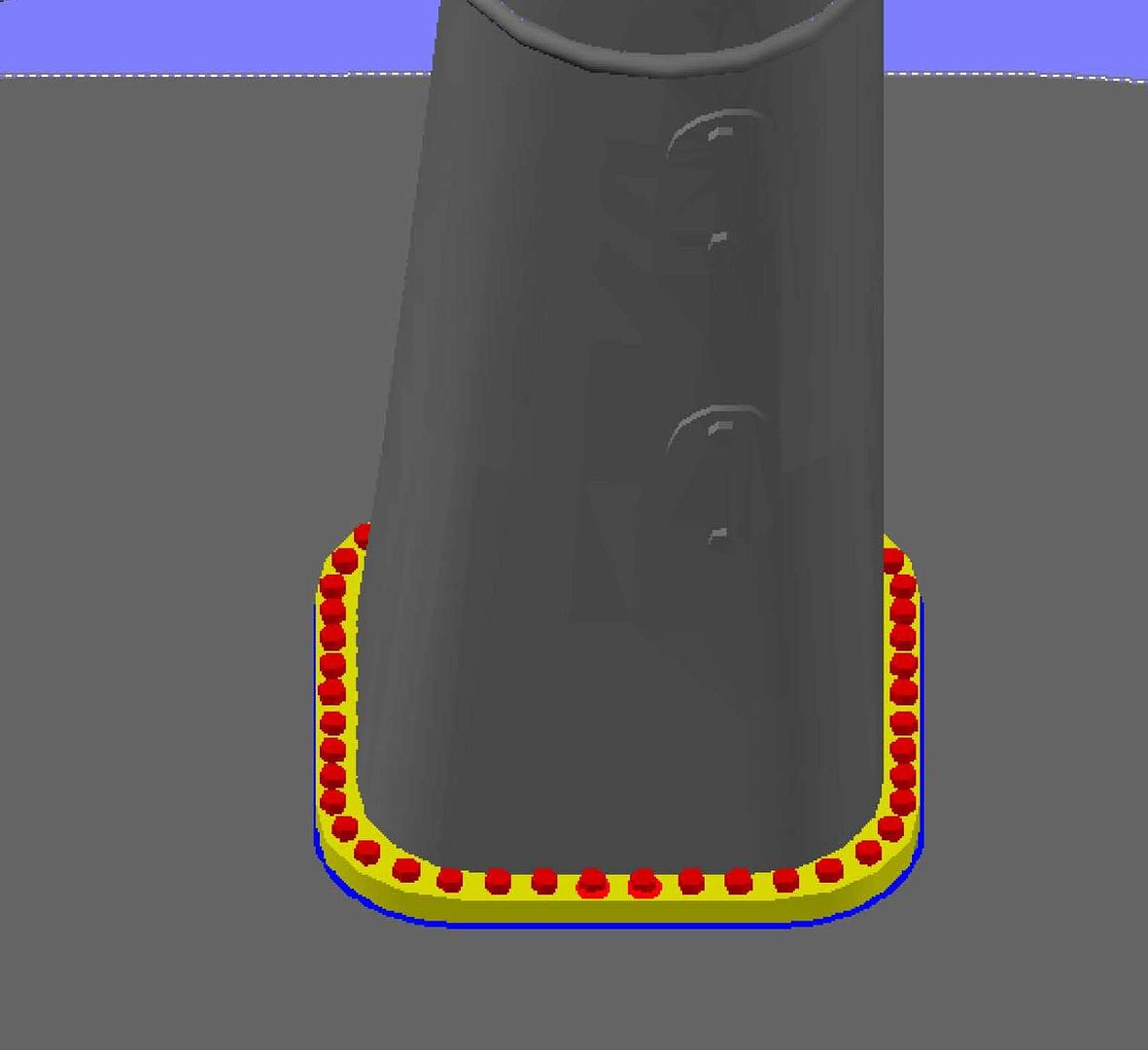

                      #115
                      I think you only need eight bolts per side. But who is counting. Of course there my be
                      more down the sides and that is the short side of the rectangle. But I think the drawing said
                      it was a square shape.
                      • rdutnell
                        • Nov 2012
                        • 388

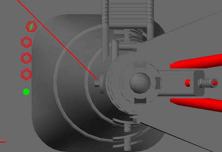

                        #116

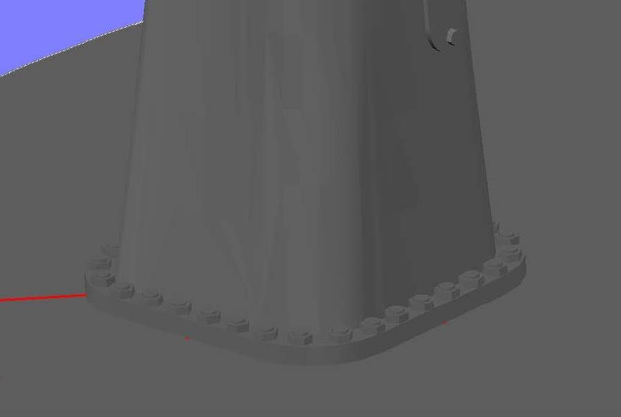

                        UPDATE 44

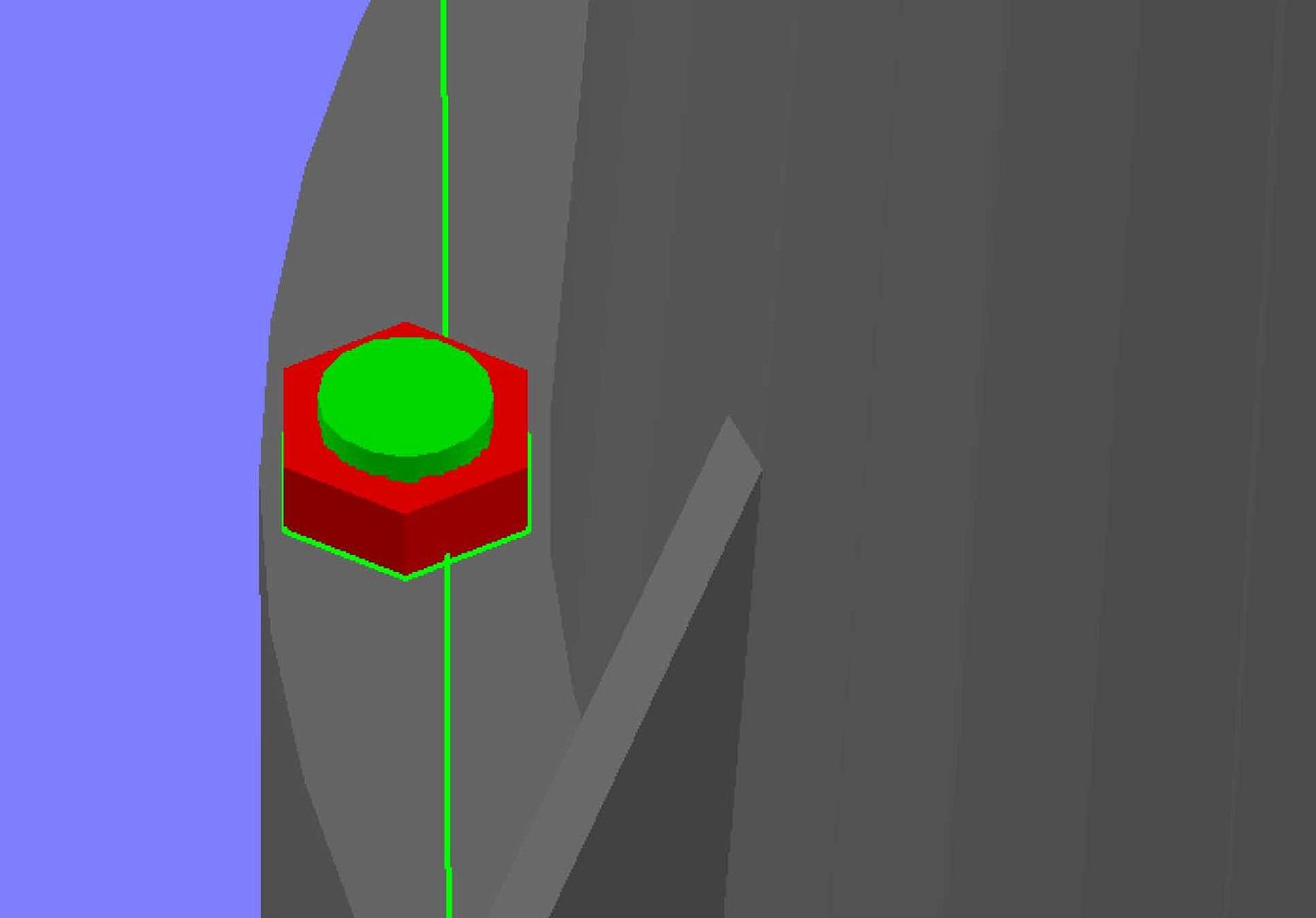

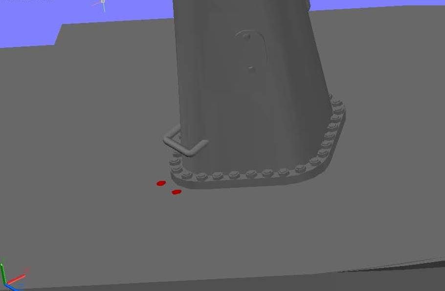

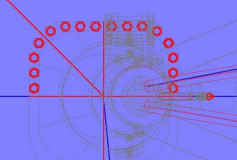

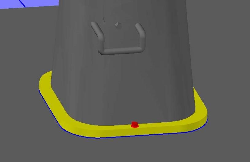

                        DOH! Maybe not so sweet. That’s what I get for trying to squeeze it in, in 30 minutes, before class. I too had counted 8 on the sides and then had a brain fart, I guess, and put 8 on the sides plus others going around the corner. Duuuhhhh!
                        Anyway, it was an easy fix. I just sliced the mast at the top and bottom of the bolts, separated the mast slice from the bolts and joined the slice to the rest of the mast again. I then deleted all but one of the bolts and started over.
                        When I say started over, I meant it, because I decided to do a combination bolt and washer to better simulate the real deal. The bolt is the minimum 0.6’ (which by the way is ~3/4”, which probably isn’t too far off what they really are. The nuts are hexagons sized to look right with respect to the bolts and to fit on the flange. Since there are 8 per side, I drew one set and then copied it 3 more times to do half of one side.
                        Because the base is in fact a rounded square, I mirrored these around a line connecting the corners of the would be square.
                        I then mirrored them again around the vertical center axis…
                        …And yet again around the horizontal center axis.
                        It looks a lot better now, for those of us that are counting Scott.

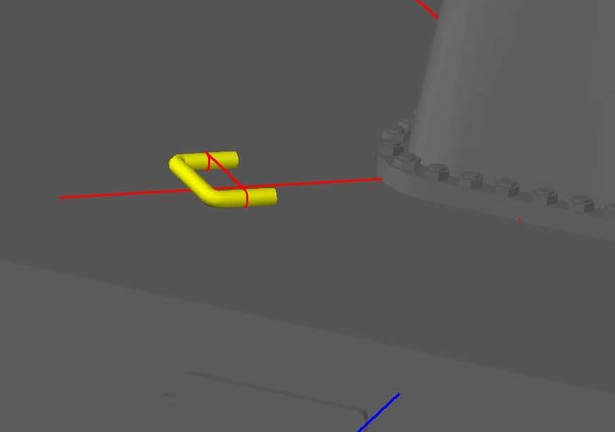

                        I don’t think I could effectively model the clips, or whatever they call those things that appear to be backups to keep the nuts from loosening, so I’m not even going to try. I did however notice in Scott’s picture that there is a grab looking brace on the mast to support the conduit for the cables running up the mast, so I decided to add it. I started by copying and pasting a grab into the drawing, slicing off the bent part and adding extensions to the arms.
                        I then positioned it properly and angled it down like in the picture.
                        I also added the tubes that the cable conduits come out of.
                        I decided that these pipes, like the conduit would best be done during the build but drilled hulls in the top of the fairwater to accommodate them.
                        I also drilled a hole to receive the mast, which I had yet to do.

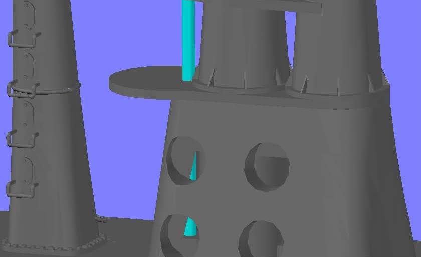

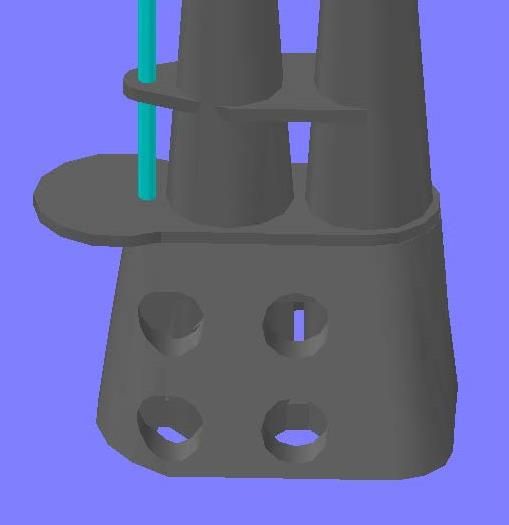

                          • 388
                          #117
                          UPDATE 45
                          Good Morning Everybody!

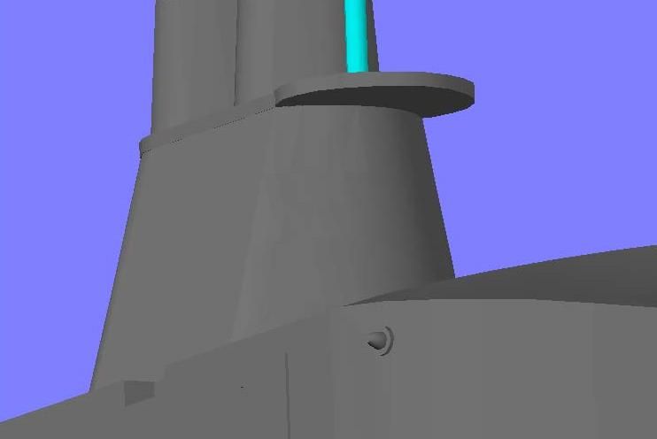

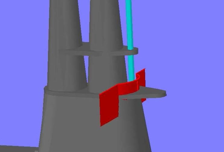

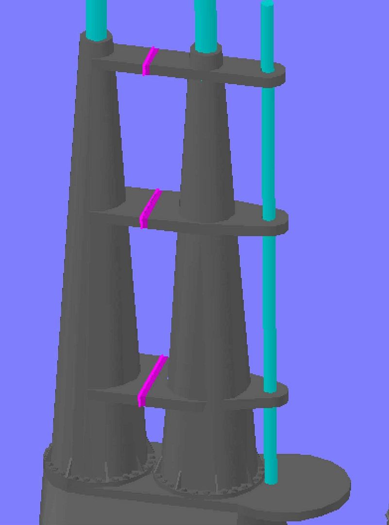

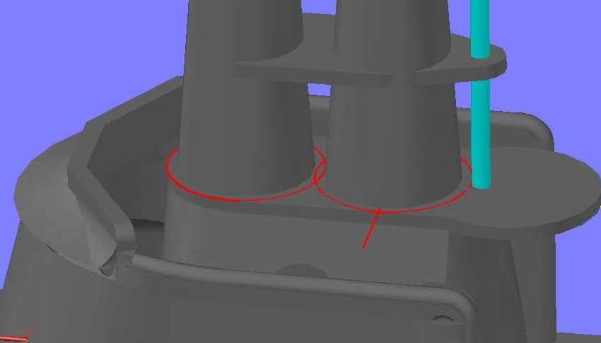

                          Being satisfied with what I have on the SD mast with my current knowledge of it, I moved on to the periscope shields.
                          The first thing I did was modify the platform at the aft end. I did this by creating a polyline matching the shear profile…
                          …Extruding it…
                          And subtracting it.
                          Next, I prepared to make the new platform by drawing a circle so that it intersected the shear at the inflection point and the end of the old platform, because I think that was good.
                          I then extruded it and attached it to the upper shears.

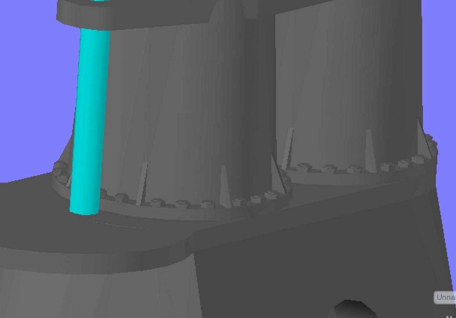

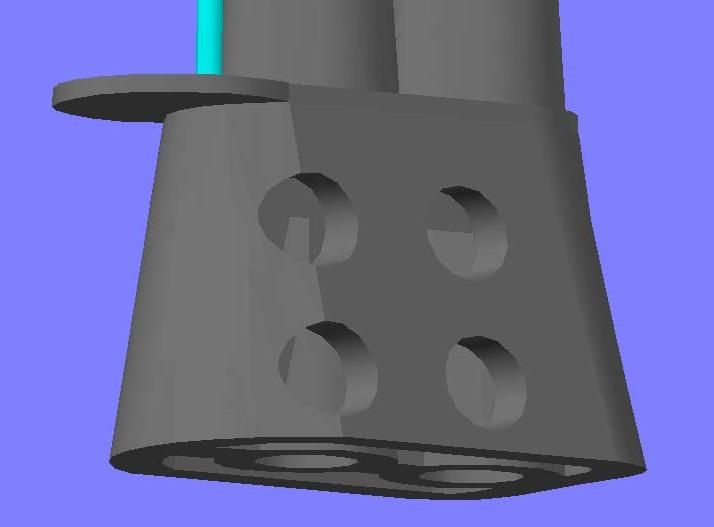

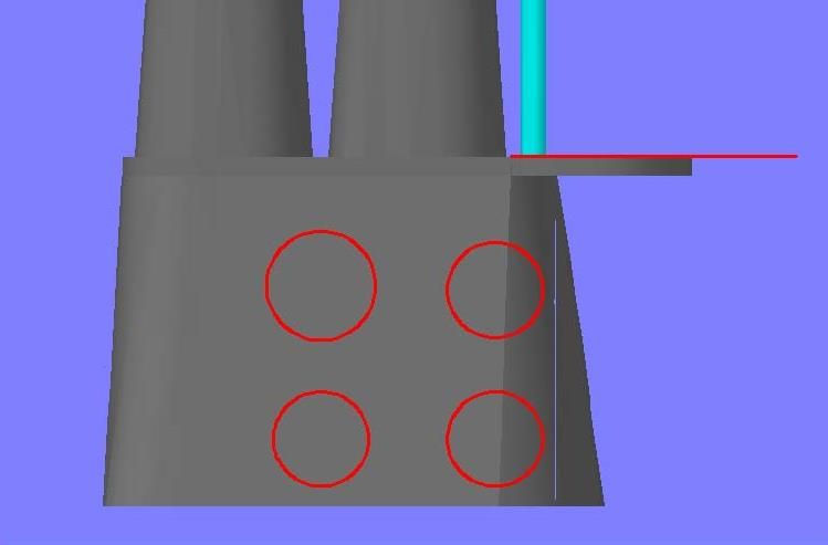

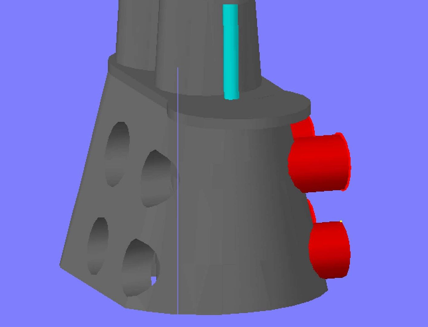

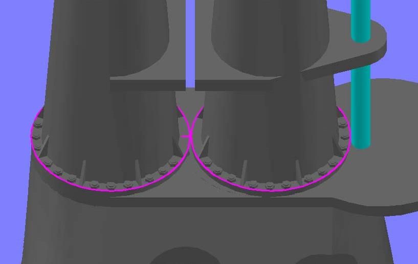

                          The next thing I did was layout the main induction breathers on the lower shear. On the port side the forward upper one is larger than the others. On the starboard side they are all the same size.
                          In the image below, there are 8 different circles extruded partially into the shear…
                          …Which were then subtracted.

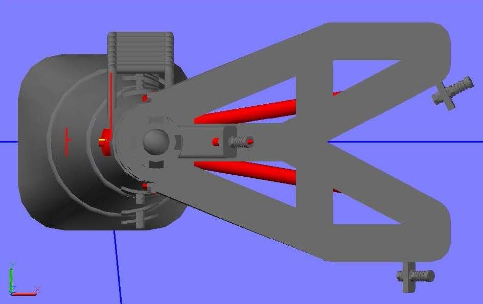

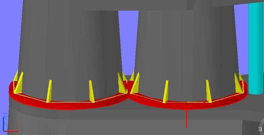

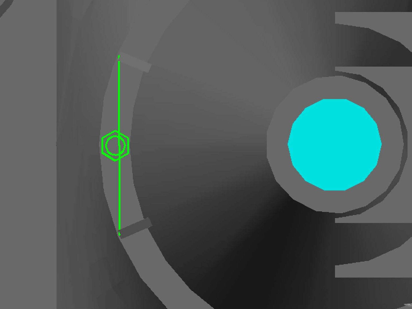

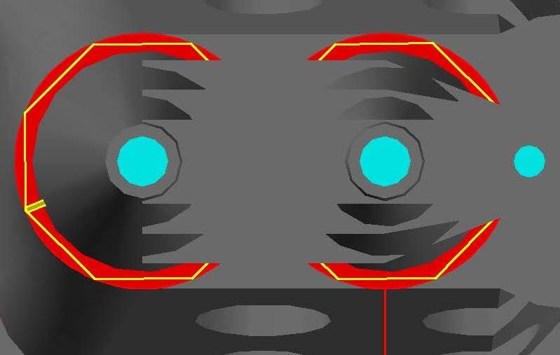

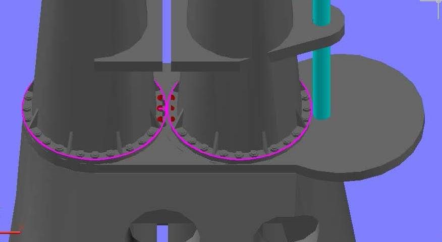

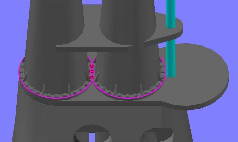

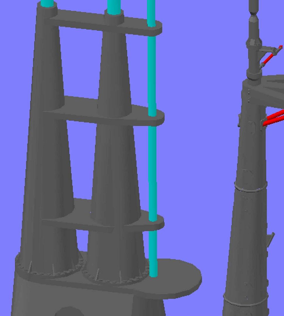

                                Continuing with the periscope shears, I decided to do the base flanges next. I had an issue right off the bat though, as you can see in the image below. In the few photographs I have of the flange, it appears that the outer edges of the flanges are flush with the outer edges of the sides of the lower shear enclosure. So, the circle for the forward periscope flange was drawn first, using the center of the periscope as the center point and the edge of the platform on the lower shear as the radius point. As you can see, it looks like it should. When I copied the circle to the aft periscope shear however, you can see that the circles overlap, and although I don’t have a picture that shows it, and I have yet to make the trip to Muskogee, I doubt if they really overlap like that.
                                I briefly considered slicing it and moving it, but because what I have was copied from the plans and moving it would necessitate a major overhaul, I opted to leave it and see how it would look with the flange completed. So, I extruded the circles up 0.06’ (0.05” at 1/144 scale), drew an octagon to locate the support braces, and made one of the braces by lofting between two triangles, 0.06’ apart positioned correctly on one of the points of the octagon.
                                Looking straight down on it looked pretty cool.
                                This one brace was copy/rotated and mirrored to complete the forward shear and then copied to the aft shear
                                The center section looked OK so I put the nuts and bolts on using the same dimensions as before.
                                There are 3 bolts between each brace, so I copy/rotated and then mirrored the one I drew to get the three nut/bolt combos shown in the image below.
                                This trio was then copy/rotated and mirrored to create the rest of them.

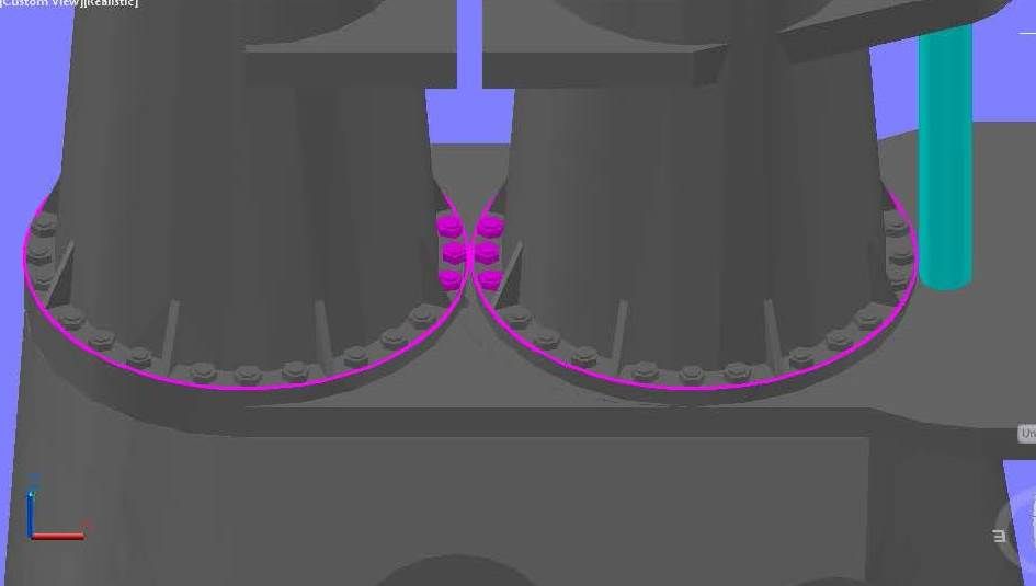

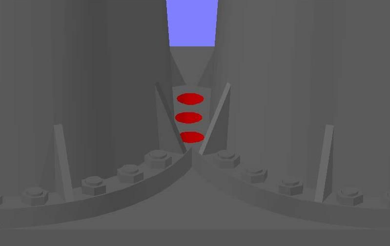

                                It looked pretty good from most angles, but not so much from the critical ones.

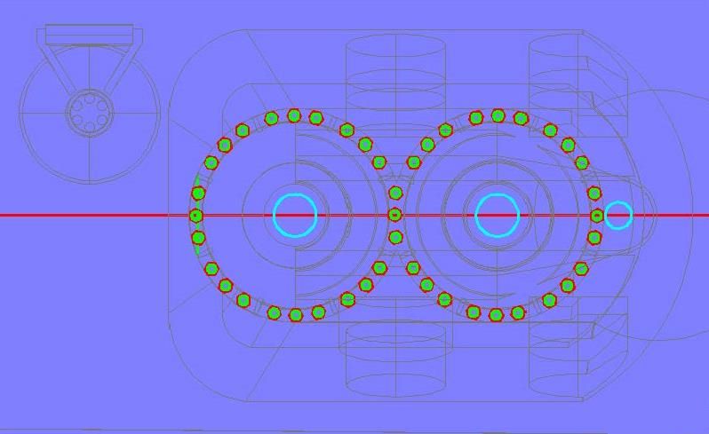

                                It wasn’t horrible, but it wasn’t right either. I had to redo it, so I started by removing the nuts and bolts.
                                I then sliced the shears off above the platform level and drew the circles in preparation for the new flange.
                                Next, I moved the aft shear back so that the flanges wouldn’t intersect each other. The distance moved was 0.18’, not much.
                                Next, I lofted the new flanges…
                                …And made the new nuts and bolts.
                                The final step was to extend the upper support platforms, which I did with extruded rectangles.
                                I’m much happier with it now and am glad that I took the time to move it, especially since it was easier than I thought it would be.
