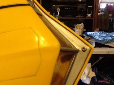

Here is my 4 screw method.
Sorry for the photo size. I can't seem to get them to post larger. (Internet challenged)
Soooo!
Here goes.

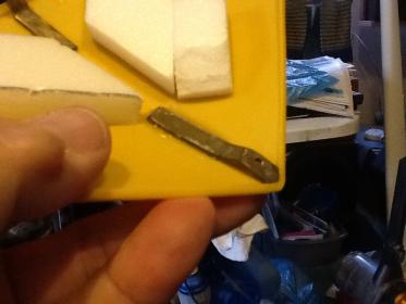

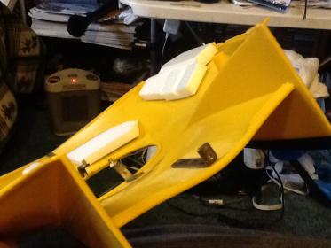

The first screw is in the stern or tail or whatever you call the rear end of a plane/boat thingy.
It is above the rear screen door, and threads into a tapped piece of K&S brass strip.
The second is under the nose and threads into a similar section of K&S brass strip.

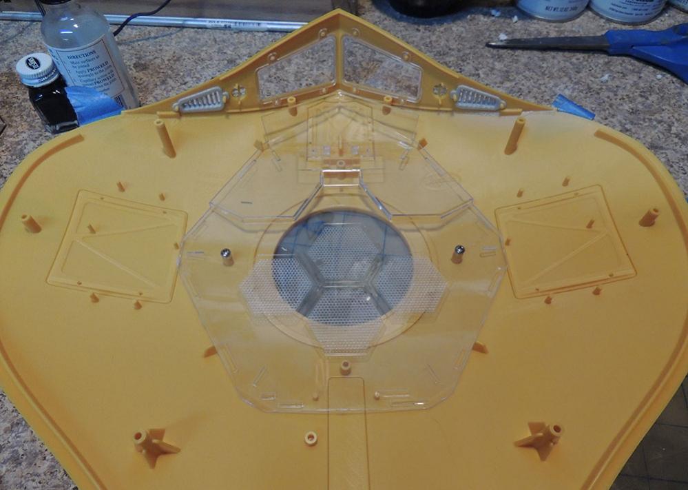

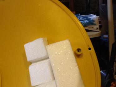

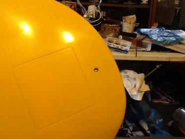

The third and forth screws are in the underside of the wings at the points where the stock pins align the top and bottom hulls.
I installed a cut down brass nut in the top hull post. And drilled out the bottom post to add a countersink for the screw heads.
I use 2/56 SS Allen head screws on the wings and tail, and a 4/40"SS Allen head screw in the nose.
If I painted the screw heads they would be very hard to spot but I am not George and a fastener or two does not bother me.
Any questions ask. BD
