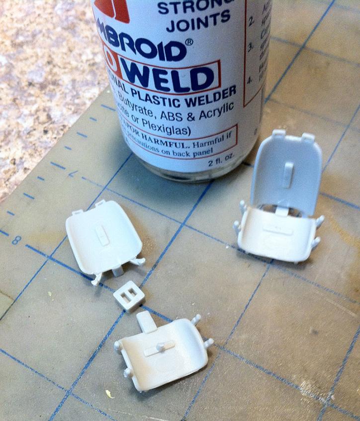

      Just to prove that I'm actually building, I started assembling the pilot seats. These always fascinated me as a kid. It would be fun to make a 1:1 scale seat if I had enough research material. As it is I'll content myself with the 1:32 type. Cohesive of choice is the Ambroid Pro-Weld. Now I have to dig out some paint!

      Say, does anyone know what's up with the square piece that holds the back to the bottom? The instructions call it a "rocket pack" but I don't see it in my reference screen shots. There's no denying VTTBOTS had some crazy gear but a rocket pack? I'm thinking it was the easiest way to join the two pieces and Mobius just called it that.

        Maybe they translated wrong and it should be rocker back?

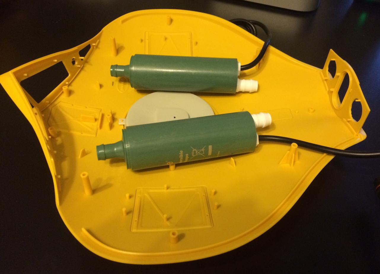

                Just received my pumps from Goldmine Electronics. These suckers are much larger (physically) and heavier when viewed 'in person'.... If these things can't move the FS1 around quickly enough, it'll be a real surprise.

                Hopefully they won't create a problem getting a good trim.
                Also, if anyone with these pumps recognizes the waterproof connectors, I'd like to find out where to get (more of) them. They would work great for R/C subs in general.

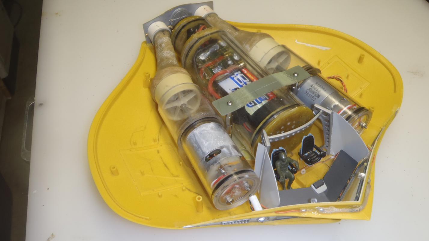

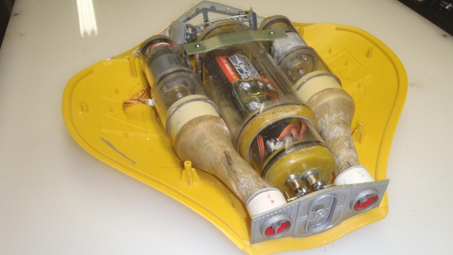

                    I proved that they would fit in my Otter box instillation in place of my small cylinders and Graupner pumps.
                    But if I were starting from scratch I would go cylinder in the center and a pump on either side.
                    Like Rick Teskey did.
                    BTW The pump cable is way to long and thick. I was just going to cut it to length. BD
                      #85
                      Oh, definitely going to whack those cables.
                      Has anyone tried to disconnect the wire where it enters the pump? It looks like there is a screw-in bushing there....
                      I like the idea of using a central cylinder. Going to have to borrow that idea! Thanks, BD!

                        #86
                        Maybe something like this....

                          CI,
                          Looks good! What's the OD of your center cylinder?
                          • crazy ivan
                            • 659
                            #88
                            Jeff,
                            2.75 inch OD with a flat filed in the top and bottom to reduce height. I needed as big a cylinder as I could get to accommodate an "old school" 3000 mah nimh battery. If you go with lipo, you can probably get by with something smaller.
