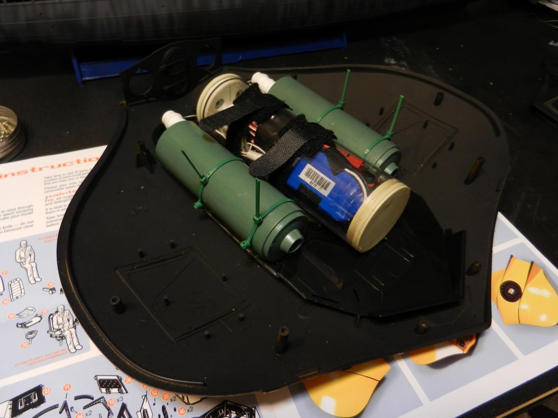

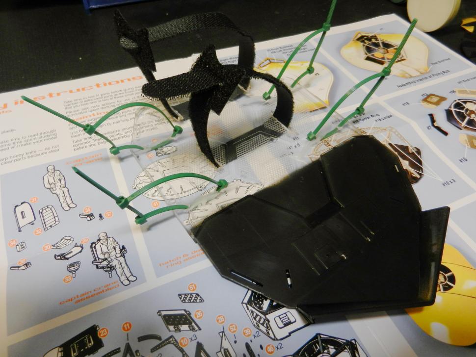

                      Don't want to pirate this thread but I might as well admit I'm working on a FS1 too. Images of modified parts:
                        #146

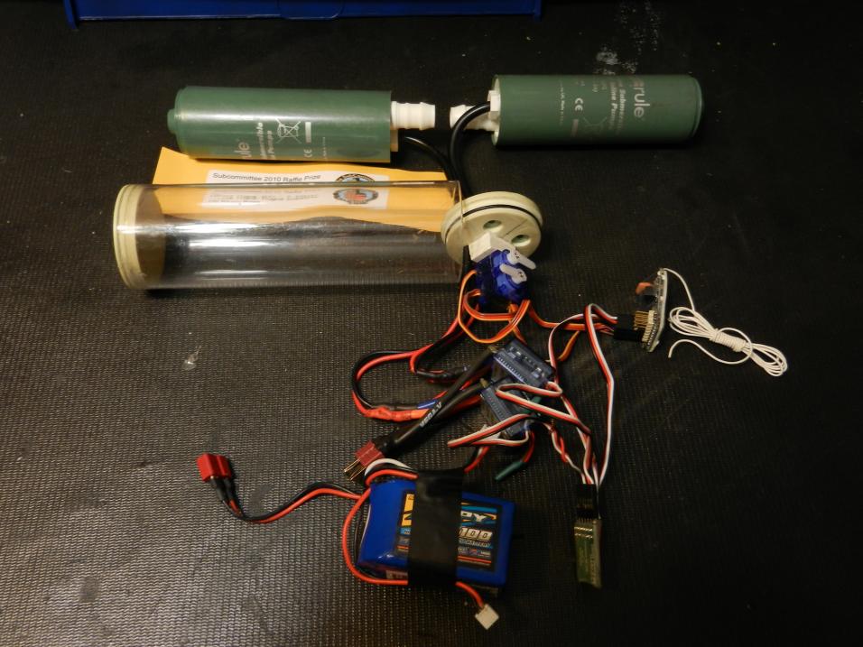

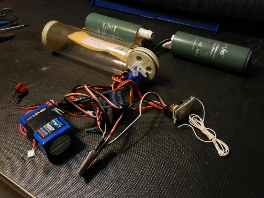

                        Here is a image of the electronics and the tube they need to be stuffed into courtesy of Rogue Subs and the Carmel Subregatta:
                        Another view:
                          #147

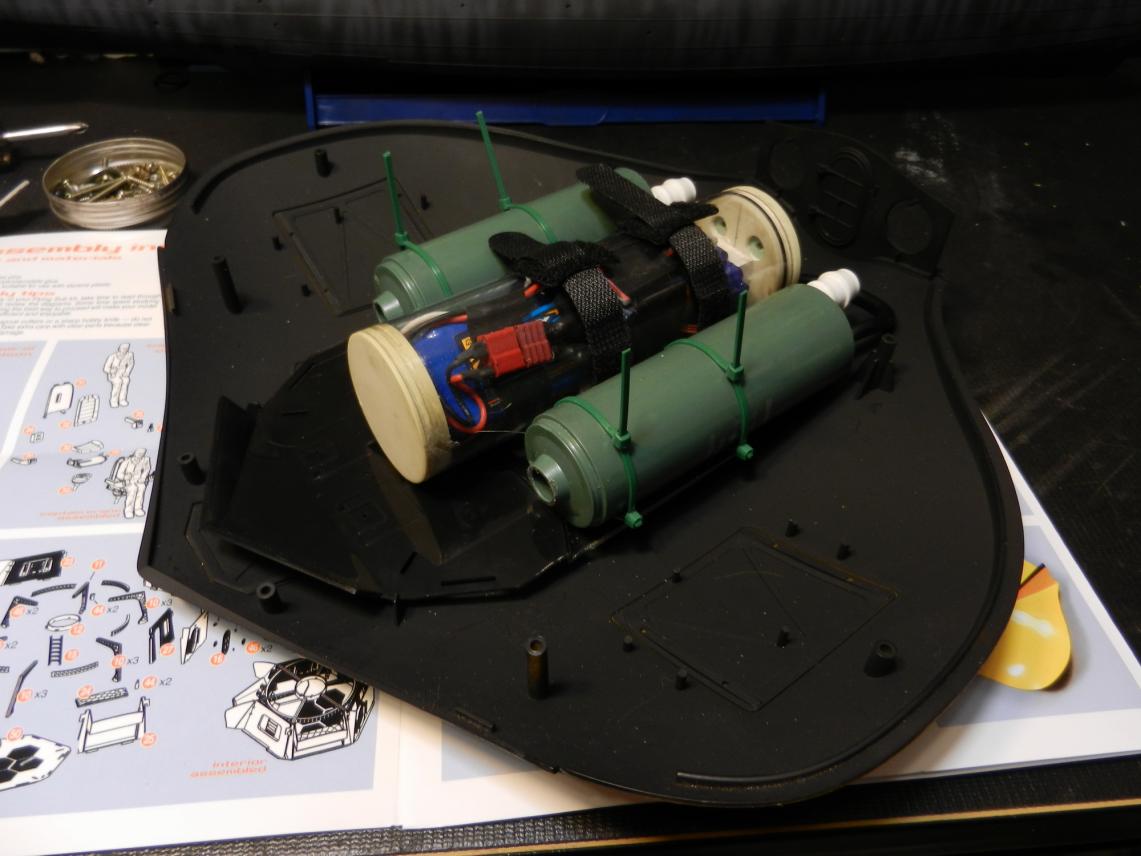

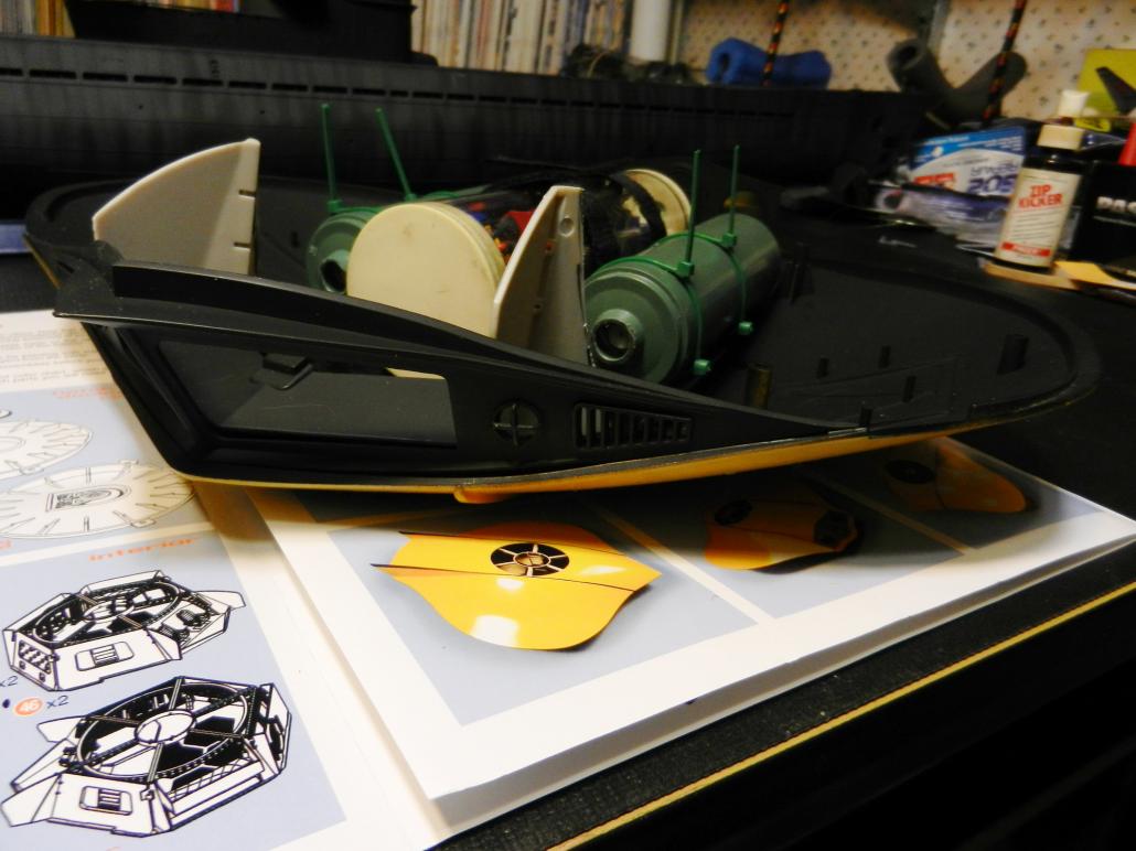

                          Here are images of the wtc and pumpjets installed:
                          See it fits! Here is another view:
                          Think I need a smaller battery or a longer tube:
                            #148
                            Looking good, Bob! What are the dimensions on your WTC?
                              #149
                              The tube is 2" od by 6 1/2" in length. I think smaller power wires will make it easier to add a on/off switch.
                                #150
                                Very nice
                                It will be interesting to see how the Rule pumps work.
                                Should be a great setup.
                                You are using three cells correct?
                                Should be about 7 amps at full power.
                                Probably 3 A at cruising. BD
