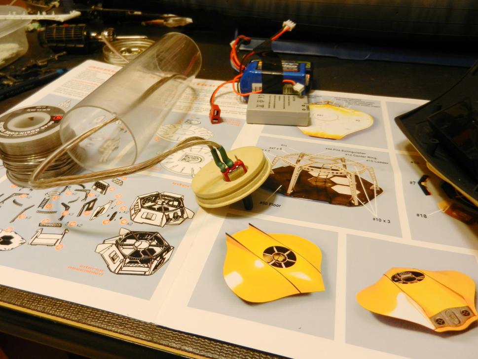

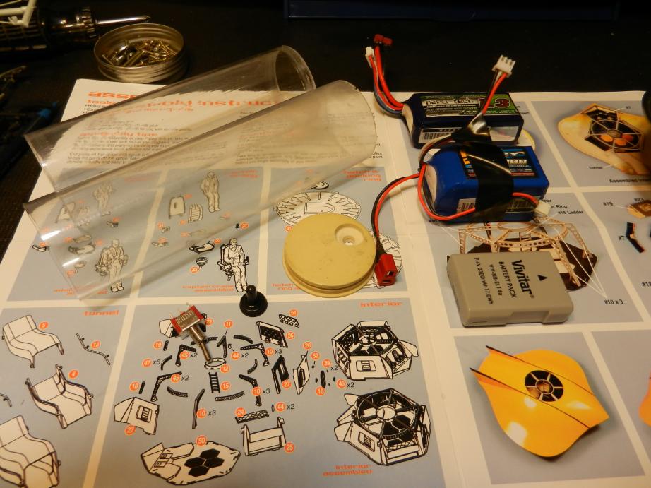

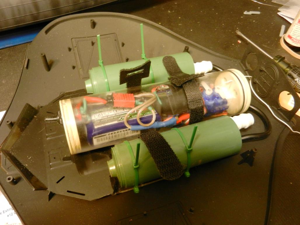

            A little more work on FS1. The first battery was 2 cell at 2100 Mah. Have switched to a 7" tube to have room for a waterproof switch and 3 cell batt, 1300 mah. I need to find a way to attach to the camera battery. It's much smaller but 2 cell and 2300 Mah.
              #156

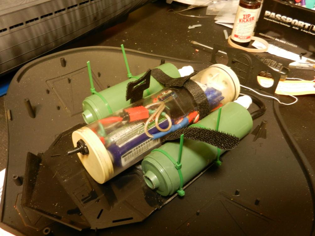

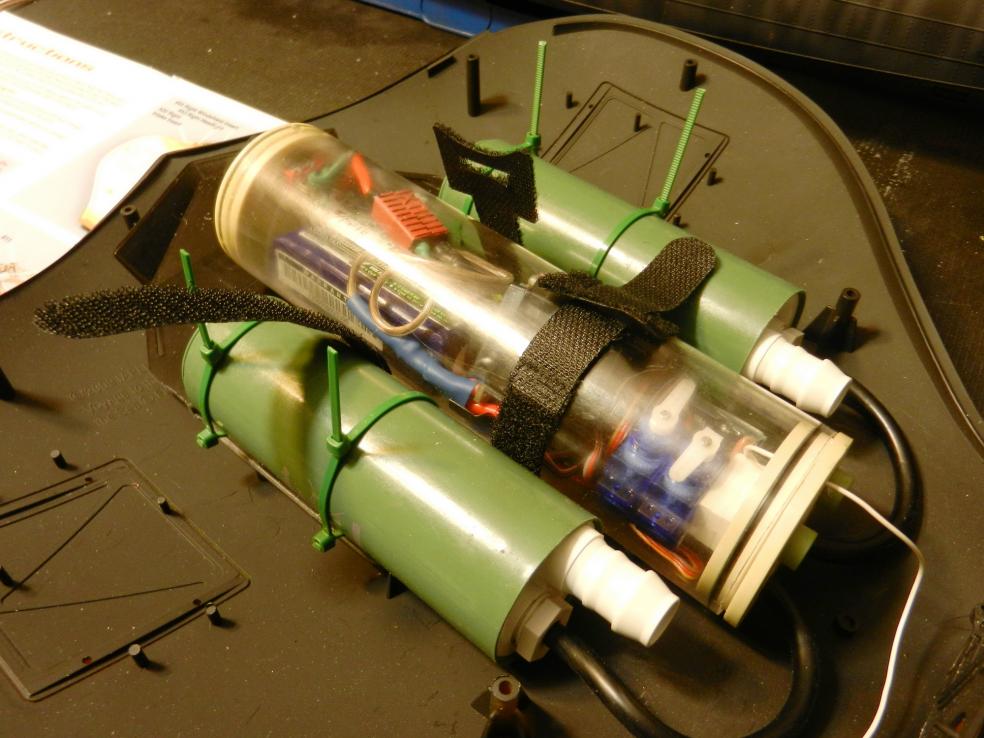

              It all fits inside:
                #157
                Looks great.
                I like the simplicity.

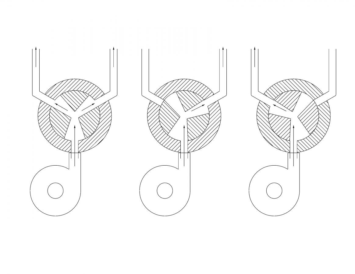

                      How about drilling Y-shaped tubes in a disc. Rotate the disc to direct the flow.
                      Rotation of disc causing flow into one nozzle only. Reverse rotation directs flow into the other nozzle.
                      No rotation directs flow into both nozzles. Or like hydraulic spool valves.
                      Or rotation directs flow into one stern nozzle and one bow nozzles to spin the boat like a pinwheel?
                      Scott T Just a thought.
                        #161
                        Rotating valve idea.
Name:	pump direction valve idea.jpg

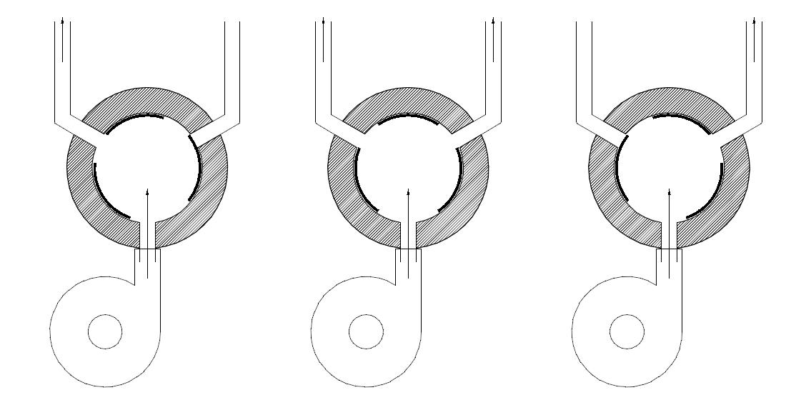

                            Same but different
Name:	same but different.jpg
