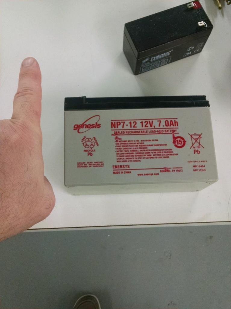

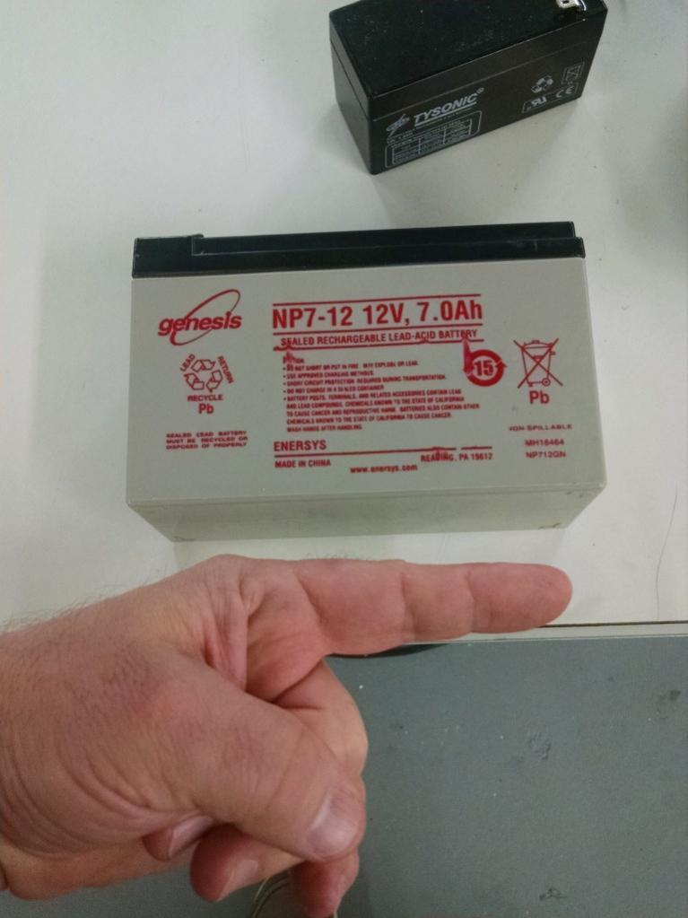

      SLA's can be mounted in ANY direction. Because I run them in the wet compartment, I run a single layer of Electrical tape around the cover seam shown here:
Name:	2016-04-06 11.19.17.jpg
      Mr. Merriman advised that YEARS ago, that way the hydrogen atoms can still escape when charging/discharging, but the large H2O molecules stay outside. Is that proven scientifically? I dunno, I just quote the beast, and fwiw, I have no indication of shorter battery life.
      Since I turn model on by simply plugging the molex connectors together, they are in the wet side, I do get corrosion over time on the positive terminal. Molex connectors are cheap enough, and I have the original on my WTC that is 23 yo.
      FWIW, I am changing to those two prong rubber automotive trailer connectors. Just wrap it with a pices of elf amalgamating silicon tape IE: Rescue Tape every time you reattach it. 1 roll last's a season. Again, not so much because of the corrosion worry, more for the fact they'er easier to install, less expensive since you buy it, cut in half and and you know have both sides of the connection.
      One thing to note, the lead plates within the SLA are not truly symmetrical from TOP to BOTTOM, so for trim considerations, if you lay them on their side you need to align them properly:
      If you can lay them athwartships, do so. In this case I'm pointing toward the bow (or stern)

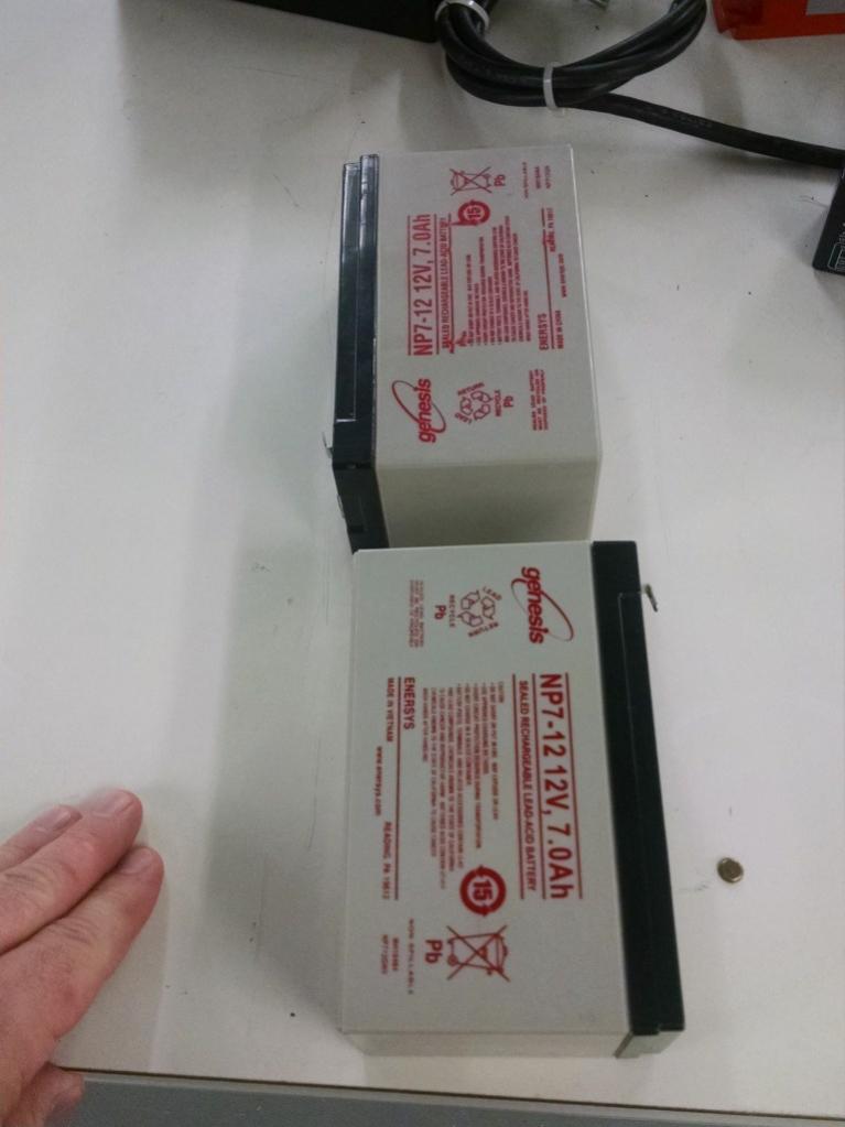

      If your'e forced to align the long axis of the battery like this (still pointing toward the bow or stern), you'll probably find the boat listing and will need foam or ballast to compensate.

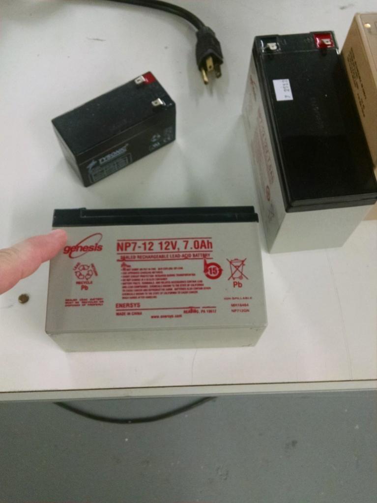

      This is how I lay the batteries in my 80" SEAVIEW, alternating them along the long access of the ship cancels out the affect.

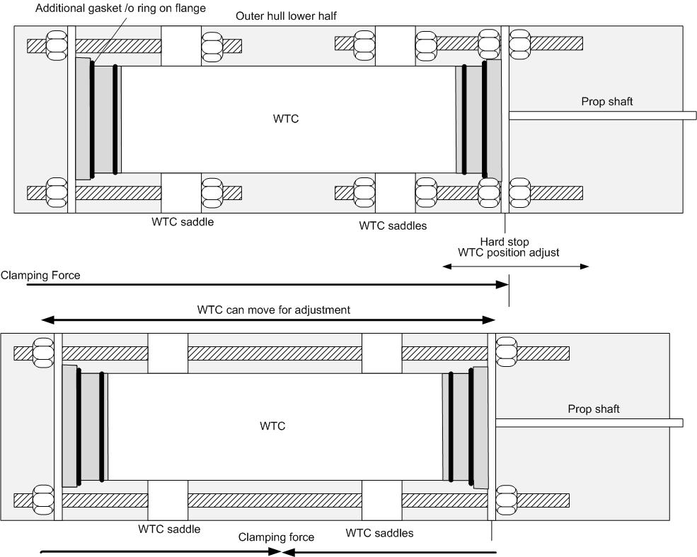

                  I will put this to the vote the 2 methods i am considering using , also notice the additional flange O ring or gasket i have placed on the end bulkheads, these are not present but it might provide double protection ????:-
                  as i see it for pros and cons for each
                  method 1 = PROs = provides positive repeatable WTC location within the hull / is easy to assemble / fine adjustment of WTC position
                  CONs = if i want to leak test the WTC in the test tank the lower hull will have to be incorporated in the test (not sure this would be an issue)
                  Method 2 = PROs = WTC and clamping is separate to the hull / allows complete WTC leak testing as a unit without incorporating the lower hull
                  CONs = More difficult to assemble as end-end rods have to be pushed through the WTC saddle clamps, WTC positioning slightly more difficult.
                  How do you guys see it ?????

                    This may be one of those times that over engineering is being considered.
                    Being able to move the wtc requires more work in designing the end cap bolts to mate up with the saddle holes.
                    Requires more work to remove and install wtc in to hull.
                    The second one requires more work as you stated.
                    I may have shown this photo before.
                    The cap retaining rods go down the outside on each side of the wtc.
                    The frames or saddle rings have been cut to allow the rods to drop down.
                    These notches keep the wtc from twisting do to prop torque.
                    At the from of the cylinder in the hull are stops so the cylinder will always be in the same place.
                    At the rear of the cylinder there are stops to hold the cylinder from moving back.
                    There is about 1/16" clearance to allow for heat and cool expansion.
                    There is a single Velcro strap center of the cylinder that is bonded to the lower hull that keeps the cylinder in the hull.
                    Loosen the control rod wheel collars and separate the Velco strap from itself and the cylinder lifts out.
                    Trim is done with weights and foam in the hull.
                    Fine trim is done by moving the ballast tank and battery in the cylinder during final water trimming.
                    Front of cylinder shows the rods against the hull alignment sockets.
                    A plastic block was installed in the bottom of the hull.
                    Rear of cylinder before stop blocks where installed between cylinder rod tabs and hull alignment socket.
                    I actually had to remove the socket down 3/4" to allow my top hull to slide back for locking top to bottom hull.
                    The stops are down 3/4" from the top edge of the hull lip.
                    I do not seem to have any photos showing the complete cylinder in the hull.
                    A note: My built was a copy of Tim's built.
                    He first built his wtc with sections held together at multiple caps with lots of little screws.
                    He was months ahead of me and he did a lot of testing.
                    He made changes along the way.
                    He changed the pump motor.
                    I was able to do the same.
                    Then he changed the cylinder to a single tube.
                    His next report was of pressure build up during a dive and end cap popping out of the cylinder.
                    At this point I decided to go with the full length retaining rods.
                    He has since installed some sort of retain system.
                    I may not be explaining this correctly.
                    So, here a link to Tim's build.
                    It is full of good useful information and photos.
                    Tim's Sculpin build

                      Thanks Ralph, i couldn't mill out slots on the WTC saddles as there are hooks in the tops to provide a means to secure the WTC, i dont think with either option that the WTC could twist but conveniently on the rear bulkhead there is a spare threaded hole which i could use to bolt to the rear clamp. I will have a look through Tims build later tonight.
