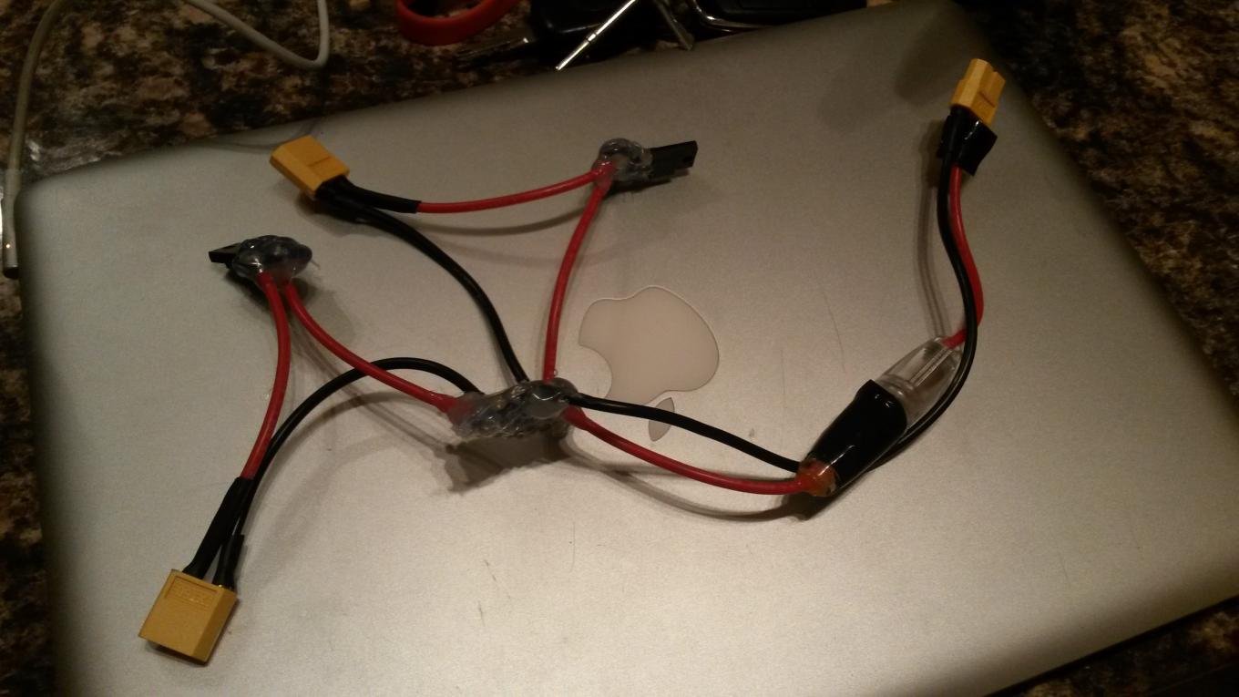

              Just incase it might be of use to others see attached which is a wiring harness for parallel connecting 2 lipo's to increase capacity. The small devices you see inline on each positive leg from the battery are Schottky diodes preventing cross charging between the batteries, this at 11.1v only looses 0.05 volts.
              This is easy to confirm with a Ohm meter ( multimeter ) i.e. if you put the tester positive probe on the positive input for each lipo connection it will see an open circuit , but when you put the negative probe on the positive leg of the combined output it see apron 120ohm.
