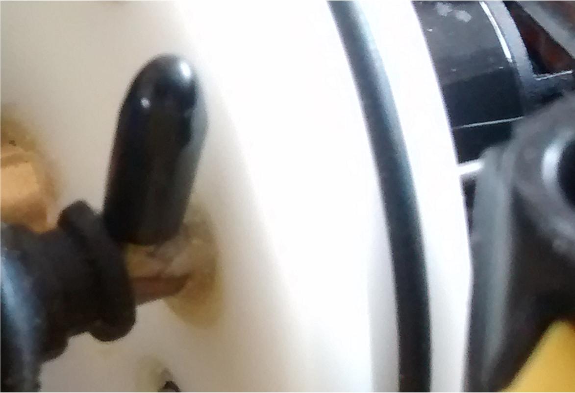

    Do you pack grease into the below

      The more i look the sub the more questions i have, it looks to me like there is some residual air in the ballast bag, do you vacuum this out otherwise i can't see how the pump would overcome the air pressure build up in the bag ?
        #63
        Let's see if this explains it.
        Your system is a ballast bag system that takes water from outside the cylinder and pumps in to a bladder inside the cylinder.
        The compresses the air in the cylinder reducing the volume of buoyancy from the cylinder.
        You bladder has air in it.
        This is actually a good thing when the boat is not being run.
        It keeps the insides of the bladder from sticking to each other.
        When running your boat this is not really useful.
        So, my procedure at the pond is to test all operations of my boat to make sure every thing works.
        Then I put the boat in the water and test all the controls except the propeller and water pump.
        Once I know all the control surfaces work, I will test the ballast pump.
        First, I will bring water in to the ballast bladder.
        I do not fully fill the bladder.
        I then pump it empty.
        This will remove all the water and if you continue to run the pump a little longer, it will remove the air in the bladder as well.
        Next, fill the ballast bladder to check to your submerged trim.
        If so, again surface the boat and now test your main propulsion motor for forward and reverse.
        If all works as it did on your work bench, doesn't always work out that way, you are ready to venture out away from the shore.
        I do a few circles in both directions to test propulsion and rudders.
        Then I can visually check sail plane operation.
        Good to take on the dive.
        I do that while the boat sits in front of me next to the shore.
        I will submerge the boat and check trim.
        If trim is good then it's time to get under way.
        The sail planes or rear dive planes will take the boat under while under way.
        The day is a good day, if the boat makes it back to shore with no mishaps or water in the cylinder when you open it up on the table.
        You pump will pump both water and air.
        While on the bench this can be tested by pumping air in to the ballast bladder.
        Remember, the pump will not fill the bladder completely with air like it will with water.
        If you ballast bladder is put away for the season with all the air removed and the bladder sides are touching, you may need to replace it do to tearing or cracks before you ca run again.
        My bladder bag happens to be copied from Tim's boats.
        I remove them when I am not going to run my boat.
        I use two toy balloons, one inside the other.
        I buy a bag of 100.
        I prefer the black balloons.
        This is a test fill using pump and air.
