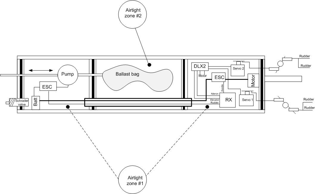

    Almost certainly a sealed ballast tank, so air is pressurized inside the central compartment as the bag fills with water.

      thanks all i think I'm slowly getting the gist, i will over the weekend get the sub out the loft and have a proper look at all the parts i have. what i still don't understand is how would you submerge the sub to say 3 meters and hold it at that depth ? is the ballast purely to achieve neutral buoyancy then you can use the rudders to dive etc i think but not sure that the DLX2 can control pitch it has a motor connection so i wonder if that is for the ballast pump to automatically pump water in and out to stay at a certain depth. looking at the rear bulkhead with the bicycle valve i suppose you would pressure the front and rear containers to a set pressure x then if i pump up the ballet bag i should not see that pressure in the front and rear compartments change, confirming that the centre section is airtight and maintaining pressure within its own container.

          I put the above diagram together for clarity,

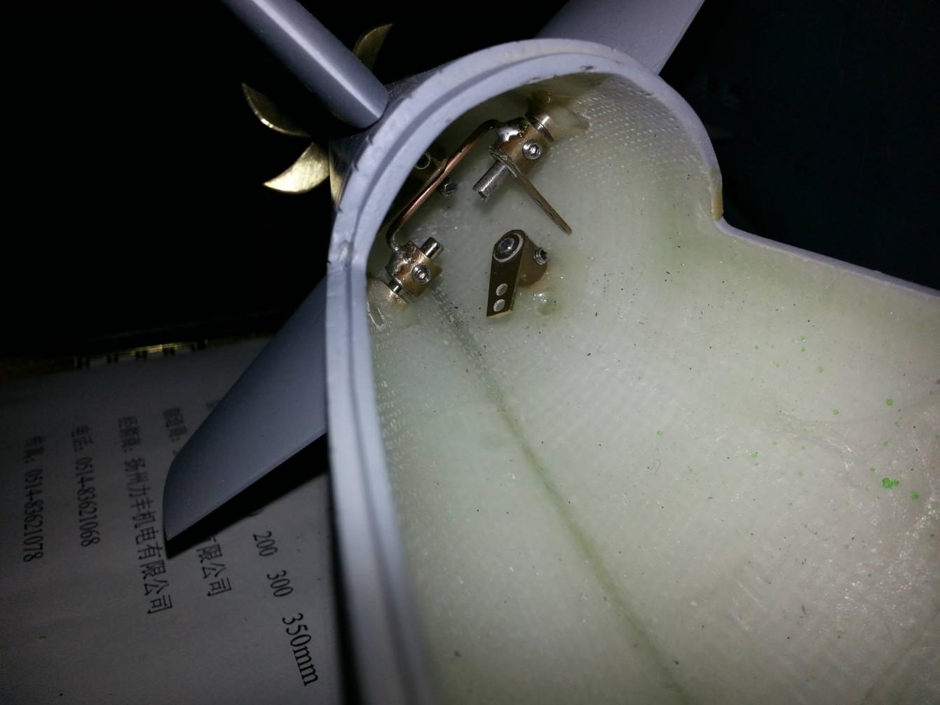

              From RC Sub Workshop (think this is the sub you have) might help with X tail setup

                Excellent Thankyou, i think i will be using a pushrod 1 to 2 instead of the joining bar seen here but this technique might be better i will see which is easiest to accomplish.

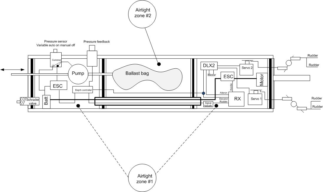

                I have now put the below together very heath robinson and might only convey my insanity but this shows my thinking better than text.
                1. I have a pressure switch which can be set to x mbar, the ESC to the ballast pump circuit runs through the switch. In normal use where the set mbar is not exceed the switch passing Leg#1 to the common which connects it through to the ballast motor. In this scenario everything operates as normal i.e. the ESC takes commands from the RX. If the set pressure is reached then the switch bypasses the ESC circuit and connects BATT straight through or i guess i could have another ESC after the switch for a more controlled pump action. The pressure switch would have an auto engage on pressure reached but you would have to manually reset it.
                2. I have a fail safe something that can detect loss of radio signal, upon which it commands the Ballast ESC to pump out the ballast.
                3. I have a depth control something that detects the depth via a pressure sensor and when there is no RX signal to either empty or fill the ballast or signal to control the rudders for nose up it maintains that last depth through the ballast pump.

                  I have just found a new sub tech ADC-1 unit would this work with the DLX2 APC i.e. i have seen mention that you simply wire as
                  RX-----ADC--------APC-------------servos
                  • Nb1914
                    • Mar 2016
                    • 53
                    Or even better to allow static depth holding could this work
                    RX--------ADC--------esc------ballast pump

                      I would forget about getting a submarine to hover at a specific depth, it's actually very difficult to do, and requires automation, with constant correction to the ballast system. Technical challenge aside, watching a boat hover underwater is a bit like watching paint dry. Trim the boat until it's just a few grams positively buoyant, then a whiff of throttle and it will submerge.
                      The depth controller is a nice little device, but I would leave it out of the boat for the time being, as the leveller is a far more useful device.
                      Concentrate on fixing the boat up mechanically, making sure it's fully watertight, and ballast it so you get a nice trim with just the top of the fin above the water when the tank is filled.

                            its slowly dawning, ok for my insanity how do people get their subs to a depth like 2meters and sit still neither up nor down and no forward movement as i have seen the TT neptune sb-1 perform with what looks like minimal electronics. I will certainly get the trim right without any fancy gizmos but my interest has caught fire on the technology to maintain a static depth.
                              #29
                              Generally what is used is a means of measuring the pressure at a certain point you wish to remain, and then electronics sense whether the pressure is increasing or decreasing, and at what rate that change is taking place, the ballast volume is then adjusted accordingly.
                              You can't do it without assistance of something like that, because it's so difficult to judge using sight alone. I would expect the system to need some dialling in for individual boats. Engel offer a system, but they only claim depth accuracy to within a metre or so.
                              It's pretty advanced stuff, so I would concentrate on the basics first.
                              If you've seen a Neptune hovering, it probably isn't, what it is probably doing is either sinking very slowly, or rising very slowly. But as I said in my previous post- it's not my idea of entertainment.
