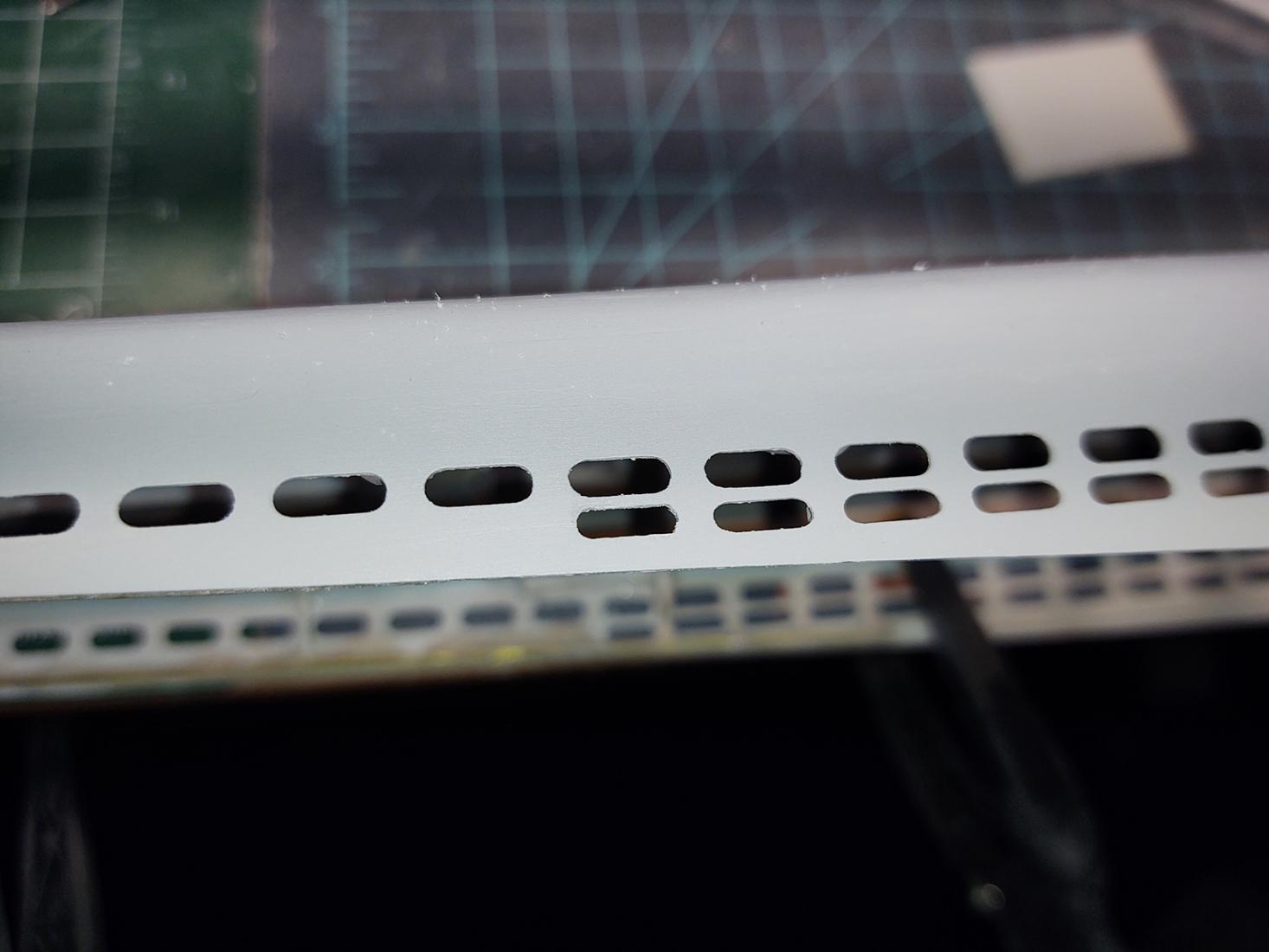

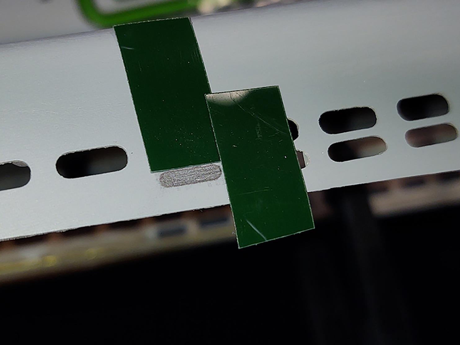

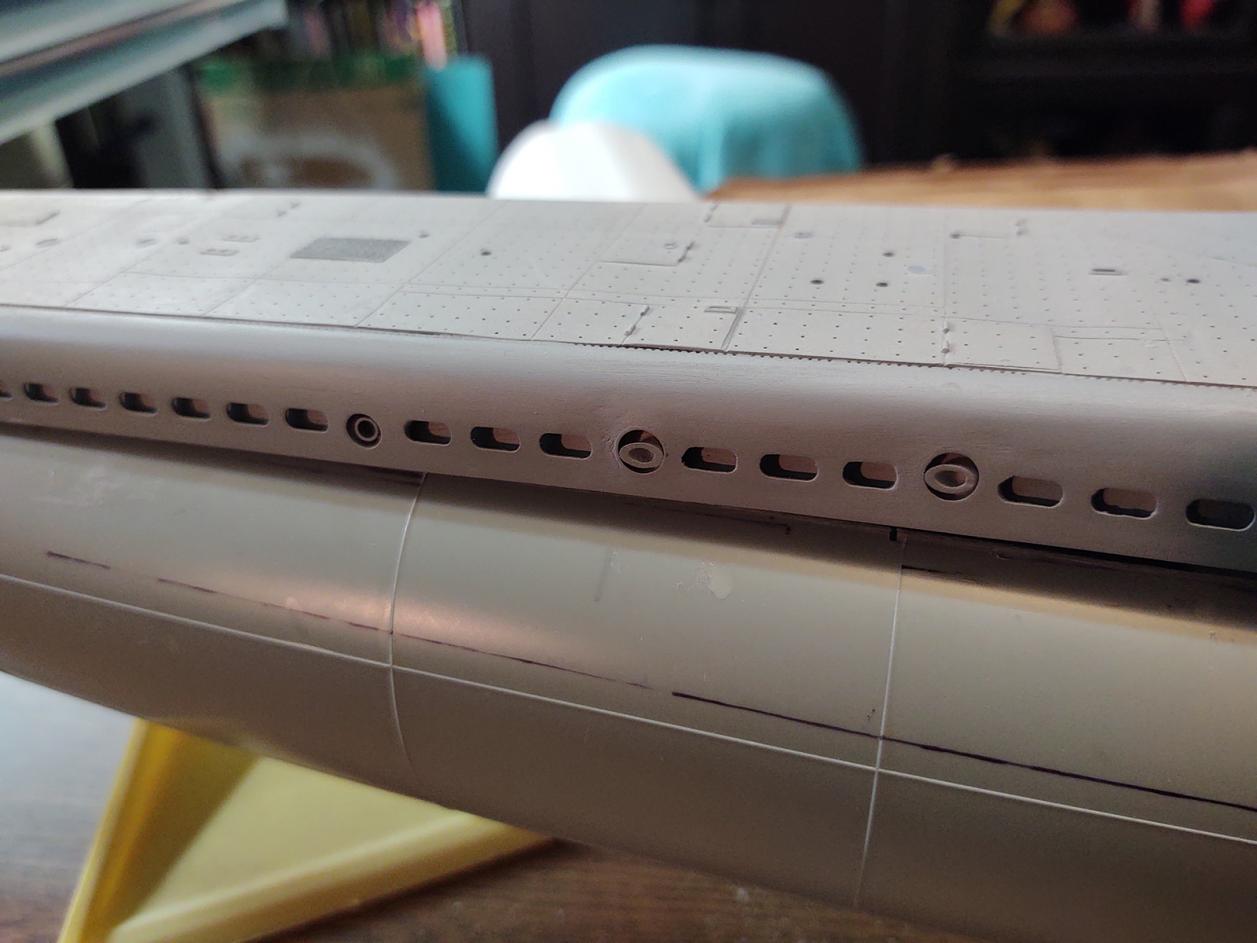

        I spent the rest of my time this week punching holes. I had noticed something wrong on my boat after viewing the above mentioned Trigger shots and also checking my Silversides shots I found I had made my limber holes with one too few of the double holes. The total number is correct so I manually created a double set from the first single back from the bow.
        I used the tiny engraving bit in the dremel to cut, and some Dymo tape to help keep the "bounce" minimized. Worked good.

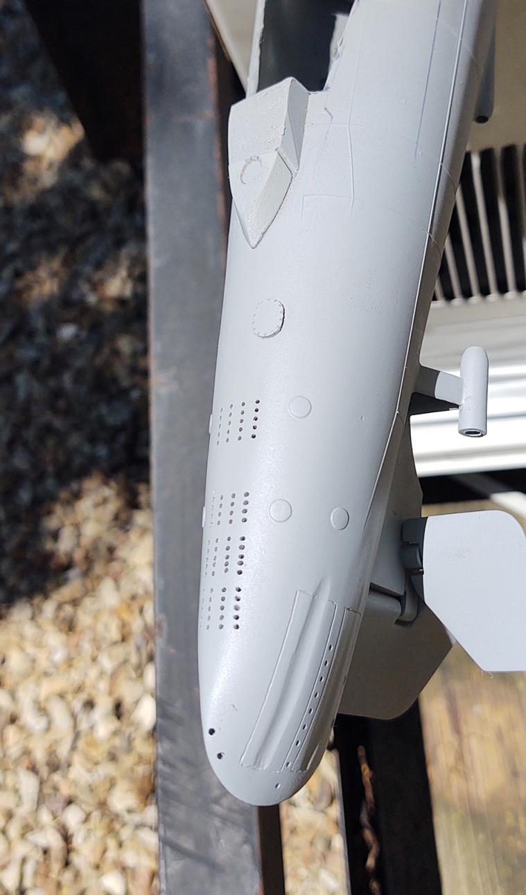

        Other holes include two in front of the bow planes on either side and holes that served as a ladder further back about midships. Scuttle holes? Dunno. THOSE are a pain though. Half-moon shapes are hard to do with files, and these will be acceptable with some finishing but not great. I would have added those to the original file I had laser cut knowing what I know now.

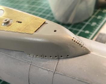

                            More scattered progress on Trigger, here and there, but mostly at the extreme back end of the turtledeck and upper hull.
                            I continued with the limber holes and added the diesel exhausts and what I take to be the trim pump discharge, though I guess it could be the blowers. Water spits out of it, dunno, not my Qual boat. Silversides has a scalloped tail pipe at the end of her diesel exhausts and my Trigger refs are unclear on the matter so I added my own. Mostly for detail. I hated the really open look the limberholes had so I put some sheet steyrene behind them to vaguely simulate the pressure hull.

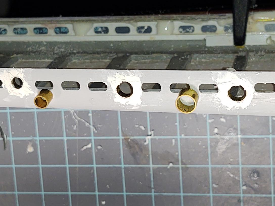

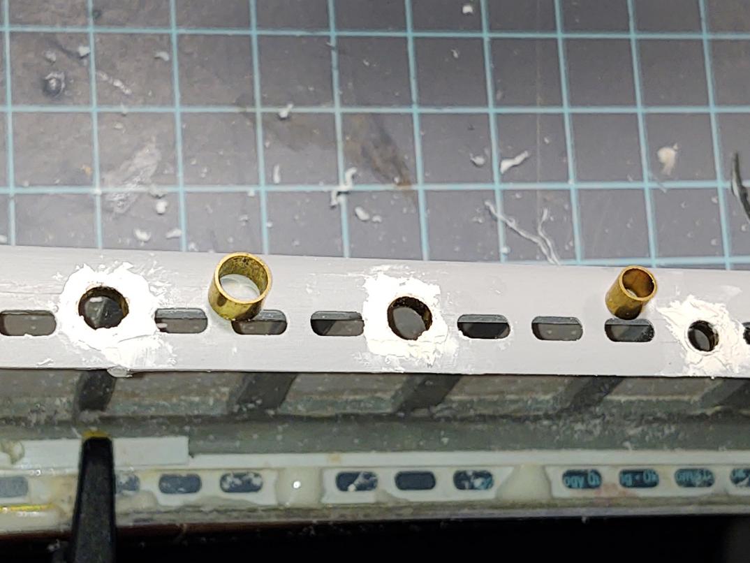

                            I puttied in around brass tube to give me some nice round openings
                            Nice, adds some weight, but she ain't see-thru no more.

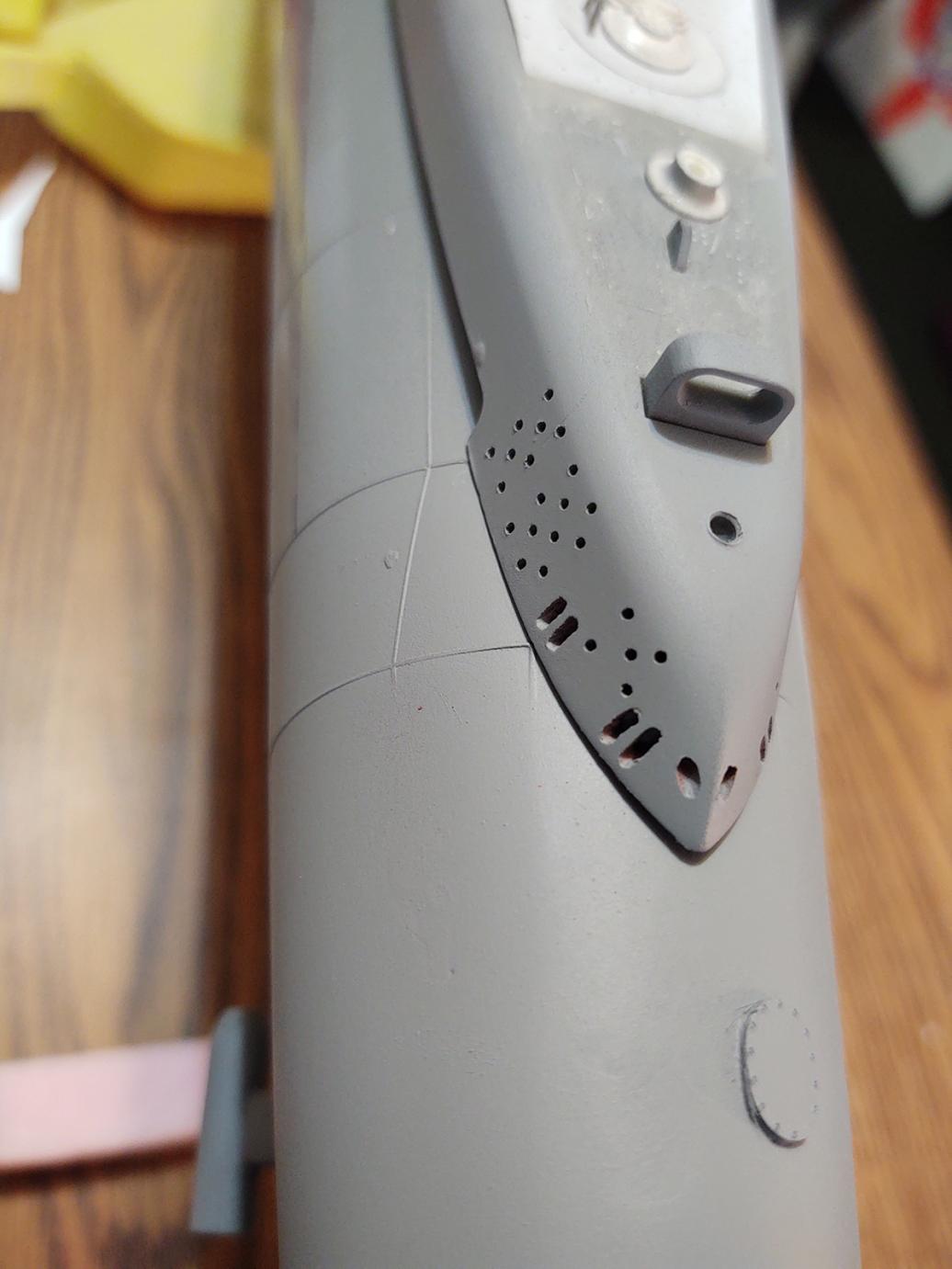

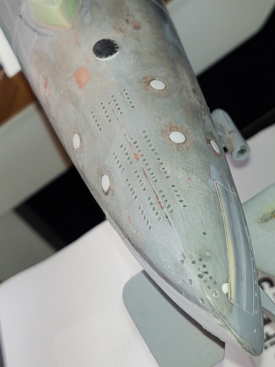

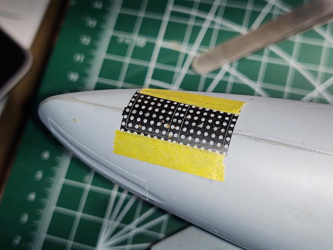

                            On the aft turtledeck I drilled some bubble escape holes as per the prototype. I continued this process onto the hull using a thick Photoetch piece as a drill guide. Worked so-so. Added the other bits like Jeffty did over the attachment points for the wartime removed prop guard. Added some plastic to buck up the PE plate and gave it all a shot of primer.
                            It helped keep the drill bit from skipping about but it wasn't perfect. Better than freehand I suppose.
                            Same method on these holes that turned out better. I do have some evening up to do on those oval slits I see.
                            With these great reference photos it is hard to ignore a lot of the juicy details I can see but It is real easy to overdo the scale. I knocked all of them back with some sandpaper.
                            And it looks pretty nice back here. Not 100% fidelity to the lost boat but ya gotta know your limits and the essence is Trigger as she looked. Once I solve some fit issues deck-to-hull I move on to the teak decking.
