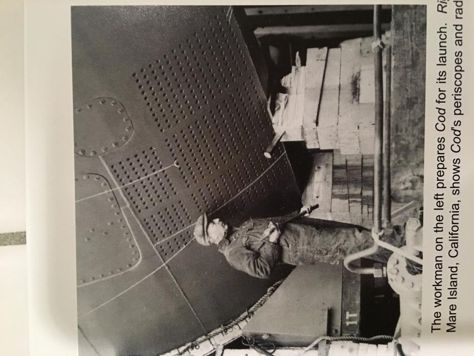

                      Not to doubt, but are you sure the EB boats didn't have those keel "chin" floods? Cod was an EB, and she appears to have them here. Perhaps she was a rare exception, or maybe this was a postwar mod?

                        And of course, now it appears sideways, because it's a phone shot. Sheesh!

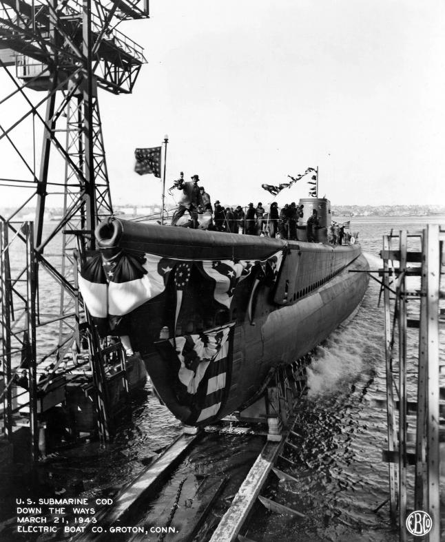

                          Here is the Cod on the initial launching, I do not see the bow holes in her.

                            Perhaps the shot I posted is misidentified; a different boat despite the caption...

                              In the launching view you can't see the chain laocker drains as they are tucked up in the curve of the hull, and partially covered by the first launching cradle on the skid. You can just barely see the big holes above the TTs, along the upper edge of the lower bunting. Definitely not a good shot to glean info from!

                                You are right about not a good shot, however we use what we can get. Here is the direct link from NavSource: http://navsource.org/archives/08/228/0822428.jpg
                                I am squinting and turning my head and I think I can make out some holes, but very inconclusive. So, I stand corrected Jeff. Build your sub whatever way you want. Just build it!
