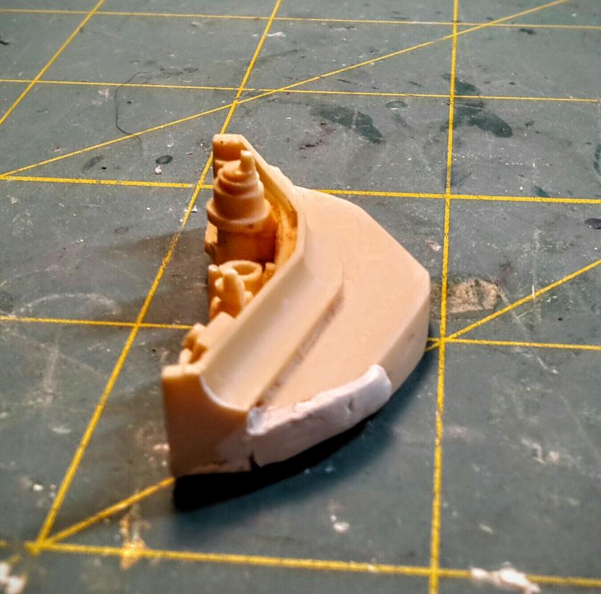

                Decided to finish up the front part and move slowly aft attaching tidbits and greeblies as I go. The time had come to attach the top and forward part of the bridge area. <Sigh> Again the Nautilus Models part is well cast with lots of detail, in fact the instrument shelf is very well realized with actually identifiable equipment such as the compass repeater, TBT mount and such, but the front was strangely angular perhaps reflecting Silversides more than Trigger. It looked to me like nothing so much as perhaps the hood of a Freightliner truck or maybe a modern railroad locomotive.
ID:	127872Click image for larger version
Name:	Union pacific.jpg

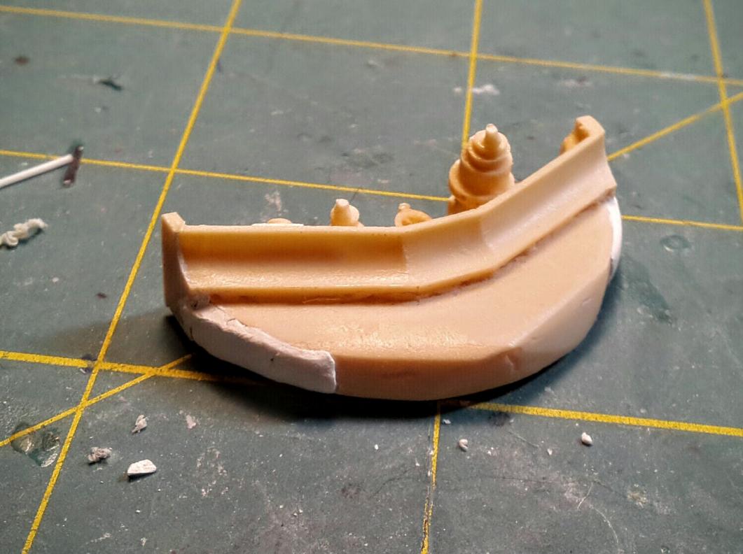

                The putty was needed to bulk up the piece to match the sail sides and give me enough material to have a nice rounded front per my refs. The venturi needed some help. It had a good shape but the bottom makes a distinct cave on the prototype and there are distinct supports visible. I took an "L" shaped piece of Evergreen and glued it in there to give is a more distinct edge overhang. I then glued some bits at intervals under the lip to represent the supports. If you look at a bunch of these period subs this area looks wildly different boat to boat like there was one really hyper-engaged guy at Buships always trying out something different whenever a boat went into the yard.
                Much more roundy now. I added a top piece as well. It looks nice but um, according to my belated look at the reference photo, not strictly canon. But it looks nice and it's close, so moving on. Moving on to ...the TBTs (Target Bearing Transmitters). Kit parts horrible, plus the aft TBT tower provided is wrong for Trigger. First attempt.

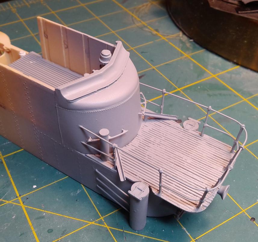

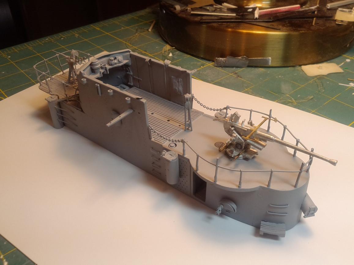

                They look better painted mind you. There were some other bits and pieces in the area to be done. The handrails across the curve of the sail for one. They were created in place with styrene rod. The liquid cement melted them together somewhat that and some plus some tiny bits of epoxy in the corners made them pretty sturdy. The lone post or whatever it is on the starboard side was next, styrene tube with a brass post. After some discussions with our wise and learned resource Bill Lambing, I decided to include the two ammo chutes as seen on my reference photos. If they were there then they should be here now was my reasoning. Finally Trigger has these series of metal rods welded between the ready lockers and the bridge plating I assume in lieu of actual grab handles to allow access to the 20 millimeter area up there.
                Ooh. On that note. I wasn't entirely happy with my choices between the kit parts and the add on kit. Mostly I needed two mounts and didn't have all the parts to make two that would be alike. Whatever. New idea. While looking into aftermarket kits for these I saw this place called Shapeways who could 3D print me what I needed, two for under 20 bucks. I got them the other day and they are pretty sharp detail-wise but will take some smoothing out before paint. I think I'm going this way now.
                Anyhow a shot of primer and here we are now. Satisfyingly busy. Some divots and pings that need correction before final paint but that's down the road. Working my way aft now, storage lockers, nav lights, aft gun deck...

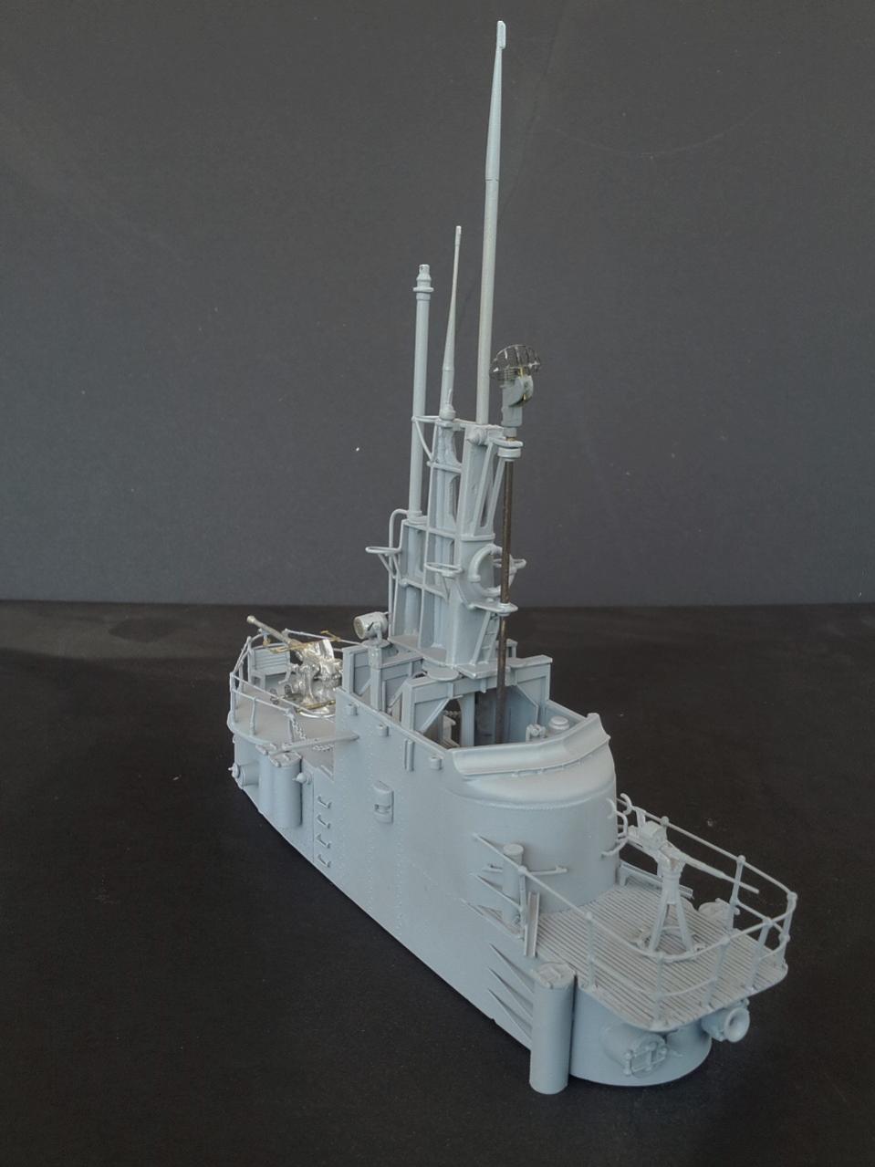

                                The sail is done. Yippee!
                                Now on to the hull and getting the guts going on this thing. A slight break first though, a local model show is coming up in October and I have a couple non-sub kits I'd like to finish to show then.
                                Meanwhile, I hope I captured Trigger's late war look so far. Details are necessarily overscale in some cases because this is a working boat after all and it has to hold up. Also in that regard everything is brass pinned as well as glued, with a few exceptions like the park bench.
