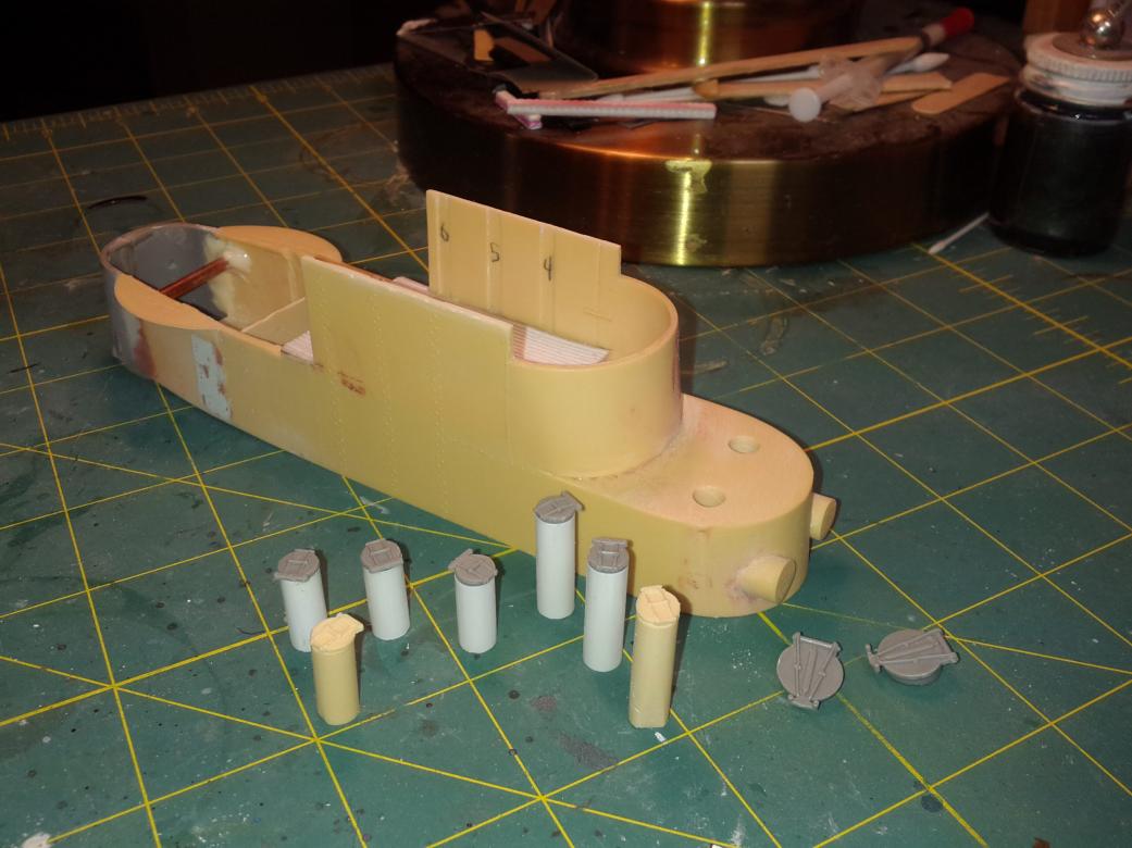

                            First I took a good look at all my various ready lockers and well, they were okay but I decided the kit parts were superior in this case. Well the caps anyways.
                            I took the kit caps and made tubes from plastic tube, resin pieces also shown.

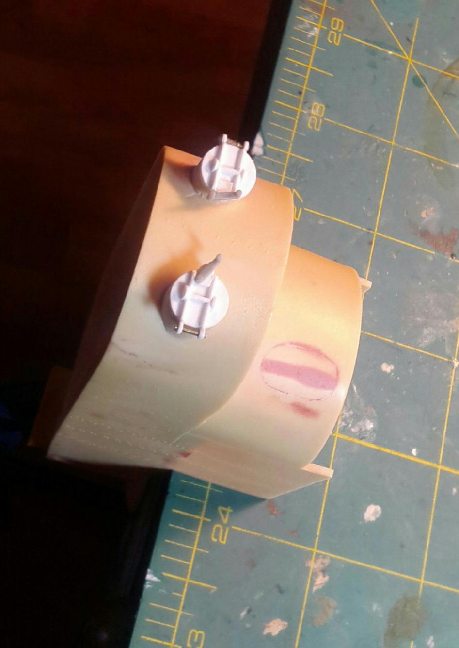

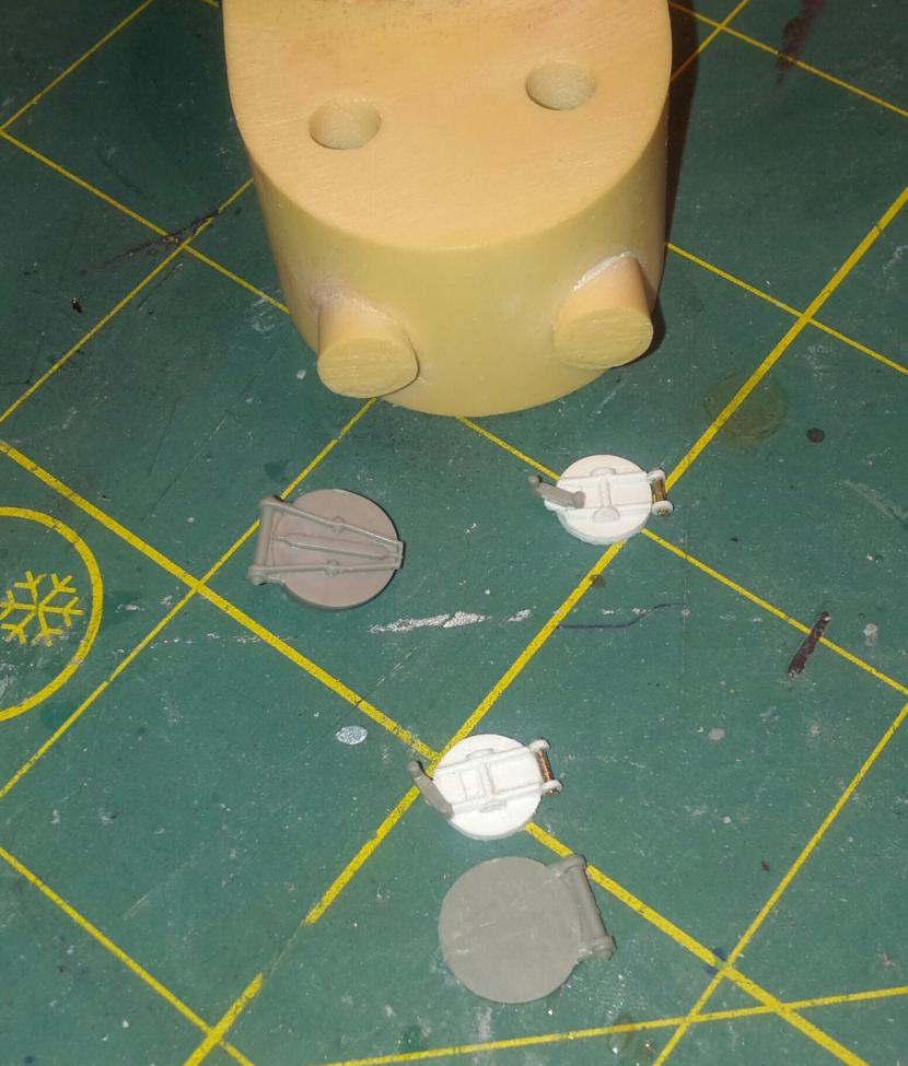

                            Going to the front with the big ready lockers that are built into the structure I was again a little disappointed. Some posts are molded into the Nautilus models resin piece and the instructions are to use the kit caps on these for Silversides or Trigger. Well in the first place the posts are too small for the kit part and the kit caps are of a noticeably bigger diameter when all should be flush. Second the pattern is wrong for my Trigger and the current configuration of Silversides. So I had to scratch two new smaller ones in the right pattern.

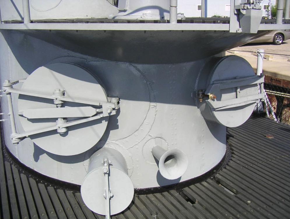

                            Oh, here is Silversides. It seems to have one of each pattern these days. Trigger had the parallel kind versus the triangle kind (Note the not at all silly foghorn).

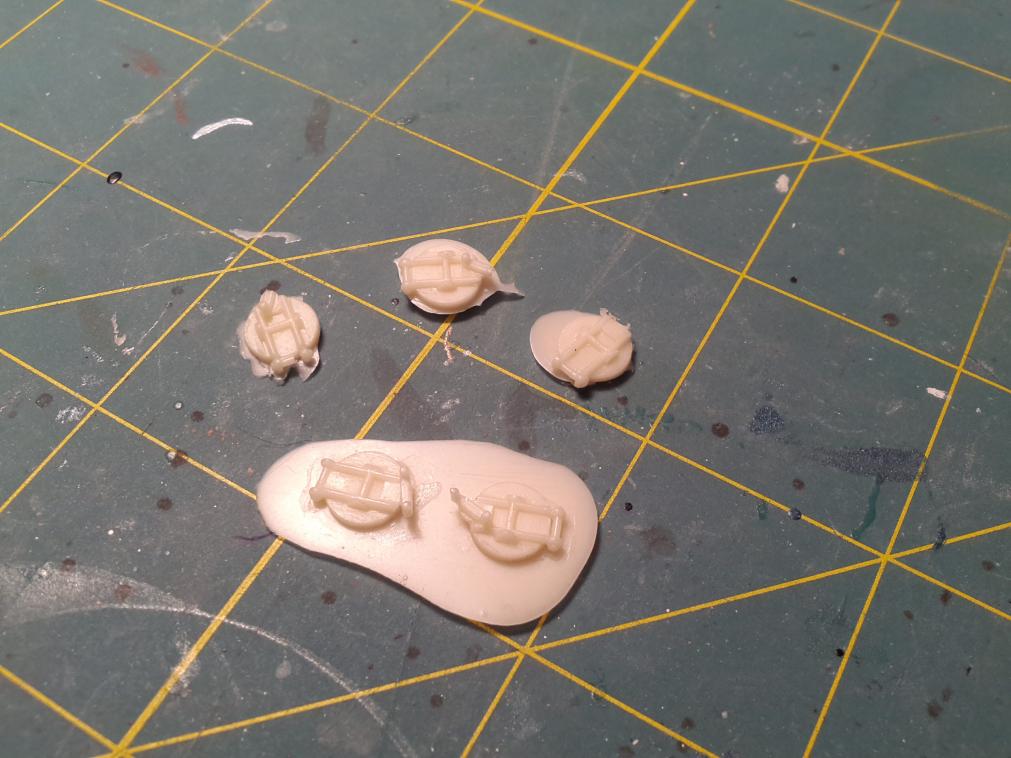

                            I wanted to cast my caps into a more solid resin part and or to share with those in need. I tried casting at one atmosphere (on the bench) but kept getting bubbles and missing details. I had recently bought a painting pressure pot from the Goodwill for $10.00 and this was the impetus to finally try casting under pressure. The parts to convert it from painting to pressure were minimal and I have to tell you the results were outstanding, first try. The handles, hinges, and all the other detail were all there. I'm a believer and it is so simple to add to your casting regimen.

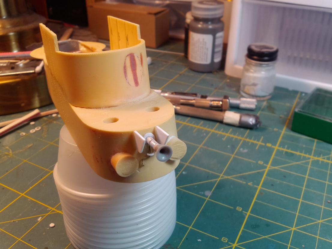

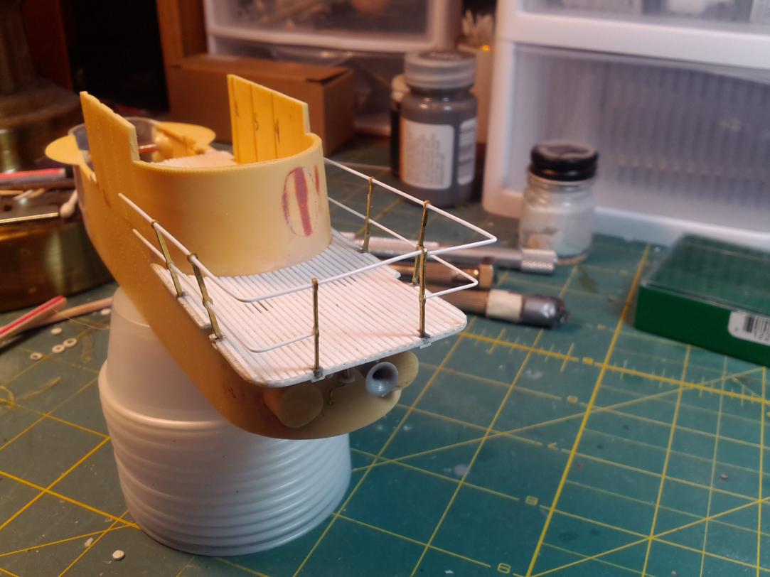

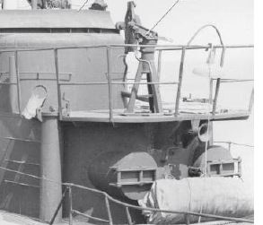

                            Lastly up front here there is the foghorn and gun deck supports. Most references of other boats show only the bell of the foghorn exposed but for some reason Trigger had the whole thing out in the air/water. Frankly it looks a little silly out there but refs are refs. The bell extends all the ways out to the deck gun edge.

                              Great to see one of us getting some work done on these projects. With the forum change, etc. finally setting down I've actually thought about revisiting my old gal. Will advise if it happens. Which stanchions are you using for the forward rail? The whole platform setup looks really nice.
