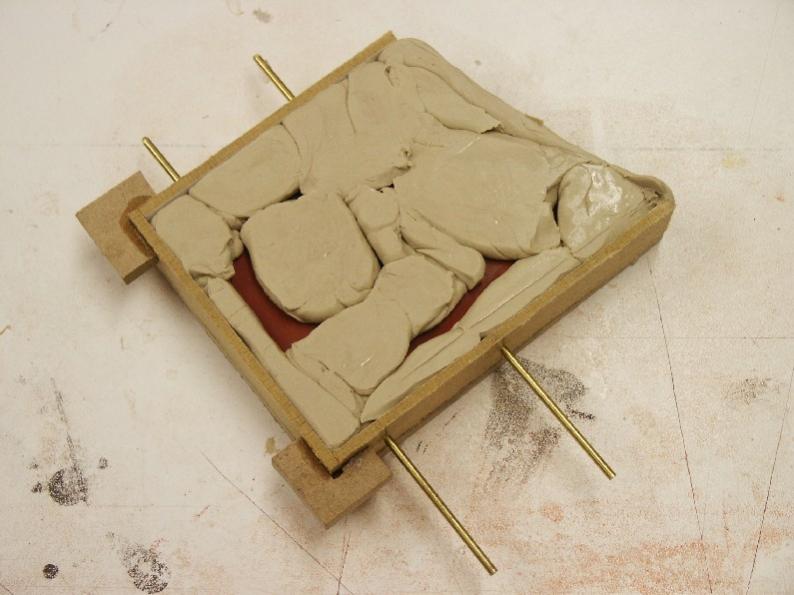

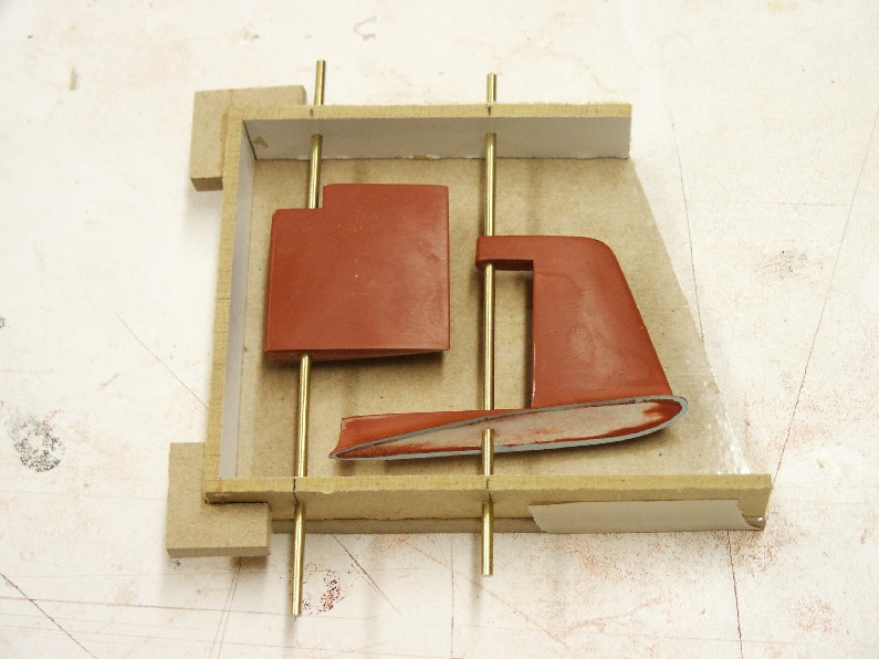

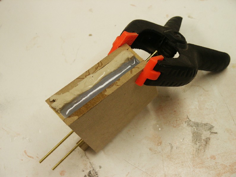

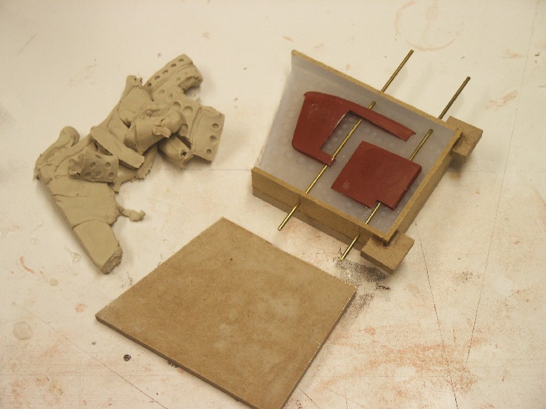

    I built up a 5-walled box again, this time for the ventral fin, but with a slight variation from the previous box. I used MDF as the main "strongback" component for each side, but this time I separated the two halves with 3/4" strips cut from the melamine finished paper board I had left-over from the hull parting board. (I used the melamine finished board for the sidewalls to save me from having to cover it up with packing tape before use. Also, once finished these molds will be large enough that I don't expect I'll need the sidewalls in place to help keep the shape of the mold when casting parts.) I then drilled four holes into the sidewalls through which I passed the 3/32" brass rod for the pivot point in the parts, and suspended the ventral fin and rudder in the box by those rods.
    Next, Clean Clay way wadded up and poked down into the box and under the parts. To work the clay into place and smooth it out I used a variety of knife handles and trimmed popsicle sticks. Once all smoothed out, many dimples were dopped into the surface with the handle of a knife and a 1/8" drill bit.
    Nothing to do now but clamp down the other strongback, seal it with masking tape and pour in the rubber...

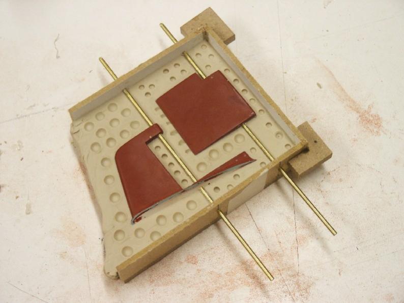

    Having been allowed to kick-off over night, the mold halves were separated this morning. Here's the side of the clay that was not exposed to the rubber...
    Finally, here's the mold with all the clay removed.
    Tonight I'll brush down all the exposed rubber surfaces with laquer thinner thinned vaseline (to act as a parting agent), then reassemble the box and pour in "side two".

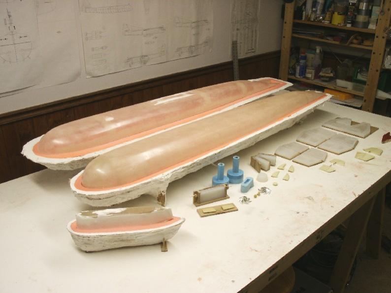

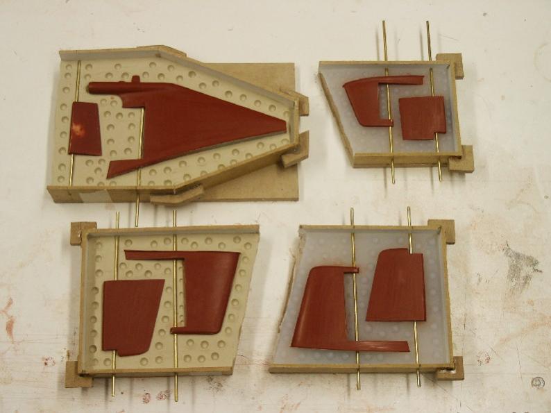

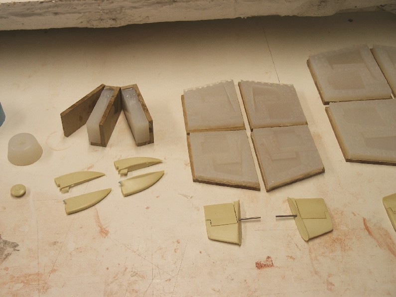

          Back to work! I've been busy pulling test shots from each of the molds. Here's the result from the past weeks work

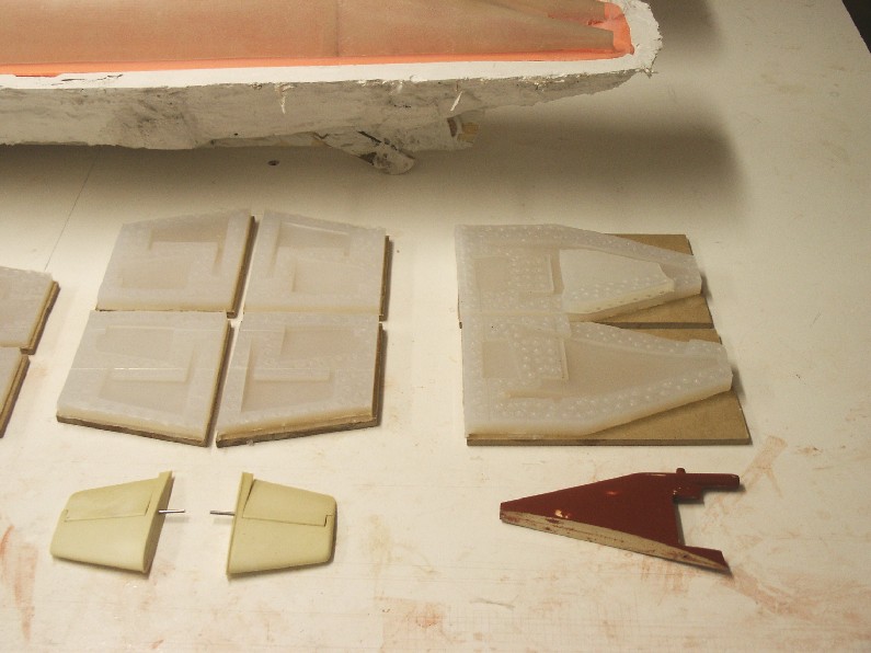

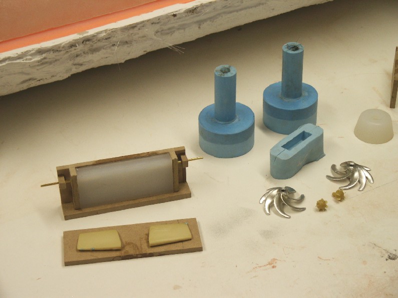

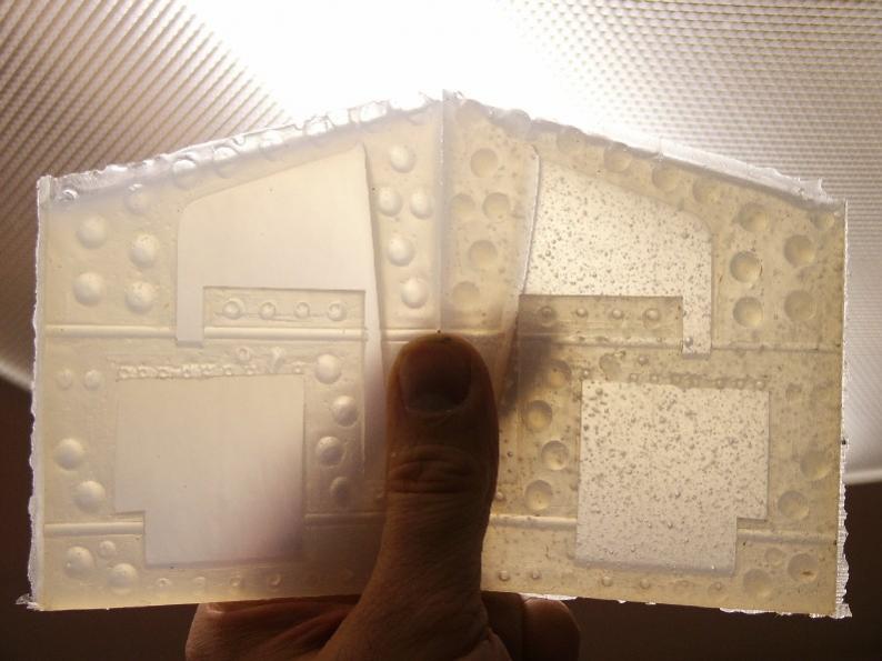

          Here's a few closeup shots of the detail bits.
          Not visible in the detail shots, I've even managed to cast brass support bushings into the fixed portions of all the appendages so there is no resistance to motion in the finished assembly. I dunno if it's really necessary or not, but I figure it can't hurt.

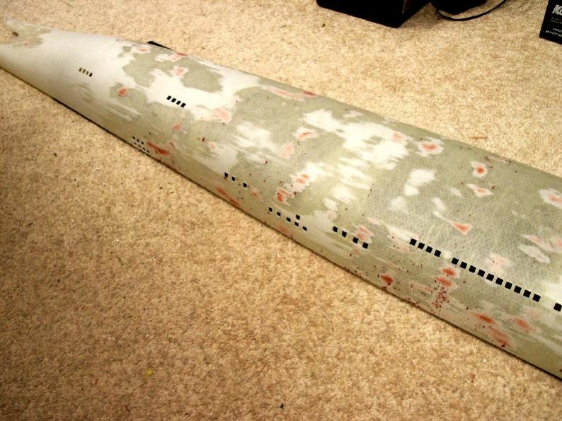

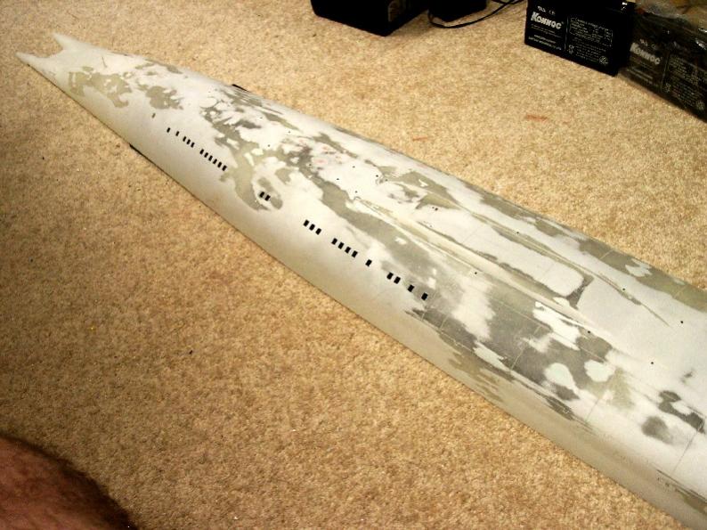

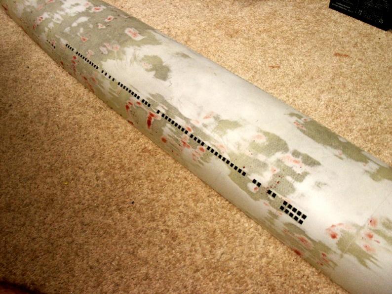

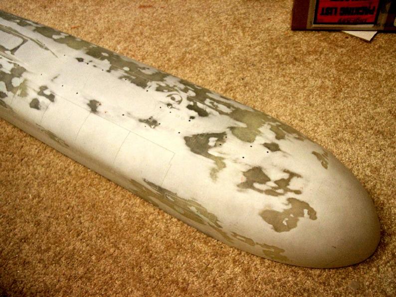

                          Actually, as I'd mentionned earlier work took me away from this little project of mine for the better part of a month, but I dug back in the beginning of last week and I now have something to show for it.
                          The first thing for me to do was to give the hull a light prime to bring out the surface flaws. (As an aside, the surface flaws in the images below will not be present in any of the hulls I sell- I'm using the "second" for myself.) The surface imperfections were filled in with red putty, and the sanding cycle was also used to highlight the flood/drain hole locations. Vent and drain holes were drilled through and then filed square. (All 270 of them!) FWIW, the filing exercise took me the better part of last week, so that's why there were no photos- nothing much to show. The results, however, speak for themselves
                          And the lower half...
