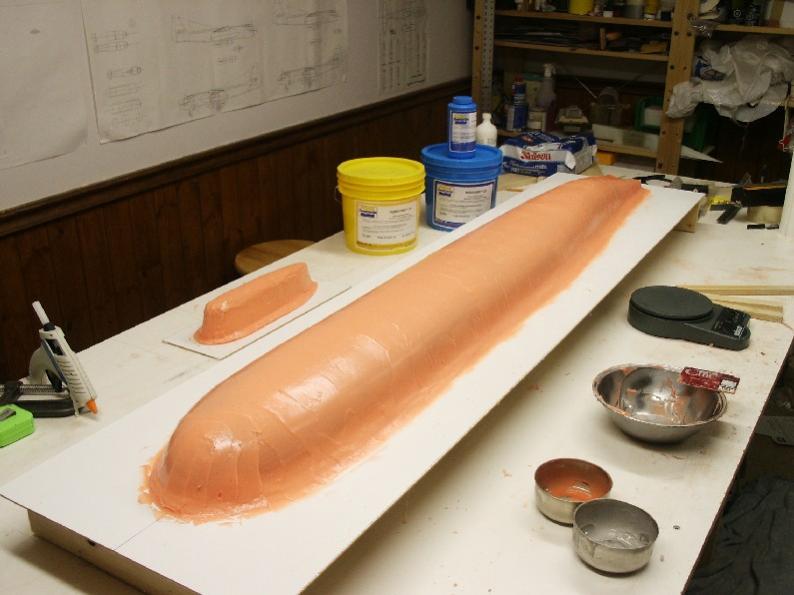

    I troweled down coats 3 and 4 onto the hull and sail molds last night. The Rebound 25 in it's natural state, as I used it for the second layer, has a consistency a little thicker than liquid honey. Mixed with just 1% (by weight) of the thixotropic additive, it turns to peanut-butter. No kidding, I couldn't have put this stuff down with a paint brush if I tried! Being as thick as it was, I used an old credit card to smear down coat number 3, and once down on the hull it didn't sag a bit. Four hours later I came back and smeared down coat number 4 using the same process, and here is the result.
    The only thing that remains to do now is to add some keying features on the RTV and then I can get going on the hardback.

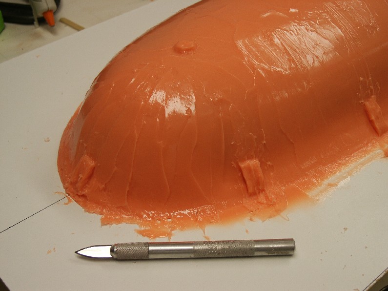

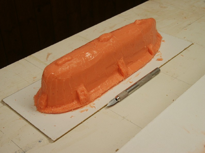

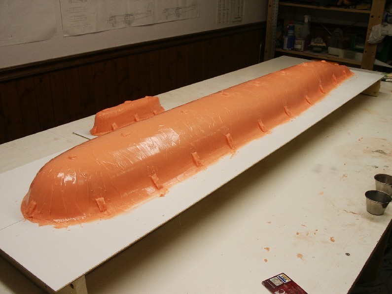

                        Per recommendations, I put a fourth coat of Rebound on the mold, and took care to ensure that the surface had no large protrusions or crevices that would lock into the mother mold.
                        Next, I deliberately put some features around the periphery of the mold that would lock into the mother mold (in a controlled way). These features were built up from really thick RTV and should hold the RTV component into the mother mold like a dome-snap. I also put some non-locking features along the top of the molds to help center the RTV tool in the mother mold.
                        As a final note to anyone wishing to use this technique, I've been told that my keying features would lock things in better had they been aligned longitudinally instead of radially. (ie having their long dimension running lengthwise insted of across the side of the hull.)

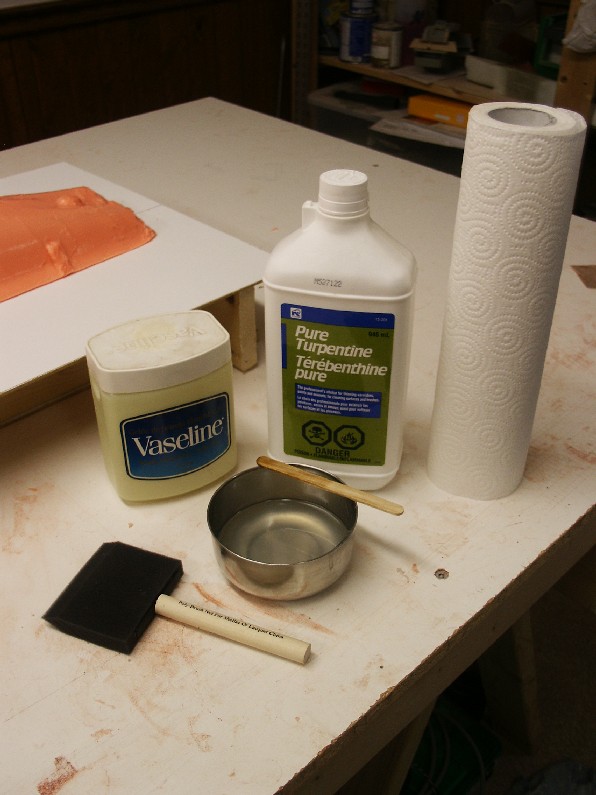

                              Plaster time! But before we get there, I should point out that it's also worth while making sure that the RTV doesn't stick to the plaster at all. To do this I thinned some Vaseline with turpentine in a stainless mixing bowl until it flowed freely. Then I brushed the mixure onto the RTV and parting board using a foam brush.

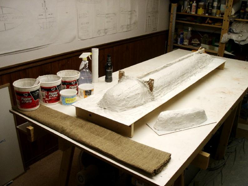

                              Now on to the plastering. I would have liked to use Ultracal for this, but I couldn't find any promptly so I reverted to using actual plaster. I'm going to apologize up front that the photos just "jump to the end", the fact is that the plaster set up so fast I just didn't have time to pick up the camera!
                              Here's all the stuff needed, and the completed hull and sail shells.

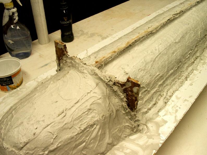

                              To make the above I went through three 4lbs buckets of plaster and about two yards of coarse burlap. Not to be confused with the thin stuff found in the gardening store, this stuff has some good body to it and was found at a local fabric shop. Boy did I feel out of place in there! The final shell thickness is just over 1/4".
                              Laying it all down was quite easy- just mix up the plaster and smear it down. Go get your burlap damp in the sink so it will take the plaster more easily. Mix up another batch of plaster, drop the burlap in the bucket and lay it down on the hull.
                              One of the features to note on the shell is the integrated stand to prevent this sucker from rolling on me when I lay up the hull. This is nothing more than a suitably cut piece of 1/4" plywood. The other feature to note is the wooden "spine", made from a slice off a 2X4. (Pine I guess?) This should provide a bit more strength to the plaster shell.

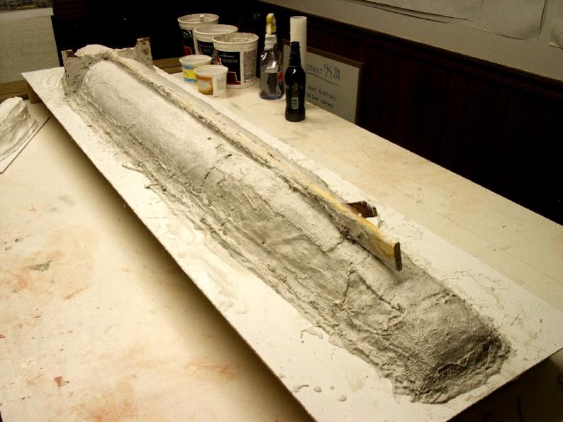

                              Another shot of the spine. Not captured in this photo ('cause I didn't add it until later) are some additional burlap strips that I ran over the spine and down onto the shell. I found that the pine didn't bond well to the plaster, so I wanted to lock it in with some additional material.

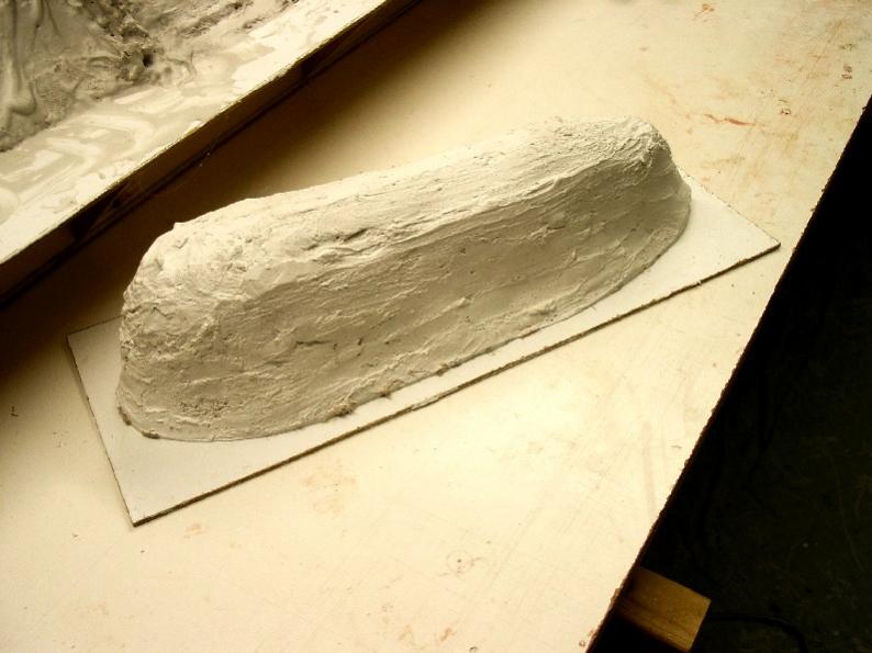

                              Here's a detail shot of the sail shell. This was allowed to set up for a full 24 hours before moving, but then...

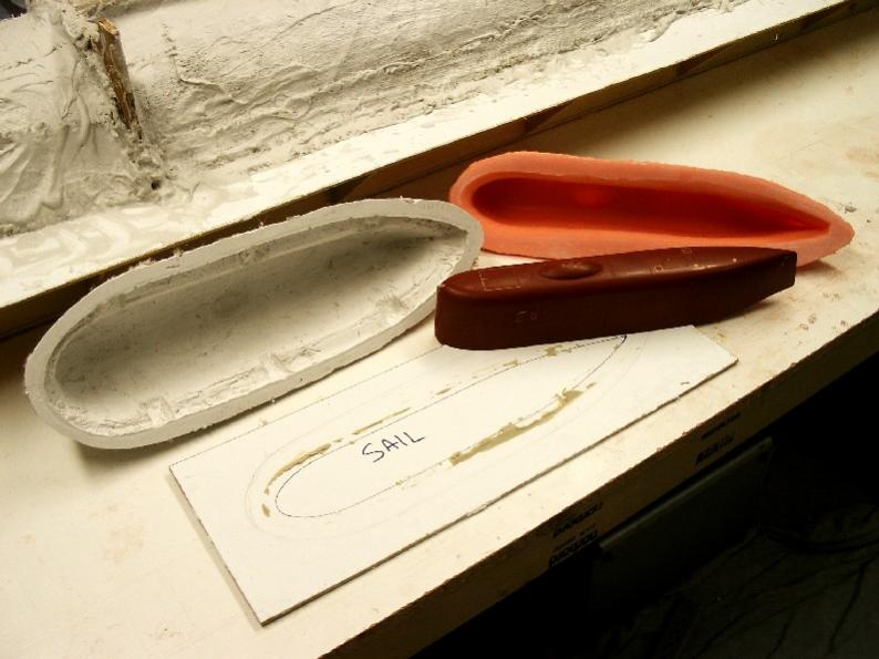

                              Demold time! I lifted the shell from the base and found that the RTV and master came with it. No matter though, with a tug on the RTV glove the whole inner portion slid right out. Next, the RTV was peeled back from the sail master leaving it completely free of any damage. Now I'm ready to make sails!

                                Kevin, may be too late but, if I were you I'd encase that wood spine in a wrapping of some of that burlap and plaster before removing the shell so it won't wiggle loose on you. As well, any movement of that piece of wood while removing or laying glass could send cracks out throughout the entire piece, causing it to crumble. I've had molds do that on me.
