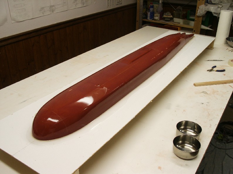

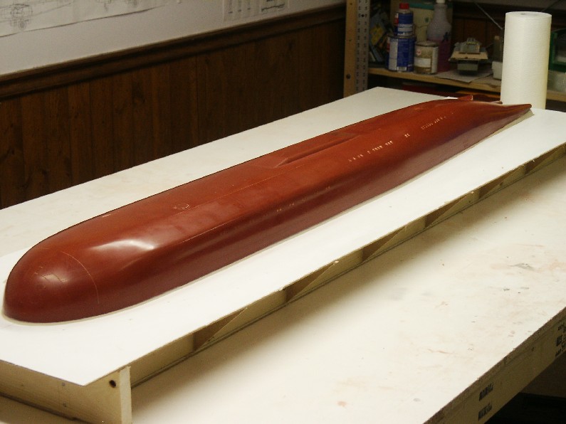

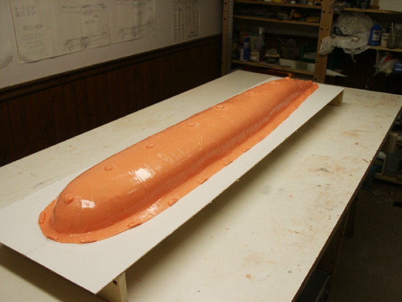

              Now it's time to get back to the hull- this time doing things over again on the top side. This is identical to doing the bottom side, but I've grabbed a few shots anyways...
              Clayed up in the parting board. As before, I've set the hull into the parting board so that I'm at least 1/4" above my scribed reference line. Although this means I'll have to trim my hull halves when pulled from the mold, it also means that I can trim the hull halves to mate perfectly when assembled...
              "Glazed" with a detail coat of SmoothSil:

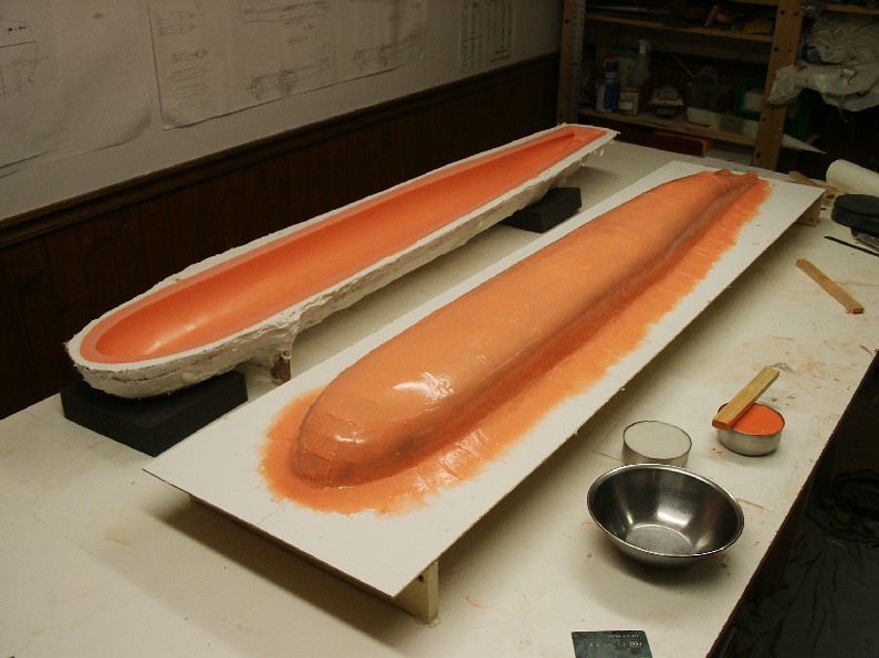

              ...And layered with about 2 coats of Rebound. Notice the unmixed RTV components in the smaller SS dishes. This will be layer 4 of 5. Also notice the lower half hull mold at the rear of the table.
              As of last night I completed putting layer 5 of 5 and the alignemnt keys into the mold (no photo yet) so I'll be back to plastering this weekend...

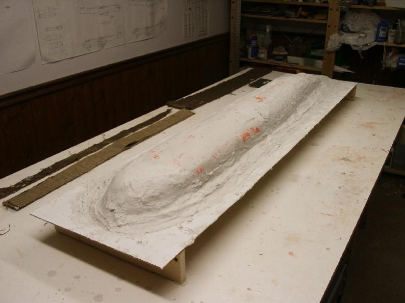

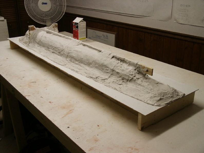

                Now onto the plaster. Basically the same as last time, except for the fact that this time I've made sure to get a layer or two of burlap under the areas where the the wooden reinforcement spines will be placed- this seems to be a weak point on the first half of the mold and will be something I'll have to take extra care over.
                Last shot- all the plaster and burlap is down, as is the spine. Notice the fan to help get all the water out- this thing will be damp/cool to the touch for a couple of days!

                        Hi Pete,
                        Would you believe me
                        Hi Pete,
                        Would you believe me if I told you that the RTV in the "shiny" shot is completely cured? No kidding! Once mixed, I poured the SmoothSil where I wanted it and smeared it around with a disposable paint brush, then in less than a minute all the brushstrokes disapear and you're left with nothing but a glassy surface. Of course this gets completely covered up with the orange coloured Rebound...
                        Once backed up with the Rebound, I'm told that the SmoothSil is a fantastic surface to lay up against. Because it's a silicone, nothing (exept silicone) will stick to it. I can't wait to try laying up parts in this stuff- I always hated the wax-wax-wax-buff-buff-buff cycle. None of that here!

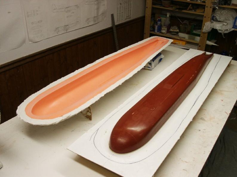

                              After allowing the upper strongback to harden up, I separated the hardback from the RTV component of the mold.

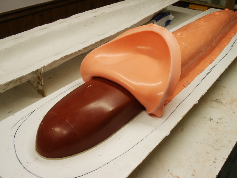

                              When talking about RTV molds I always thought it was funny when folks talked aobut peeling away the RTV component from the master, but for anyone that's not tried I assure you that's really how it goes down. I snapped this shot "mid peel"...

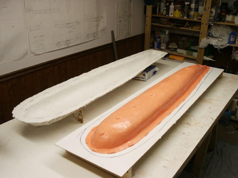

                              And here's the resulting 2-part mold (side 2) and pristine master. It, the lower half mold and sail mold are now ready to start pulling hulls from...

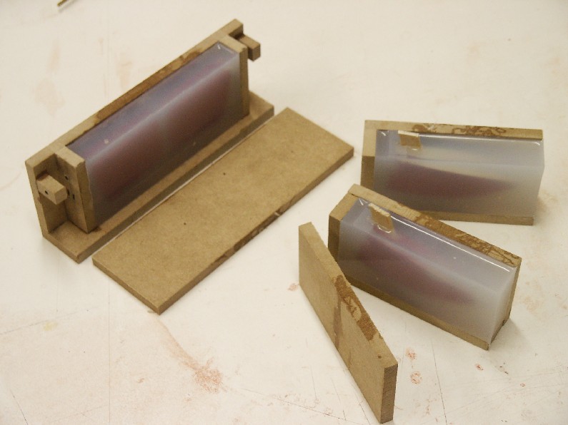

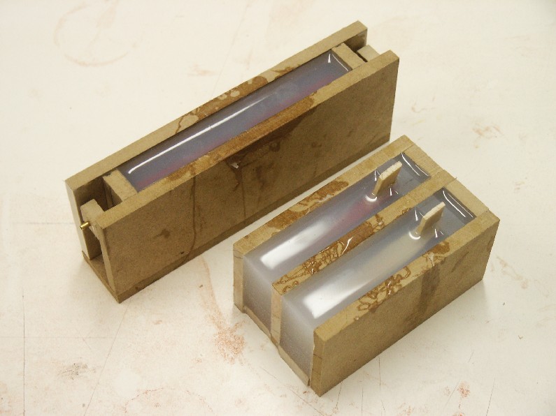

                                In my absence from posting in the past few days I've been working out how to make the mold boxes for all my appenages. I decided to build simple boxes from 1/4" MDF. Why MDF? It cuts nicely on my bansaw, it's much lighter than the more popular 3/4" shelfboard, I can buy it in small sheets (24" x 24") and it's cheap! The only downside is that the unfinished surface is lousy for casting RTV against, so before use I "seal" the surface with a layer of clear packing tape.
                                I've started with the simplest molds- those for the fore and aft reactor cooling scoops and the bowplanes. These will be cast into 1-piece molds that will be sliced open to extract the part. I built 5-sided boxes to contain the liquid rubber, suspended the part in the box and poured the rubber in. Here are a couple of shots showing the cast mold with the boxes in their assembled and disassebled states.
                                A further note on casting with RTV- as noted earlier, I'm using a platinum catalyzed Smooth-On product. Being platinum catalized, the rubber undergoes no noticeable shrinkage during the vulcanization process, so the mold boxes that I build before casting still fit perfectly after the molds are made. (This would not be the case with the less expensive tin-catalized type RTV which does exhibit a measurable shrinkage while vulcanizing.)
