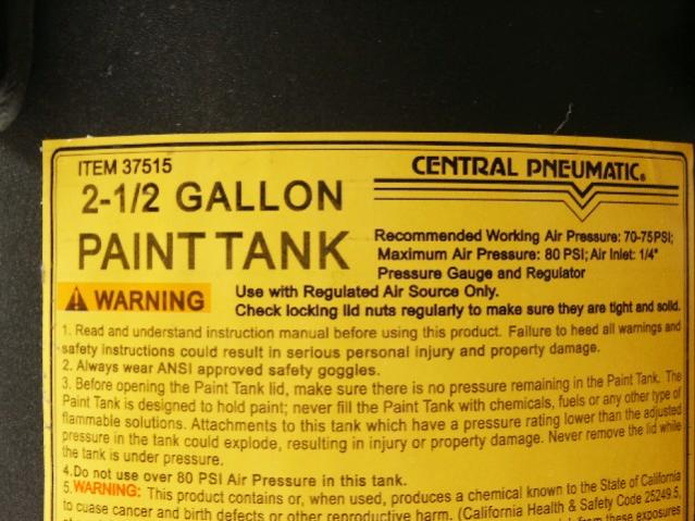

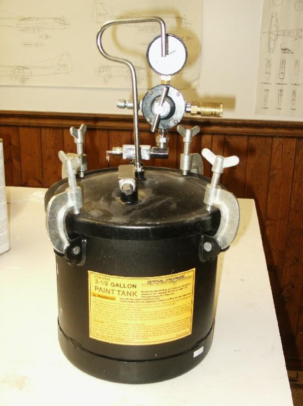

              Okay, since a picture is
              Okay, since a picture is worth a thousand words I'll save myself a bunch of talking and just show these- This is the Harbor Freight pressure pot I've been using to cast my RTV molds and polyurethane parts in.

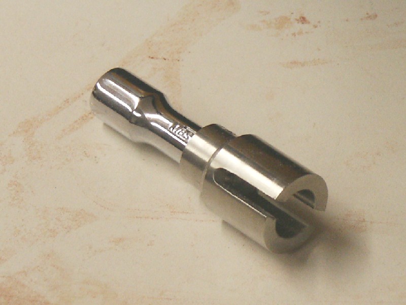

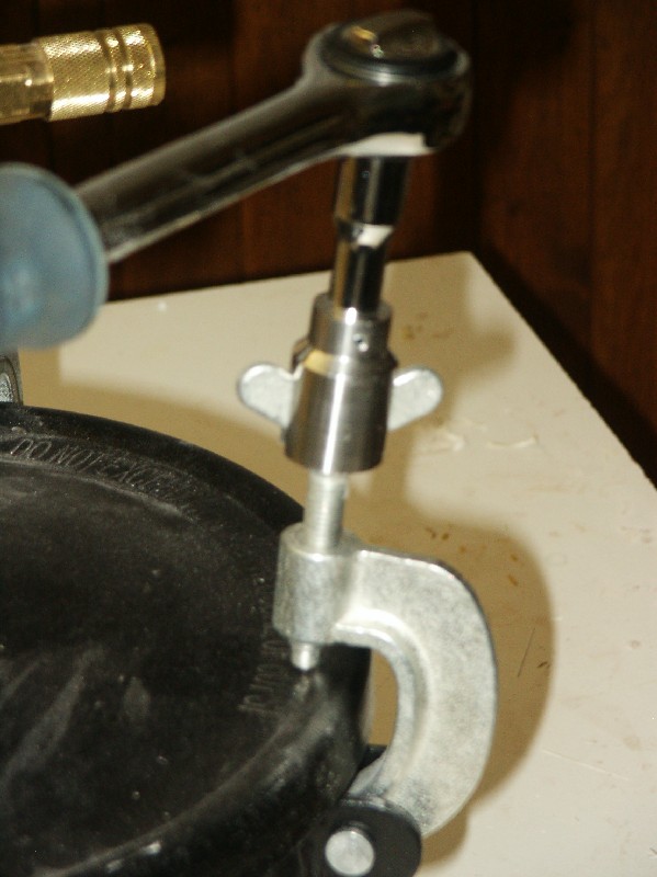

              As mentioned in my last post I was having a devil of a time getting the lid cranked down tight enough so that it wouldn't leak when I brought the pressure up to 70psi. My fix was a special "socket" I turned off that would let me drive down the wings using a 3/8" drive rachet. The upper end is just a cut down 3" socket extension, the lower part is the custom made "socket", and the two pieces are held together with a 1/8" roll pin.

                  Nice socket Kevin. I need
                  Nice socket Kevin. I need one of those. I use the same pot, but if I crank really hard I can get mine to seal almost all the way. Far enough that mu compressor tank doesn't run down enough to lower the pressure before the part is cured.
                  I only go to 50 psi and that seems to be plenty. Why so much pressure?

                    I've been using 70psi
                    Hi Pete!
                    I've been using 70psi for no better reason than "that's what the pressure pot is rated for." Naturally, the higher you go in pressure, the smaller any remaining voids will be.
