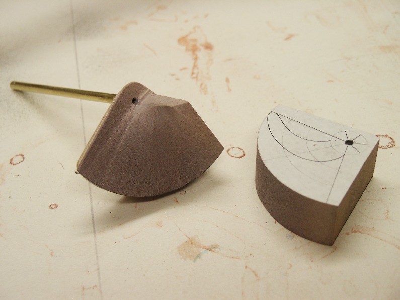

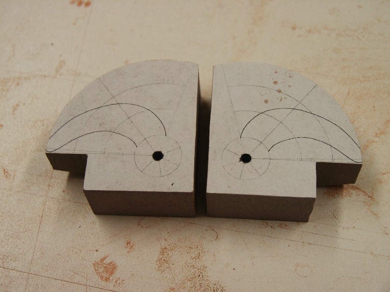

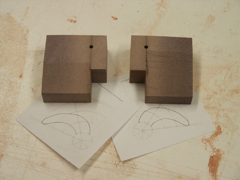

                    After a long week of too much work, I finally found some time on the weekend to get back at the important stuff. Since I can't find the exact prop I need for my OSCAR II, I've begun the process of making them myself. I'll be building them (left and right) using the same process David Merriman uses when he makes his props

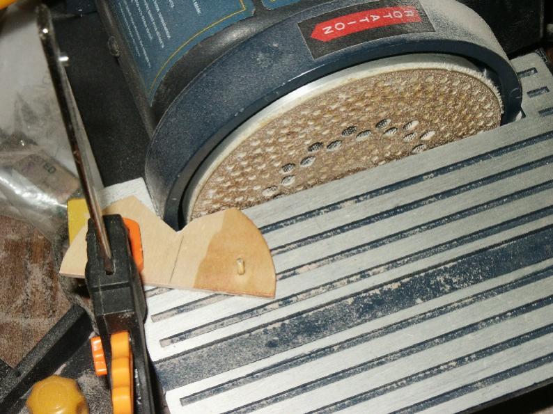

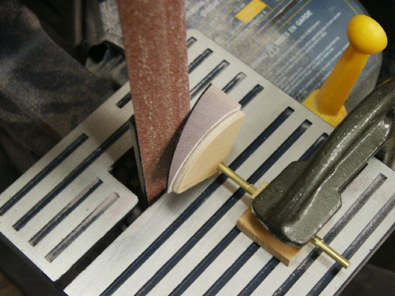

                    Next I trimmed the blade blanks to the correct radius. This was done with a simple jig on my 4" disk sander.
                    Next I marked the arc that the blade will follow along the outer circumference using a piece of 1/32" Chartpak tape. (I've skipped the math used to determine the thickness of the blank, and the arc covered by the blade blanks, but take my word for it that my 2.15" dia prop will advance by 2" given one revolution.)

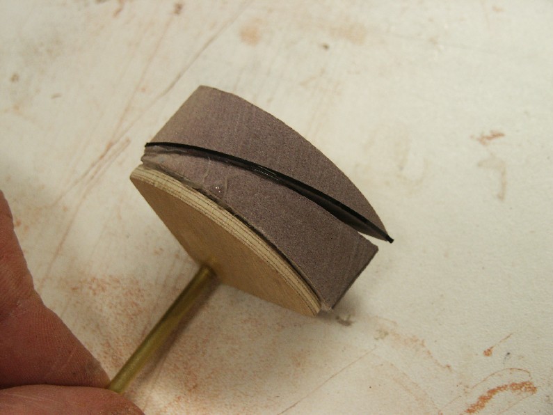

                      #235
                      Now for the magic...
                      Using hot

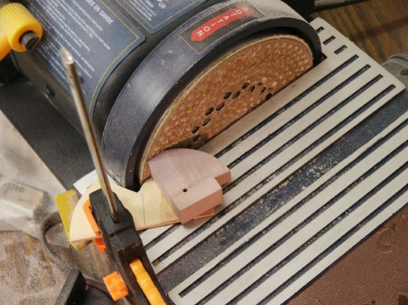

                      Using hot glue the blade blank is mounted to a piece of brass tube with a plywood 'foot tool' to keep everything perpendicular to the tube. I also made a simple block-jig that would hold the tube on the 'foot tool' parallel to the work surface. (Or more importantly, perpendicular to the belt sander.) The whole assembly was lined up exactly with the edge of the belt to that I could sand a helical path into the blade blank. (The block-jig allows the foot-tool to slide and rotate and only constrains the parallelism of the part with respect to the belt.) Ugh! Here's the pictures, I hope this makes sense.

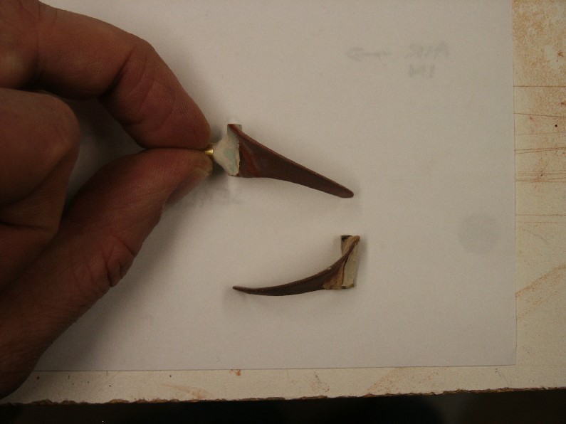

                      Now on to side two- Using the same technique I made a mating "base" and hot-glued it to a second 'foot tool'. Then, using a piece of brass rod to ensure alignment and hot glue to hold everything together, I glued the real blade blank to the second foot and broke away the first 'foot tool'.
                      Following the same process as above, I again ground away the excess material to create a 1/32" thick helical "cork-screw" that is all ready to be carved to the shape of the blade.

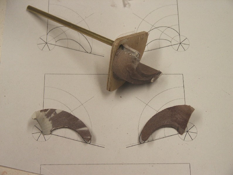

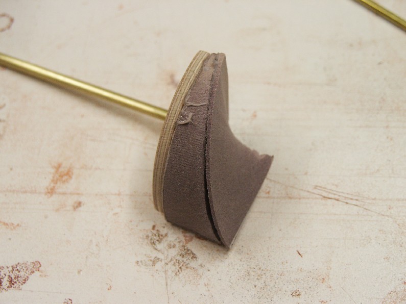

                      The blade was once again mated to a sacrificial piece of renshape, this time with the final shape of the blade pasted to the upper surface. This "blade sandwitch" was taken to the belt sander to put the final shape to the blade. Here's the result:

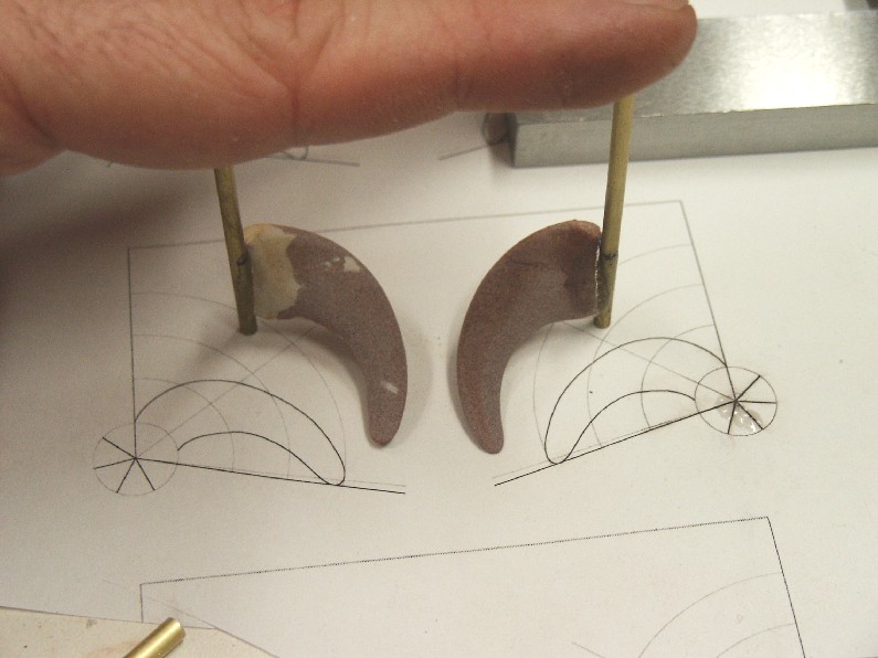

                      Finally, I glued each blade to a piece of brass tubing for final shaping.
                      Although somewhat jig-intensive, the result of this technique is a blade master having a uniform pitch across its diameter. Now for some final tweaking, then for a swim in RTV...

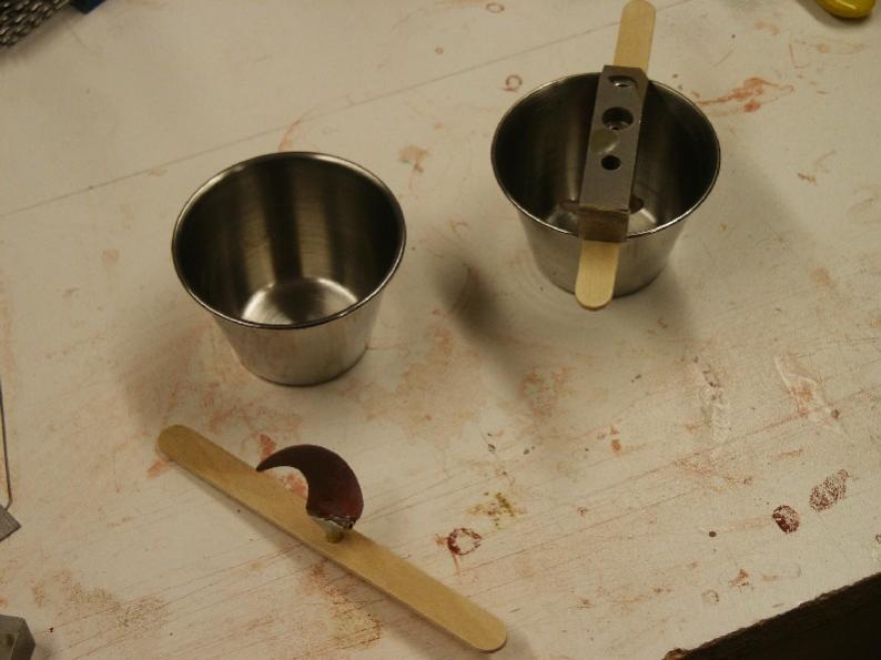

                                But before I get to that, I want to share another hard lesson learned. This story begins with a gift from a well meaning older gentleman in the local boating club. He began scratchbuilding a Nautuilus many moons ago, and saw that many of the things he'd done along the way were very applicable to what I'm currently working on. One of his experiences was casing parts, but he'd done it with a re-useable hot-melt vinyl molding compound, which he most graciously gave to me. (I believe it used to sell under the name Vynamold?) If anyone ever offers it to you, thank them kindly and RUN AWAY!!!
                                I actually burned my first batch, warmed in a tin can on the stove. The second batch, heated in a decomssionned toaster oven, came out beautifully. So I preparred one of my prop blades for molding in a stainless steel cup.

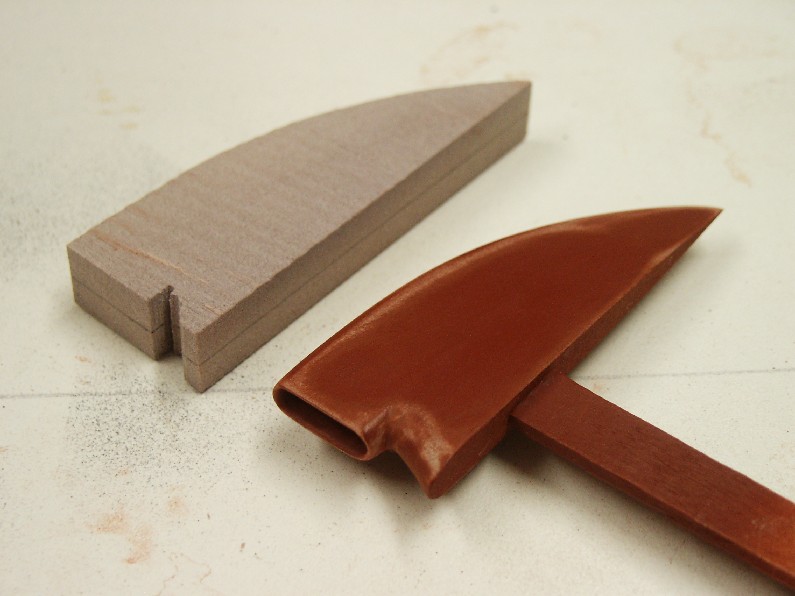

                                The results were not pretty! The heat from the molten vinyl also badly distorted one of my propellor blades, and didn't want to release from the RenShape.
                                Fortunately all is well that ends well- I kept all my prop-making tooling and withing about an hour I had a replacement blade turned out. I'm currently on try number two using the RTV I should have used in the first place...
