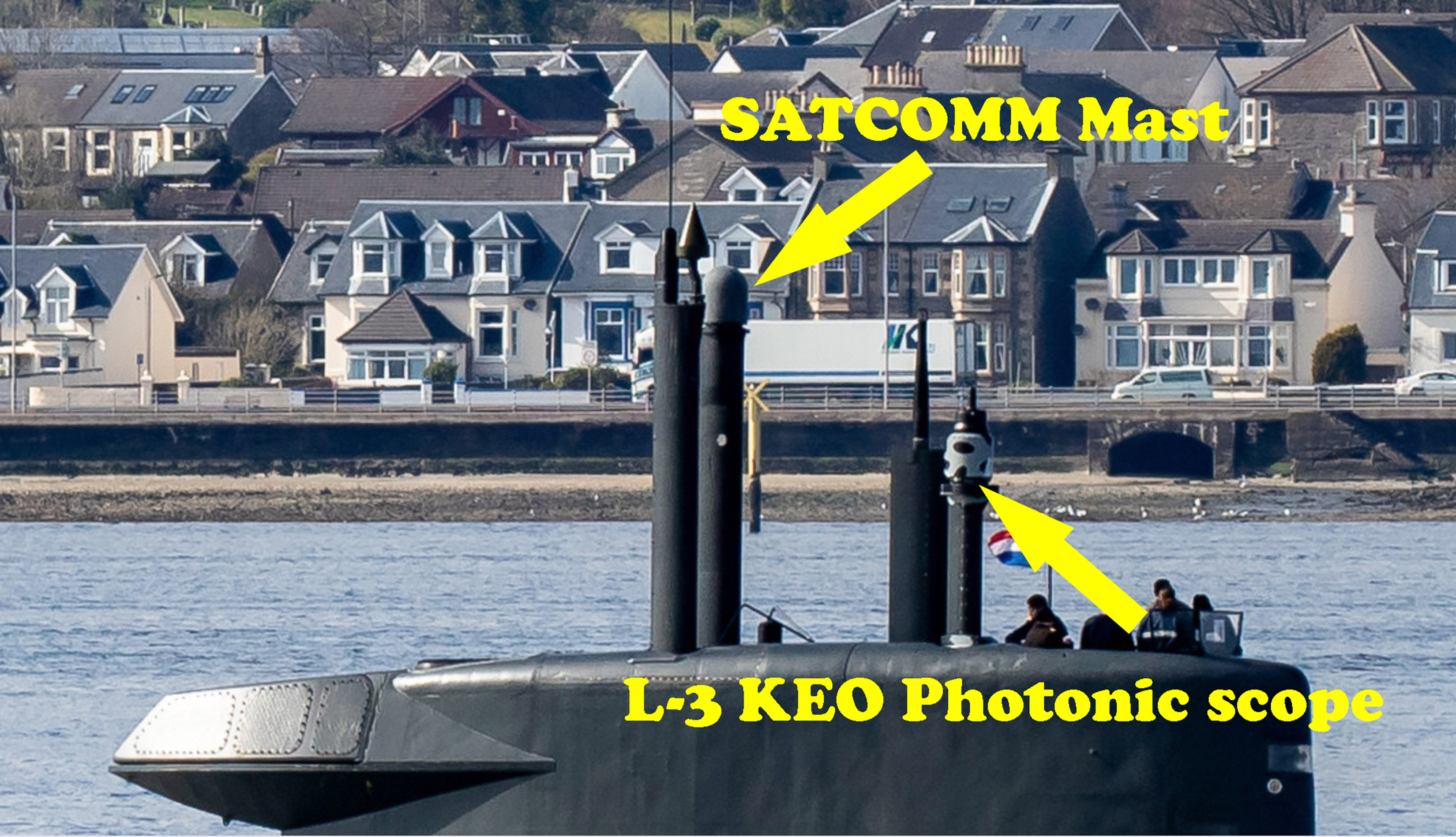

          Working on an upgrade to the Walrus. I am creating a L-3 KEO Photonic Periscope. I have no idea of dimensions, so I eyeballed it as best I could.
Name:	L-3 KEO Periscope.jpg
          We will see.

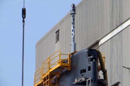

              Here is one of many photos I scrounged around for.

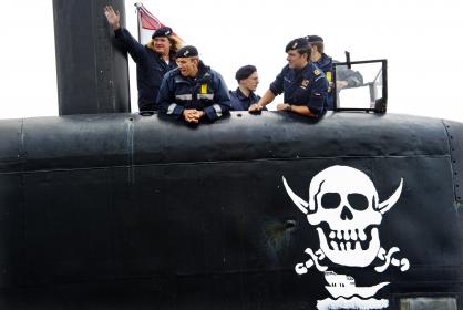

              The only bummer is the Pirate emblem was not with the new scope and I do not know if they still use this emblem - This was a mission for pirate interdiction, as I understood it.

                              Since I was upgrading, I realized there is another mast I needed to create. The SATCOMM mast.
                              Here is the drawing.
Name:	Screen Shot 2020-10-25 at 10.44.09 AM.jpg
                              It came out o.k., but the paint is drying, so, I will do a photo after they are mounted.
