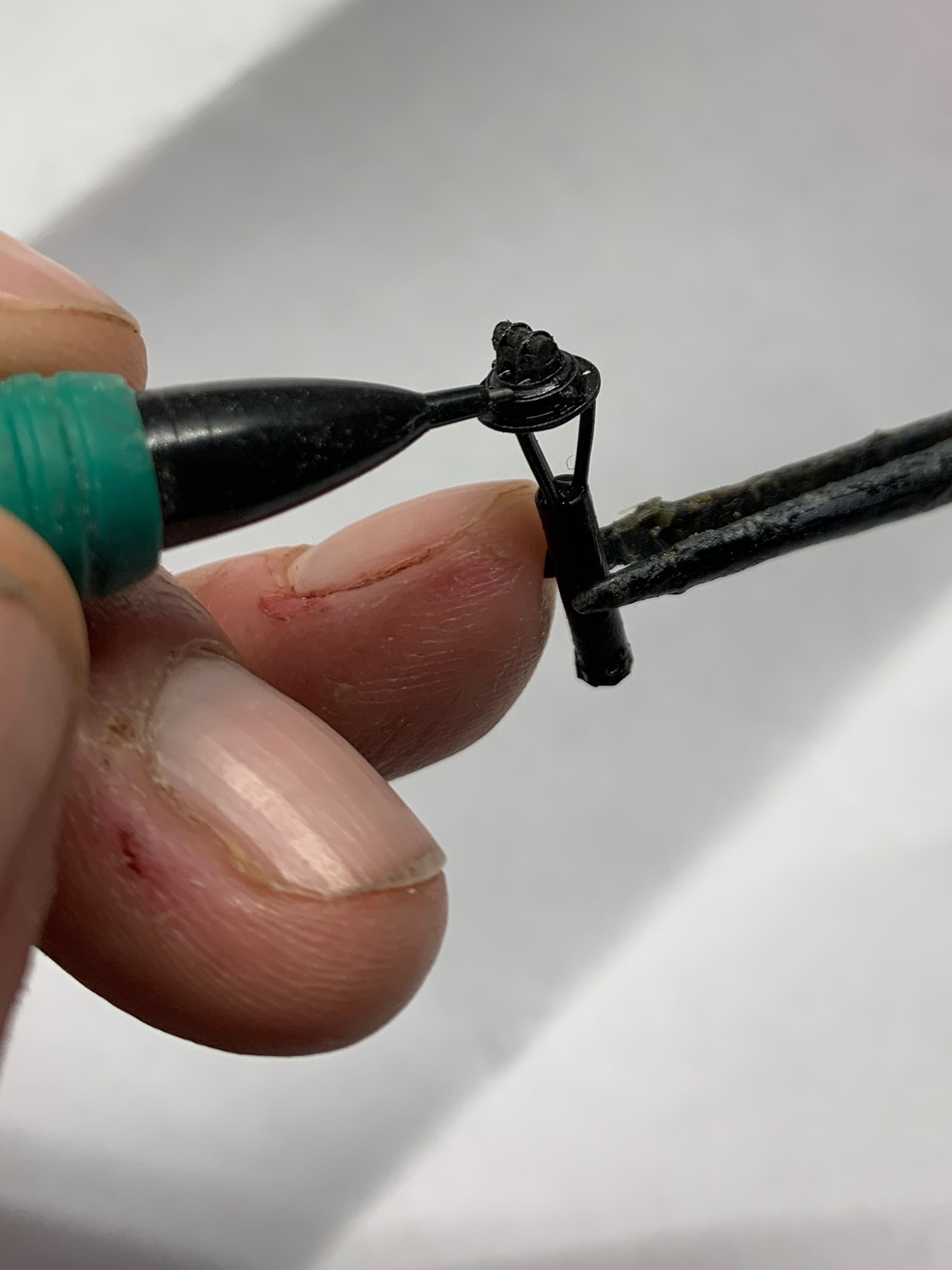

      The Dutch word for what I was calling a compass repeater is "Peilorus". I was told it is "for measure to other ships". Around the tube on top is a ring that has markings. On some photos it is white with black ticks for 360 degrees, others it looks darker, but not sure. So I wanted to make it lighter, but not white.

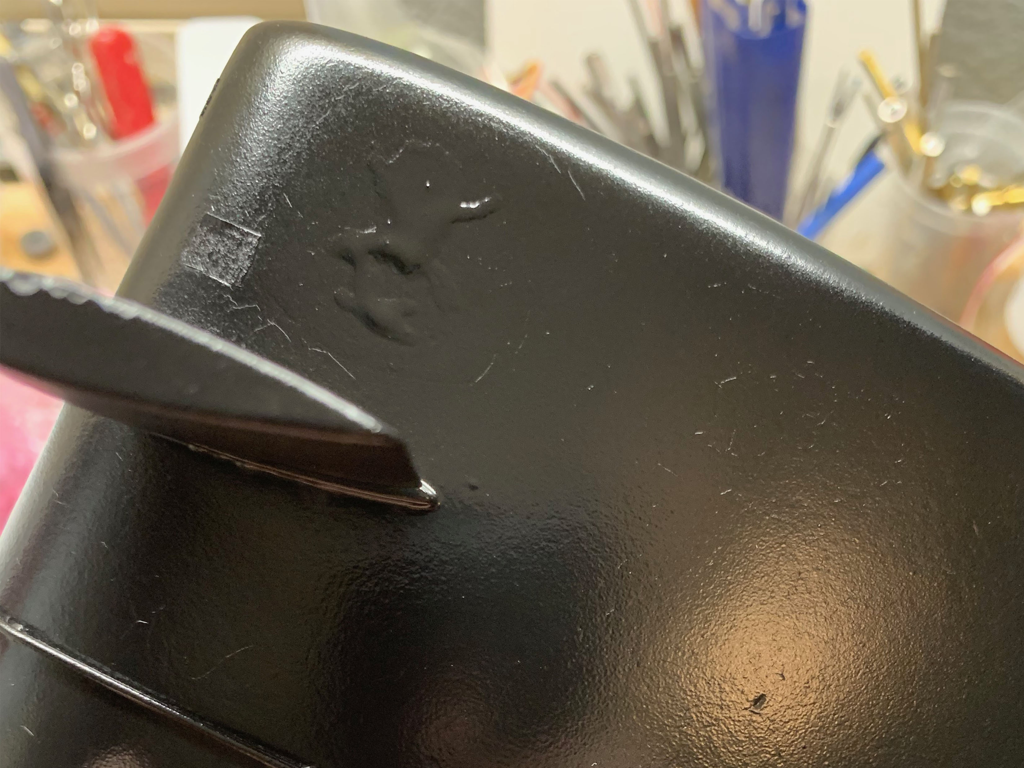

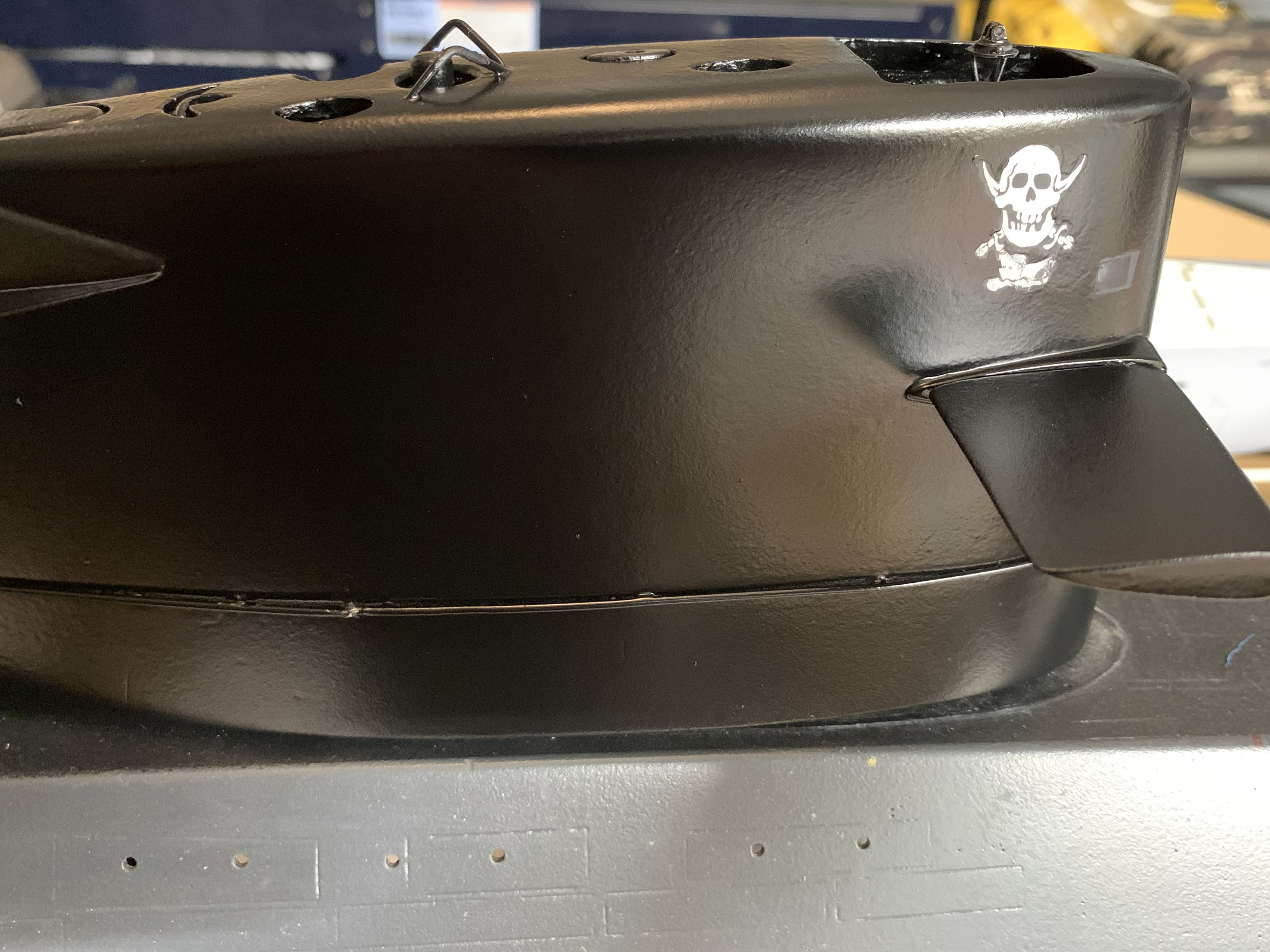

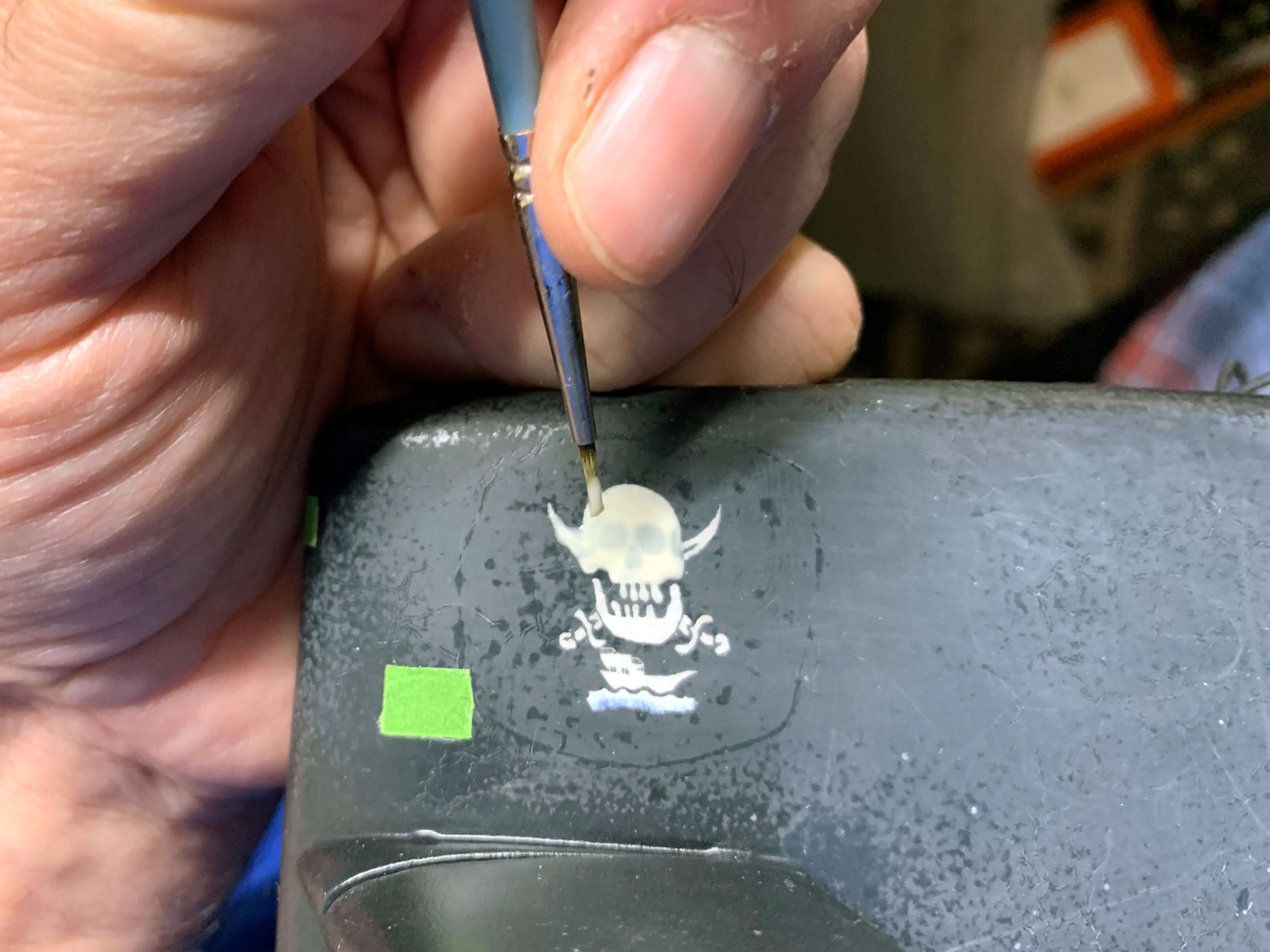

      I sanded the sail with 600 grit wet/dry sandpaper and wanted to keep the skull and crossed swords. So, I did something I have not done since I was a young man. To mask the decal, I used wood glue.
      Now I used to use white glue, but did not have or could not find. The wood glue should work.
      Painted it over the decal.

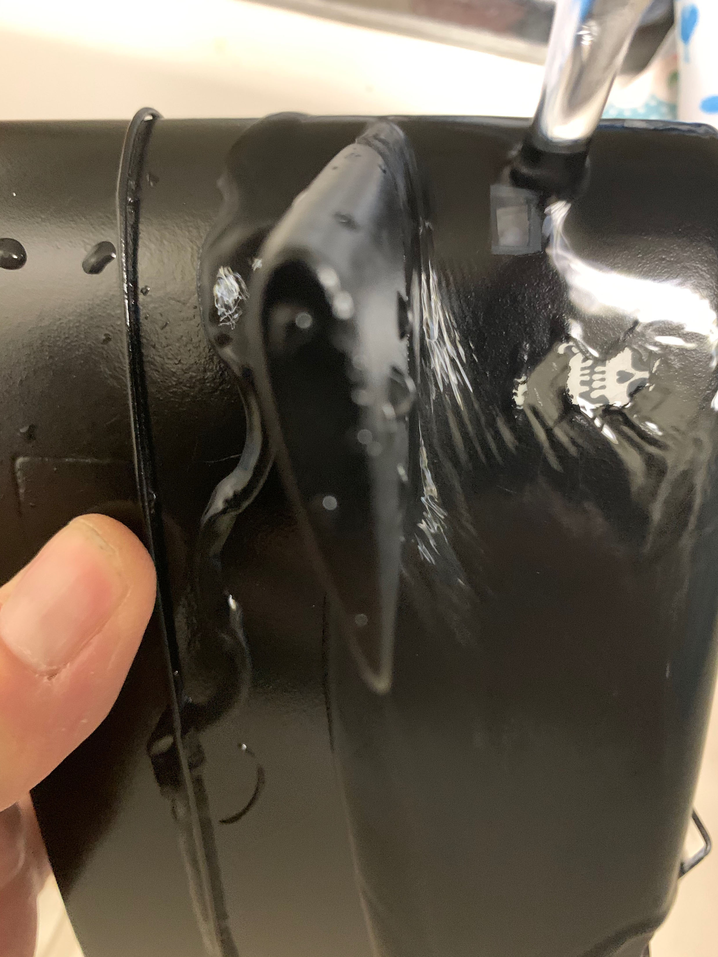

      Let the paint dry for several hours and then under running water, began picking at the wood glue area. It did not come off as easy as I remember, but I used my fingernail to work it off.

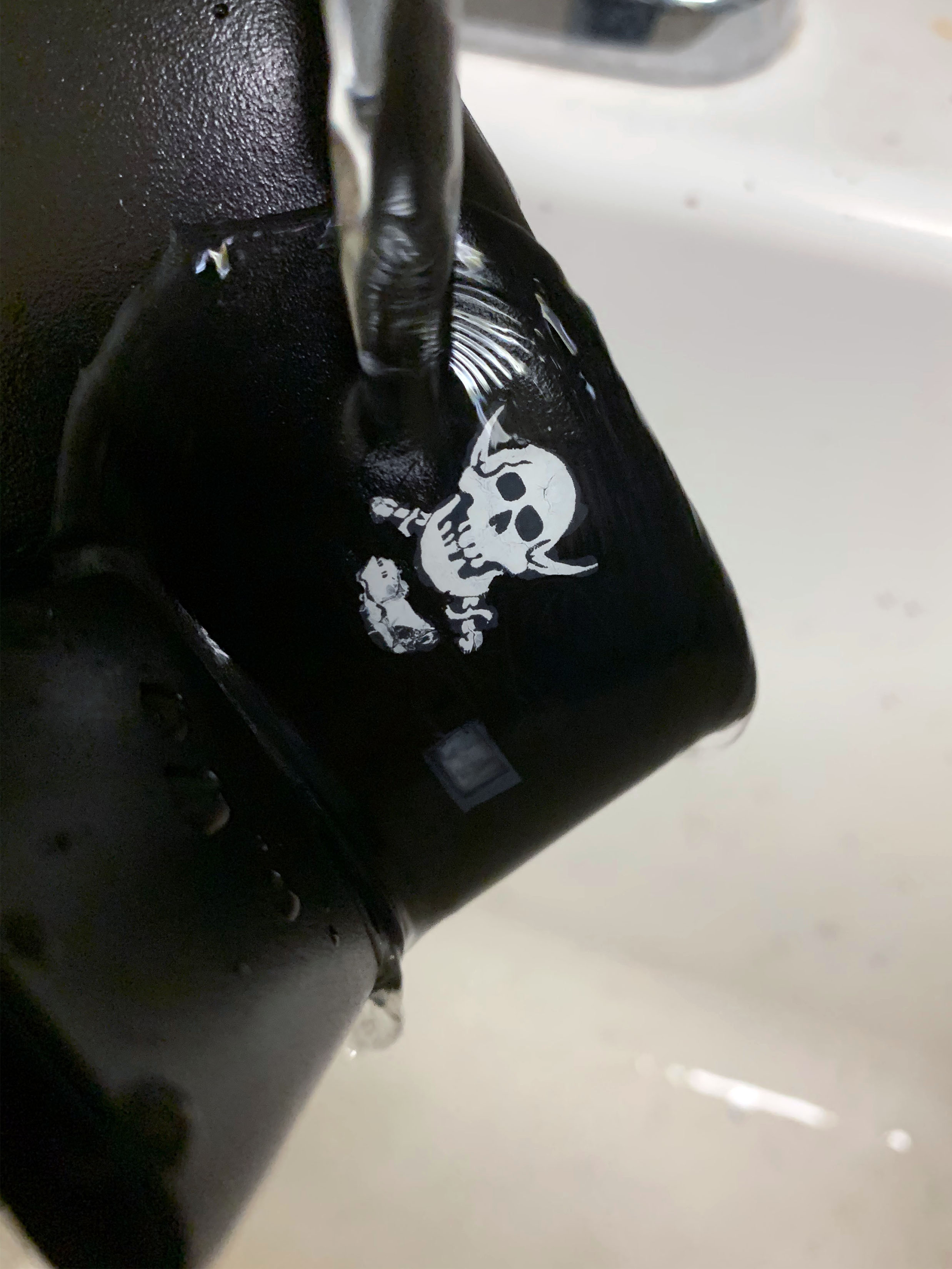

      With careful scratching, the glue came off.

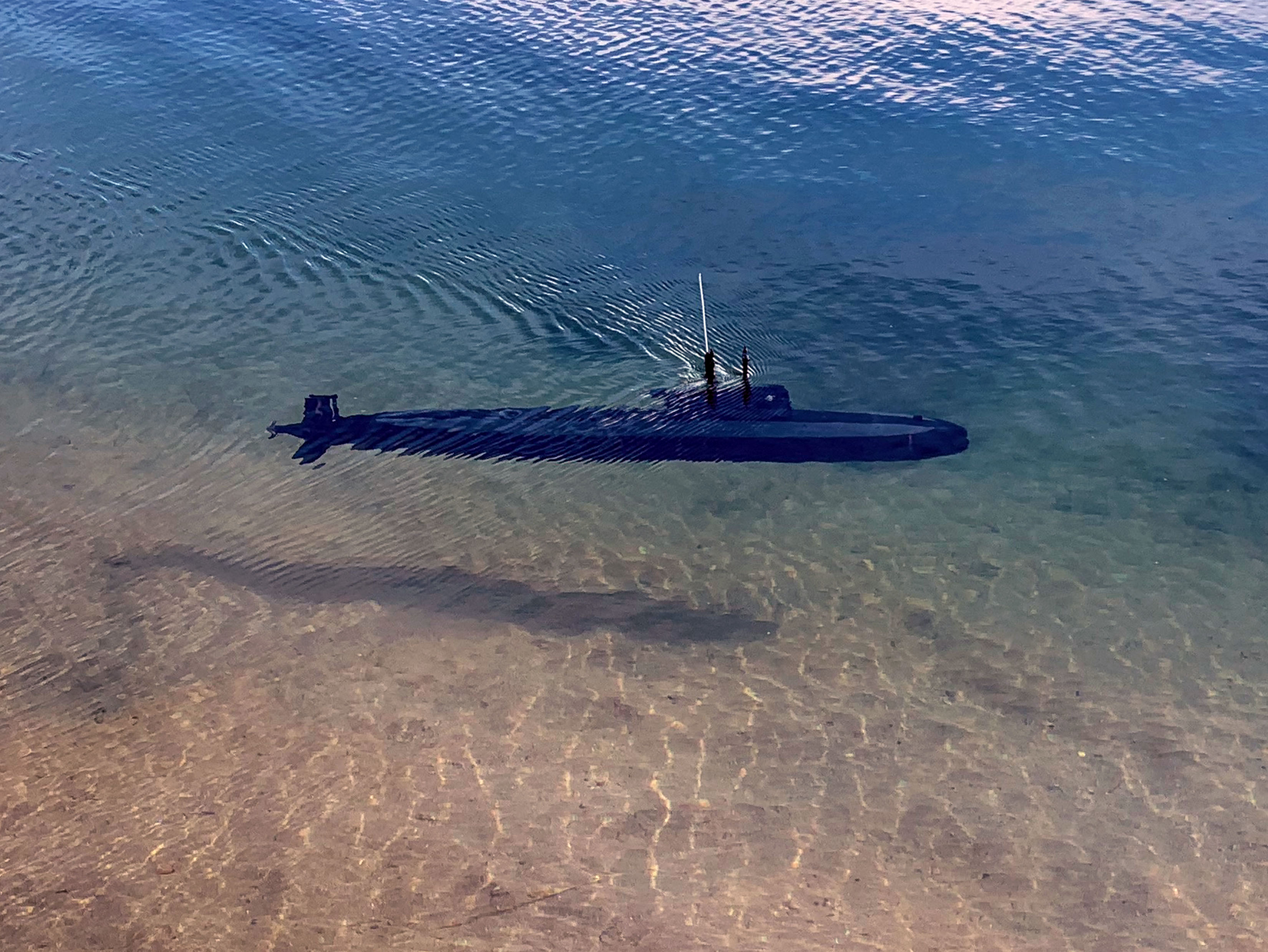

        Had a brief moment this weekend to run the Walrus. Sometimes that is all I need.
          #139
          I really like the photo of running with the masts up and above the surface.
          I like the clarity of the water!

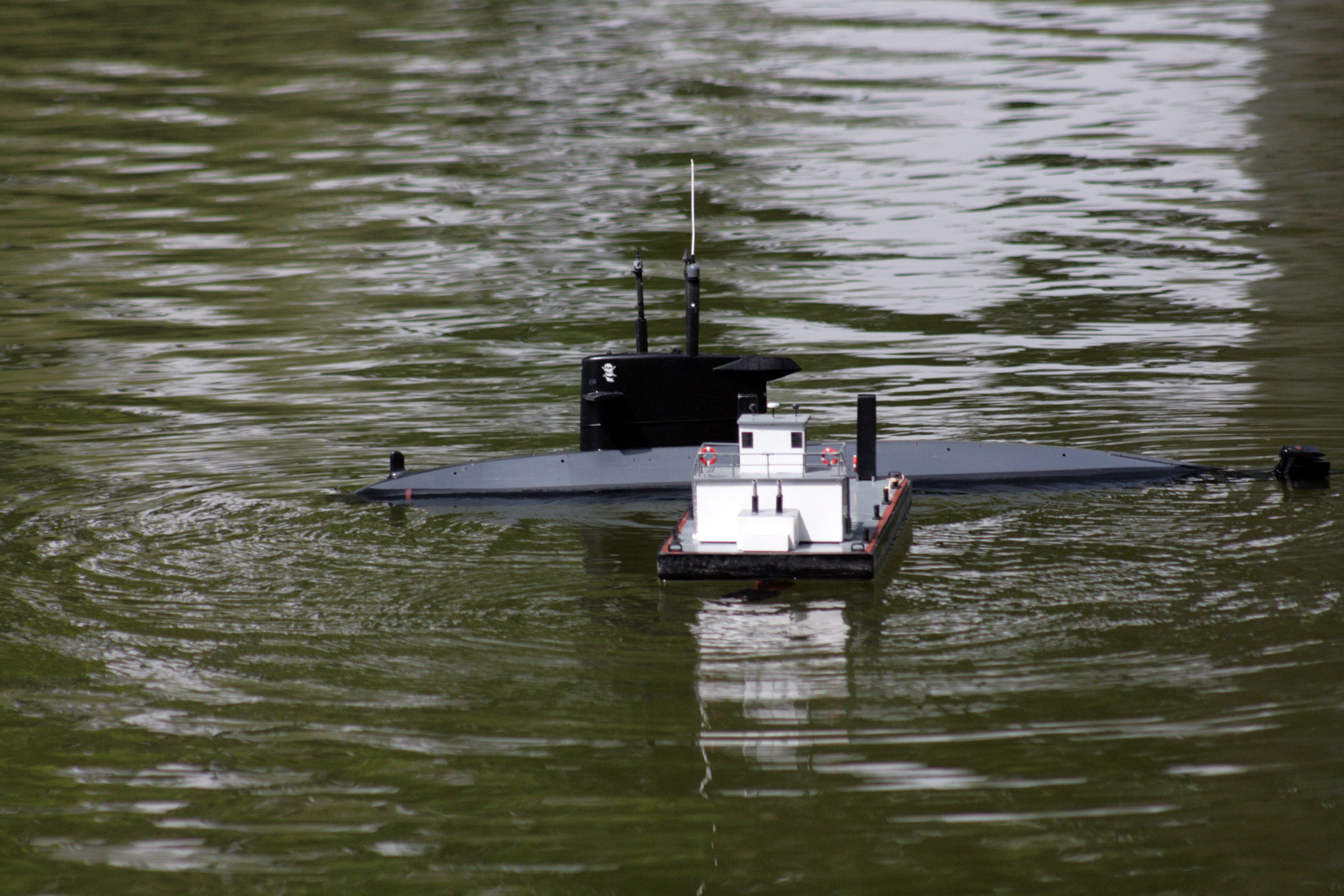

            Lastly, here is Ralph's rescue barge at work on my Walrus.
            I will post later on the issues and fix.
