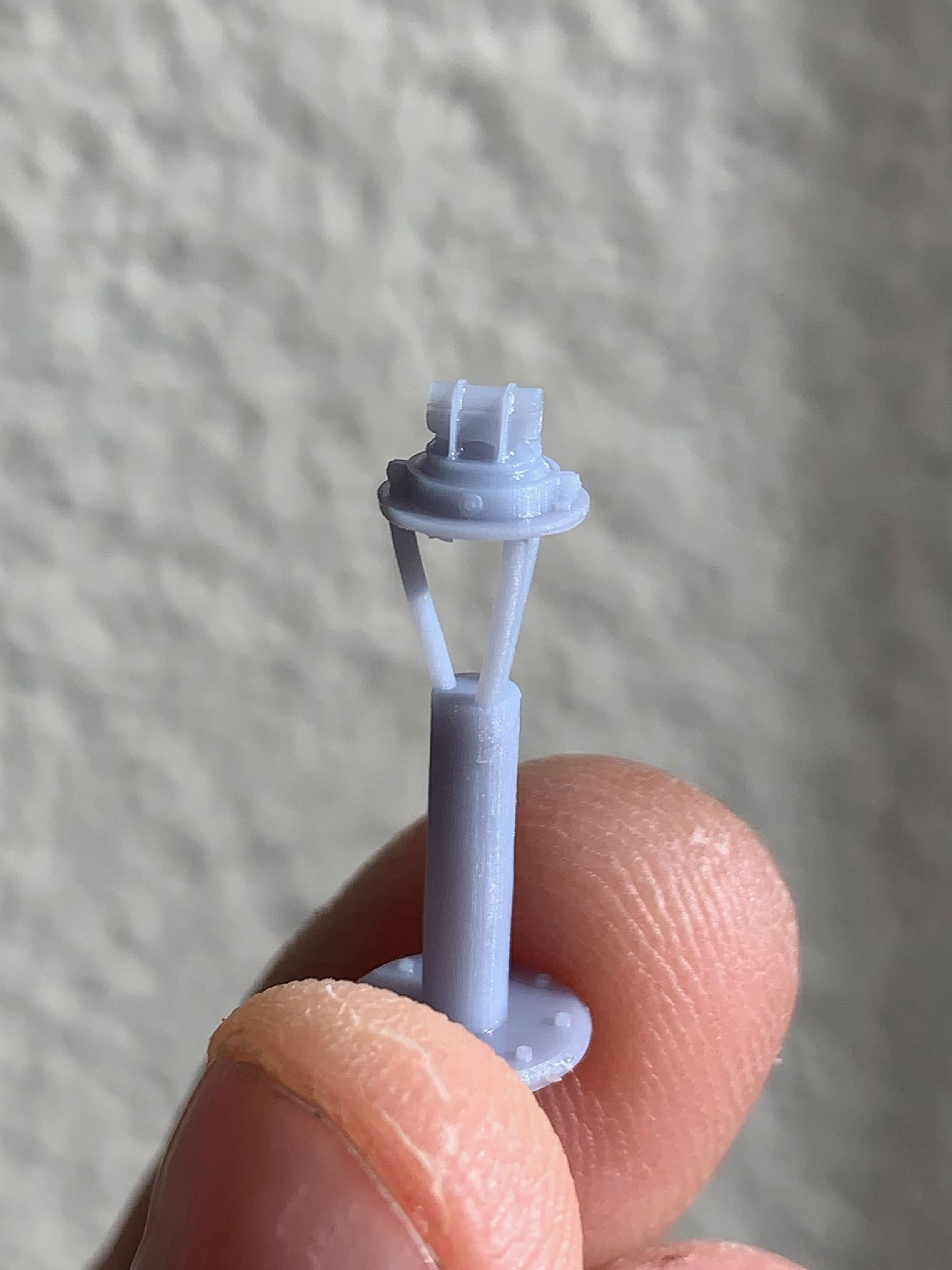

              Printed out the compass repeater. Very pleased. Really impressed with the details that come out of this Elegoo Mars Pro.
              The base is not accurate, but look at the details that did come through!
              Now I will maybe work on the opening with the hatch below. Then I need to get back to the Type IX.

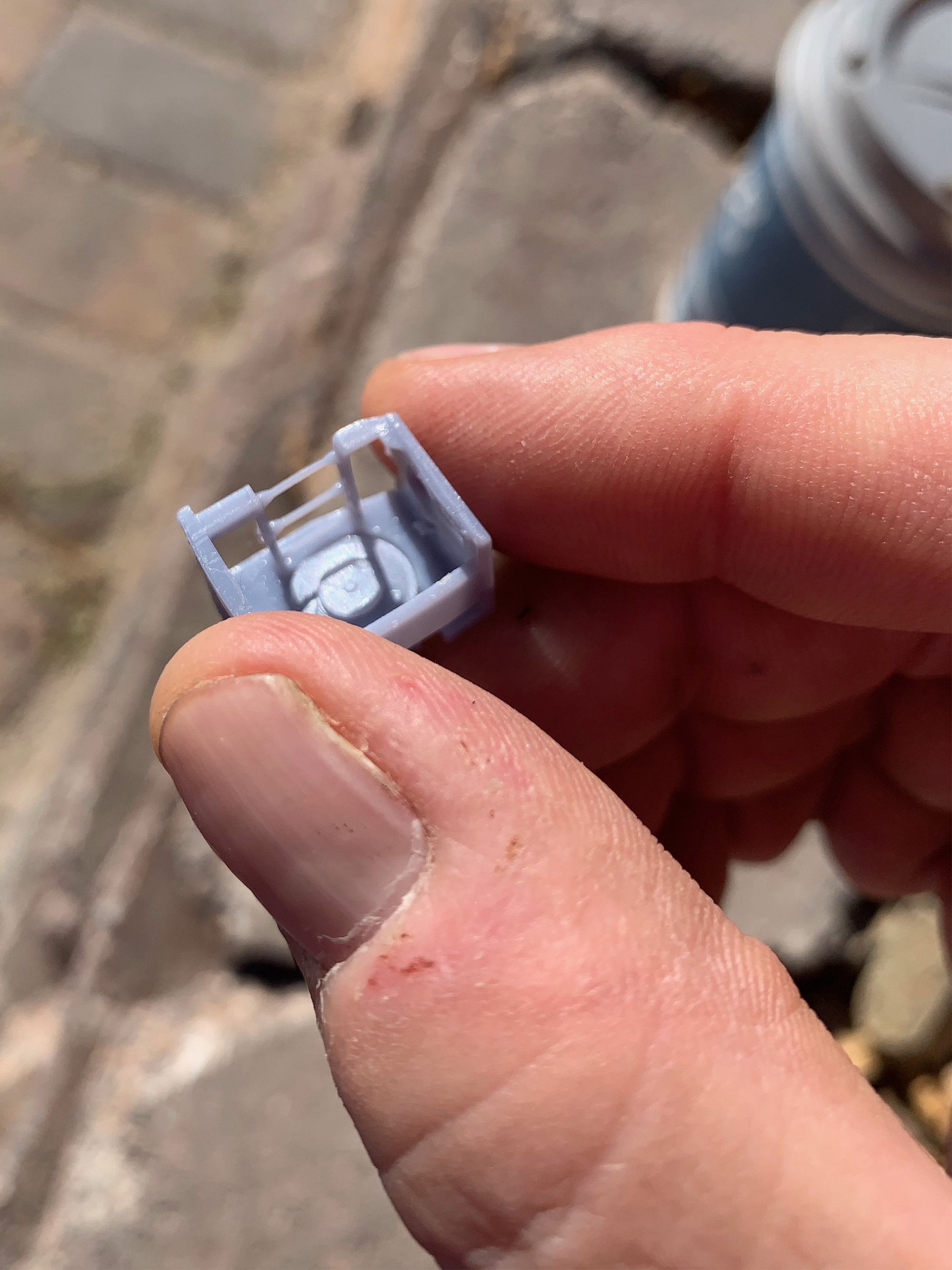

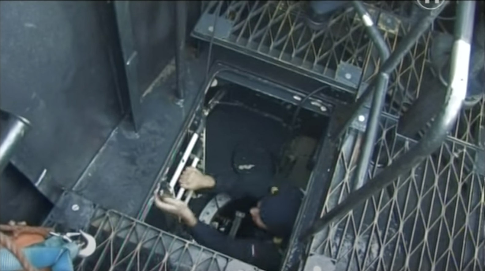

                I noticed there is a deck grating and the hatch is a little lower than the sail deck.
                So thought I would give the grating a try.....

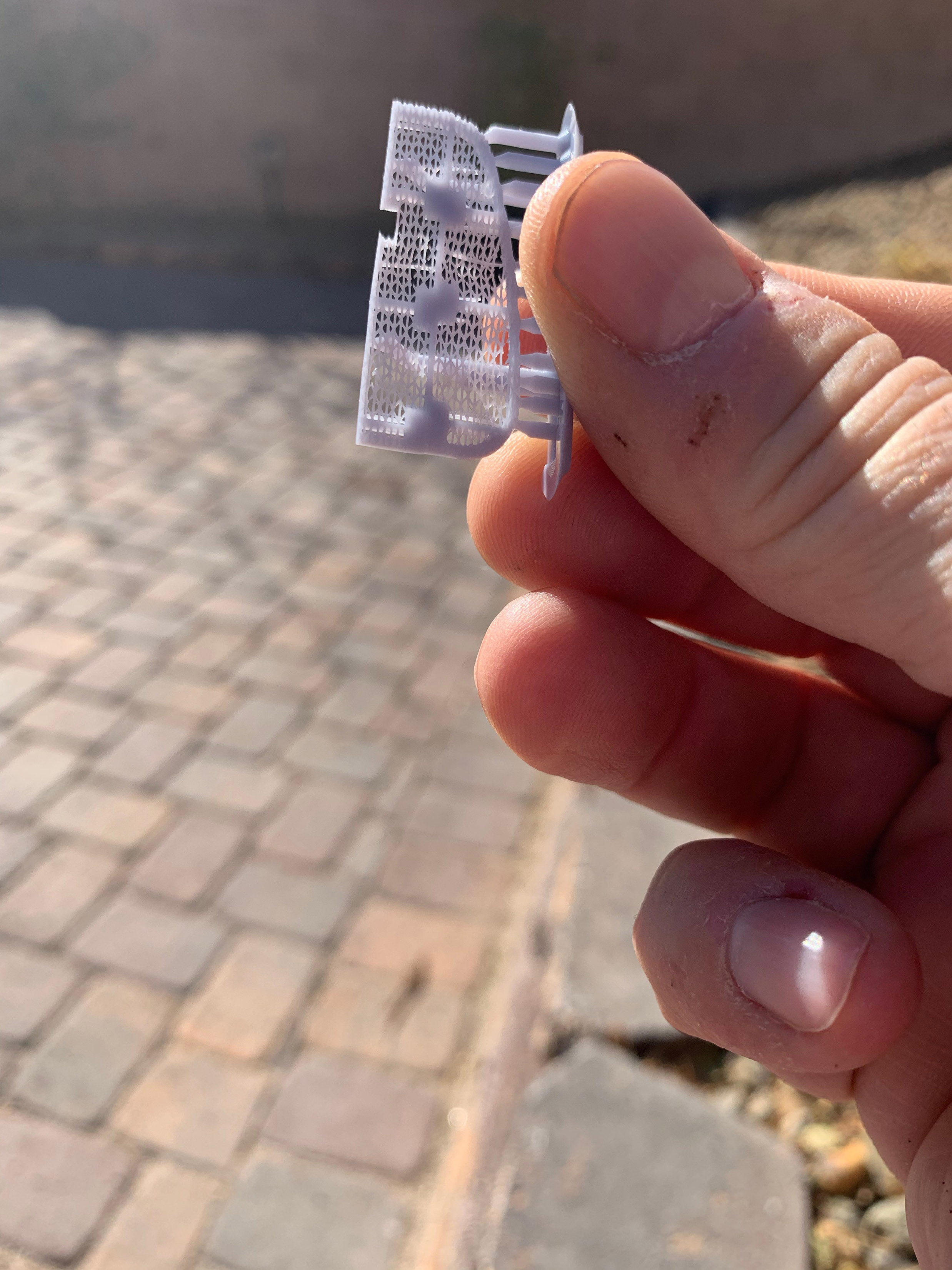

                Then tried printing it...
                Half did not print at all and the other half sorta printed. It was too fine and portions tore. I will try again making the grating a little thicker. This could be a nice detail. Railings, I will add this in brass, I think.
                The access to the hatch came out good, this will go below existing deck.

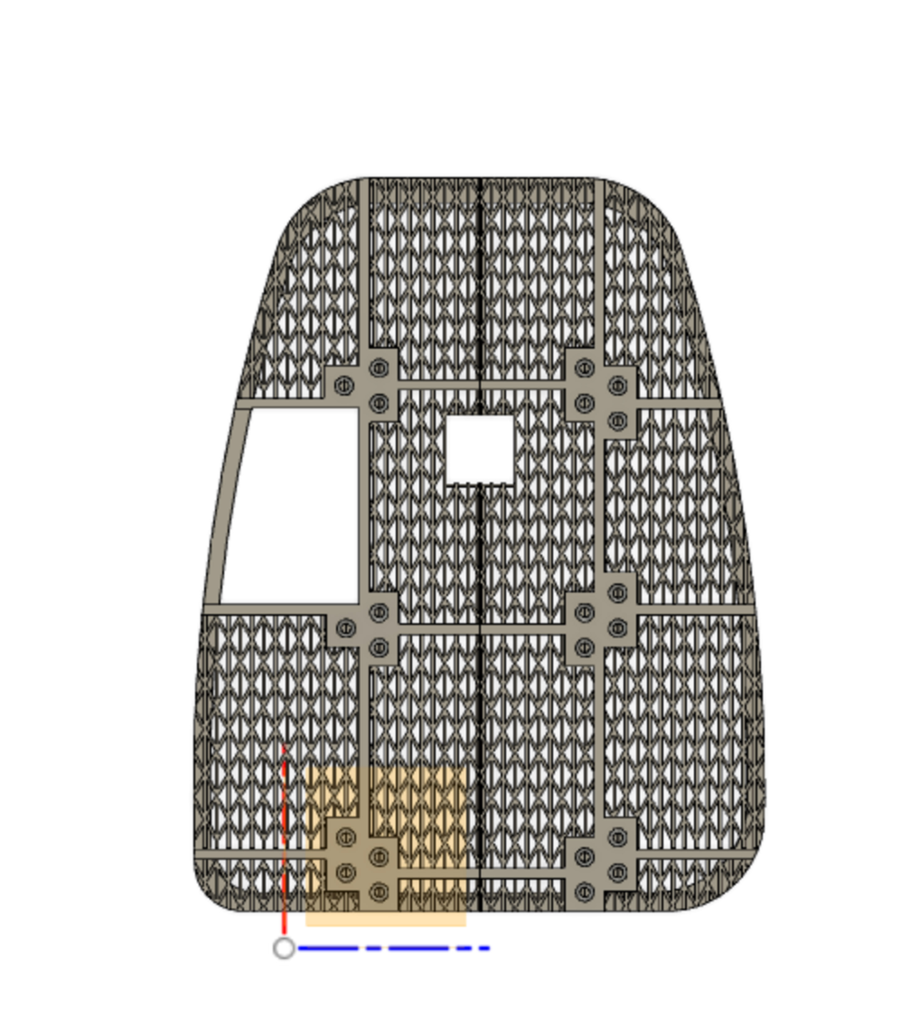

                  Made the grating .2 mm thicker (vertically) and tried printing again.
                  It worked!

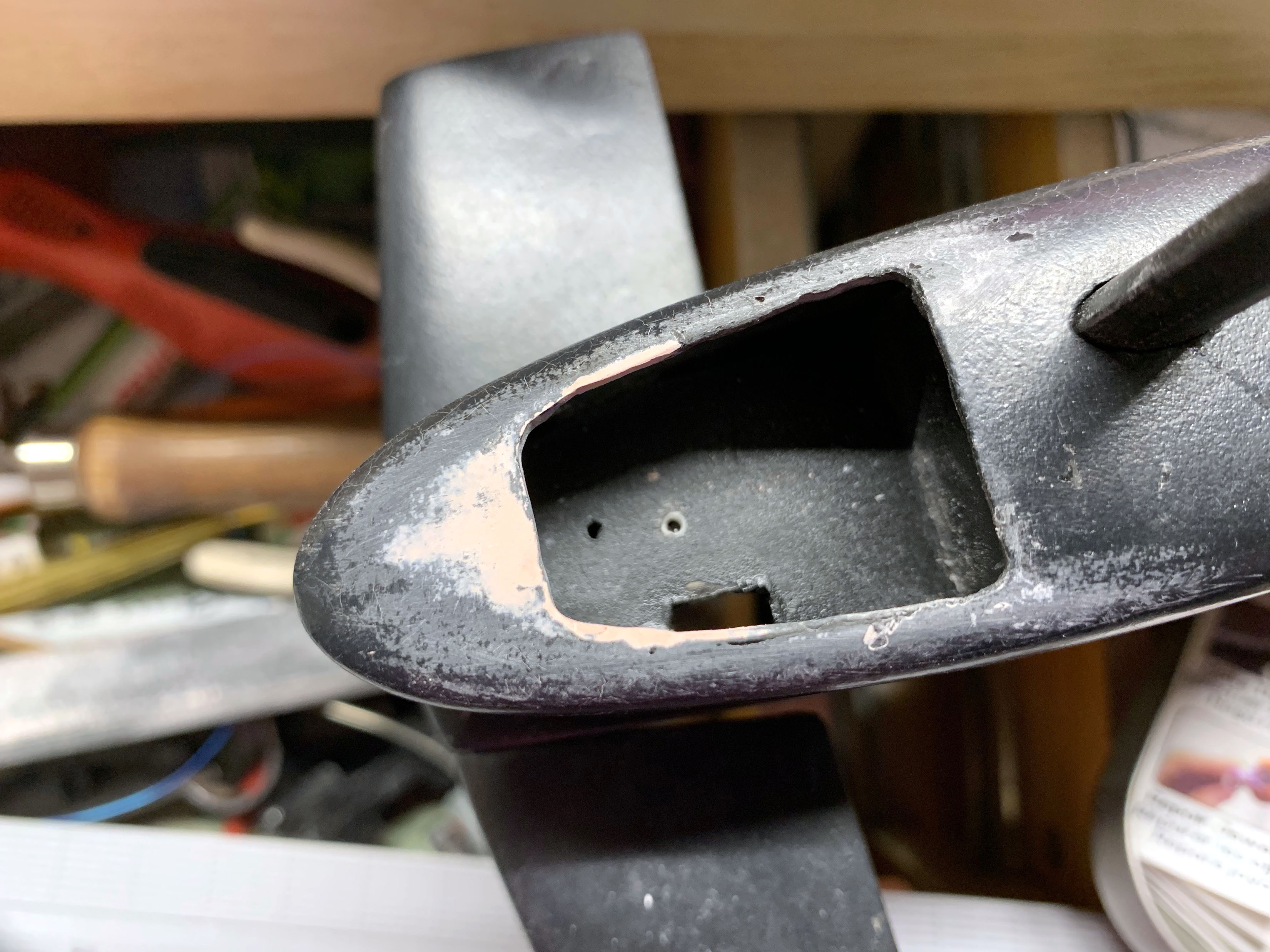

                                Opened up the bridge to match my references. Quickly sanded and painted the bridge.
                                Still have more to do on the bridge opening, but couldn't wait to see what it will look like.

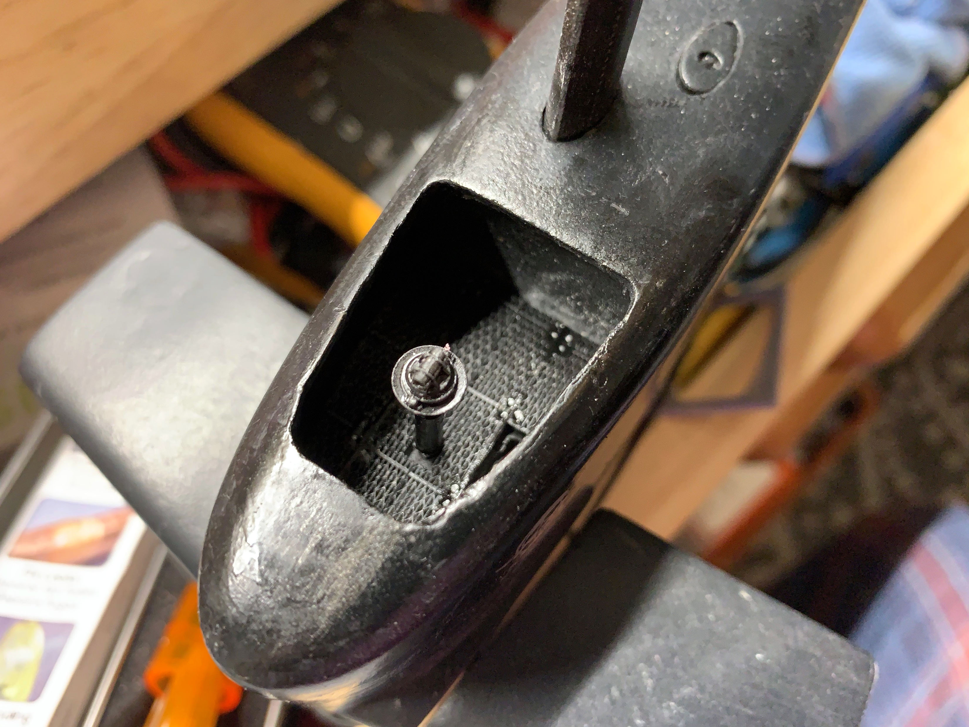

                                I did some dry brushing using silver to bring out some of the details. It made the compass repeater and grating pop.
                                The hatch opening will be installed once the paint dries.
                                Now the wind shield and clean up the finish. I might have to lose the skull and cross bones depending how the tidying up the opening.
