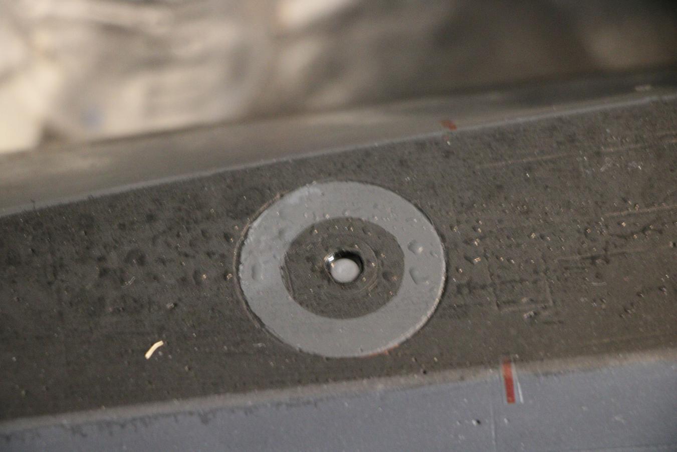

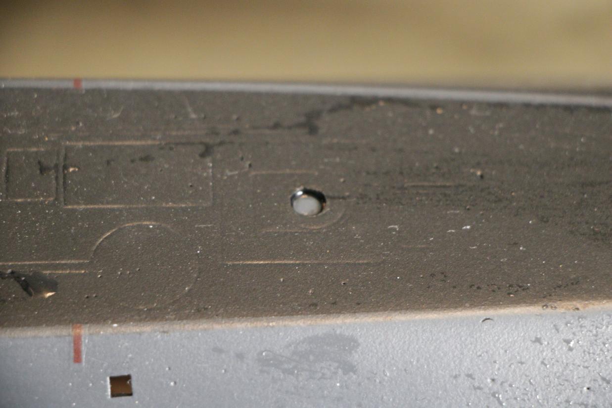

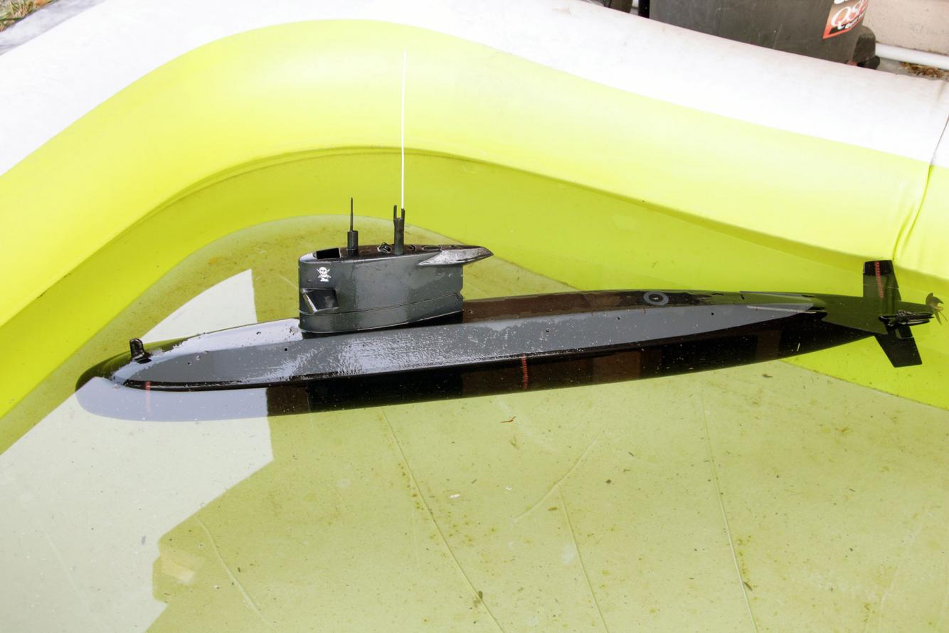

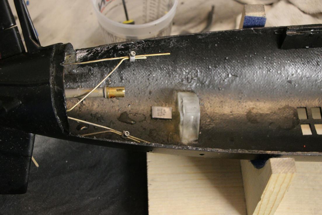

    On the bench, I saw that my wheel handles did not help with air. There is not enough space to break the surface tension.
    You might be able to see the water trapped.
ID:	133052Click image for larger version

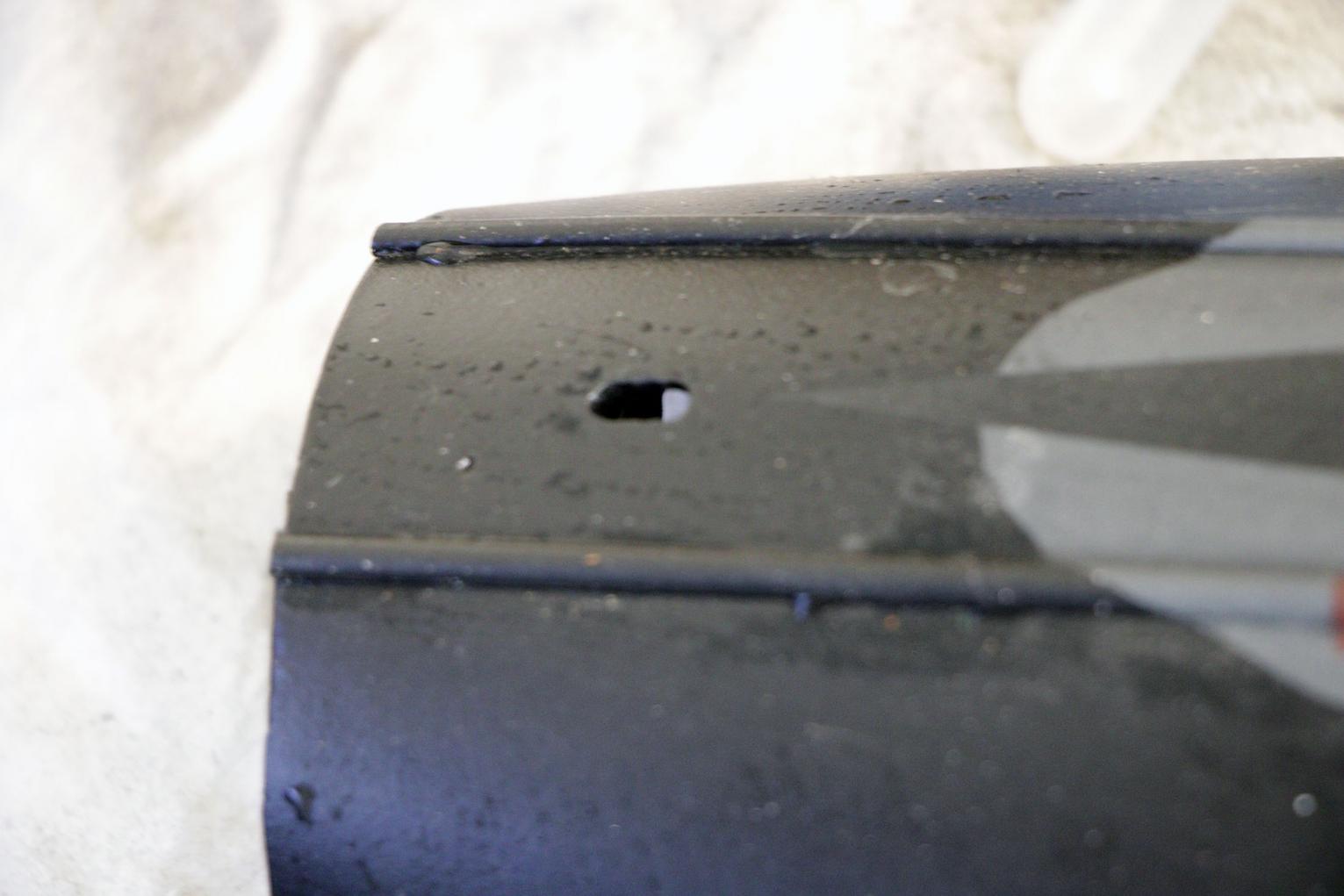

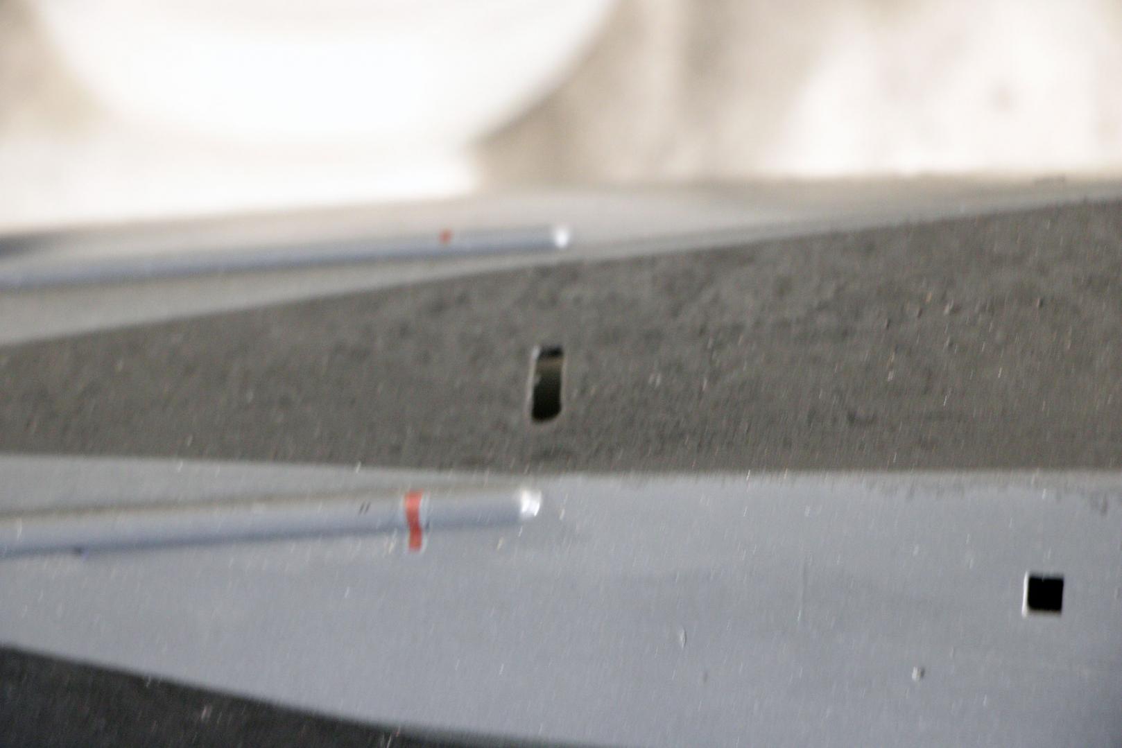

    You need about 3/16" to 1/8" to break the tension and allow air to escape. Like I did at these points in the rear end of the hull. I made these oval, when I do straight holes, it seems you need to go larger hole. The oval seems to give me the extra space and it can look more like it is supposed to be there. You know what I mean?
ID:	133054Click image for larger version

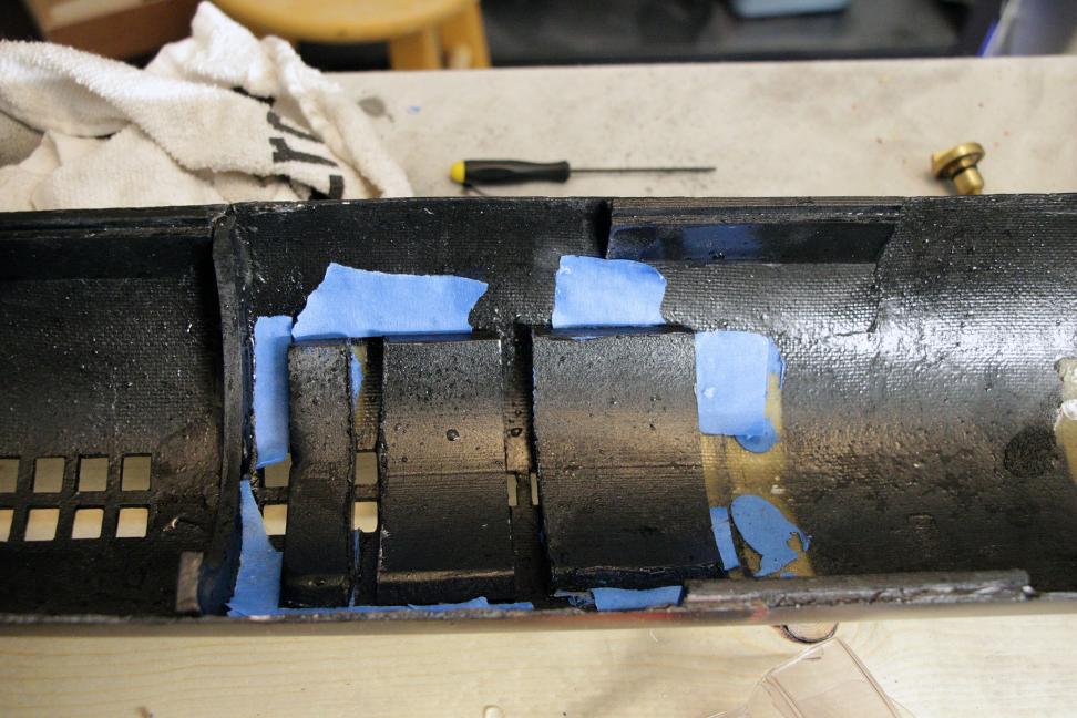

    To make sure I get the weights back correctly, I taped around the edges. I will let the hull to dry out and affix them as tested.
    The small weight would be right above rear anchor point. So I will need to shift it back a little and retest the trim.

      Tom, I find 1/8" holes work okay.
      I drill the 1/8" hole as the vent then I use a 1/4" drill bit and hand turn a bevel on the under side.
        • 2350
        #78
        Ralph, That is exactly what I do when making a vent hole. Tapering it underneath, as I understand it, traps the air and because of the thinner edge it does not hold it, allowing the air to escape.

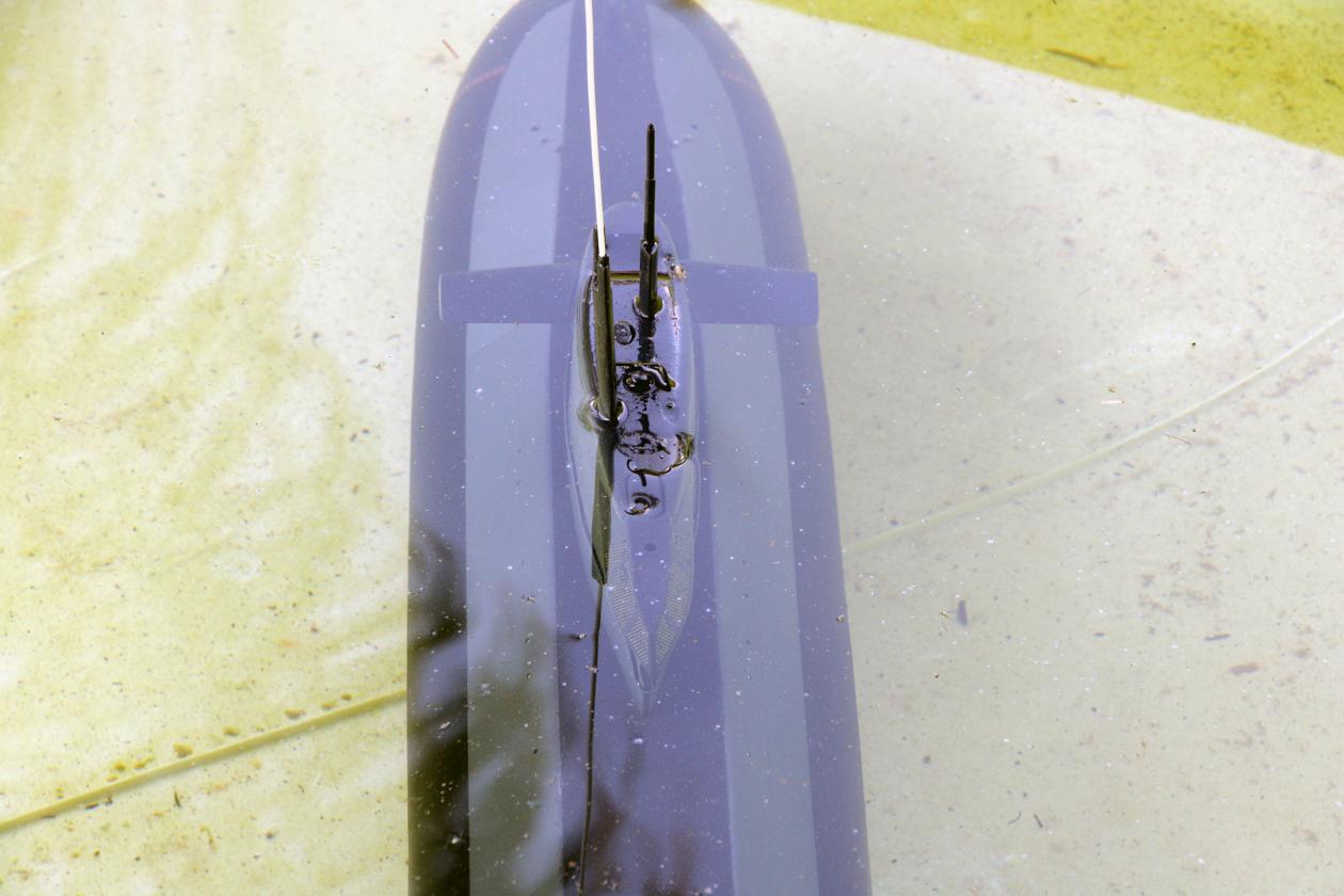

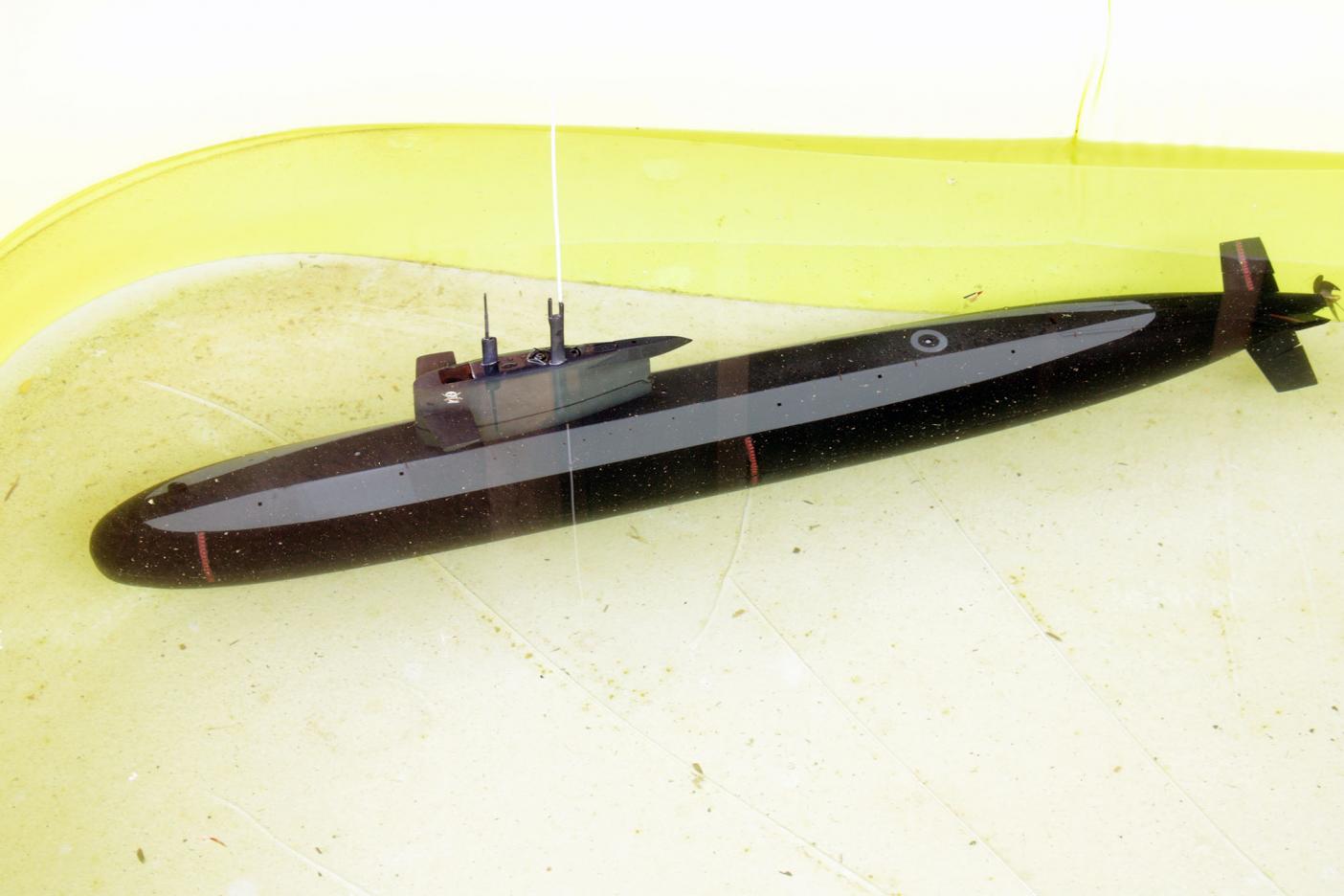

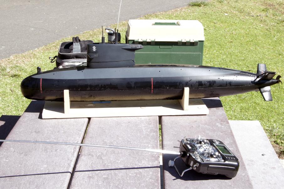

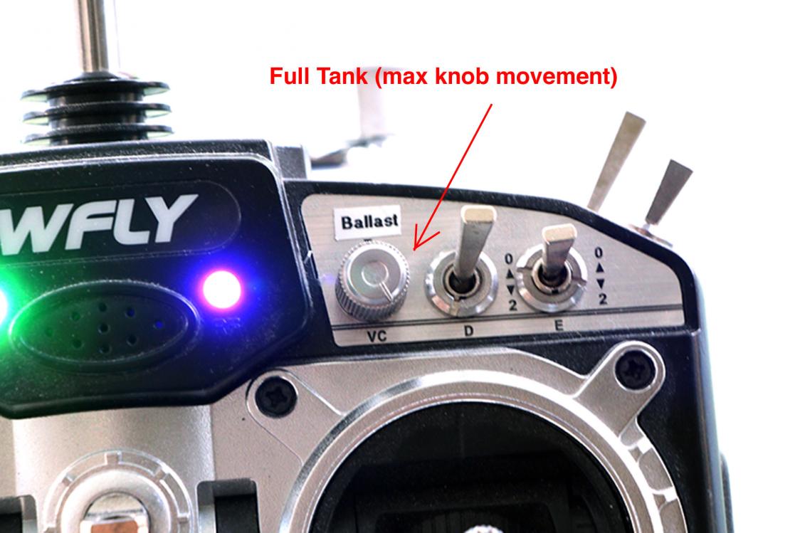

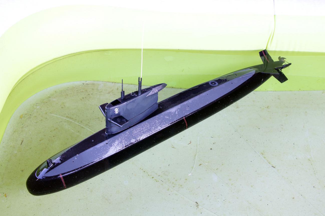

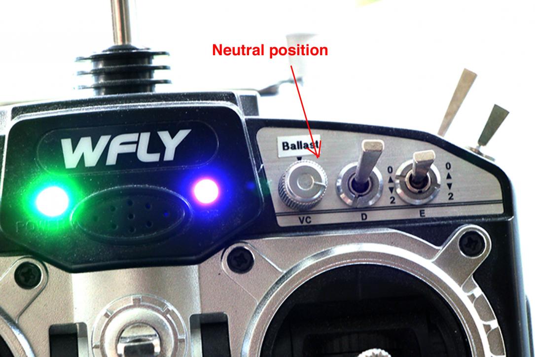

              Final test.
              I talked to Will about the trim and he said that works. If the knob goes to 75% or more it will be fine.
              I will apologize to all that are enduring frozen water or sub zero temperatures for being a wimp. It is cloudy and raining, tonight it will be in the low 30 degrees. So the test tank was even colder than before and without the sun there was no love in the air.
              Anyways, I wanted to verify that the final adjustment made yesterday were still good after RTV rubber was used to affix them and to see if putting the sub in the water if it will still sit well (the piston needs to be cycled to get the air out). Fun to look at as it was.

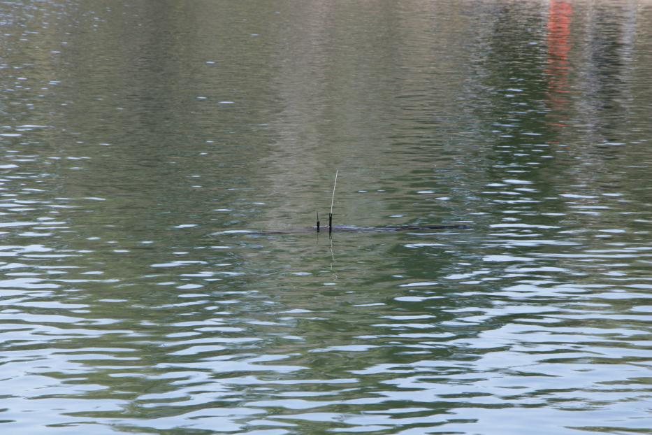

              Once the piston was cycled, I set my dial to just at or below the surface.

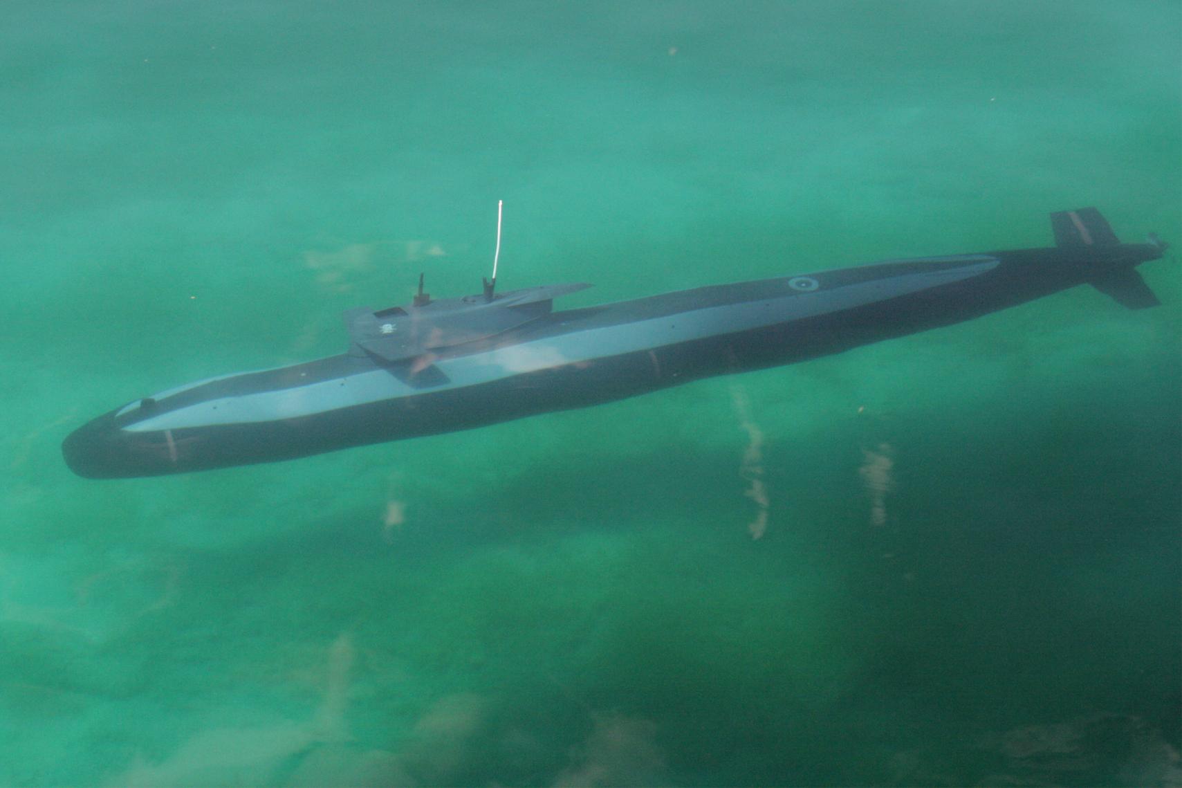

              That brought the sub to this point
ID:	133060Click image for larger version
              I have this much room to full ballast tank more than enough to dive and I have plenty of lift available.

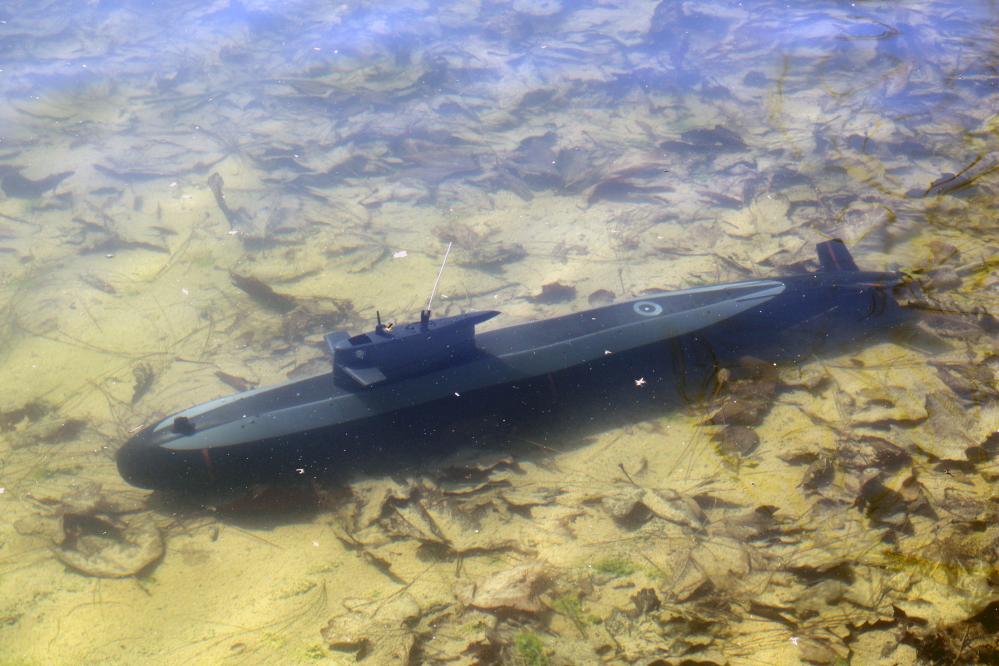

                      Ran for a total of 3 1/2 hours (could have gone longer, but it was time to wrap up the day).

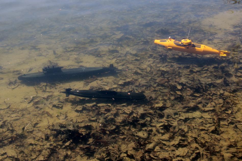

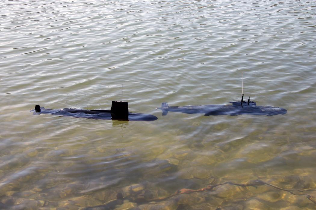

                      Wouldn't you know it I found a submarine parking lot with Will Oudmayer's Delta and Mike Dory's Akula.
                      It was a good day! Thank you guys!

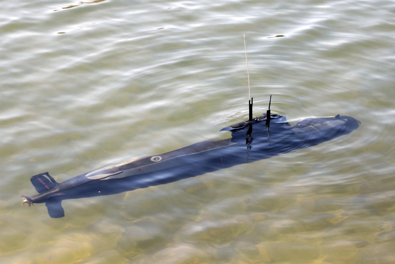

                          #87

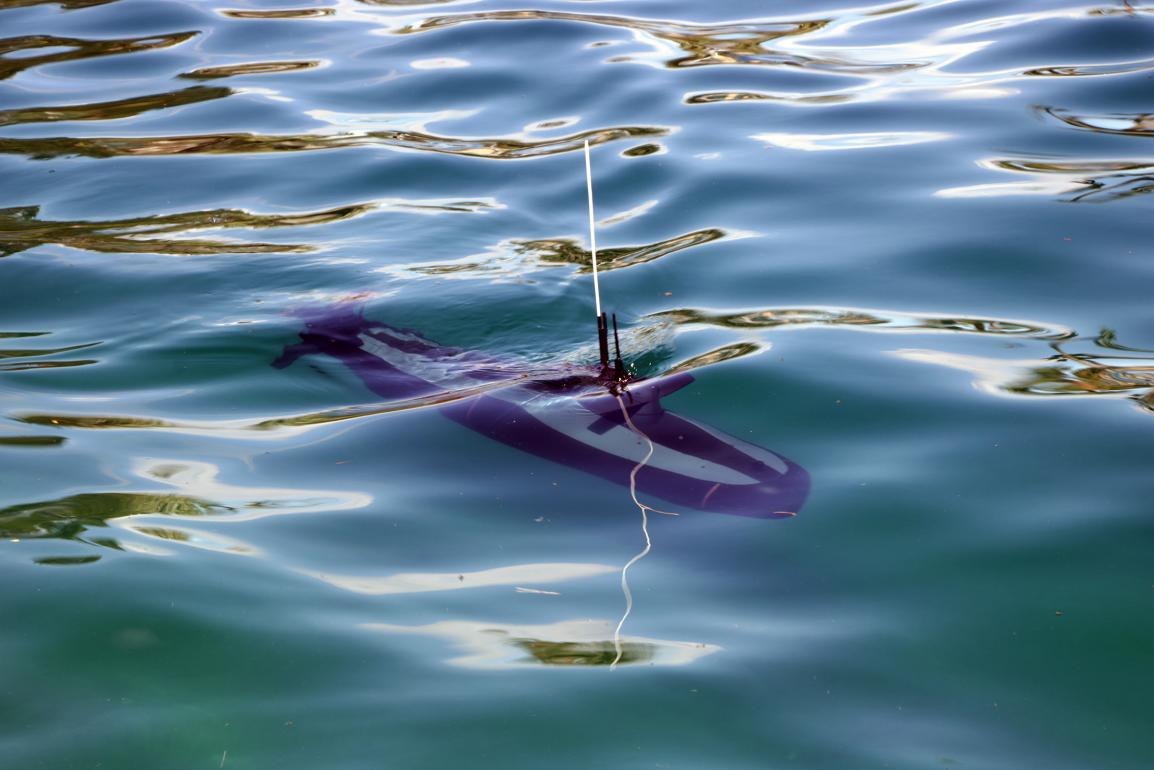

                          After running my little Seaview, I needed some calm. That is where the Walrus comes in. It just is a relaxing boat to run.
ID:	133260Click image for larger version
                          It began as windy with a bit of chop in the water, but after an hour or so it calmed down a little. This sub once at periscope depth, did not care if it was choppy or not. It ran well.
