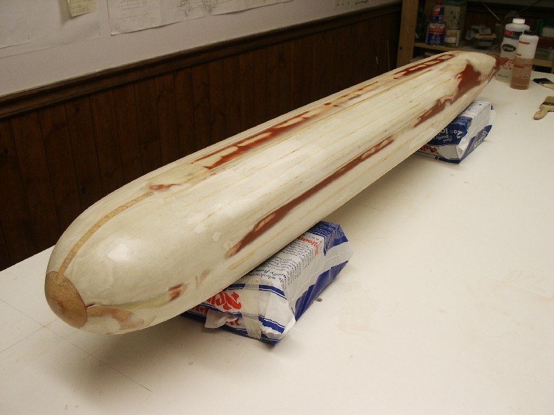

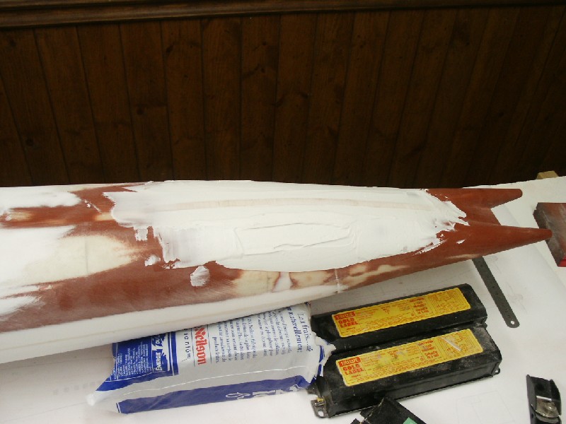

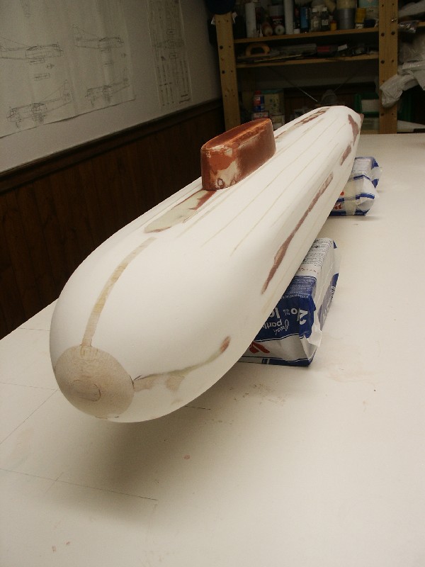

    Not much to add from last night- After a light skuff I put coat number two of DW onto the bow.

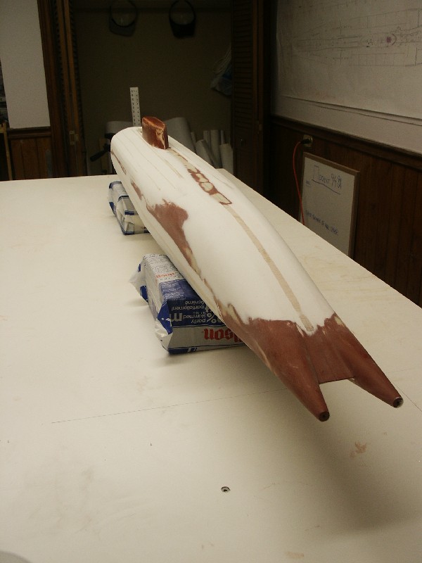

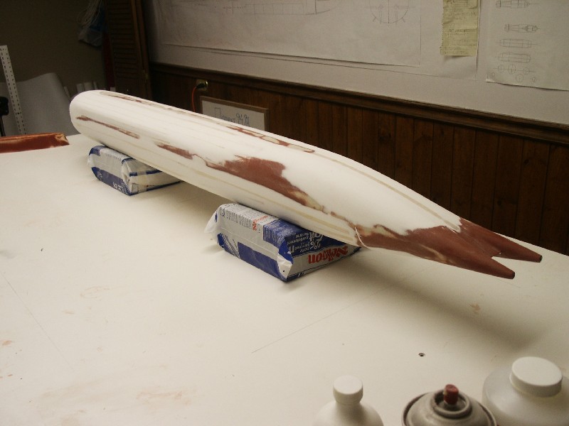

    I also started building up the stern area to bring it up to the correct height for the new drawings following the same process I detailed yesterday. This will also correct the "discontinuity" in the upper surface created when I elevated the screw fairings with the saw and wedges.
    Just in case anyone's curoius, yes those are fluorescent light ballasts in the corner of the photo. I have a half dozen of them that I keep for use as general purpose weights. In this instance I've been using them to block up the hull and keep it from shifting around while I'm taking measurements.

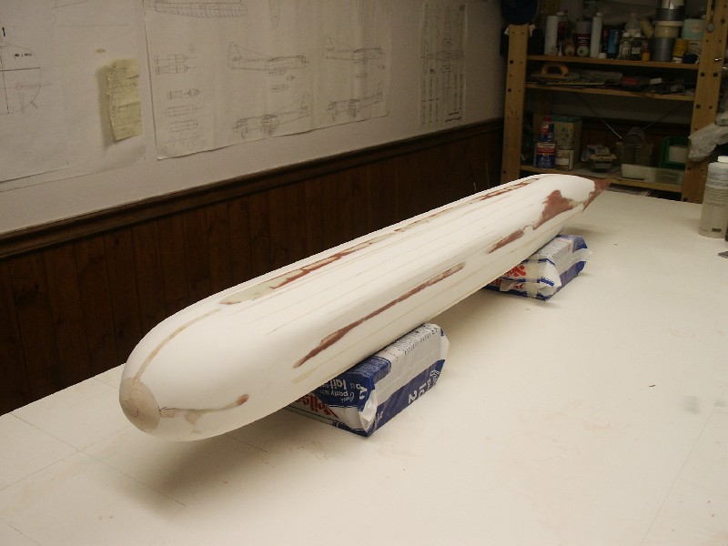

                    Here's a closeup of the bow having been final sanded to shape.

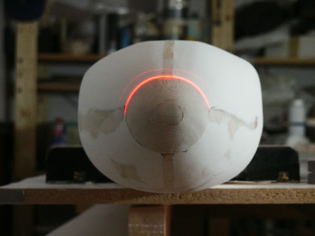

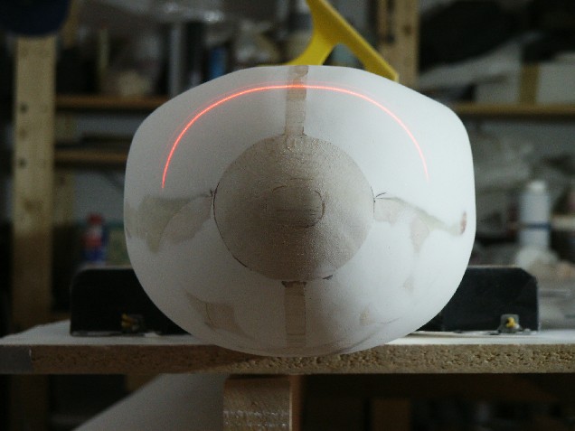

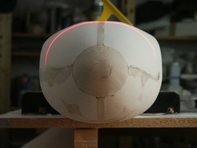

                    Since I'm only going to be laying down a single layer of 1.5oz cloth this time I'll do my "laser check" of the bow before I put the glass cloth down.

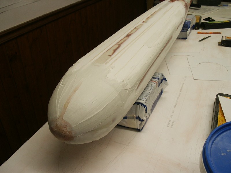

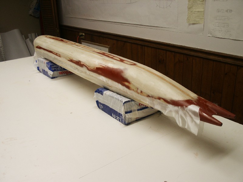

                      Now it's time to step
                      Now it's time to step back and give it a good over-all final sand in preparation for the glass-cloth.

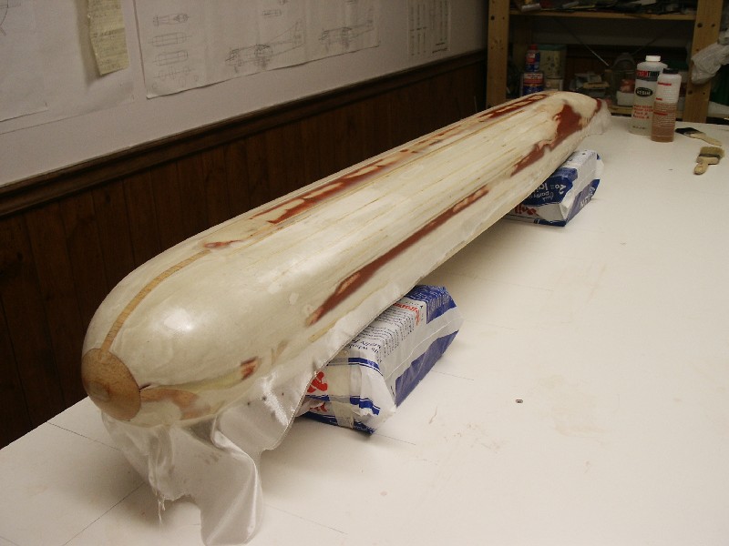

                      Just for kicks I put the old sail in place. The sail will have to be rebuilt as well, but it's good enough for the photos...

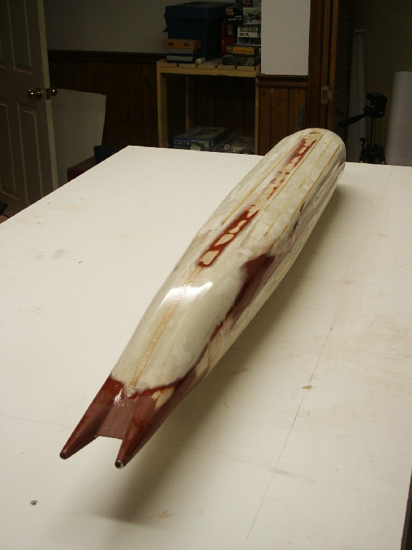

                        Final shots for today- While
                        Final shots for today- While making my corrections to the hull I noticed that some areas of the 6oz glass cloth seemed to be rather dried-out. As best as I can tell the drywall compound sucked the epoxy right out of the glass cloth, leaving "unsaturated" weave that would not take any more epoxy on subsequent applications. This time 'round in an attempt to prevent this I decided to seal the DW compound with a coat of alcohol-thinned epoxy applied with a brush.
                        I'll leave this to cure now for a day or so, then another light sand and the cloth will go on Wednesday evening.

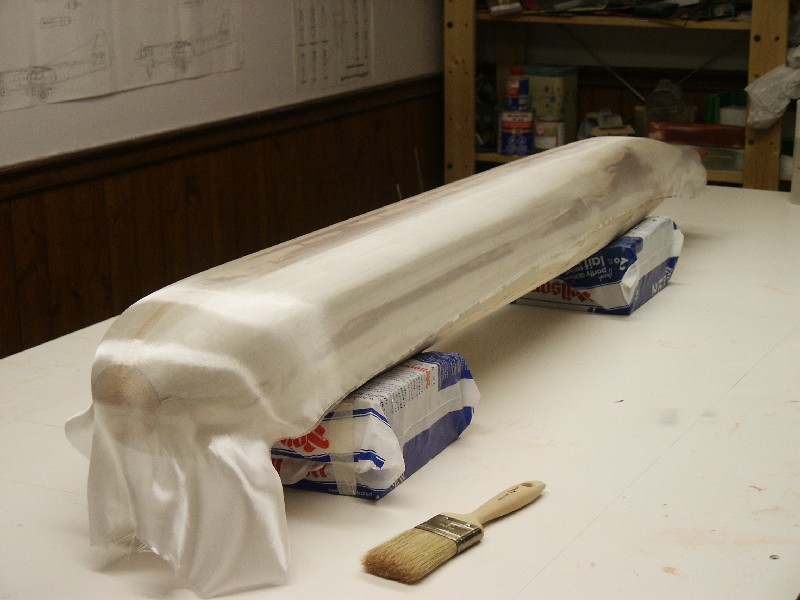

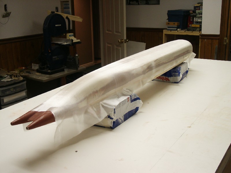

                              As before, glassing will be a two-step deal. This time I'll begin with the top half, then I'll do the bottom half once that's set up. Because I'm using such light-weight cloth this time, I've tried somthing different for trimming the ragged edges- stay tuned!
                              After roughly cutting the cloth to size, I laid it down on the hull. Since I've not made any "adjustments" to the prop fairings I don't need to recover them, but the rest of the upper surface will get it down to the waterline. Once spread out into place, I used the horse-hair paintbrush (in the photo) to brush-down the cloth and build static electricity, keeping it in place. This is one of these places where its worth it to take one's time and work out all the wrinkles.
                              Next, pour down the epoxy resin on top and spread around with old business cards to fully saturate the cloth to just below the waterline.
