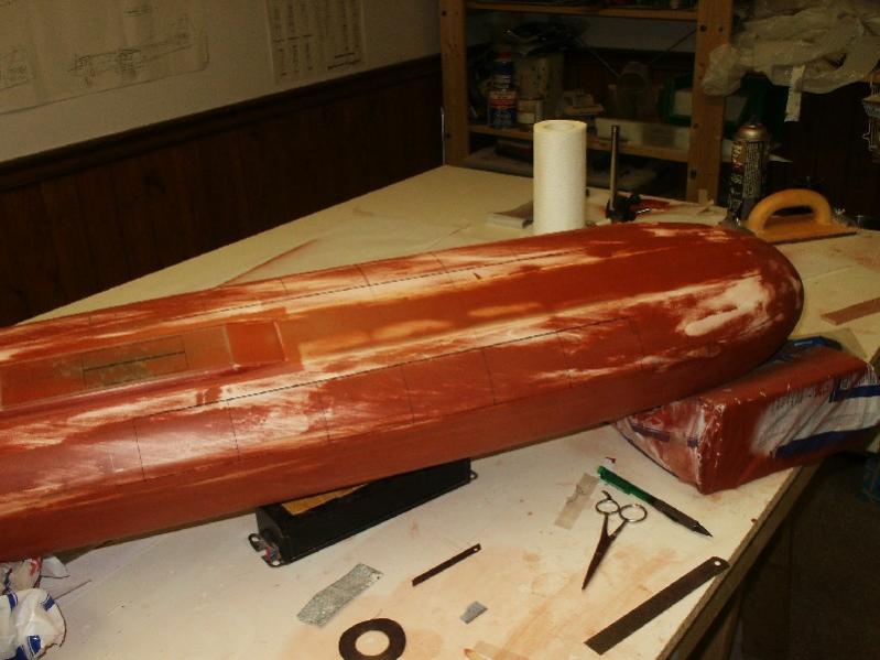

    This morning I have some

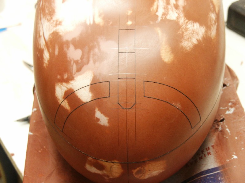

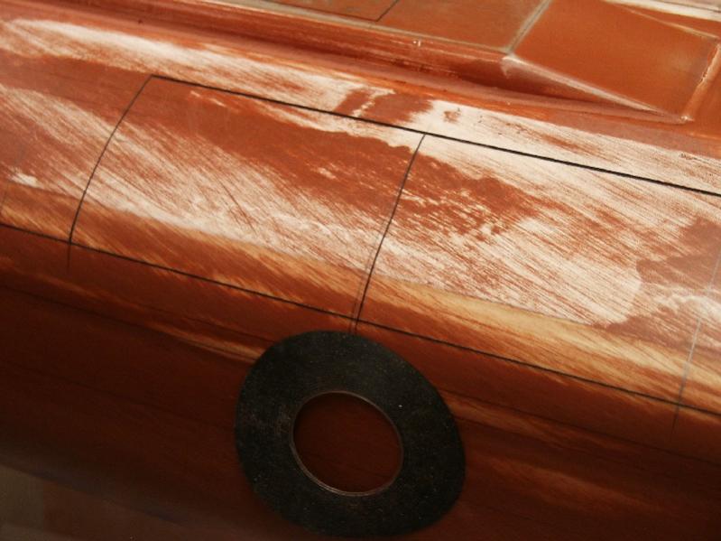

    This morning I have some good progress shots to share. I've begun carefully laying down the Chartpak tape that will be used to make the recessed panel lines. This is a fairly tried-and-true method for creating butt-joined type panels in the model jet community. I'll be using this technique to outline only major features such as the doors that cover the cruise missiles, bowplane doors, towed radio buoy, etc... All the flood and limber holes will be marked using the same technique.
    Once the panel line locations have been marked, very thin (1/64" wide) tape is applied along where the panel line should be. This will initially create a raised panel line. Once I have all the tape applied, I'll spray on several coats of high-build primer. (In some areas I may also choose to use filling putty) This will all be sanded smooth, and the tape will then be removed leaving a nice, crisp recessed line that can be easily picked up in the molding process.
    Here's a closeup of the tape being layed down on the missile doors.
    This is a closeup of the bowplane door covers.
    These are service doors for loading the torpedoes.
    And finally here's an overall shot of the hull with most of the panel tape layed down on the upper hull. I figure I still have another evening of panel taping, and several evenings to lay down the flood and limber holes... (There are about 250 flood holes that will need to be marked!)

        That might work, I dunno. The tape is an adhesive backed crepe paper though, so sealing it really well would be essential. (I know that's how some of the jet/scale guys have been known to do panel lines, but the environment's not quite the same.) Chartpak tape is available in many different widths, but can be very difficult to locate. I've got 1/64", 0.020", and 1/32", although I'll just be using the 1/64" on the Oscar. (At 1/96", hatches framed by a 1/64" line would scale up to a gap of 1.5"!) For anyone who's interested Chartpak tape can be sourced through stores that carry drafting supplies, which in this day and age are becoming few and far between...

          Just great work! One question though. Where the h ell did you find the tape!!! I haven't been able to find it out here in LA! Help! Please.
          Steve
          P.S. I don't know if you plan to do this but I've just sprayed over the tape with primer. Many layers and then remove the tape. Light sand and you've got nice deep panel lines.

                Here's a thought, I used to do some auto pinstriping, and a lot of it is done with vinyl striping tape. One could check at an auto detailing shop or even a sign shop to see if they can get tape this narrow. This stuff is great because it's very strong, is not porous, and can be bent along curved lines. Although I'm not sure how easily it would lift off, but worth looking into.

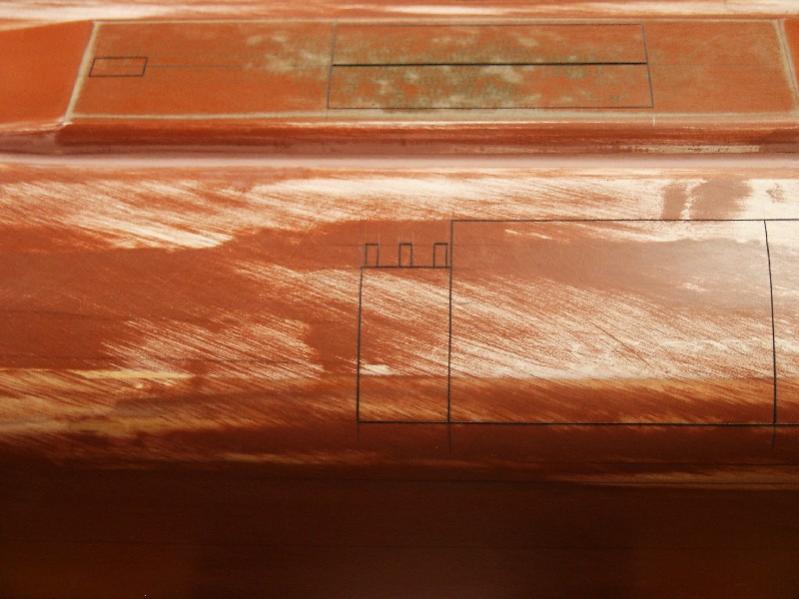

                    I got a couple more details all taped up last night. I completed the equipment hatches behind the Granit doors.

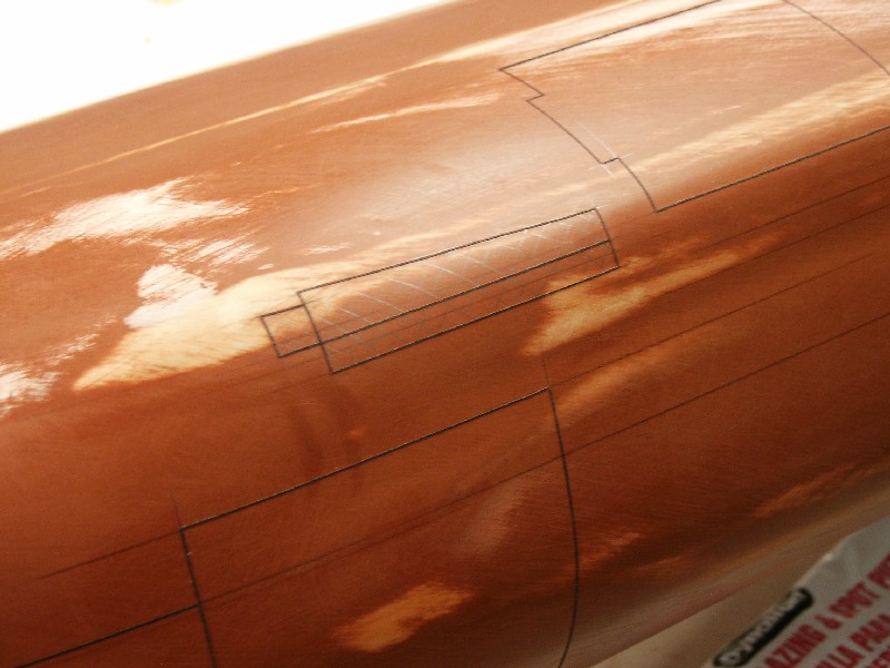

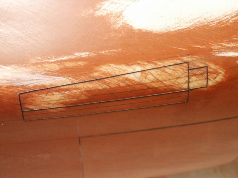

                    In my usual style I also had some back-tracking to do. Another look at some dock-side photos suggested that I had my bowplane doors a running 1/8" or so high on the hull. So I peeled up the tape and layed it out again just a little bit lower. (I left the original pencil marks in place so the difference can be seen.)

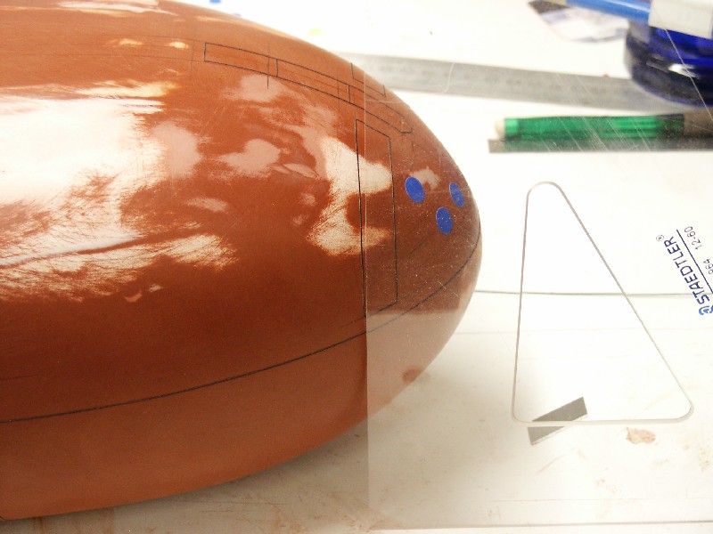

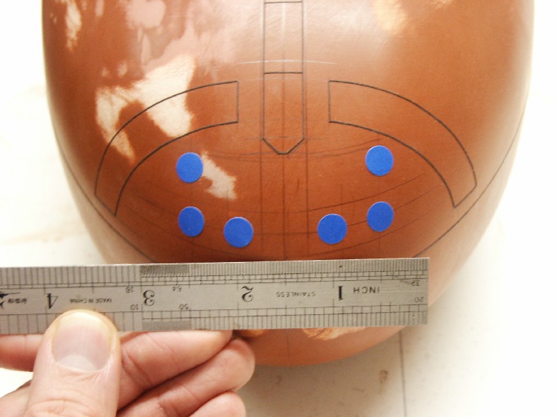

                    Finally, I also stated putting some reference lines down for the torpedo tube doors. (Don't get hung up on the size of the blue dots- they're intended to be indicatve only of tube door centers, not tube door diameters.)

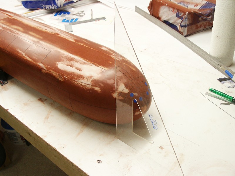

                    Michael, here's a couple of shots of how I marked those panel lines on the bow. Note that in the square is not perfectly aligned with the long axis of the sub, nor is the camera angle perpendiular to it, so there appears to be a slight misalignment between my marked lines and the square.

                        Wayne- Forget that I shan't! I spent a great deal of time last night trying to get the locations to look right when compared to your head-on shot (from the SubPirates board). (Below) This is a particularly useful photo as it's taken from a very good angle- almost dead on level with the bow and nearly perfectly aligned with the long axis of the ship. When viewed from this angle the doors appear nearly perfectly circular except for, as you pointed out, the straight edges on opposing sides.
                        My guess is that the hinging axis of each door runs perpendicular to these straight edges. I can't wait to make the final markings for all this on the hull as I've already figured out how to make the jig to do it. Don't worry, I'll take many photos...
                        Now if only I could find a pic that clearly showed both the upper and lower doors at the same time! (Or even just the upper doors from this same angle as they are irregularly shaped.)
