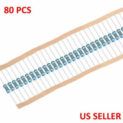

                  Powered up the Tx and Rx and tested the servo for 180 degrees.
                  Well that is not what I expected.
                  I got about 90 degrees total..
                  Did some research and found out that the servo is setup for 180 degrees but the Tx signal does not support the signal needed to get the 180 degrees.
                  Checked for options.
                  I found 2 that I can do.
                  1. Open the servo and add two 2.2k to the potentiometer (about $5.00)
                  2. Order a servo adjustment circuit to put inline with the servo. (about $20 and has the ability to adjust the throw)
                  I am going to look in my parts box and see if I have 2 resistors at that value.
                  I am thinking what I have are capacitors and not resistors.
                  Anyway., tomorrow if the weather turns a little warmer, I will be putting the barge in the test tank to get a waterline and to test the motor pod thrust.

                    I have ordered the resistors.
                    Paid a big $3.22 for 80 of these little ... parts including shipping.
                    Will be here next Thursday.
                    Only need 2.
                    Thought about the servo tuner but it was $ $26 with shipping.
                    Would get here end of April to end of May.
                    So I can use 2 resistors and have a box full of spares and save $23.

                            The resistors ordered to make my high torque servo in to a 180 degree servo were in my mail box.
                            After doing the in town errands, I went out to the shop.
                            This is what I got for $3.22 for 80 2.2K resistors.
                            This project will require 2 resistors.
                            Here is where I got them.
                            https://www.ebay.com/itm/324083572997
