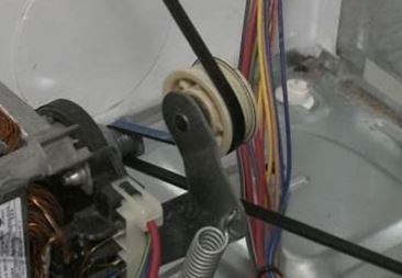

      How about something like a dryer belt tensioner pulley. Spring loaded.

        Thanks, Scott.
        All suggestions help me figure out a way to make it all work.
        I didn't spend much time looking at the o-ring failure but after thinking about it, it might be that the o-ring was too tight and binding the rudder post in the through tube.
        I did notice that the o-ring would stretch on the pull side before the rudder would turn with a jump.

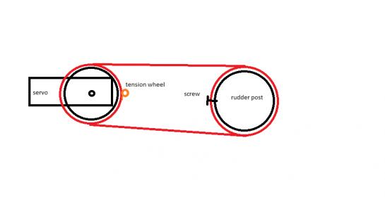

          On my barge I was able to use a servo pulley that was salvaged from an old sailplane. It has a small spool to allow for adjusting tension I also went as far as to put an anchoring screw in the rudder post and recessed it to not interfere with the lines crossing the pulley I used leftover sailboat rigging line and it has been good for several years now
Name:	barge steering.jpg

            Greg, looking at your drawing, this is exactly what I thought would work.
            The issues in not the system but the cable I am using.
            It is fishing wire leader and it does not bend around corners very well.
            I needed to pull a lot of tension.
            Going around the 1" pulley I have on the rudder post was not easy.
            I also anchored the cable on the rudder post pulley and then again on the servo pulley.
            This morning, I had it all assembled and working.
            After about 5 minutes, I started seeing slack in the cables.
            My servo pulley had started coming apart.
            My pulleys are made from plastic sheet (1/16") glued together to build up to about 3/8" thick.
            It appears the cable got in between 2 layers and cut though the joint.
            What are you using for the cable/line between the pulleys? (belt?)
            Maybe that would help.

                            The original pulled down enough to rub on the pulley edge.
                            The small screw is to capture the steering line so it does not slip during operations.
                            There is a screw at the front of the servo pulley that captures the steering line ends and allows me to put tension on the line so there is no slack.
                            The pulley installed.
                            There is a brass 1/16" rod going through the pulley and the brass steering tube post.
                            You can see just the very end of it.
                            There are modified wheel collars on each end to hold it in place.
                            I sanded both sided of both wheel collars flat so they would go under the pulley and not drag on the deck.
                            In this photo the steering line has been installed.
                            Checked for pod centered on hull and tensioned.
