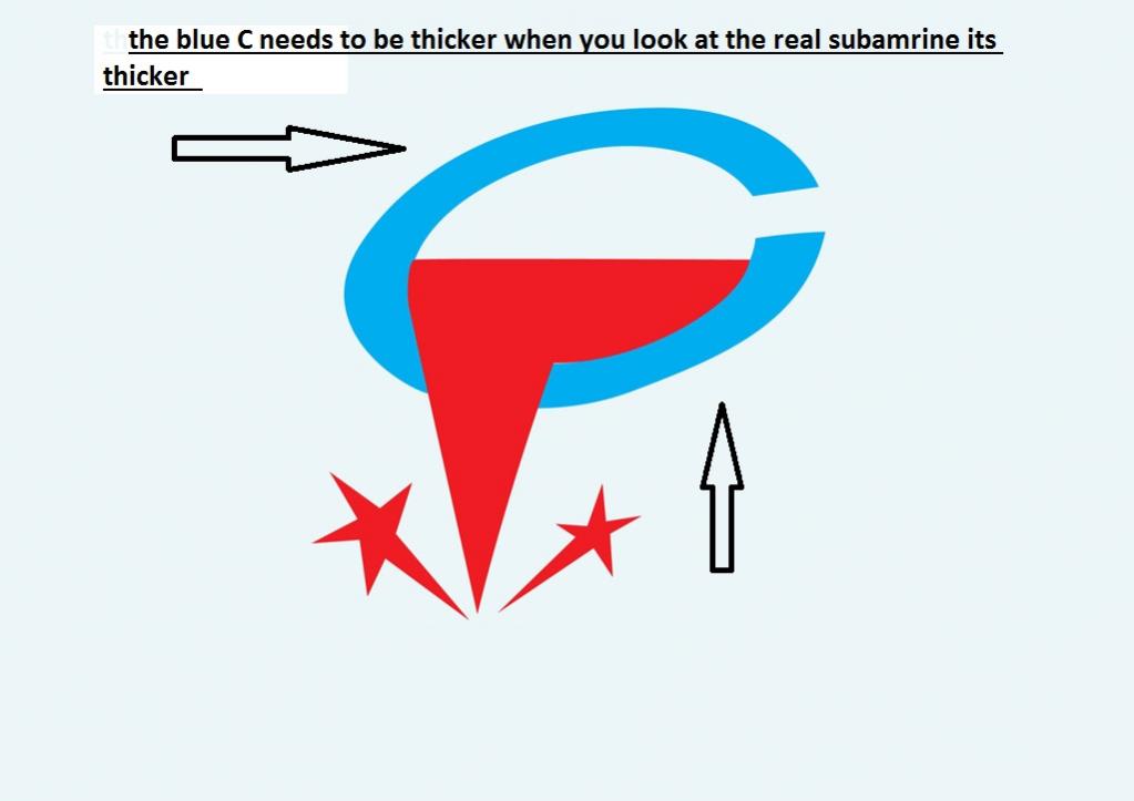

                          #57
                          I just sent 3 pictures to Cindy at www.aeroloft.com we will see how much for the decal then I will go from there. l think bob is right I don't want to take any chances I want it perfect. I think some one that does it for a living will do a better job then I can. I will keep everyone up to date on my findings I hope its good . The water transfer is good but I will have a black background so I think the colors may not be that vivid . That's the reason I'm going with Cindy I sent her these pictures she should be able to work with these to get the right size and shape of logo . thank you to all of you giving me ideas and choices much appreciated

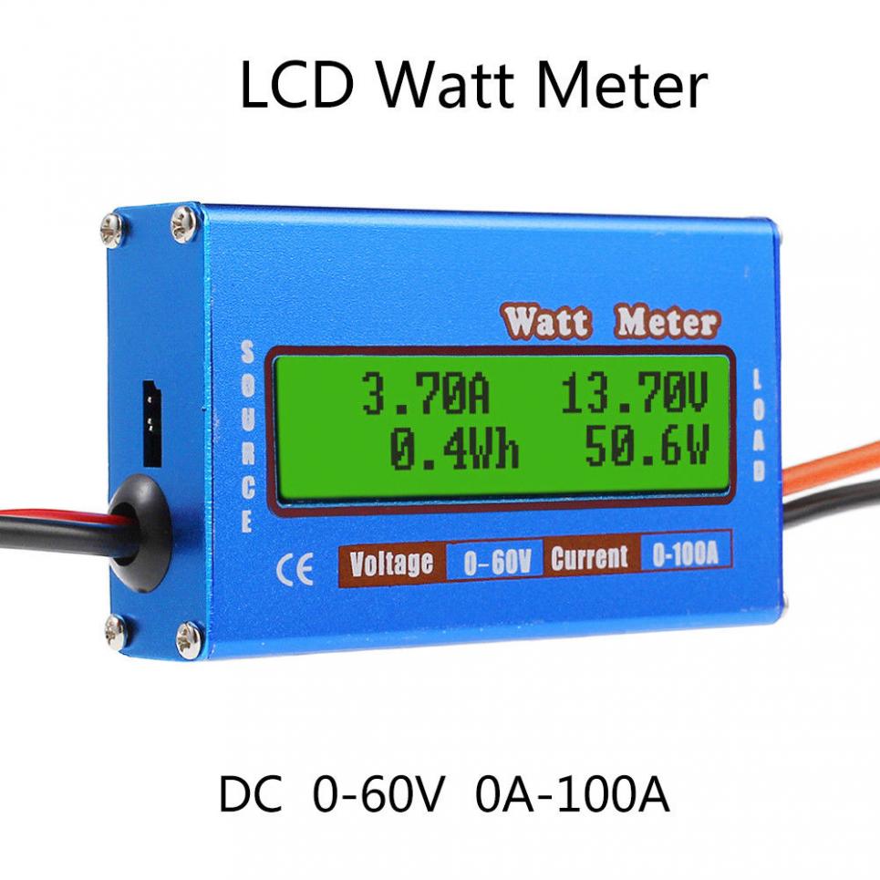

                              I NEED SOME HELP ANY ONE ! I posted a picture of a watt meter that was suppose to work for 6 volts system because my typhoon is a 6 volt system. Well it only seems to work on 12 volts only does not even glow light up does nothing on 6 volts. I want some thing that works .Can someone send me a link of a 6 volt meter that works for sure.
                              much appreciated
                              thanks Jim

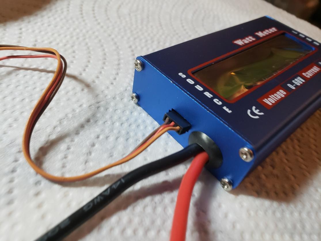

                                #60
                                I was told what the problem was there is a outside small power supply, small little pins that need to be powered up for the meter to turn on . normally you need to do nothing if the power is over 12 volts In this case 6 volts is to low for the screen to turn on with out some help. I now can now use it for a 6 volt system . I had no instructions on this unit that is what the real problem was
