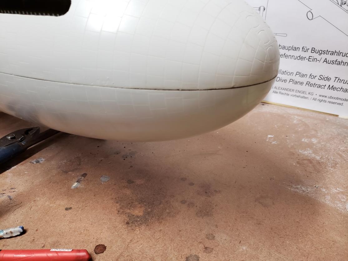

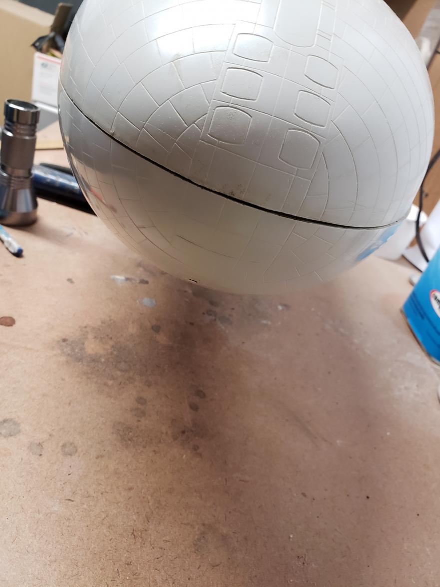

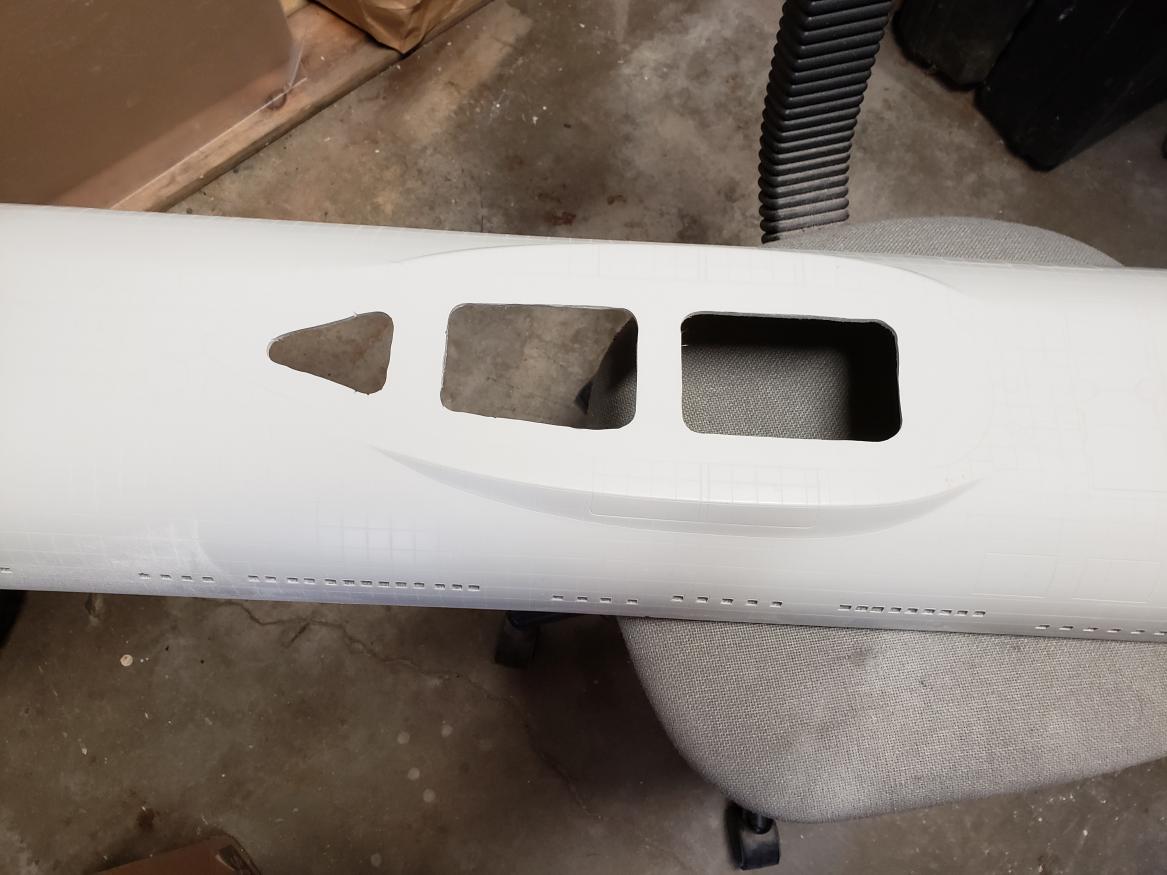

    there you see the gap I have at the nose of the typhoon. I will fill that In with Epoxy sand smooth and redo the etch graphic lines to match up with the rest of them. stay tune there's more to come

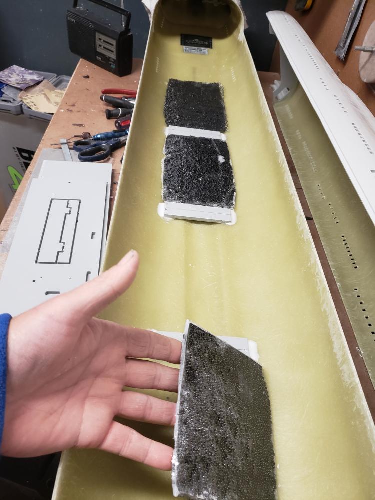

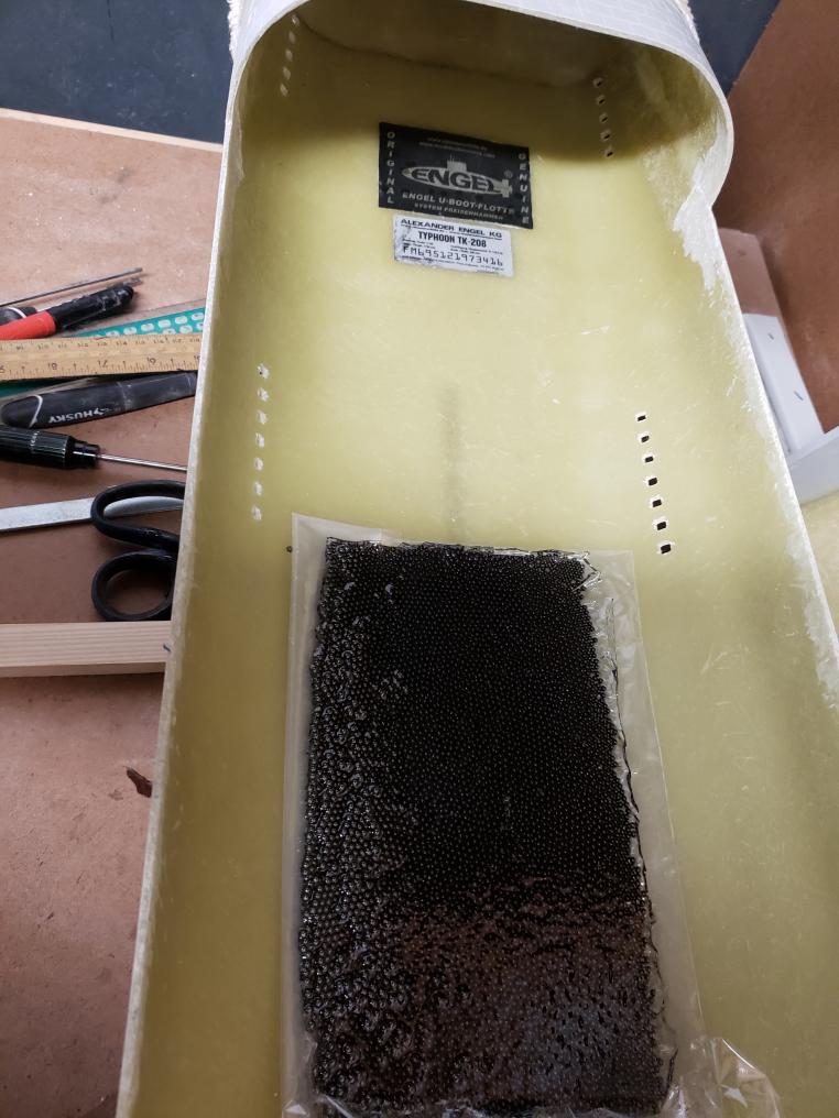

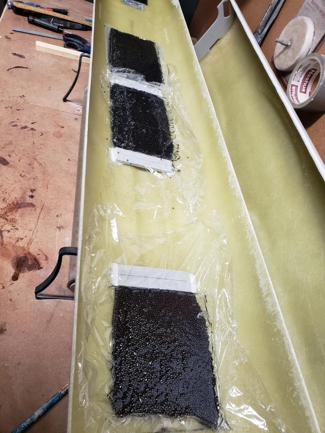

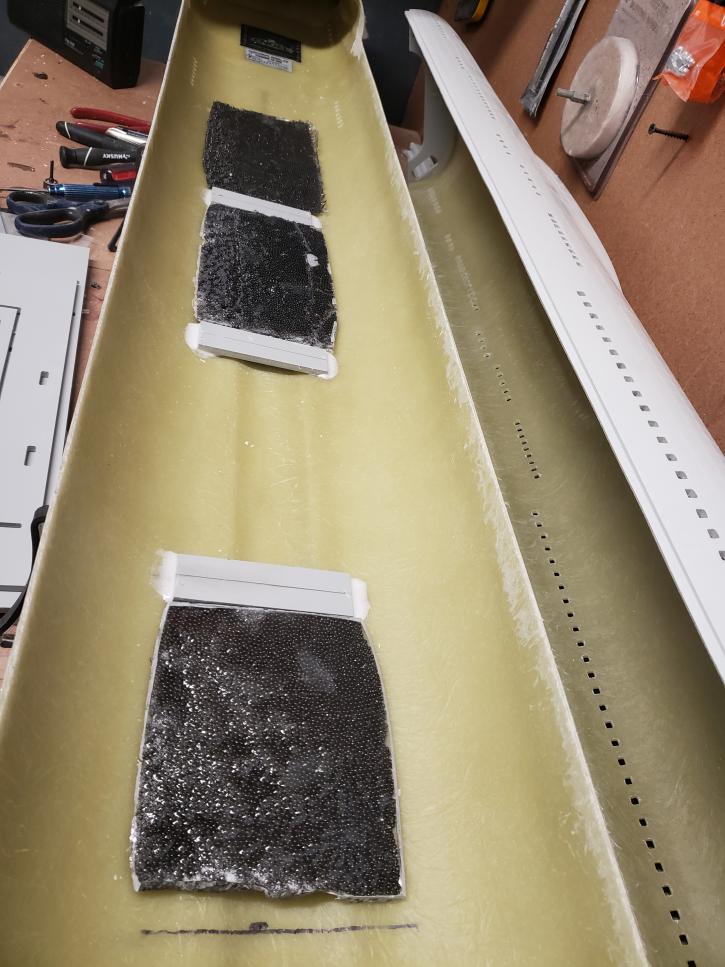

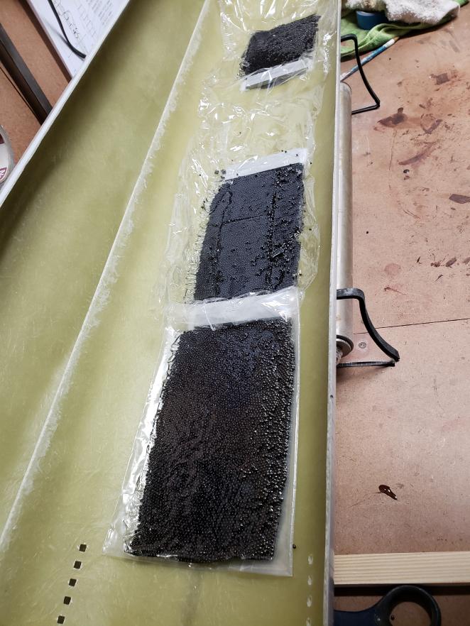

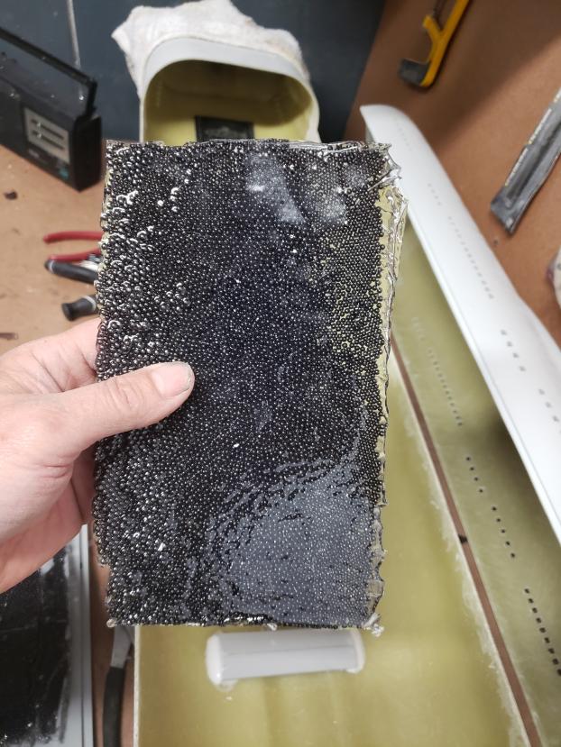

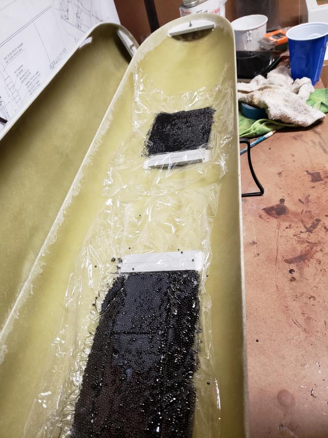

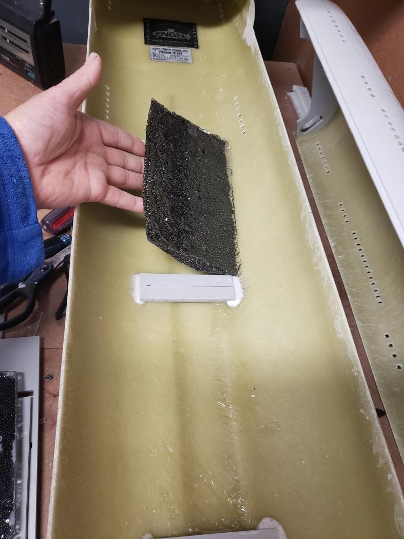

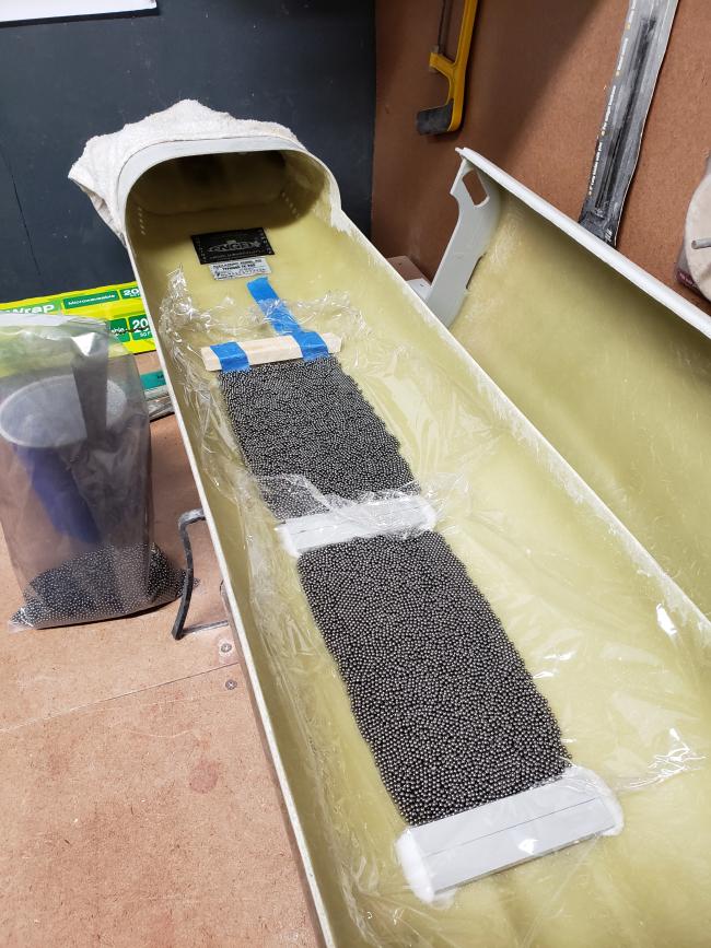

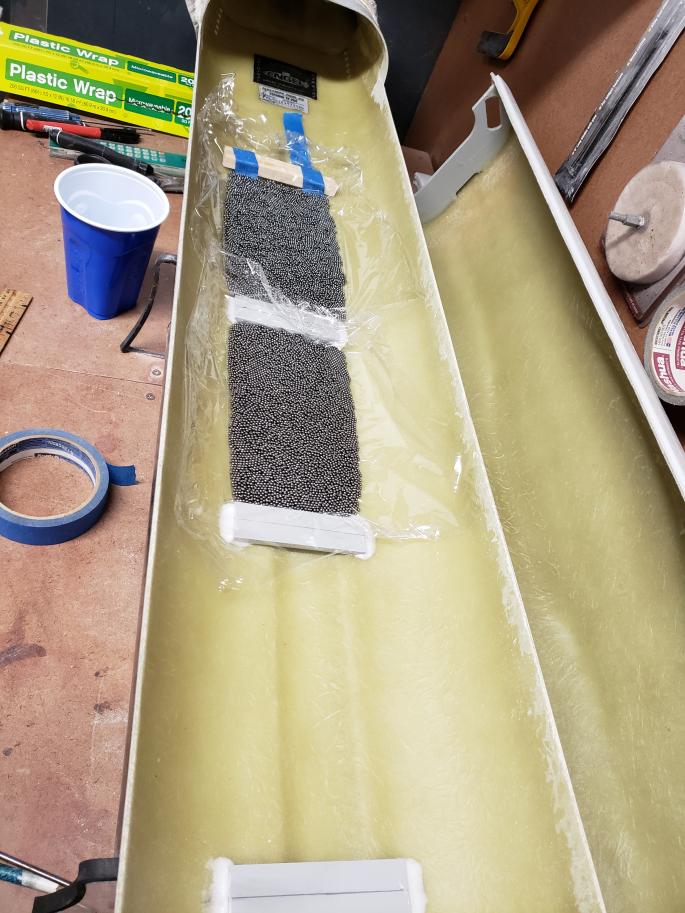

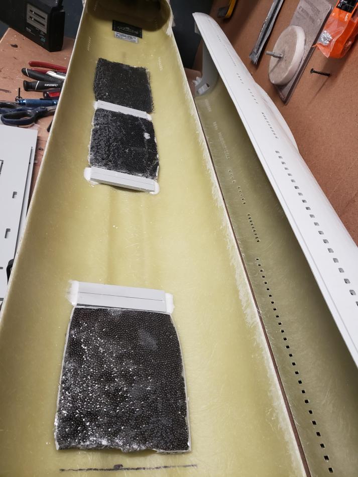

      keel weight
      I was given a good suggested advice into not adding weight to the keel. That's until the boat was ready to be trimmed . Some of Engel's boat models have to much weight . So I took it under additional Advisement, to add the weight but with a film between the keel and the weight so it can be removed . Once cured I took them out did a little bit of trimming, and know they are removable. So if I need less weight it's as easy as trim off some until boat is trimmed, once I have correct weight then glue them in . What do you think of this idea! guys

        pictures of weights cured ready to come out.

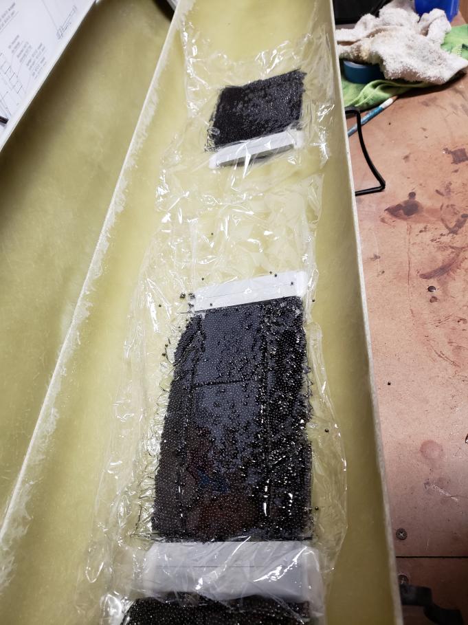

          more pictures

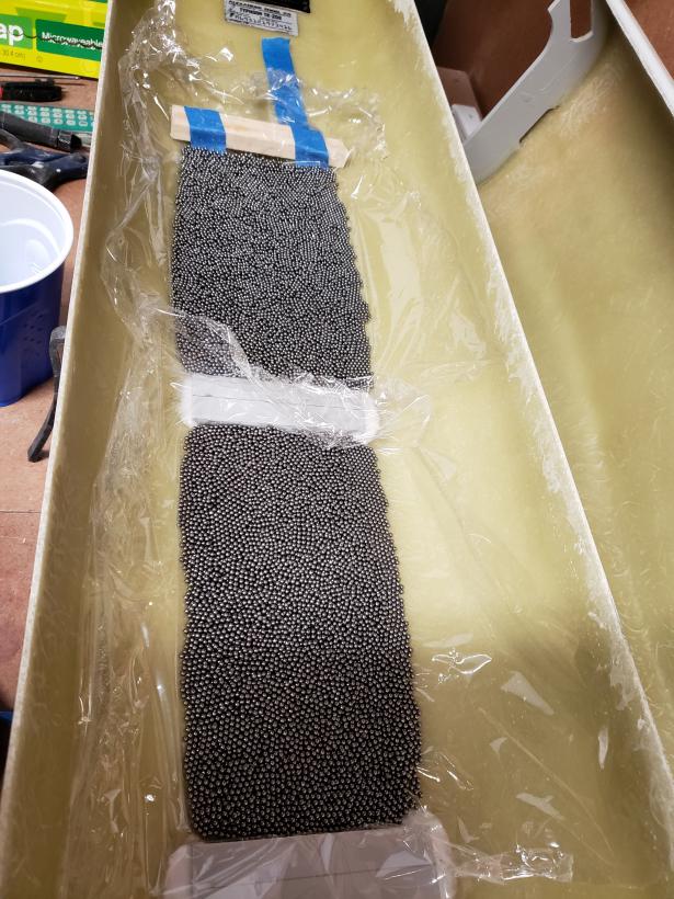

            picture showing weight is removable
            removable weights until later . Then i will glue them in when im certain on proper trimming .

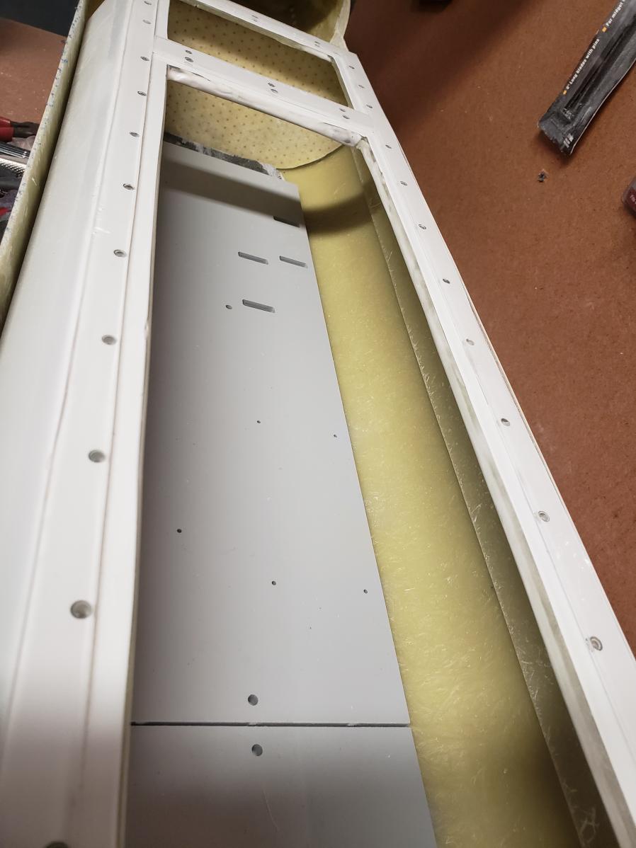

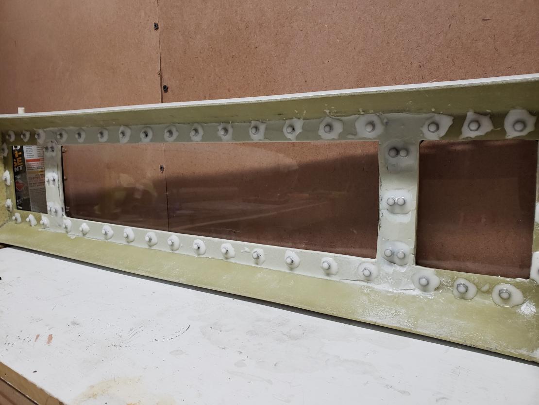

              picture of removable weight and the electronic box resting inside of sub . I will be epoxy the bolts in next.

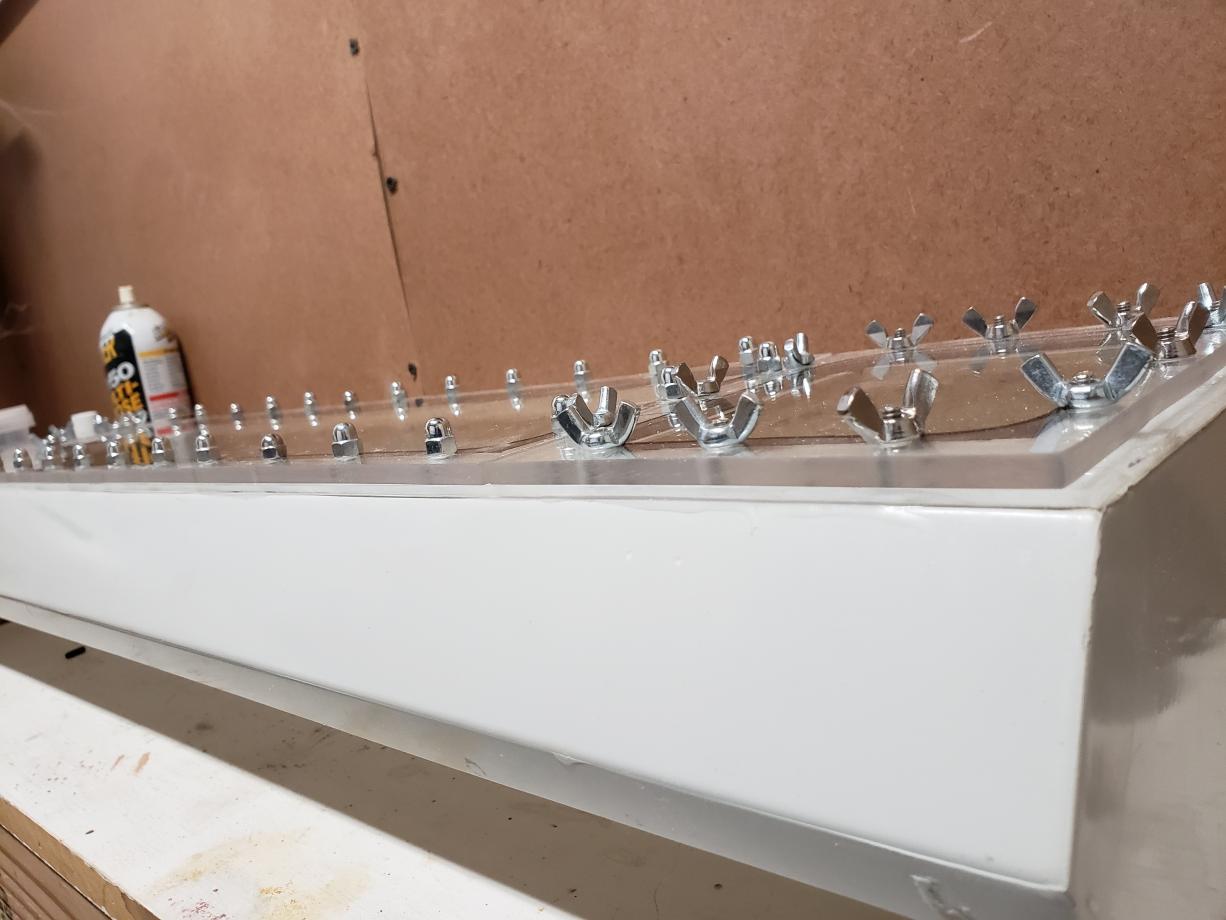

                Jim, You might want to check the bolts engle put in your kit. Your going to want to be sure there all stanless steel. When I was doing the radio box, I learned it was better to use stanless steel bolts with brass nuts. that way if you over torque the bolt it was the nut that strepped out and that was very easy to replace. A lot better then trying to dig out a bolt that has been glued in place. Best Wishes Mike Dory

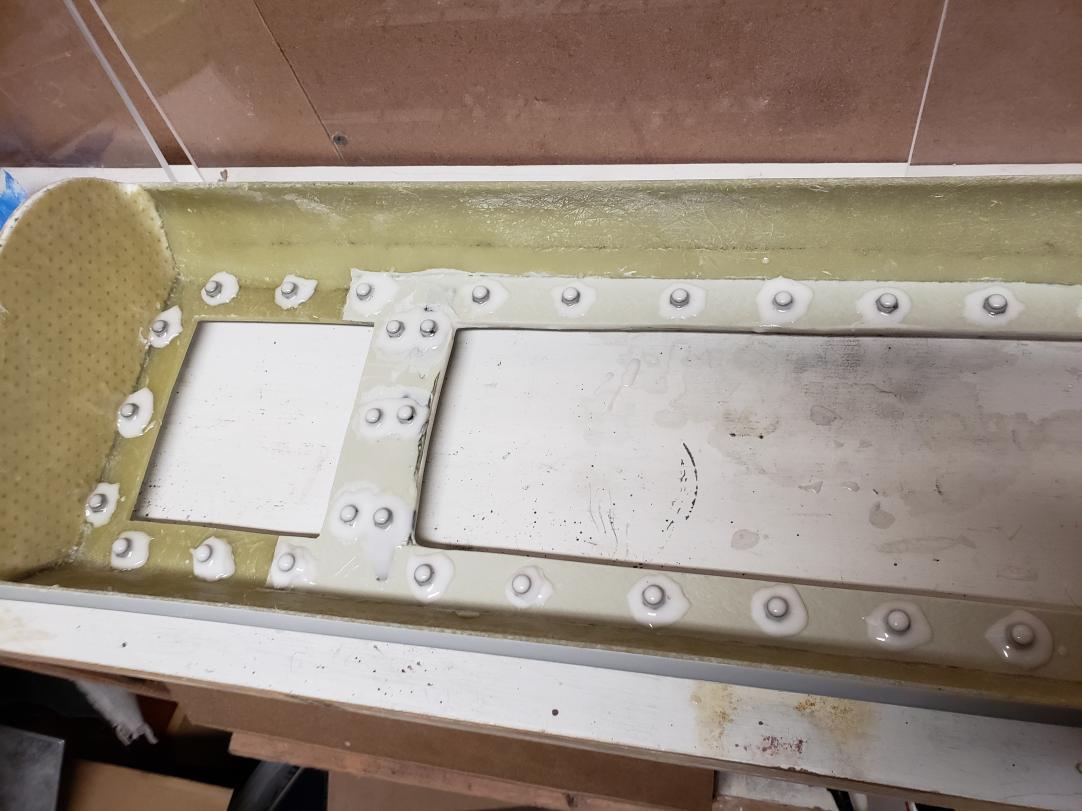

                  Hello mike
                  yes I think that's a good idea you are so right Engels has some bolts In the kit that are stainless steel. I have gone to home depot and purchase 3/4 long bolts with stainless steel nuts I will be carful when i tight them down . plus I have stainless steel wing nuts easy to get them off at least nothing is going to rust, Less likely I would say

                        more pictures dont be a stranger comments are welcomed ?
                        trimmed out the top half for the coning towers mechanical mechanism

                          here is my method to madness in placing my glued in bolts

                            commets are welcomed
                            one picture on bottom and one from the top completed

                              more from the top

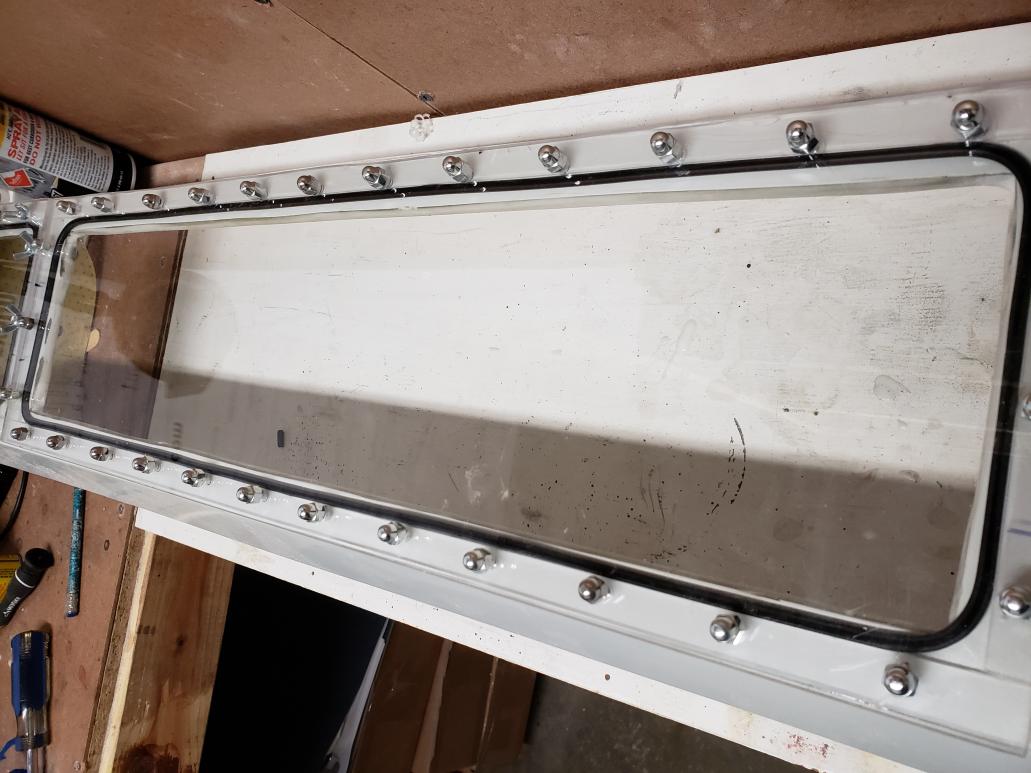

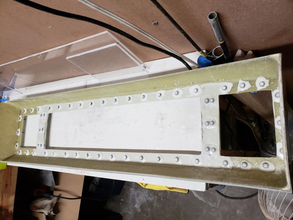

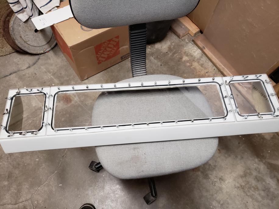

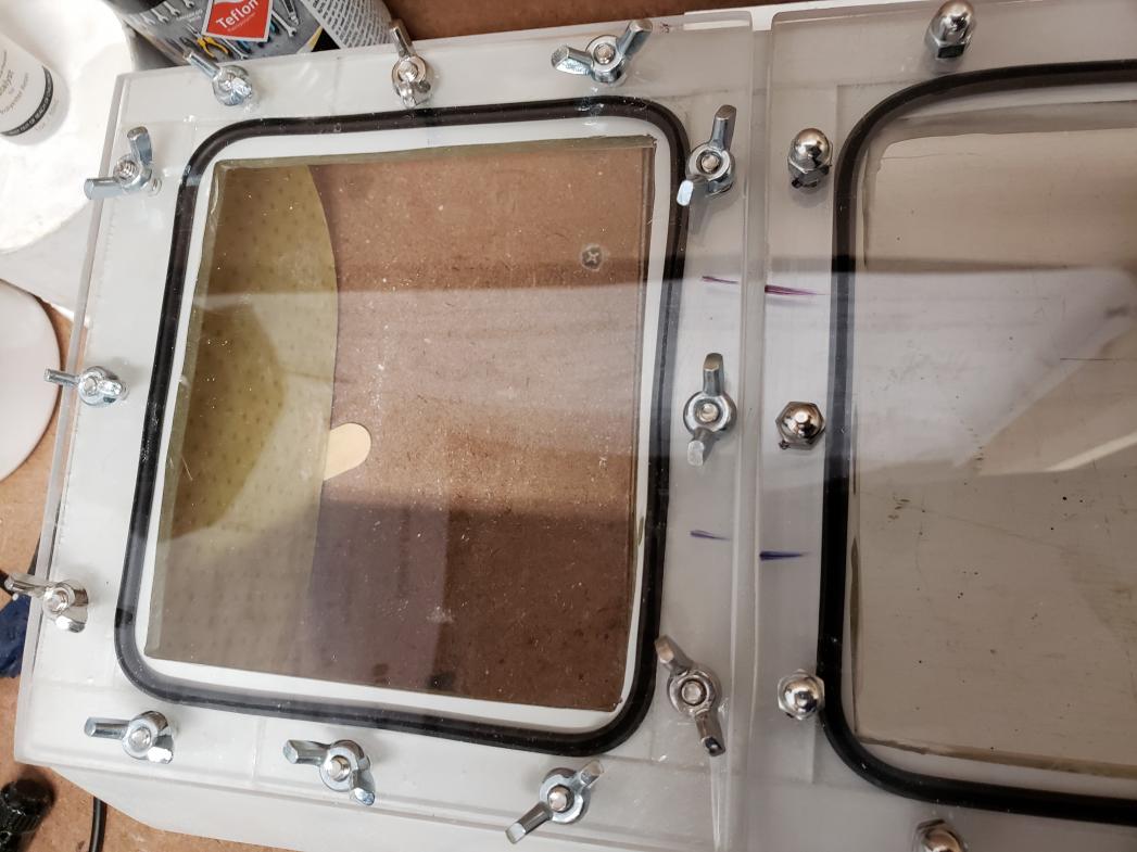

                              unit has been completed and wow this was a job to do very time consuming and precise
                              • u-571
                                • Dec 2008
                                • 110
                                #45

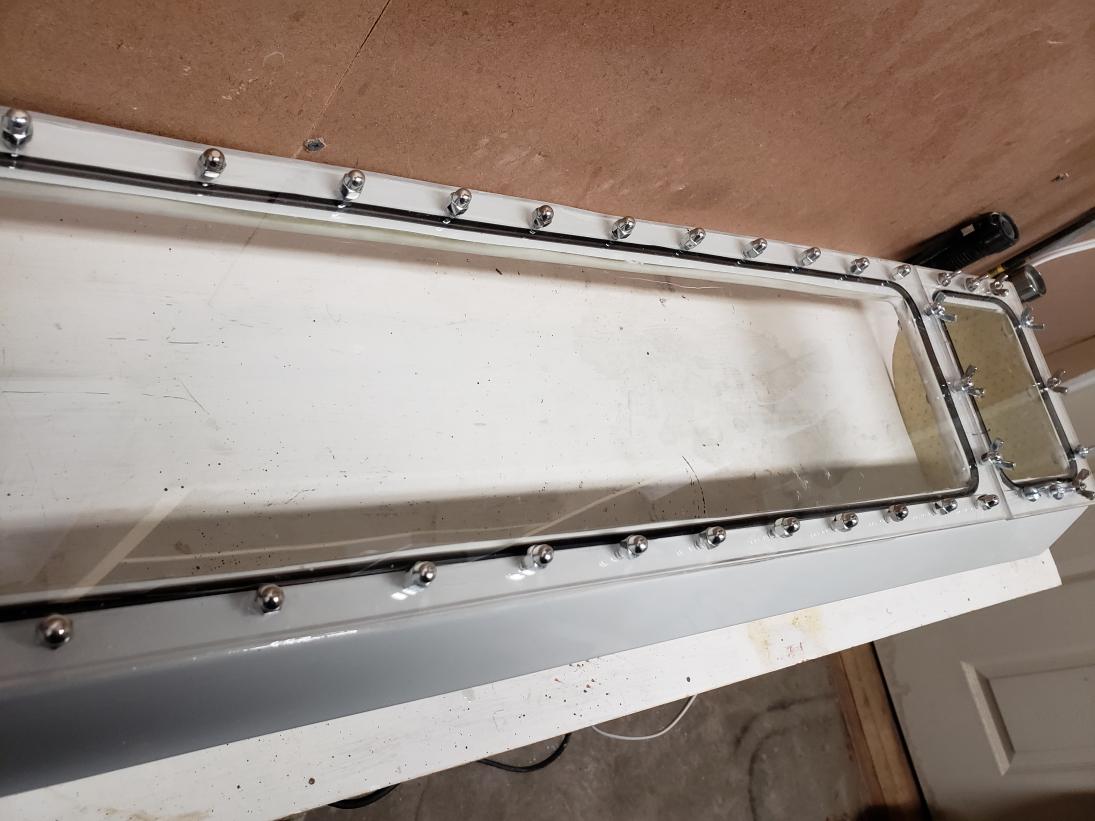

                                comments welcomed
                                more pics of the water tight electronic compartment !
