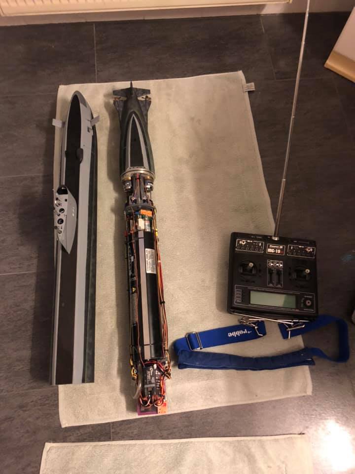

                            The last post about the build was October 2016. Well, I finished the boat but stopped there. No trimming, no run....so November 2020 I decided to finally get it wet. And so I did. Started trimming a week ago. Unfortunately it has a leak and it took me a while to identify where it is. Seems like te bajonet catch has a bit large tolerances. So I will degrease it and then put some scotch tape under the O-ring. Should fix the problem. And then back into the tub...
