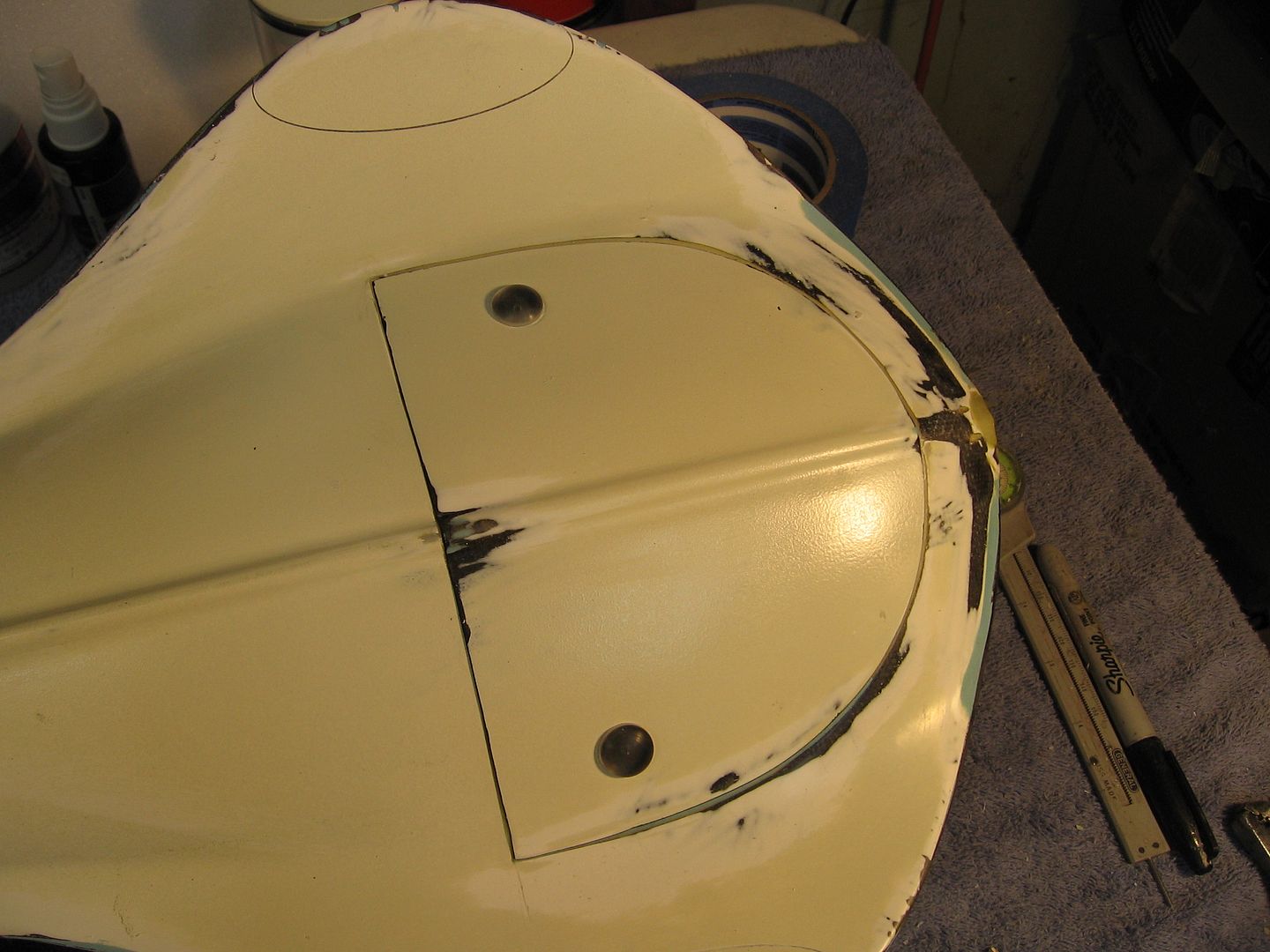

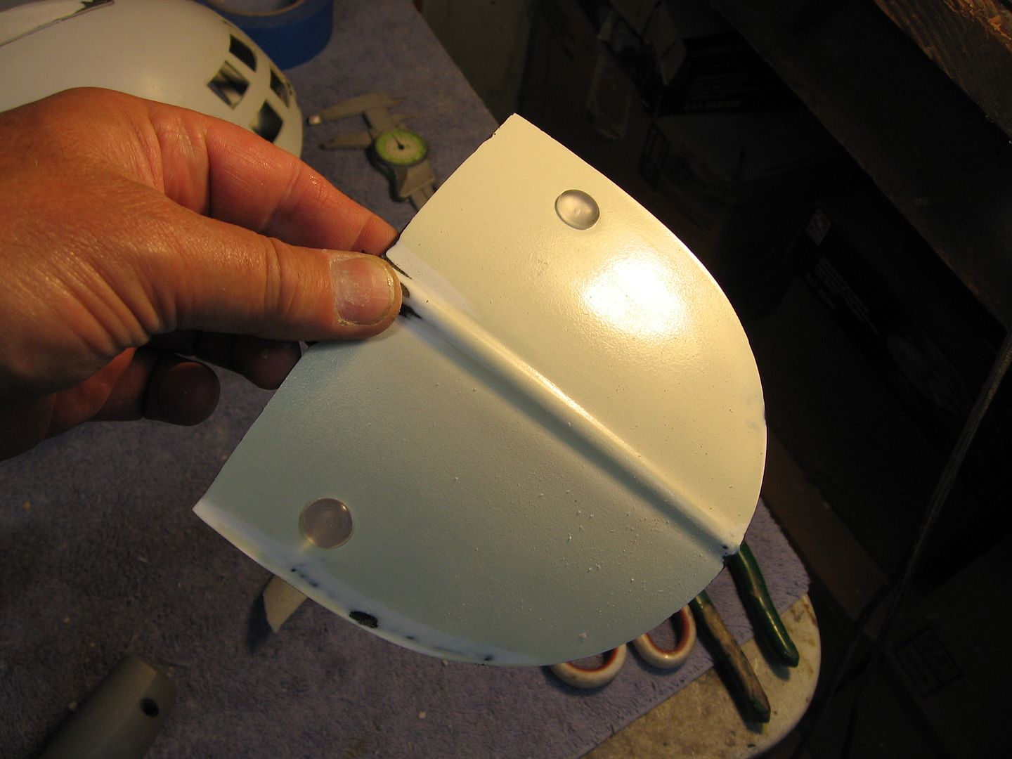

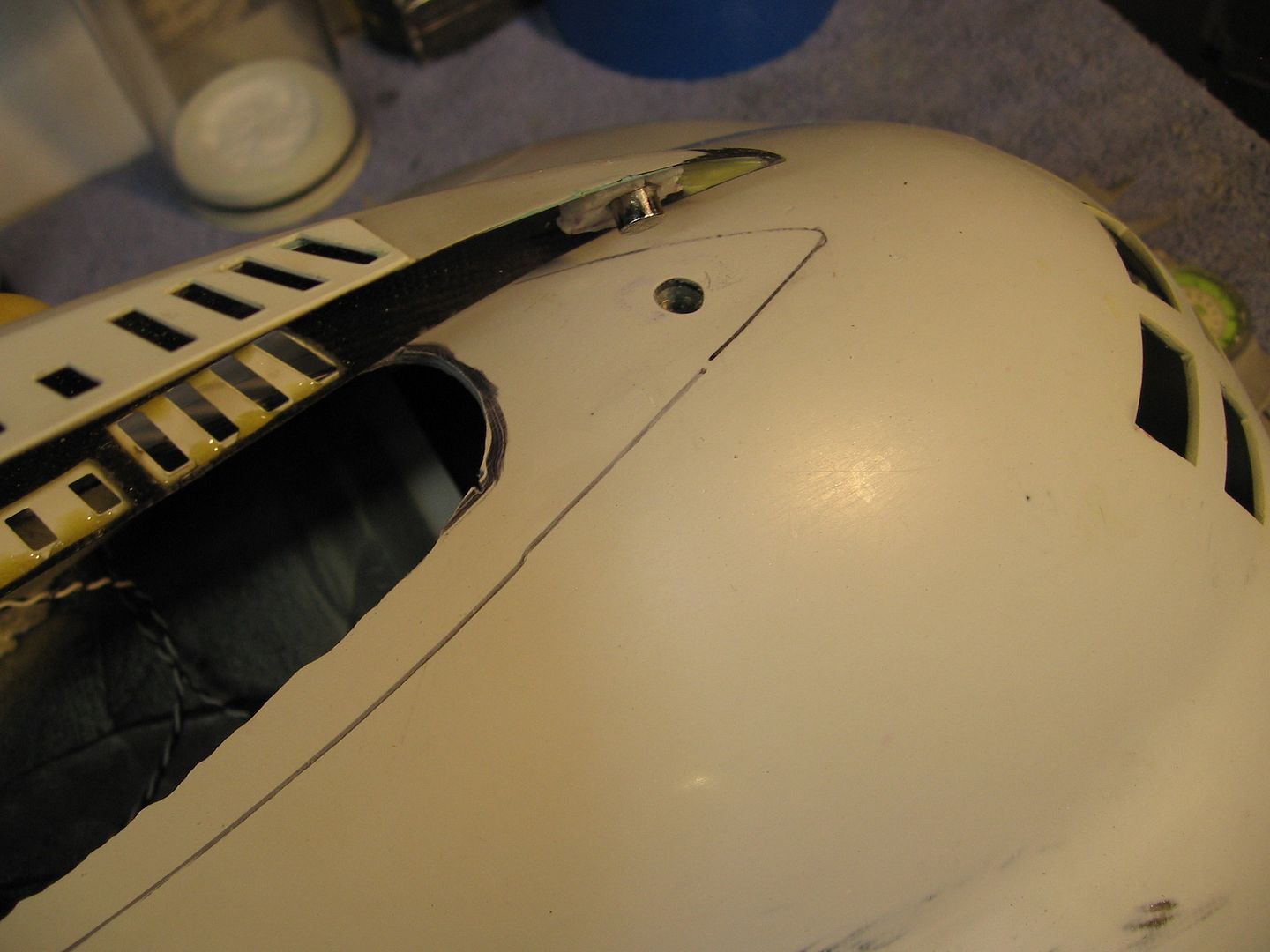

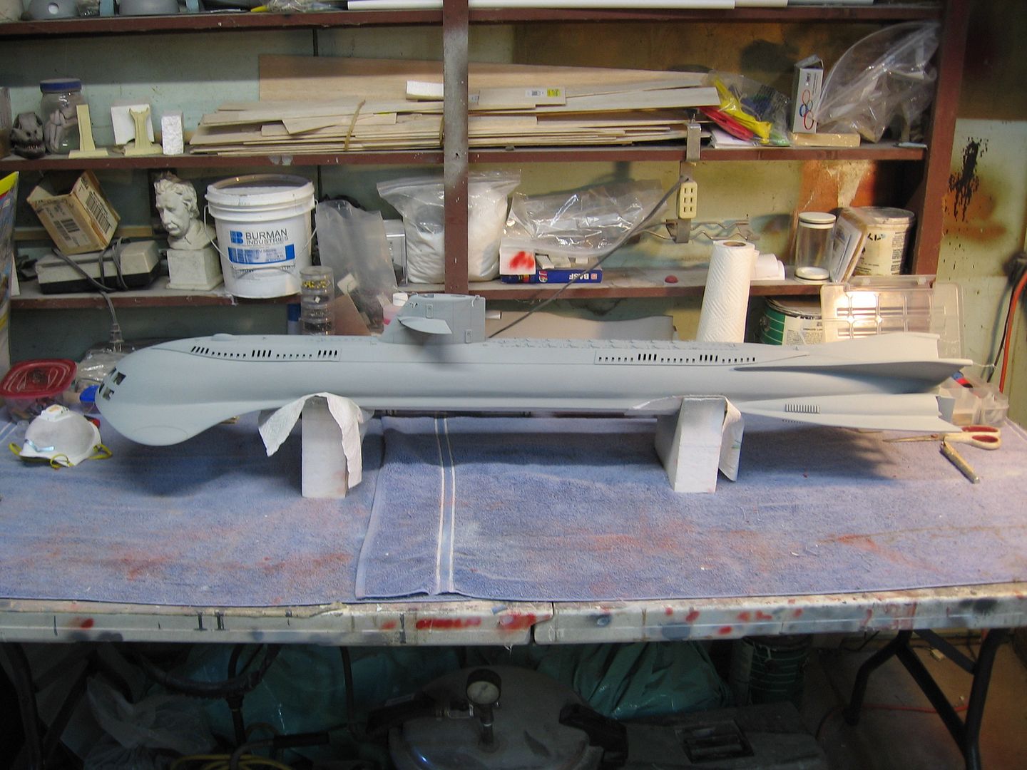

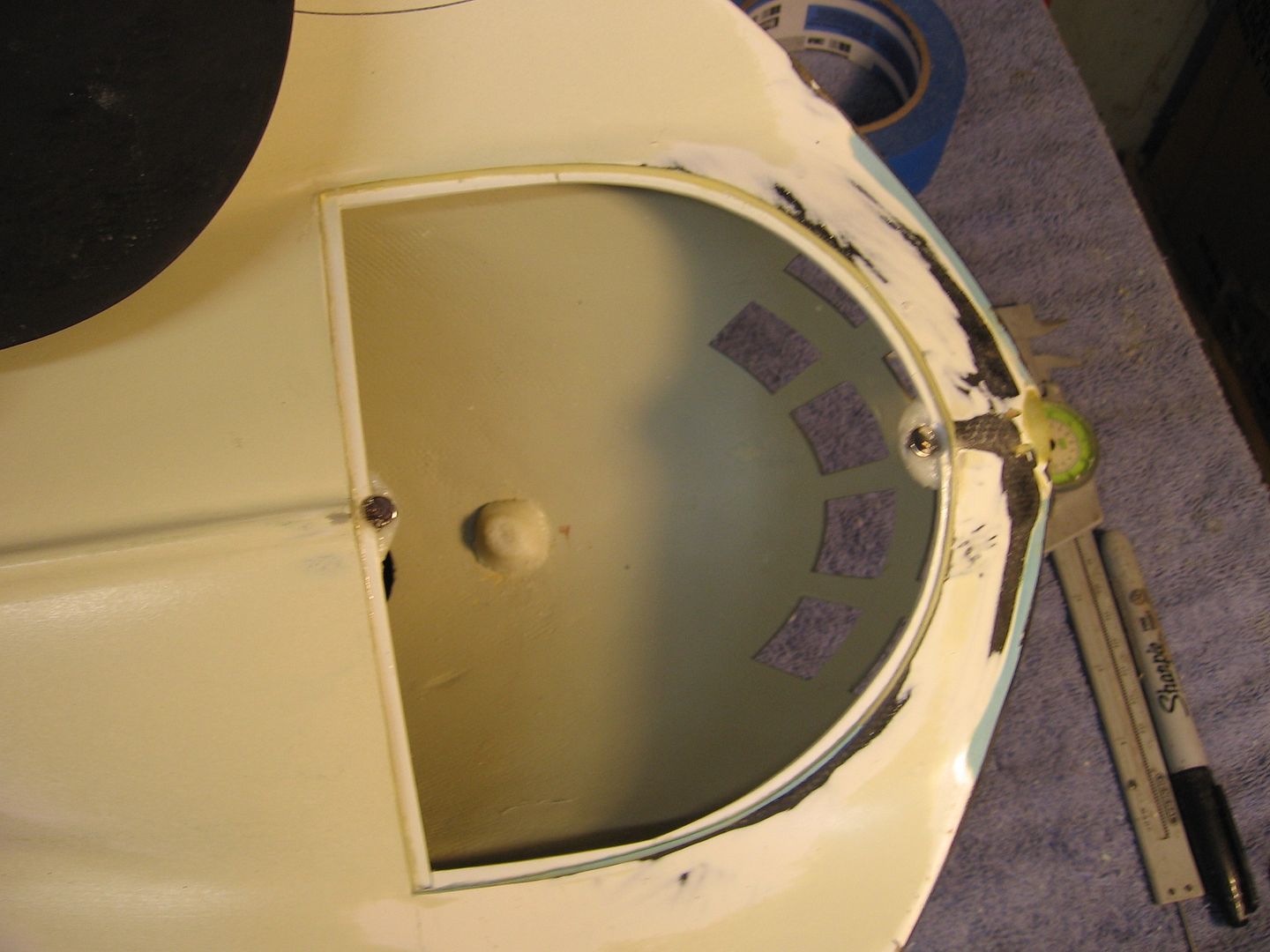

      Got the holes cut out so the Manta lights just press in tight. They will be removed for painting.
      Got the magnets installed for the bottom bow hatch.
      Got the deck installed with magnets that seat into deep recesses to aid in proper alignment and hold down. This is very strong and difficult to get open with fingers alone. Good! The hydraulic pressure should not be an issue in popping it off.

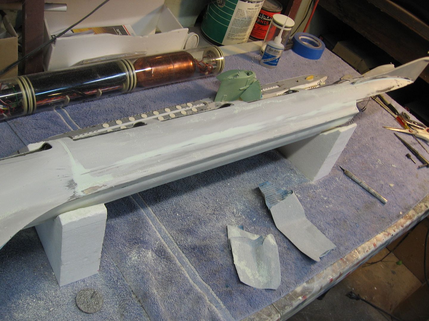

      Got the seam that Jeff hated soooo much blended. Gone.

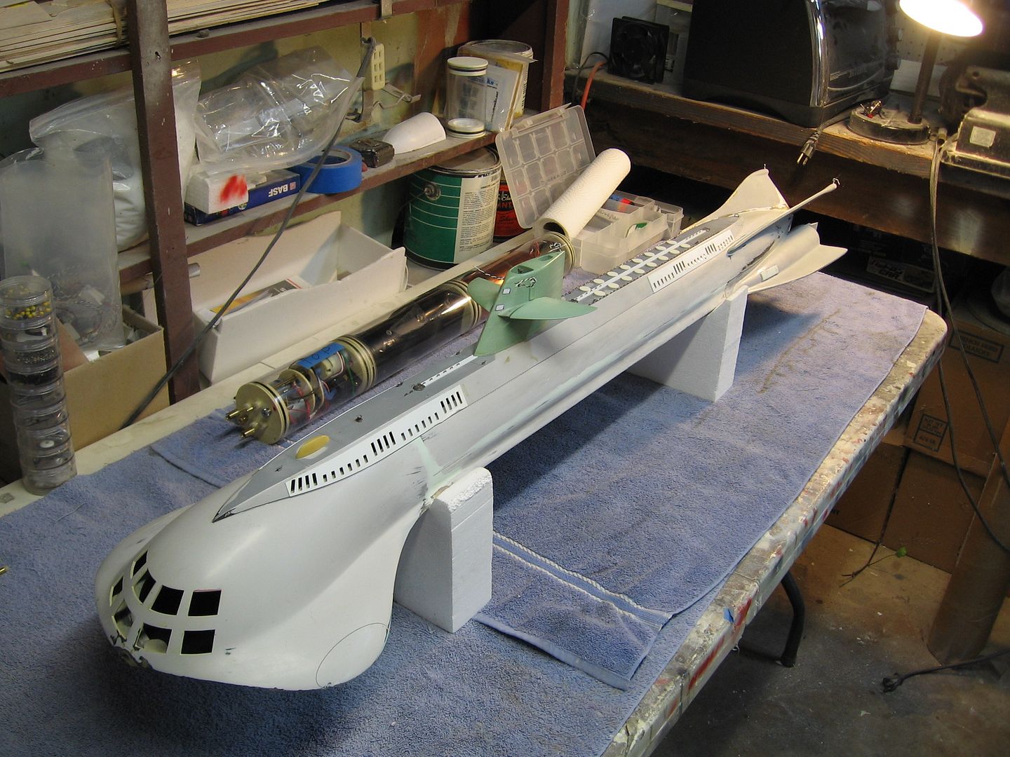

      Tomorrow I’ll blend the rear seam and close the gap. Go over the entire boat and get the bad spots. Red putty, preen and paint.
      Lights should be here Monday and in they go.
      More tomorrow. It will be all one color top and bottom.

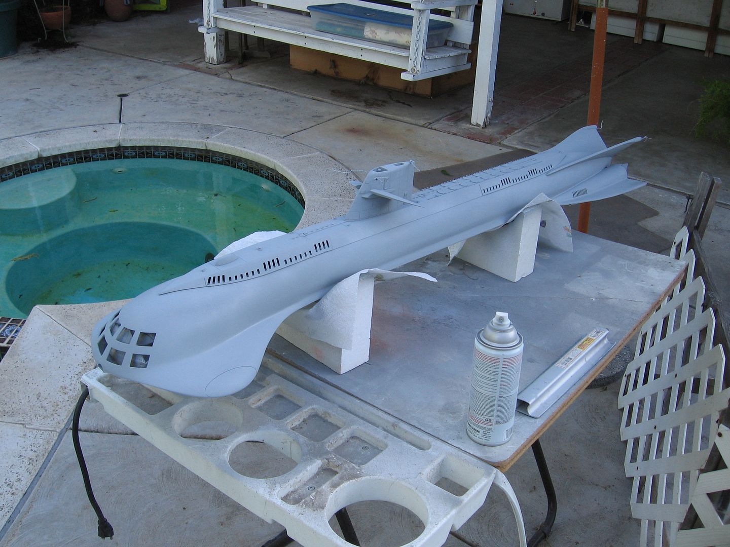

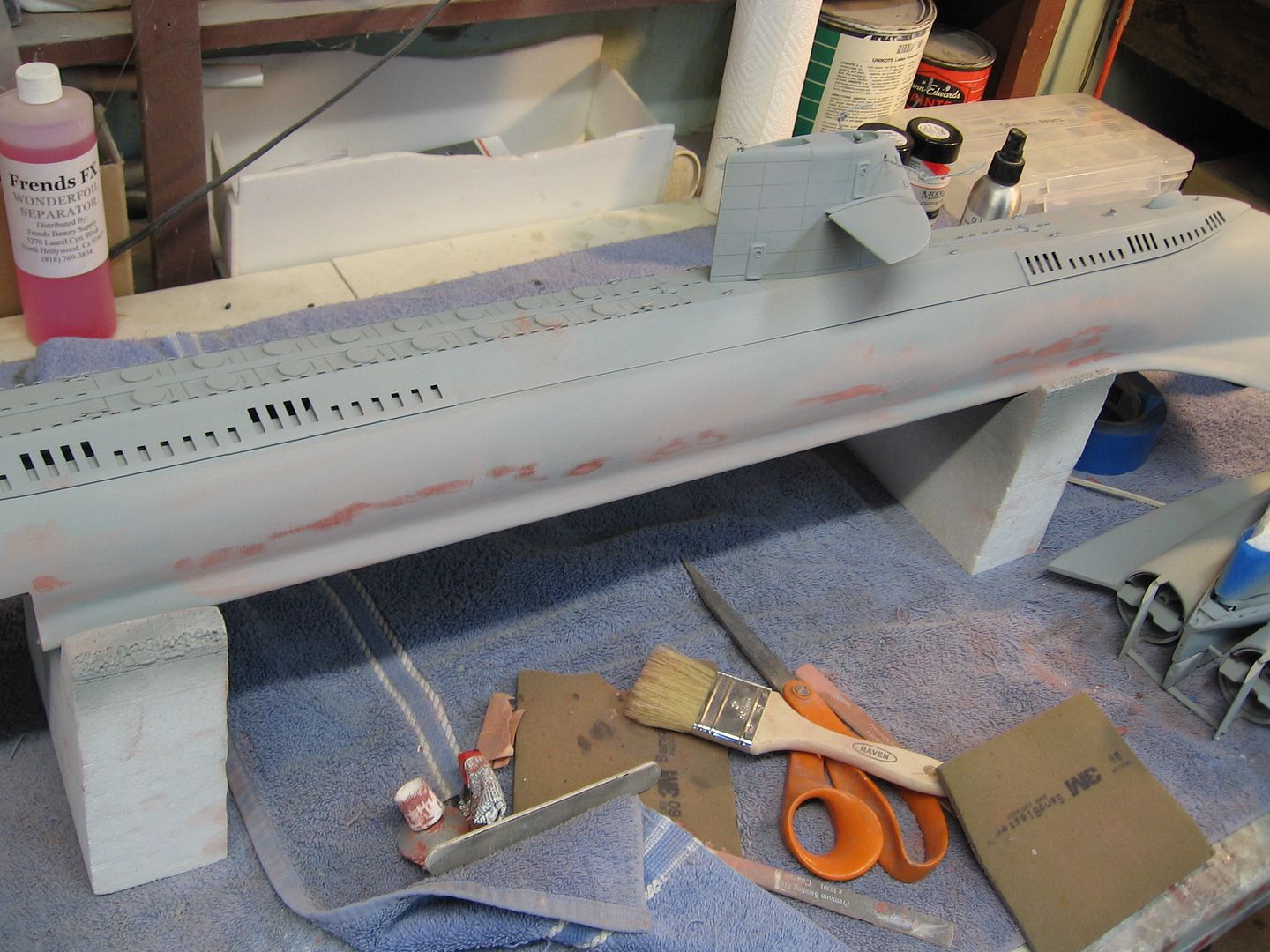

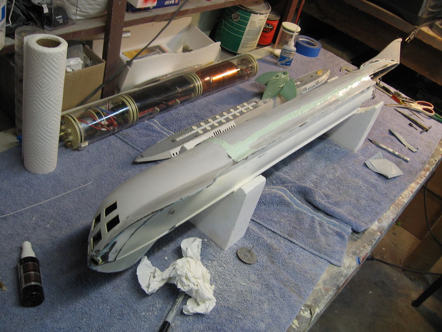

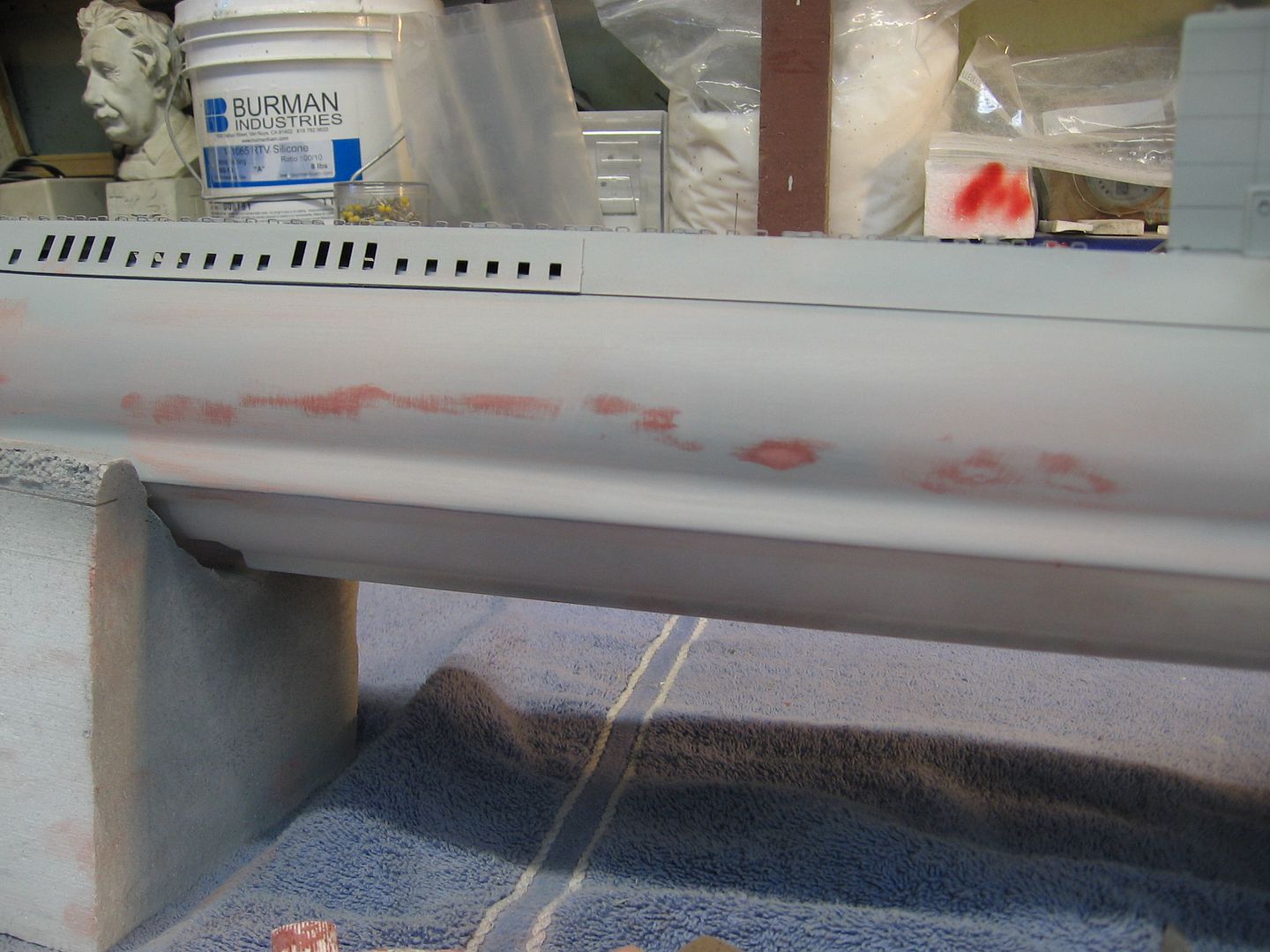

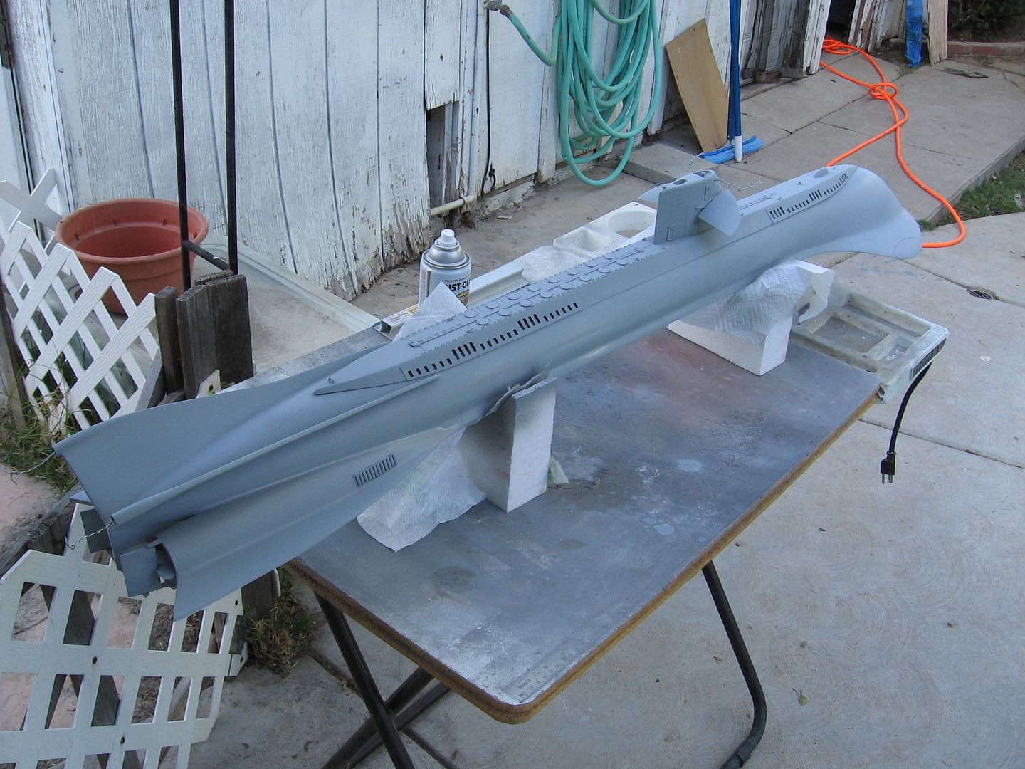

            Been preening filing and sanding all day. I sprayed on about 4 a layer of primer on which happens to match the correct color. I used white primer on the bottom. Just about have all the blemishes. Still have the louvers to blend in and I fixed the Tesky…I mean pesky seam in the back.
            A bit more tomorrow and I can install the lights. Then we wait on the sound board, battery, radio and observation deck to get here. Jeff’s working his hard on all of that. This gives me some time to preen some more, let the many layers of paint dry and clear coat it.

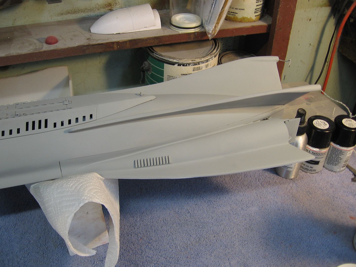

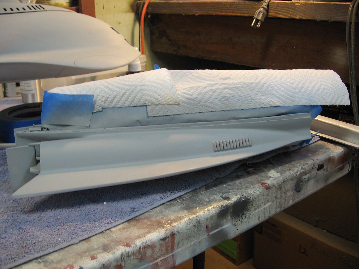

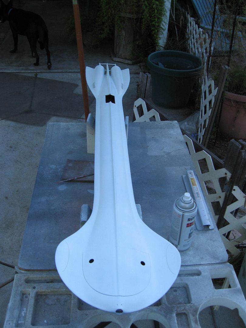

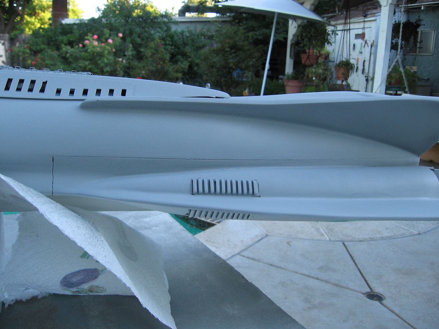

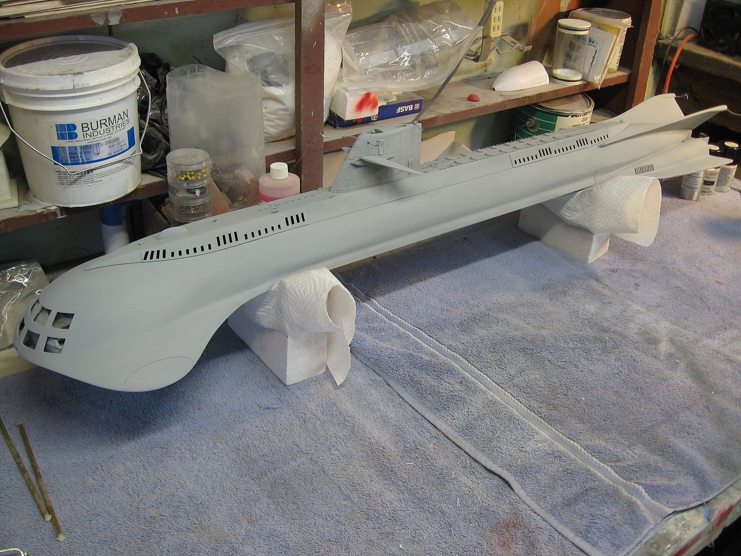

              I’ve spent two days now going over the surface again and again to get her smooth. She’s looking great now. Louvers all blended in and the final paint on.
              As you can see the stern seam is pretty darn clean now. Got the under sides of the dive planes in the stern and the sail painted white.
              Opened up the underside of the deck holes even larger at Jeff request they are just to the edge of the deck which makes for nice clean looking limber holes. Not to mention the free flooding!
              Tomorrow I will install the lights, lens and the rest. We should have a look at her all lighted up by tomorrow at this time.
              Steve
              Pick, pick, pick, I did a lot of this sort of thing.
              Getting these louvers in wasn't easy. They didn't match the curve of the Nacelles well as they were designed for the DeBoer hull not this one.
              Ready for lights and windows.

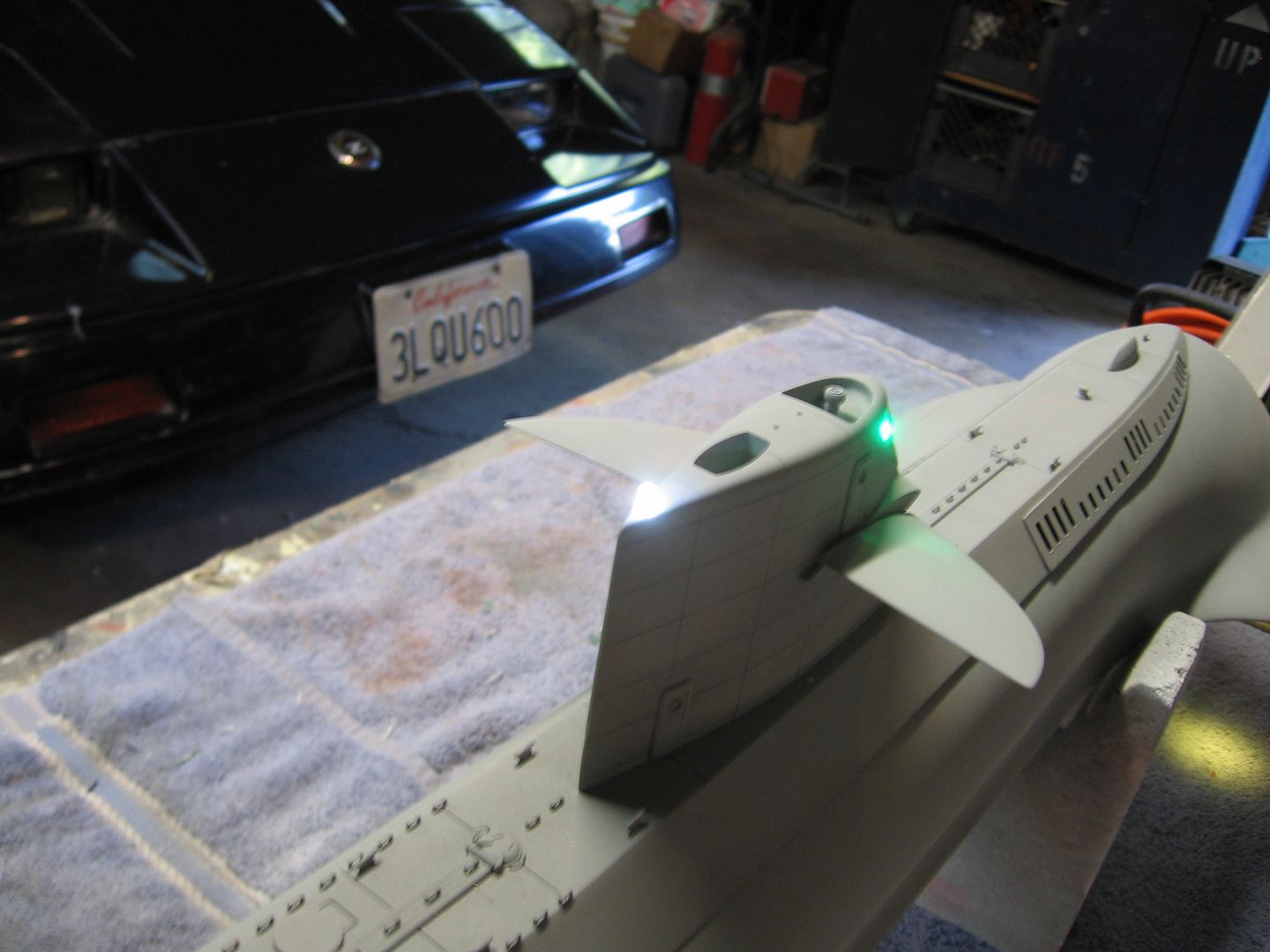

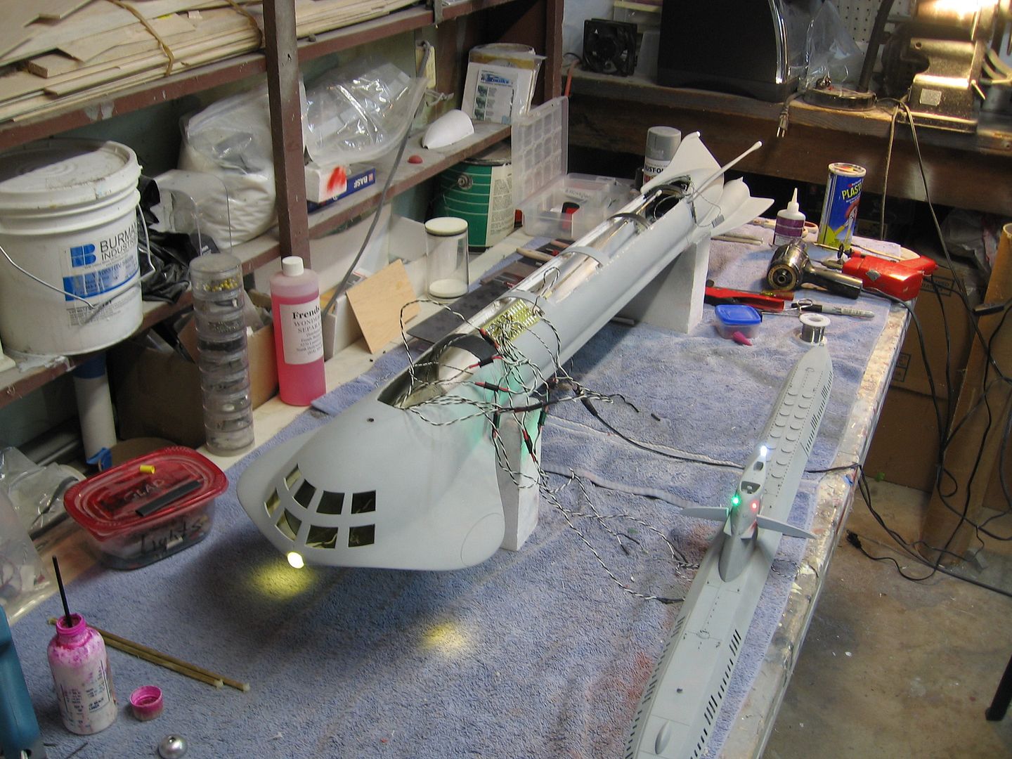

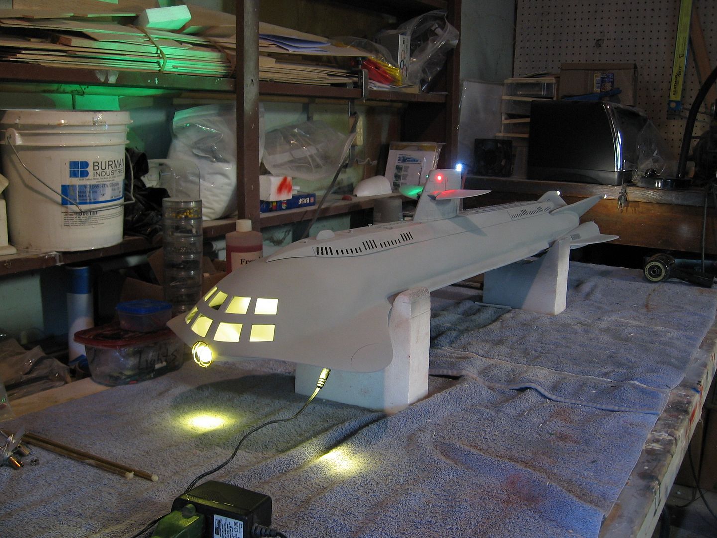

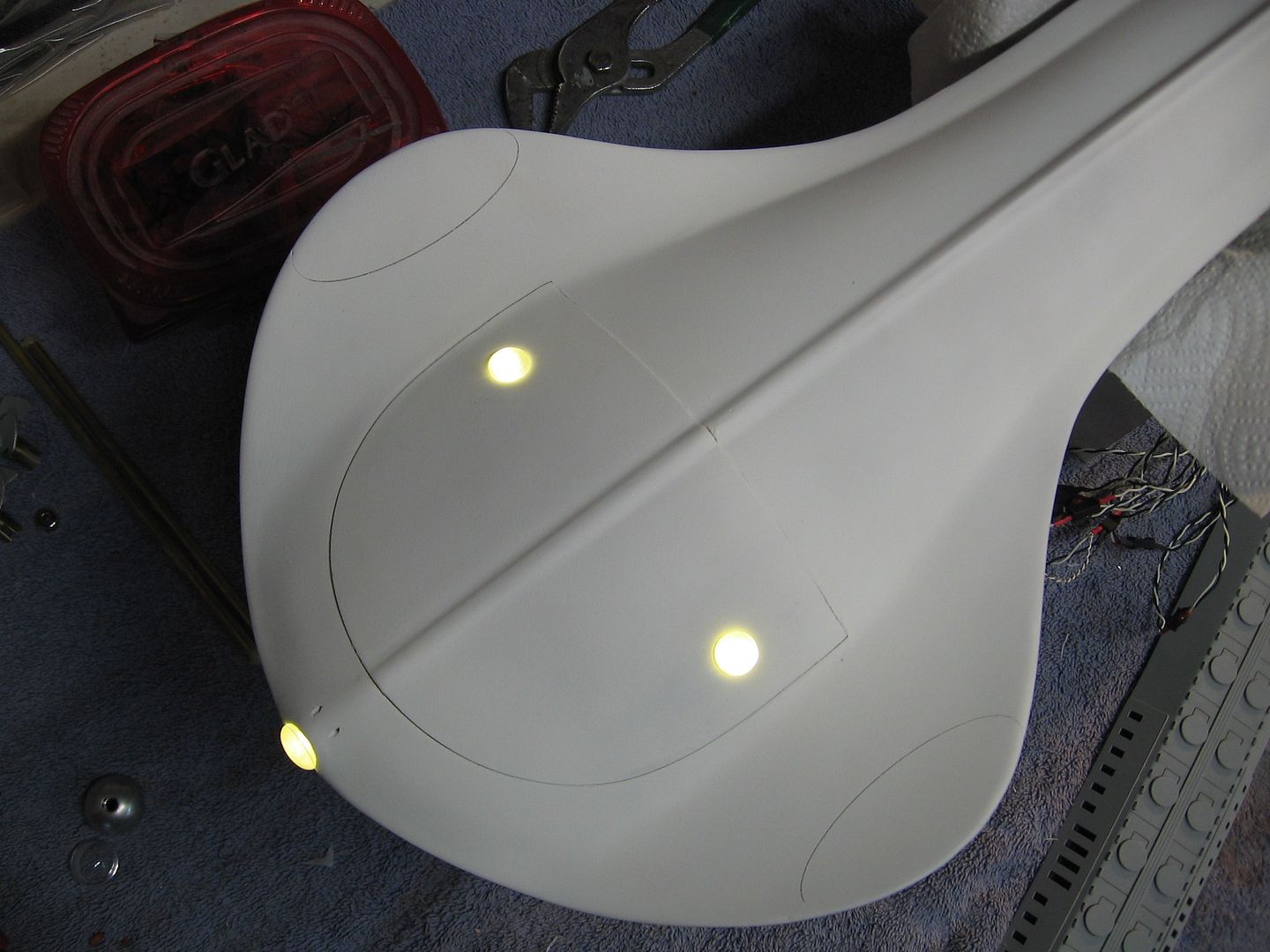

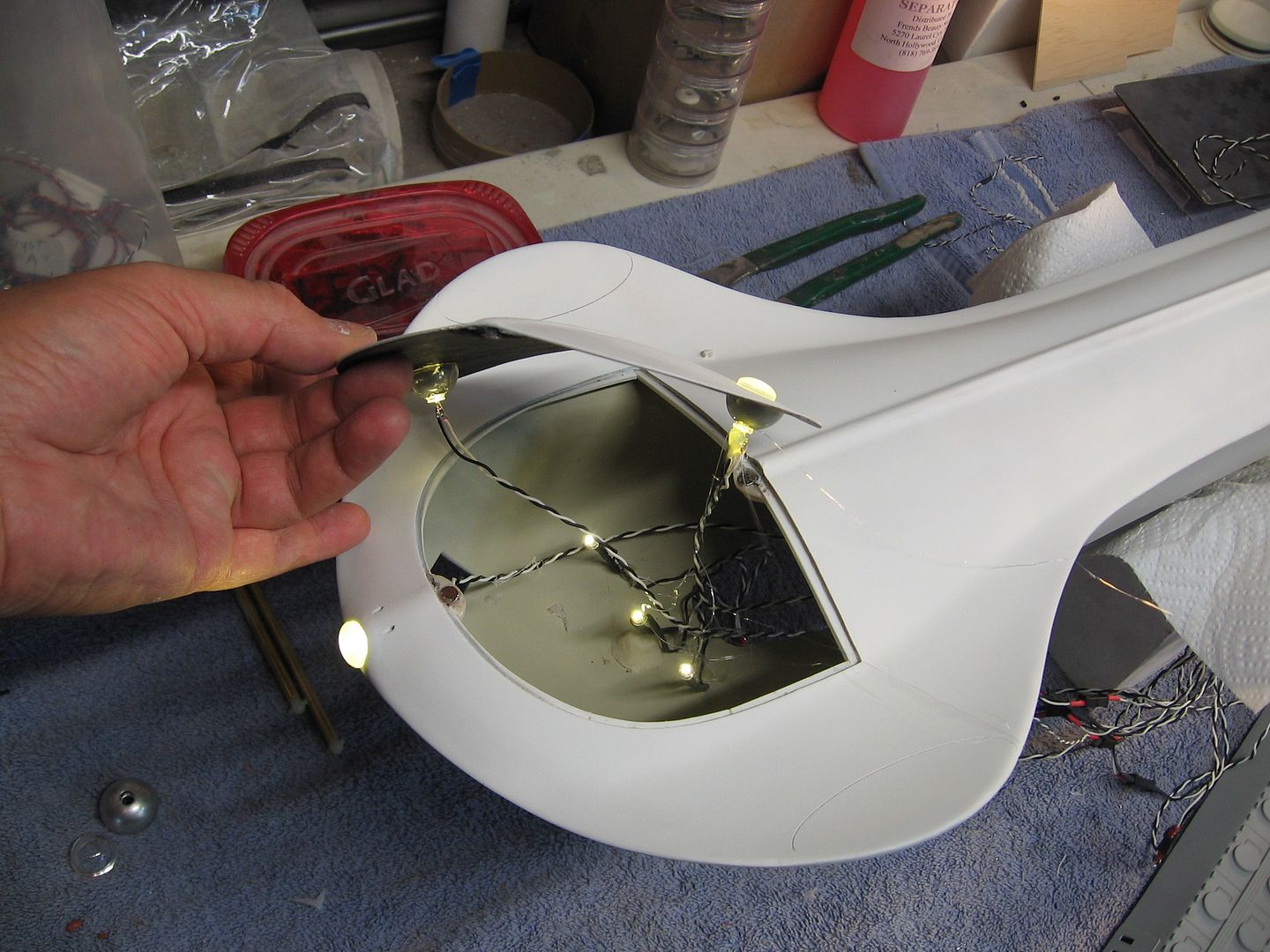

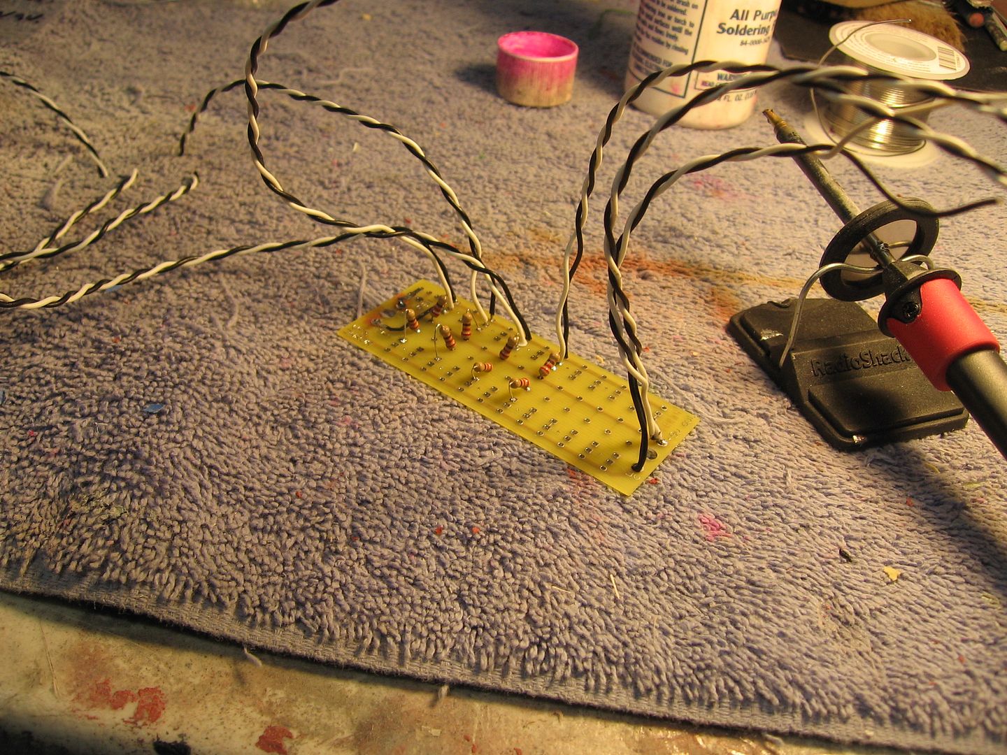

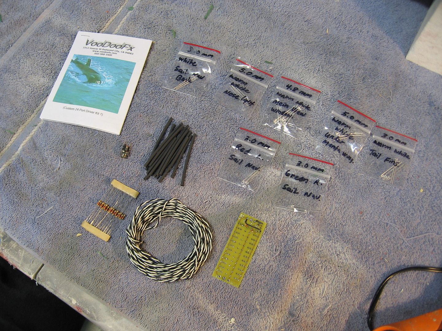

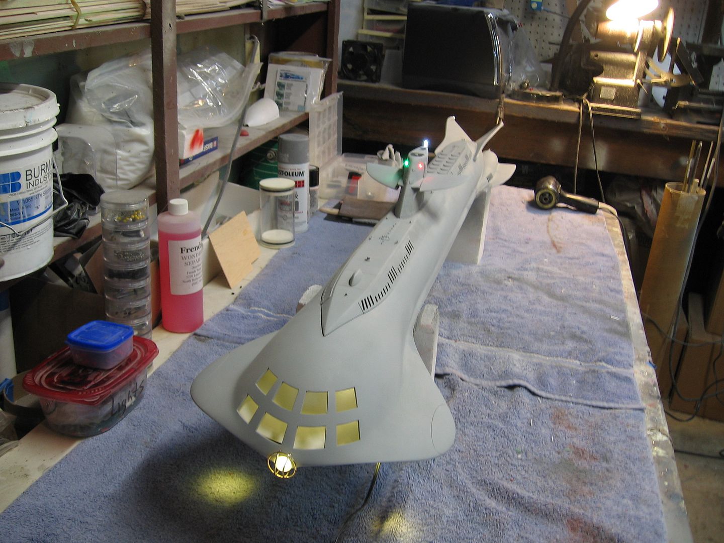

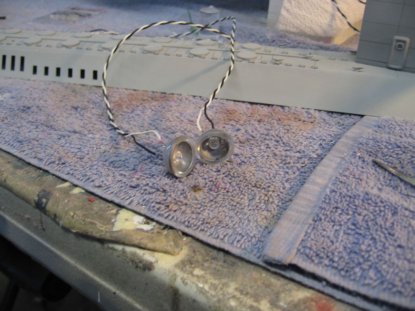

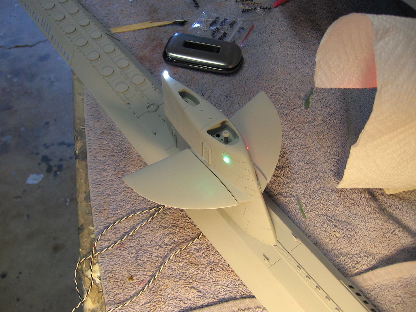

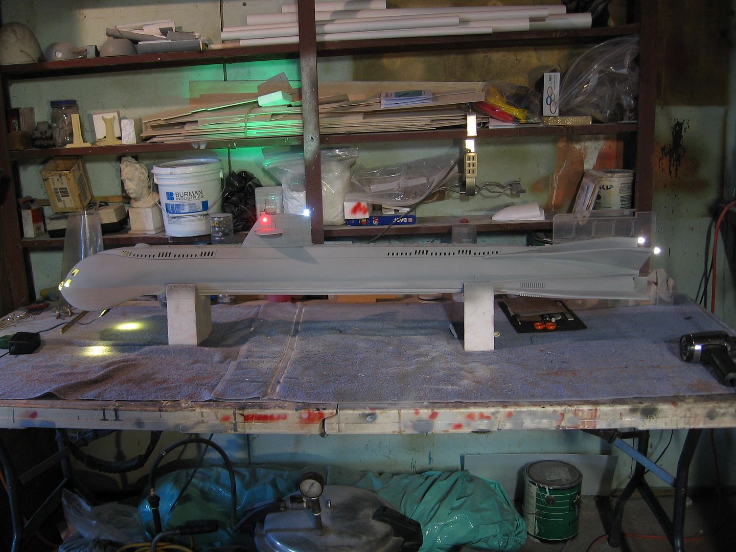

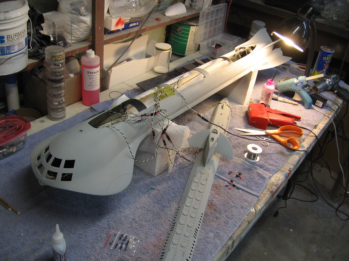

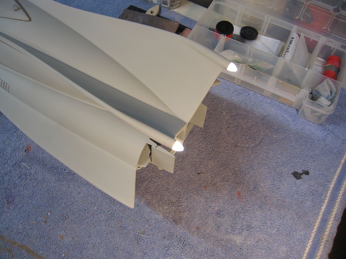

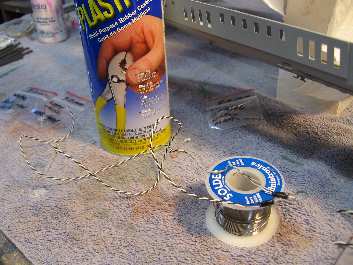

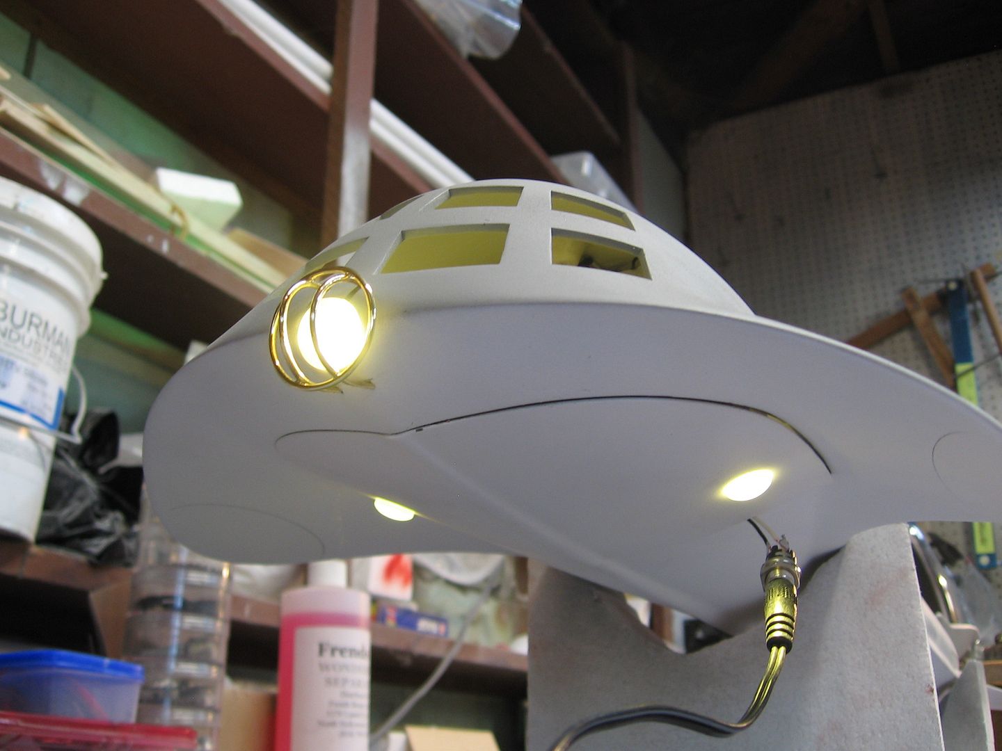

                  It took all day but she’s lighted. Randy’s Voodoofx custom lighting package like always wired up and worked as advertised. There’s a lot of wiring, soldering the board to hook up resistors and then there’s all those connectors. I made reflectors from half hemispheres. Tool dipped the bare wiring.
                  Currently she is light with the static displayed supplied 9 volt power source. A standard 9 volt battery will run her in the water. So when she’s on display in Jeff’s office or shop she can be lite.
                  Tomorrow final preening on the paint. Got to finish off and attach the head light guard. Paint the bridge area of the sail white. Little stuff while wait for the OR and the radio-batteries.

                    Looking great for sure. Hey whats with the brass wire cover for the main headlight?
                      • 942
                      #115
                      Gotcha, Greenman! Take a look at the original VTTBOTS movie (particularly the minefield sequence) and/or any of the First TV Season bow closeups and you'll see that the eight-window version had a searchlight cage just like this one. ('Course this one isn't painted yet.) Credit goes to Paul Lubliner's research on same long ago, and his willingness to share the exact shape and design of what is usually obscured by murky underwater photography and/or bright backlighting by the searchlight lens itself. My intent (with the exception of adding a lot of speculative deck detail extrapolated from a few full-size deck set shots) has always been to go for as much accuracy as possible. Thanks for noticing!
