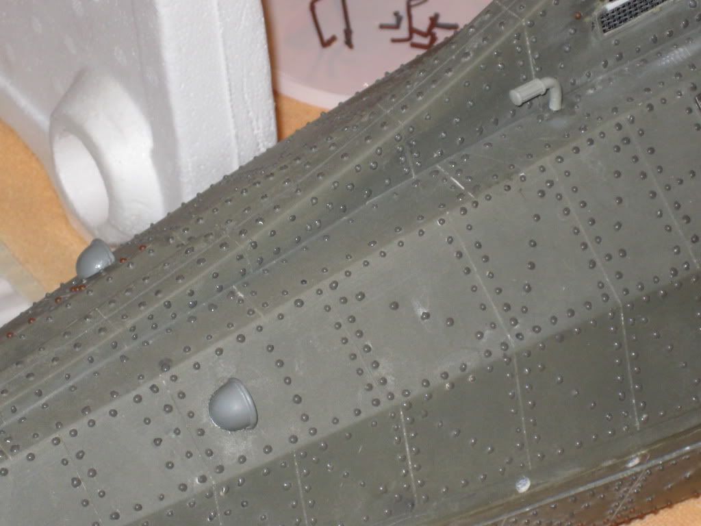

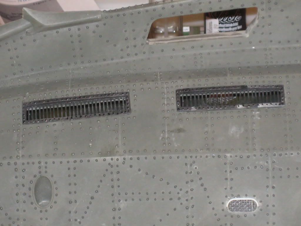

              I've got a Whale of a Tale to tell ya, lads. Yes, that's right, I've temporarily set Harder aside to put a couple of days into my too-long-ignored Custom Replicas Disney Nautilus. It was indeed fun to take a break and work on something different! Here are pix]http://i1143.photobucket.com/albums/n637/jefftytoo/IMG_5204.jpg[/img]

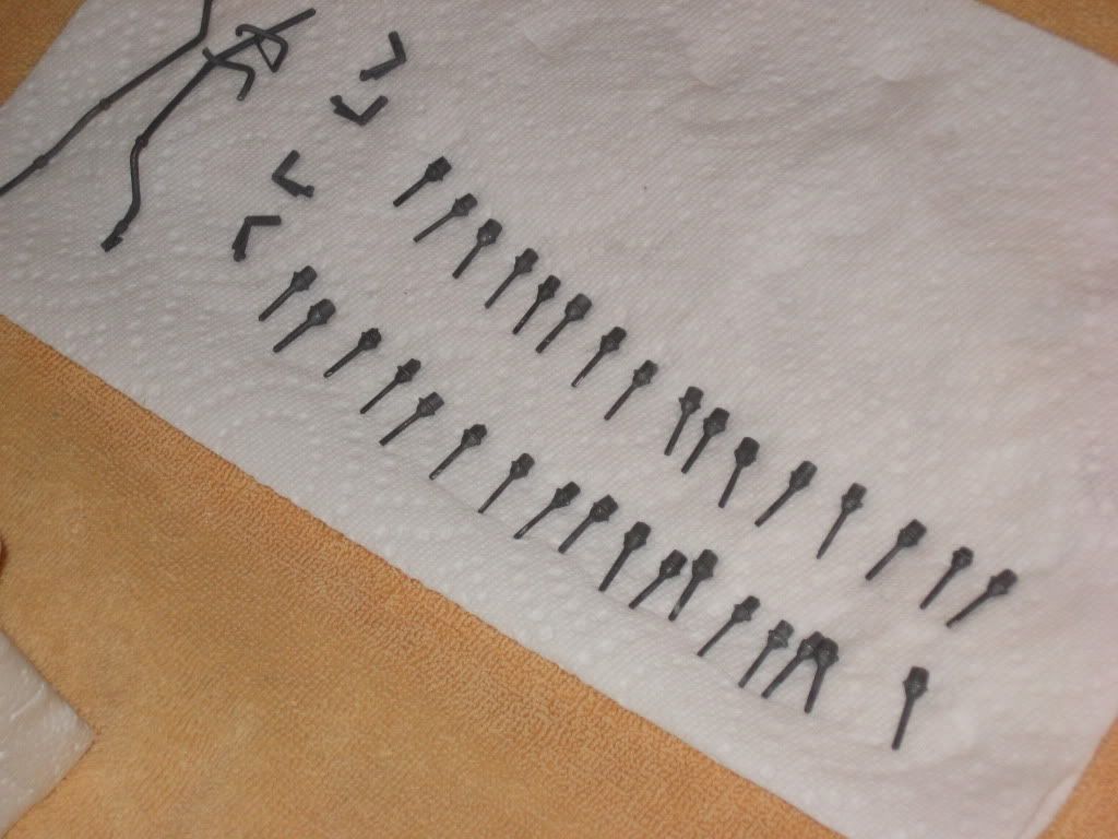

              Likewise for "atomizers".

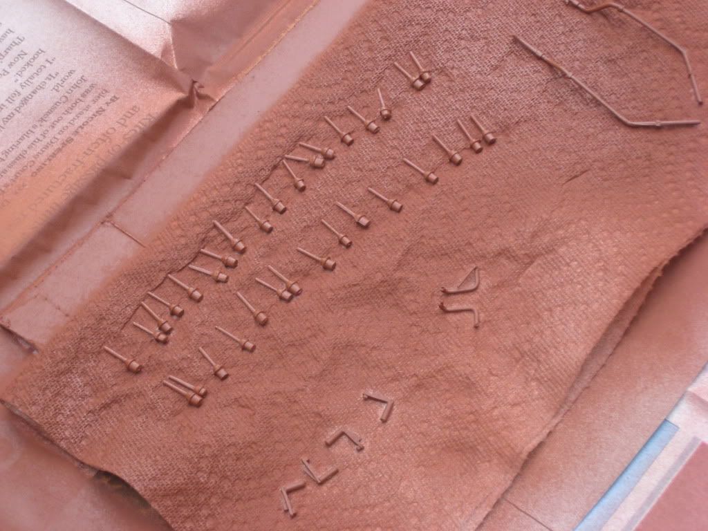

              "Atomizers" get primed on one side—the side that goes toward the hull and thus will be difficult to hit with primer later.
              I have a t-shirt which reads]Voila![/i] And you said no practical good would ever come of my checkered advertising career...

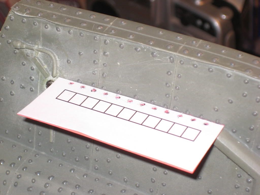

              Making openings on the template.
              Positioning the template.
              Spots are now marked.
              Carefully drilling out.
              Pretty nice 'n' even.
              Working with the Big Girl.
              Grates go in.

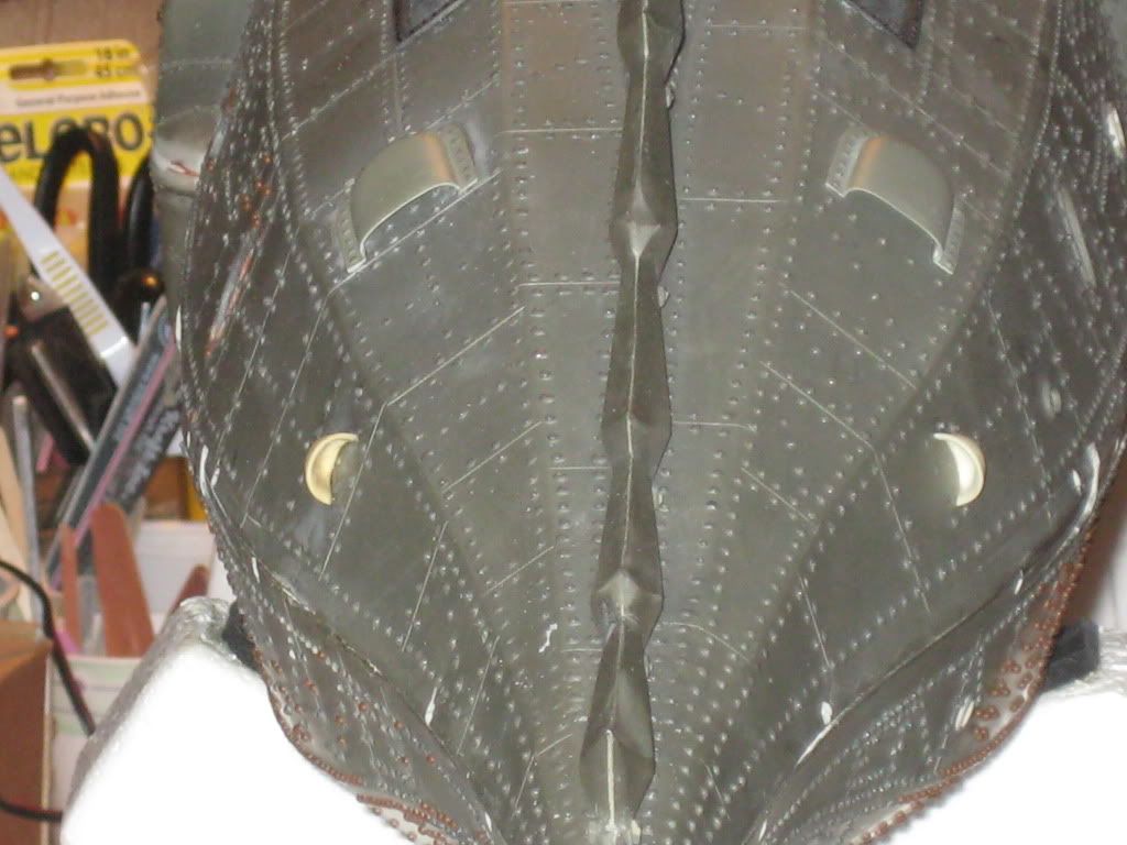

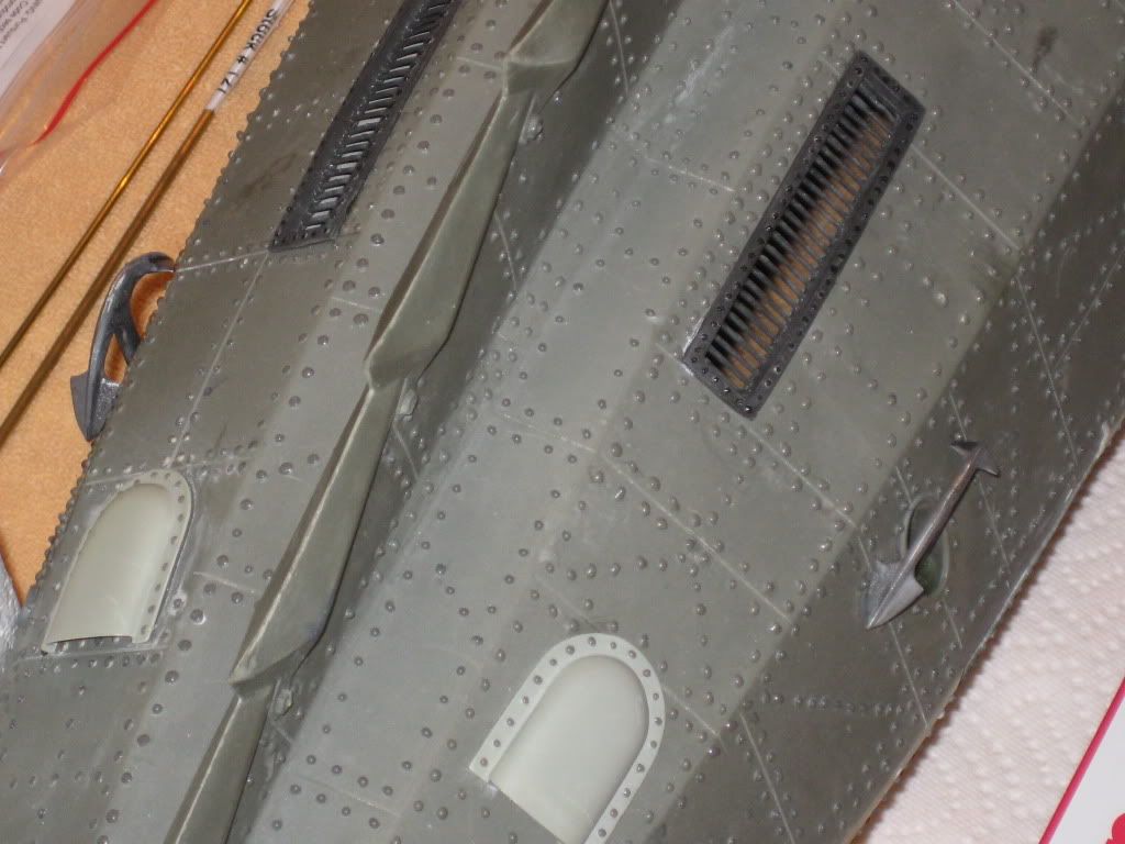

              "Scoops" go on. All these scoops are not just CA'd, but affixed with tiny segments of brass rod too. Don't want them popping off around that 19,000th league.
              Gentlemen, we have "atomizers". Note nice removable part covering the electrical jack seen in previous shots.
              More scoops aft. Plus an aft "vent".
              Other details with the scoops—tethers—if you look closely. Note how the scoops are actually scooped out. A super idea from Paul Crozier.

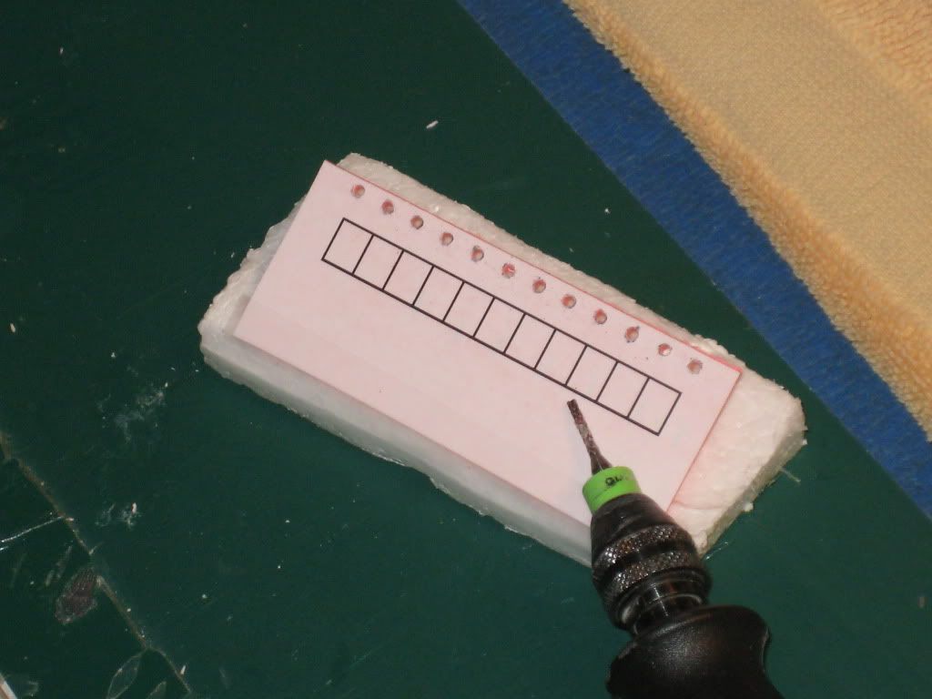

                For the life of me I couldn't figure out how to numerically crunch 2.25 inches into the twelve equidistant spaces I needed to properly position the "atomizers".
                JeffP, I hope you don't mind my providing this...
                Since most of us don't have the nifty layout tool that JeffP uses, here's a quick and easy method that requires no math][/url]
                -JeffL
                p.s. For those who prefer the math: space-between-parts = overall-desired-length / (number-of-spaces - 1)

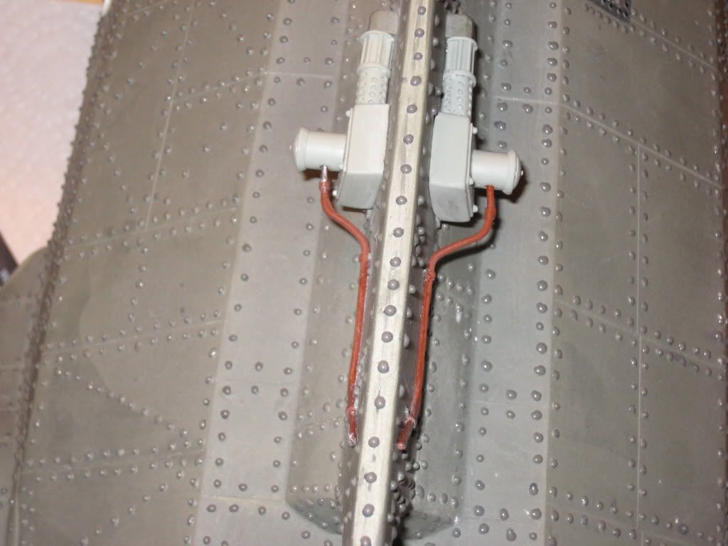

                    Speed screw, pumps and piping installed. Plenty of CA, plus brass pins for the speed screw.
                    JeffP

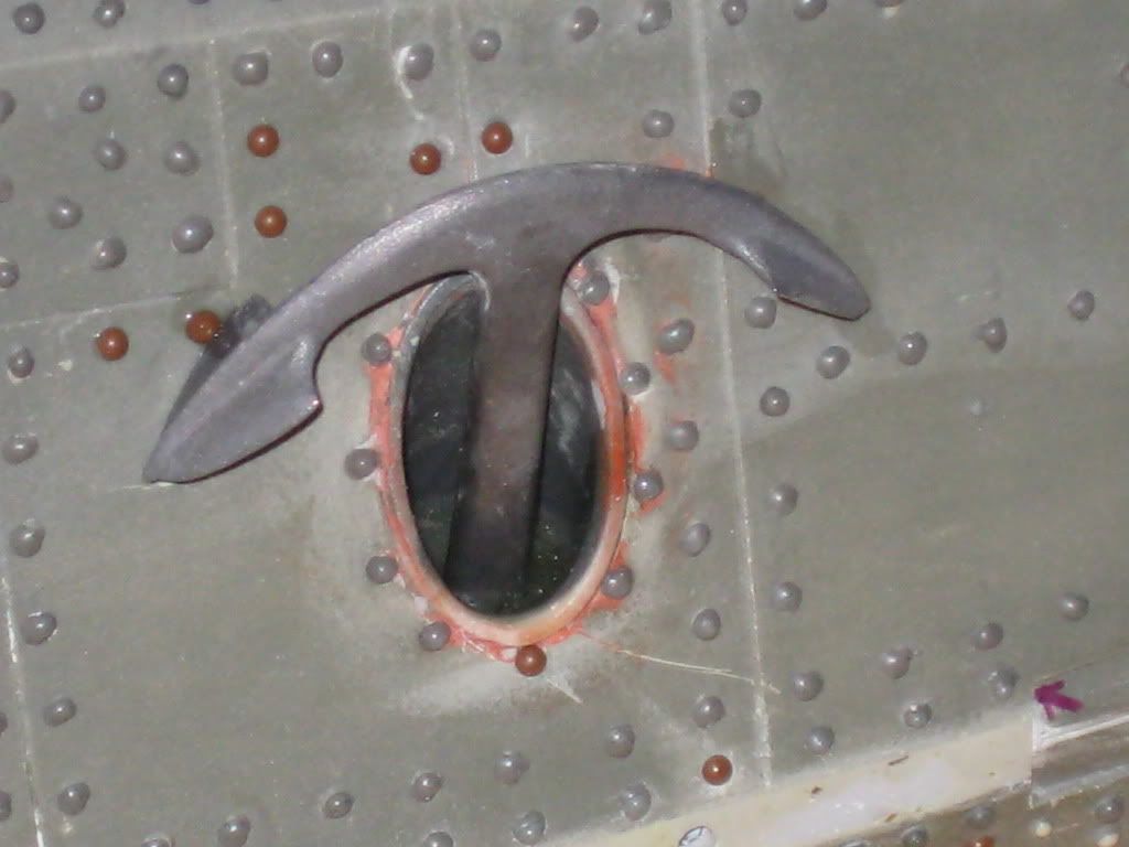

                      Anchors epoxied in:

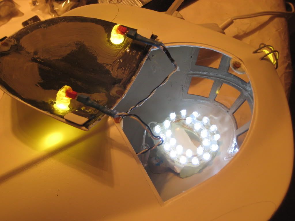

                        For anyone interested, Seaview here undergoes a refit to be ready for her annual appearance at the West Coast Fall Fun Run in San Francisco in a few weeks.

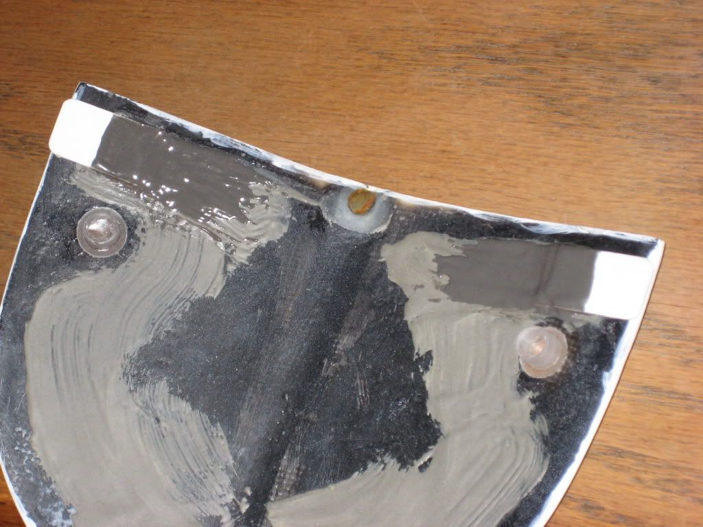

                        I've moved the bow access panel's clip-on tabs a little outboard and JB Welded them on more robustly. These clips will really keep the piece from falling off now. (I tested it!)

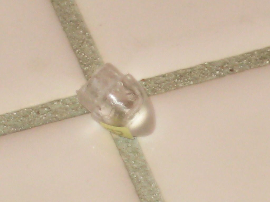

                        This strip of waterproof automotive LED lights has been epoxied together to form a circle (thank you, John Wayne) to concentrate its illumination. It's now a successful replacement for each of my failed earlier Observation Room overhead lighting systems]http://i1143.photobucket.com/albums/n637/jefftytoo/IMG_5684.jpg[/img]

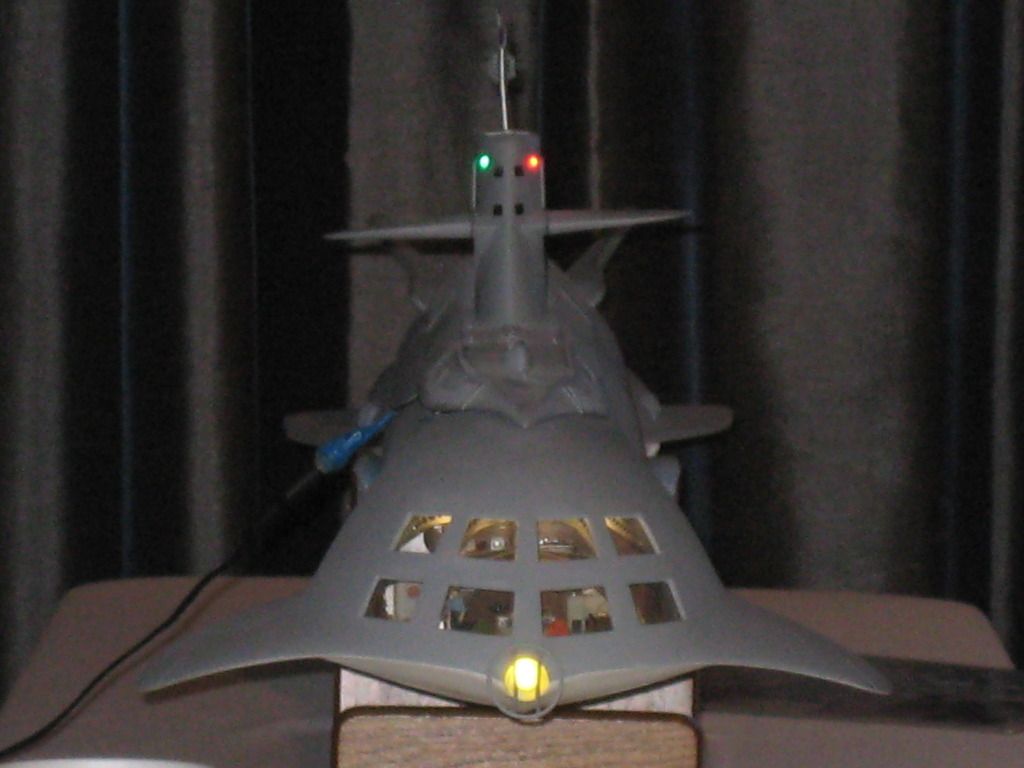

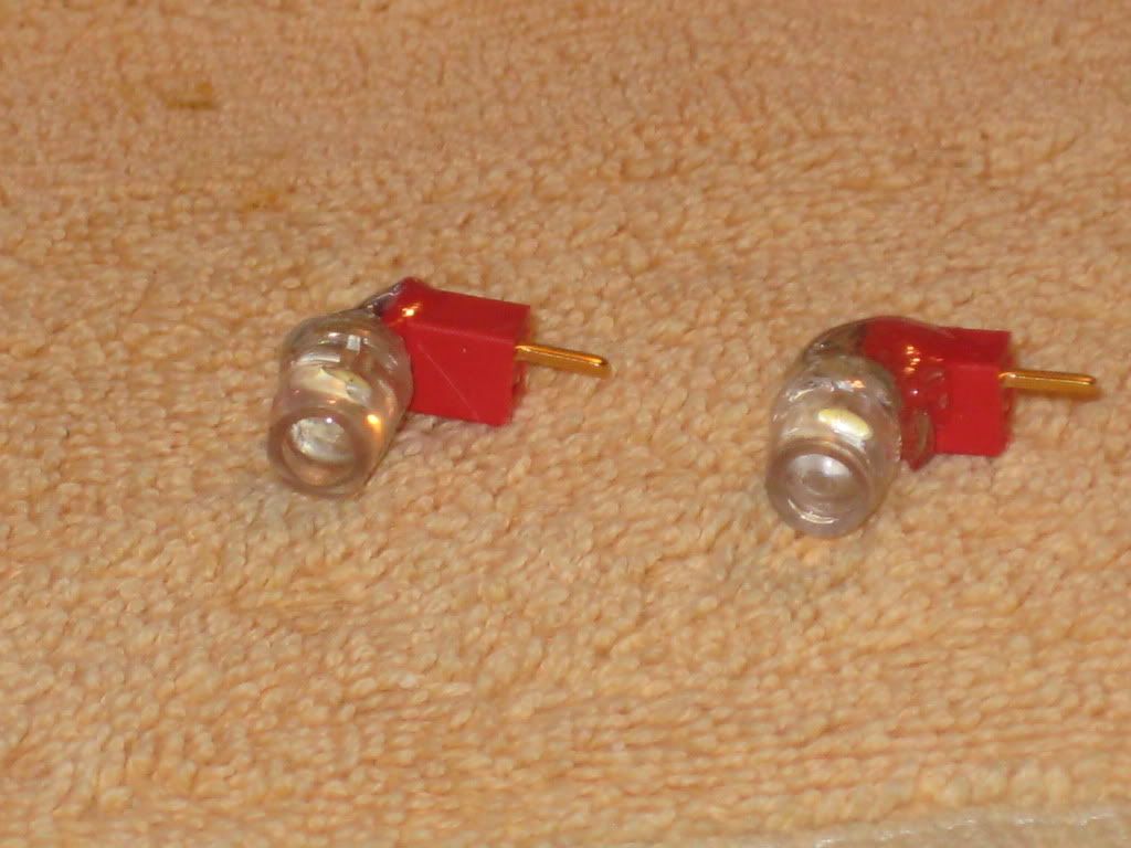

                        The bright "warm white" LEDs used for the twin manta (under keel) lights kept coming out of their friction-fit sockets and/or breaking their wire connections. So here I've soldered the LEDs directly to Dean's mini-connectors, covered their connections with epoxy to waterproof them and, in the shot after this one, hot-glued them into their sockets. They're not coming out of there now! And they're not gonna break either!
                        Voilá—my bow lights are working again!

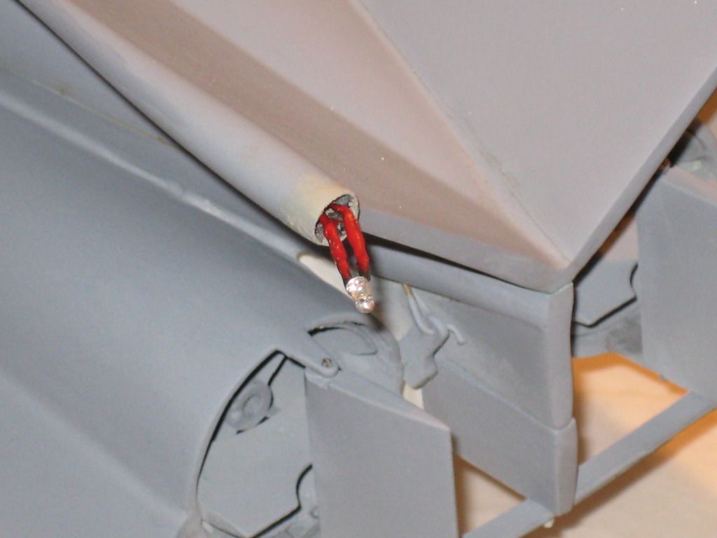

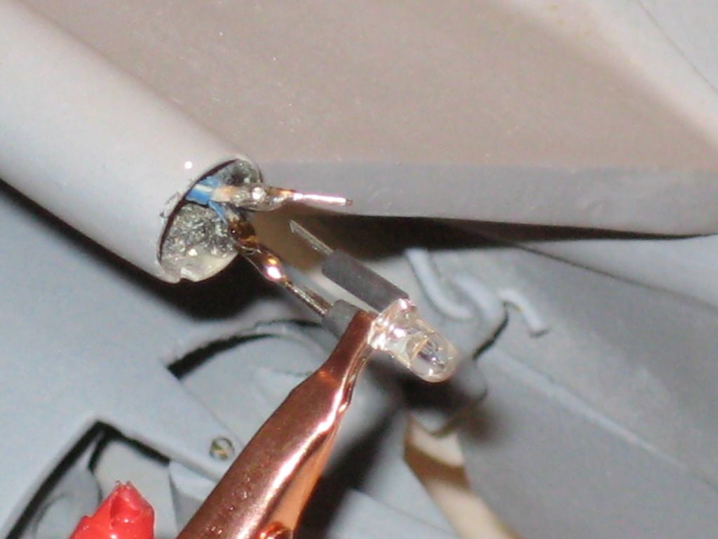

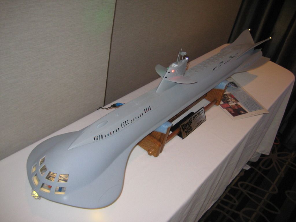

                          I was invited by a new friend to display my Teskey Seaview at a local model show last weekend, but since one of her taillight LEDs had just gone out recently, I knew some fast repair work was in order before putting her in front of any adoring fans...

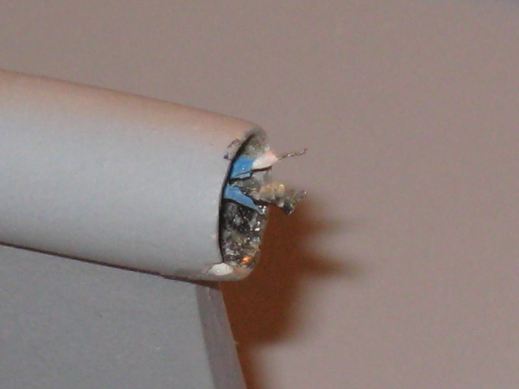

                          Once I'd removed the clear acrylic bullet fairing and pulled out the dead LED, I could see there wasn't much to work with here. (I'd hoped there'd be significant slack in the wiring, but no dice.)
                          Nevertheless, I did manage to get a replacement soldered on...

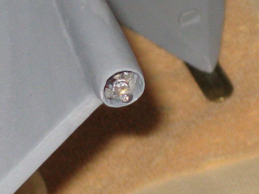

                          A little tool dip works wonders...as does some repair putty.
                          Now in position. (And with some touch-up paint.)

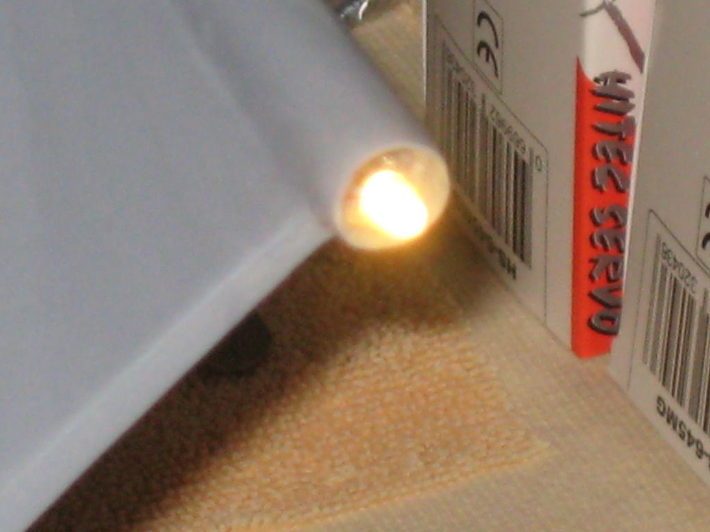

                          Lit up.

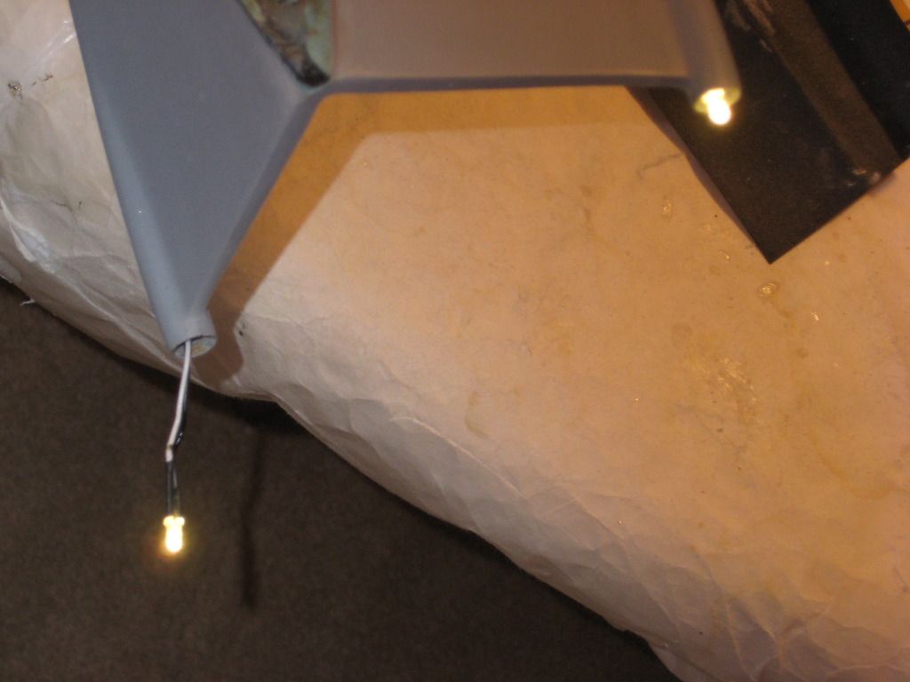

                          Okay, with the port side light now replaced and working, I could see that the cool white LED still functioning on the starboard fin was now mismatched with the new warm white version to port. So now it too had to be replaced, and it was MUCH less cooperative, necessitating taking the boat all apart and feeding all new wiring through the caddie fin, which took several difficult, frustrating attempts. In this shot, the new wire is shown finally in place.
                          Now we're talkin'!
                          Over the years my custom-shaped acrylic light fairings had acquired a spidery network of cracks inside. Acrylic adhesive applied to the cracks did help some of them to disappear. Not the total cure I'd hoped for, but at least an improvement.
                          And here she is at a Southern California model show last weekend, all lit up again...
