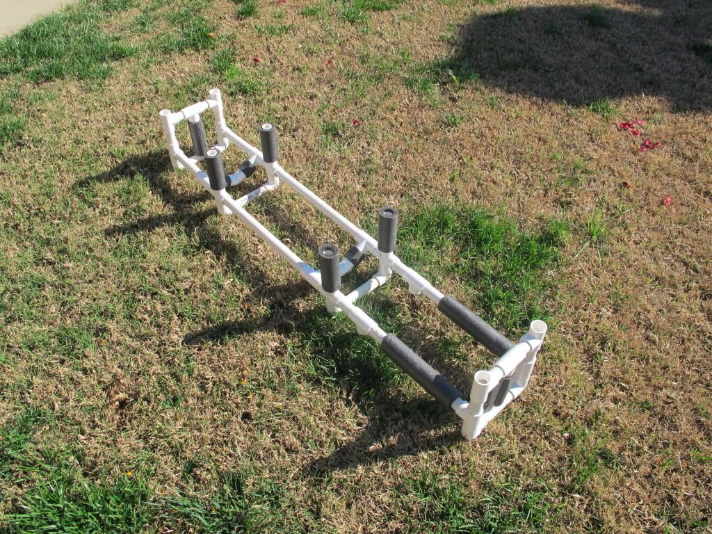

                  Meanwhile, a number of tweaks, fixes and assorted adjustments are now required, post-run, to get Seaview fully back in fighting trim. All will eventually be covered here, but for now, just one of those required projects is to improve my method for transporting her in the car. My thrown-together padding system surrounding the boat while she slid around in her styrofoam stand just wasn't cutting it, I found, during the long trip to SanFran from L.A., and something had to be done about this. Cut to a couple of weekends ago, when I was inspired by the sight of the wonderfully robust PVC pipe rig Will Oudmayer had engineered for road-tripping with his big, heavy boats (observed during a visit to his magical garage workshop to discuss eventual further work on my 66" Disney Nautilus—another story for another time). Here's a shot of Will's nice travel cradle, sent to me to help with the design and build of my own customized version for Seaview]

                  And the build progresses to completion, all in a single afternoon and evening]http://i1143.photobucket.com/albums/n637/jefftytoo/IMG_4779.jpg[/img]
                  And here's the boat all snug as a bug in a rug.]http://i1143.photobucket.com/albums/n637/jefftytoo/IMG_4781.jpg[/img]
                  Topside]http://i1143.photobucket.com/albums/n637/jefftytoo/IMG_4786.jpg[/img]
                  Starboard bow]http://i1143.photobucket.com/albums/n637/jefftytoo/IMG_4784.jpg[/img]
                  Closeups, fore and aft]Seaview
                  's delicate searchlight cage with twin foam rollers at the front of the cradle. Really happy with how that turned out.
                  All that's required to finish the project is to permanently glue the joints not intended to be flexible; oh, and the foam half-rollers need to be glued down as well. Couldn't do any of that today because that special PVC glue is far too nasty to use inside the house. Hope to complete things next weekend, then I'm back on my Harder build.
                  Thanks for reading!
                  JeffP

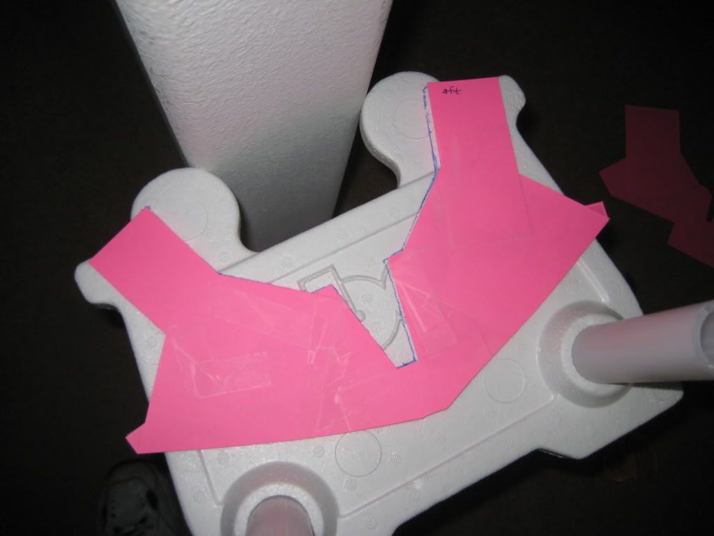

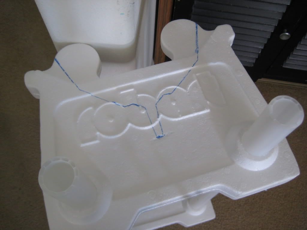

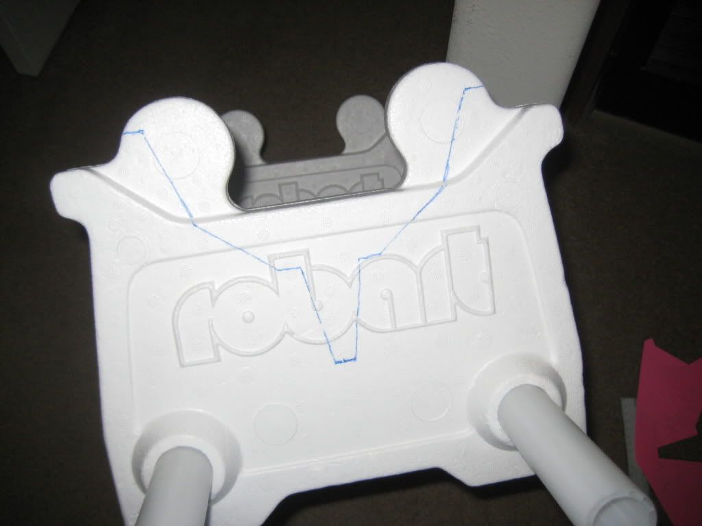

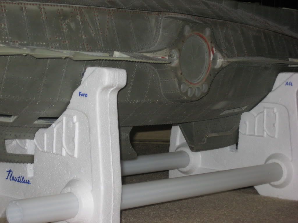

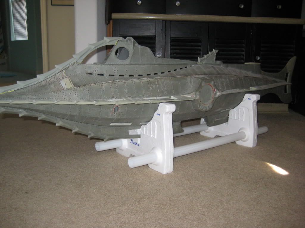

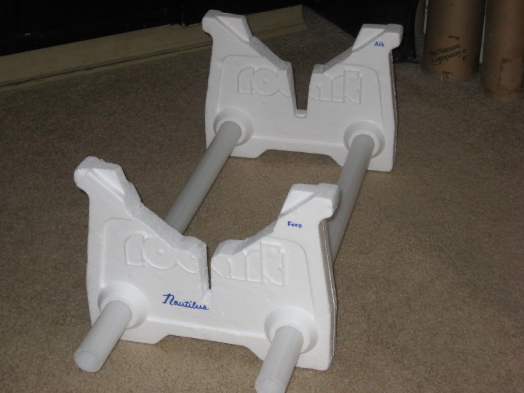

                              Some of you know that despite the fact I'm supposed to be working on my USS Harder Revell conversion for our "Ghosts' Glory" wolfpack, surprisingly my long-neglected 66" Custom Replicas Disney Nautilus has jumped back to the shipyard forefront! This is because Will Oudmayer and Neil Schmidt are once again excited about tackling the engineering aspects of the build, and who am I to throw water on those guys? E-mails are flying and all manner of electronic parts are suddenly being ordered from Germany, England, even Malaysia… There'll be much more to report on all this in the weeks and months to come. But for now I thought I'd share that when transporting the hull (such as it is) to Will's a few weeks back so he could take some critical measurements, she nearly tipped over in the car because she sits so high in the Robart styrofoam boat stand I use to haul her around. Disaster was thankfully averted, but I realized then I was due to cut down said stand to substantially lower the duo's center of gravity and thus avoid any future tipping incidents. Before any more time could pass, I elected to take on this minor project this weekend. Here's how I handled it]http://i1143.photobucket.com/albums/n637/jefftytoo/IMG_4858.jpg[/img]
                              Using the template, you can see how easy it was for me to now draw the boat's hull contour on the stand for removal.
                              This one's for the contour about 2/3rd's aft.
                              And this one with the skinnier protrusion is to fit the lower rakers forward.

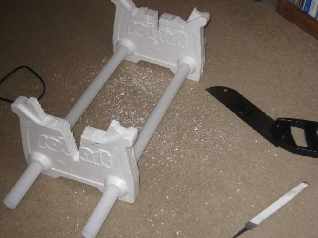

                              The cutting and filing and sanding begins. (Yes, a vacuum cleaner was later involved!)

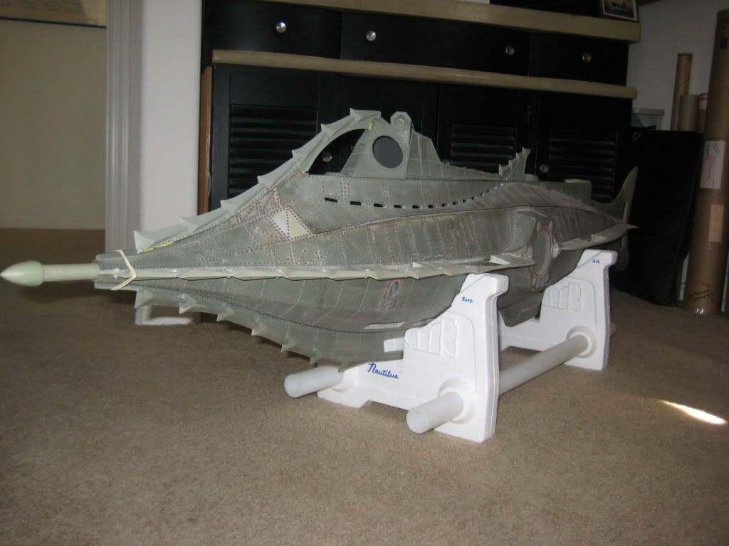

                              And here's the finished product.
                              Voila! A snug fit low in the stand. But not so low it'll threaten to split apart under the strain. (This is going to be one heavy boat.)
                              Yup, she's a purty beast even at this early stage of development.

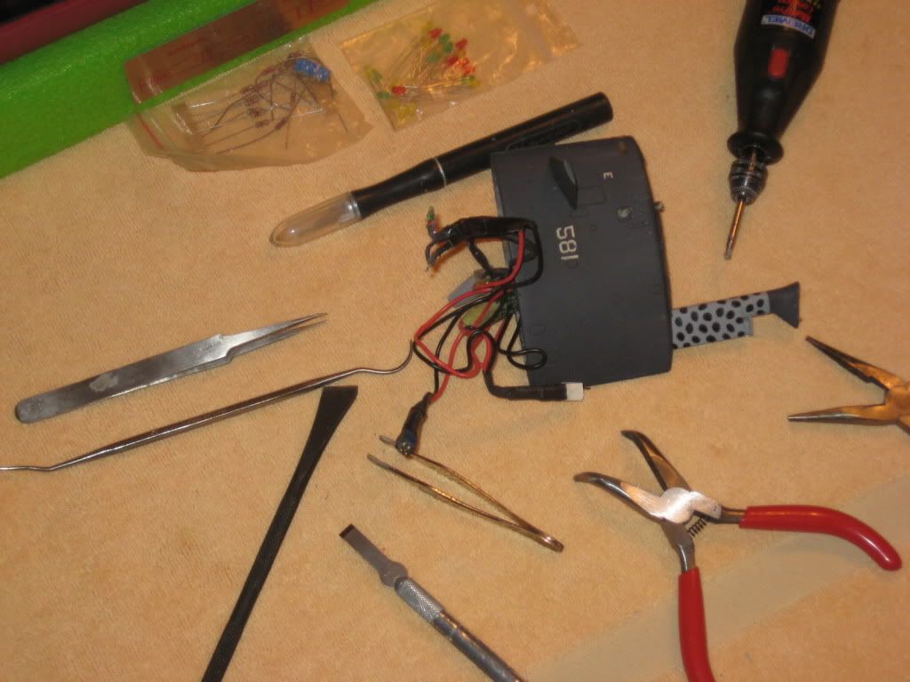

                                Oh, yeah: I also started in on re-wiring Blueback's sail.
                                Again.
                                *sigh*
                                (What a hassle.)
