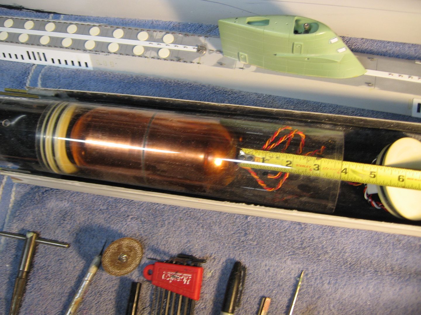

                        Just to be clear, you're saying a bulkhead can be moved to allow room for the lighting board and maybe the sound contraption too? This would be a big relief, especially to my local buddy Neil S., who's in the throes of figuring out a separate module. Would really be great if he didn't have to...

                          #87
                          Since I'm the one crammed for space, and if I'm reading and seeing things right, the pressure vessel (it's the copper colored tank, Jeff!!) can be pushed aft in it's compartment, looks like at least an inch or so. That will create more space in the very front, hopefully 3 inches plus, which should give us room to pack full of electronics. I've got the sound board conglomeration down to about 2.5", so an extra inch would be enough for receiver and possibly the light board.
                          If Steve could be so kind (at his leisure) to pop off the end cap, give the pressure vessel a gentle push aft, and give us a new measurement, hopefully that will give me some breathing room.

                            BTW-You are correct Neil. The copper tank is just a slip fit in the Lexan. Plus the front end cap is hollowed out for more room as well. BD.

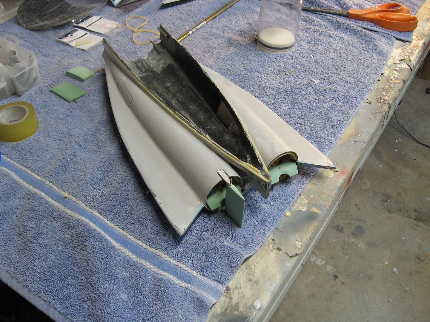

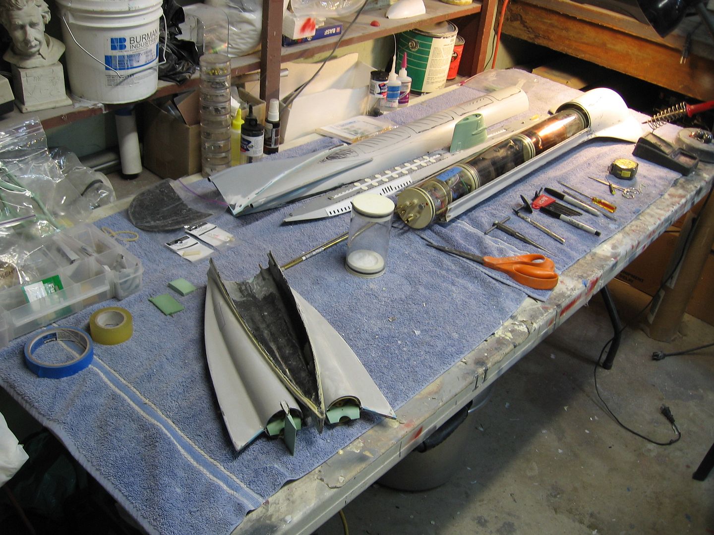

                              Started work today on Jeff’s Seaview. First up let’s get those Tesky tail feathers installed. I should finish this up tomorrow morning and move on to installing the WTC to the aft stern section allow it to be pre-connected to the dive plane, rudders and two long dog bones.
                              The fit of the planes is very nice and gave me little trouble. But with the nacelles already part of the hull it was a bit of a ship in a bottle to figure out. Hog out a bunch of ugly holes and then fill them in. It was the only way.

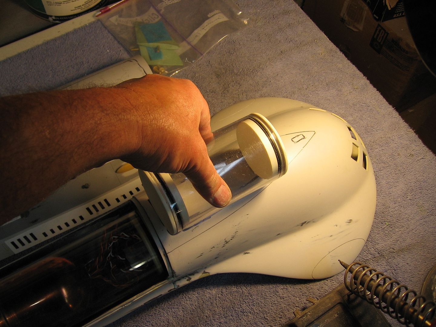

                              I had some various BigDave cylinder components and cut one up to fit in the bow. This will allow for additional water tight space for the battery and lights, maybe sound. Neil you can now see how much room you have to work with. If we have servo control of the board it will have to go in the forward compartment of the WTC.
                              Pump Jets are installed in the designed positions.
