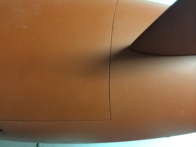

              Still trying to work out the electrical glitching.....For now, I'm working on the hull seam.
              D
                #37
                Re: OTW NACKEN BUILD HMS Neptun
                what seam?
                that looks damn near perfect!
                  • 945
                  I'd say it IS perfect—at least that corner. Wow.
                  JeffP
                    • 2352
                    #39
                    Unacceptable seam. I think you should keep at it until a scanning electron microscope is the only way you can identify it. LOL You have done an amazing job on this sub.
