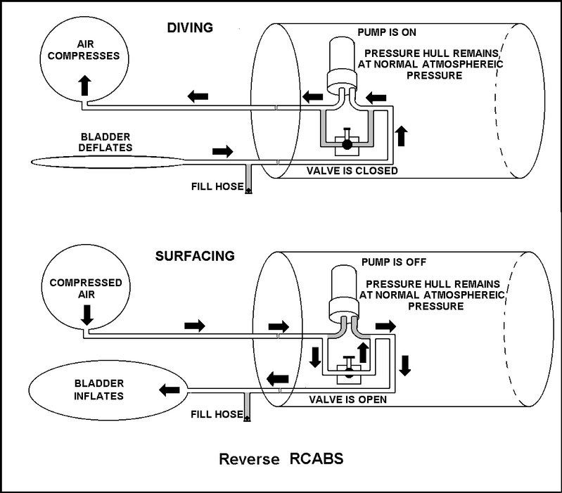

                            Dang it. I know there
                            Dang it. I know there was a schematic diagram of the RCABS-R system somewhere, but I can't find the darned thing. Can anyone point me towards it?
                            I am going to try a 4" custom version of it for that 1/48 Gato hull that has been languishing in my garage for too many years.
                            Tim

                              #59
                              This one, Tim?
                              http://i119.photobucket.com/albums/o130/Crazylvan/Fig2ReverseRCABS.jpg
                              Its from my
                              This one, Tim?
                              Its from my article in SCR Issue 69.

                                #60
                                Perfect! Thanks Geo.
                                T
