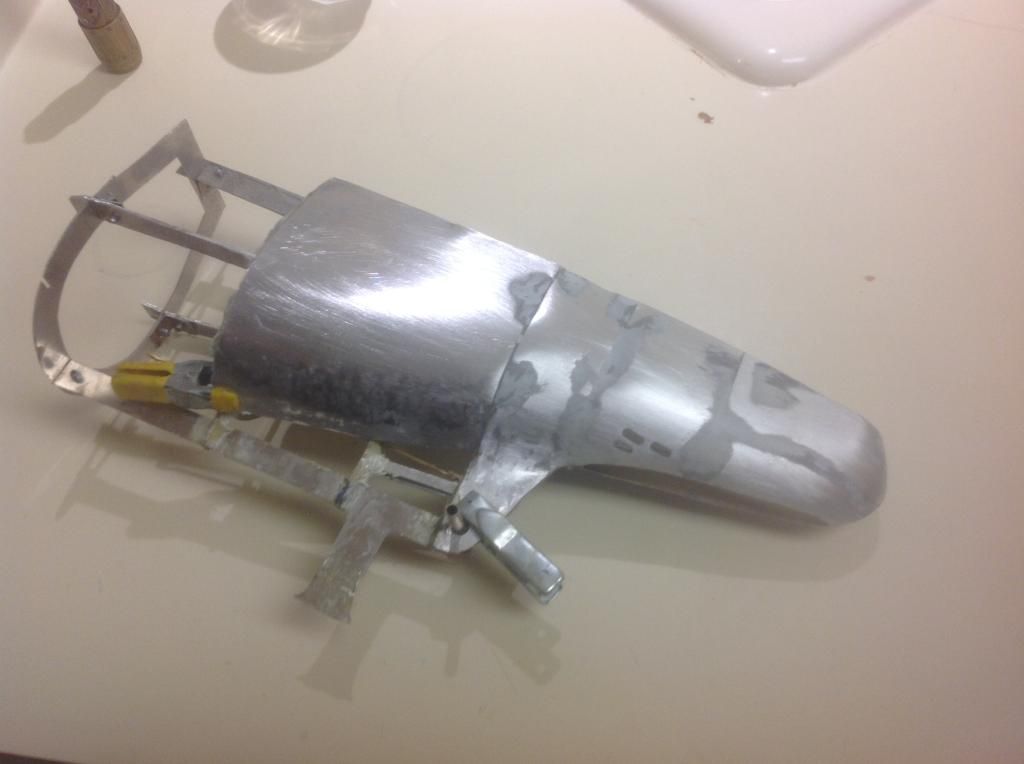

        Re: Gwen's all metal scratch built 1/32 Type VIIc

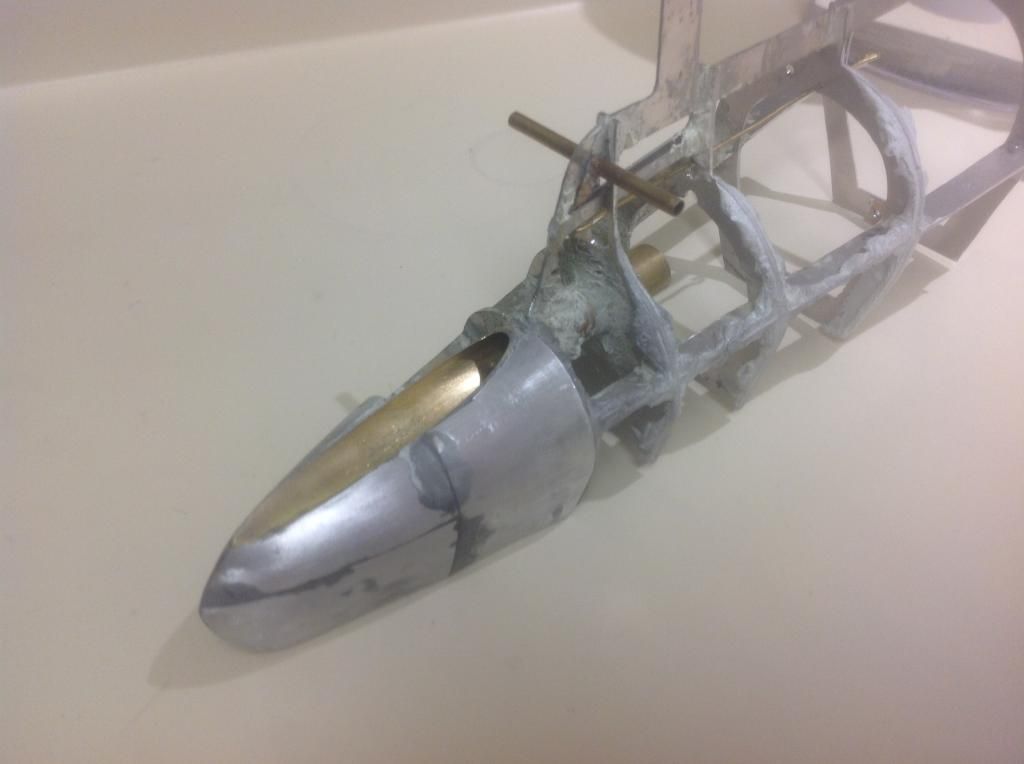

        Today's progress...
          What material are you using to bond the skin to the frames, and to smooth out the seams? Is that a polyester resin?
          • gwen
            • Dec 2014
            • 42
            #50
            It's PC-11 Marine epoxy.

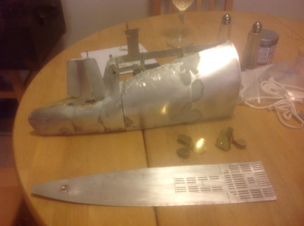

              Today's progress...

                Today's update...

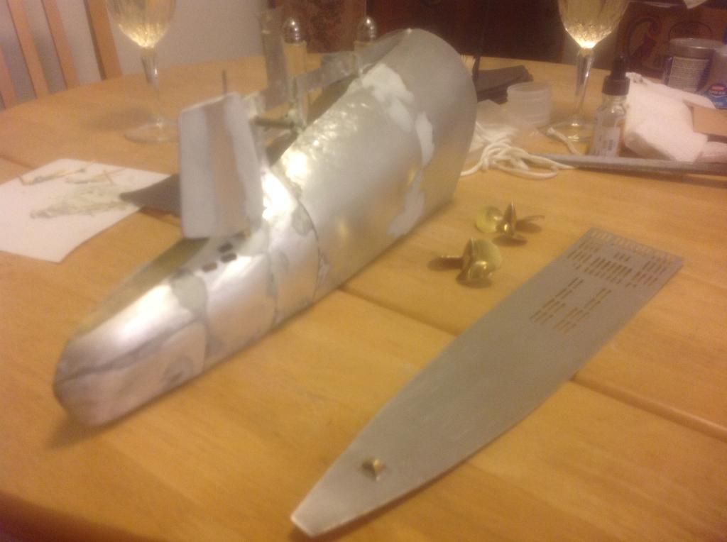

                              #59

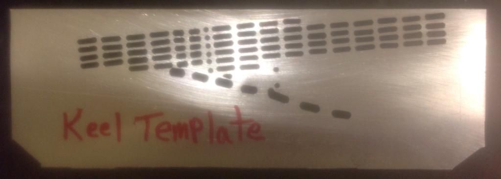

                              OK, after numerous hours of drilling, sawing, and filing I have a template for cutting the keel hull parts.
                              Jeff, does this look close to your reference material?
                              Oh, it's upside down as I'm sure you'll realize...
                              • gwen
                                • Dec 2014
                                • 42
                                #60

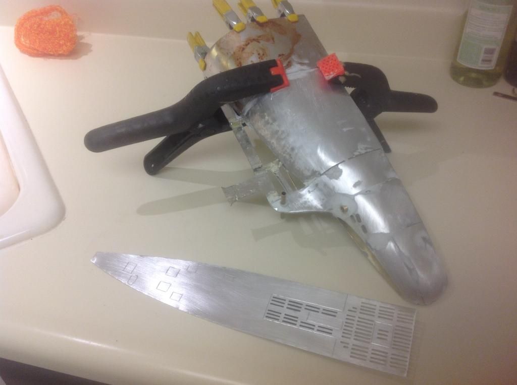

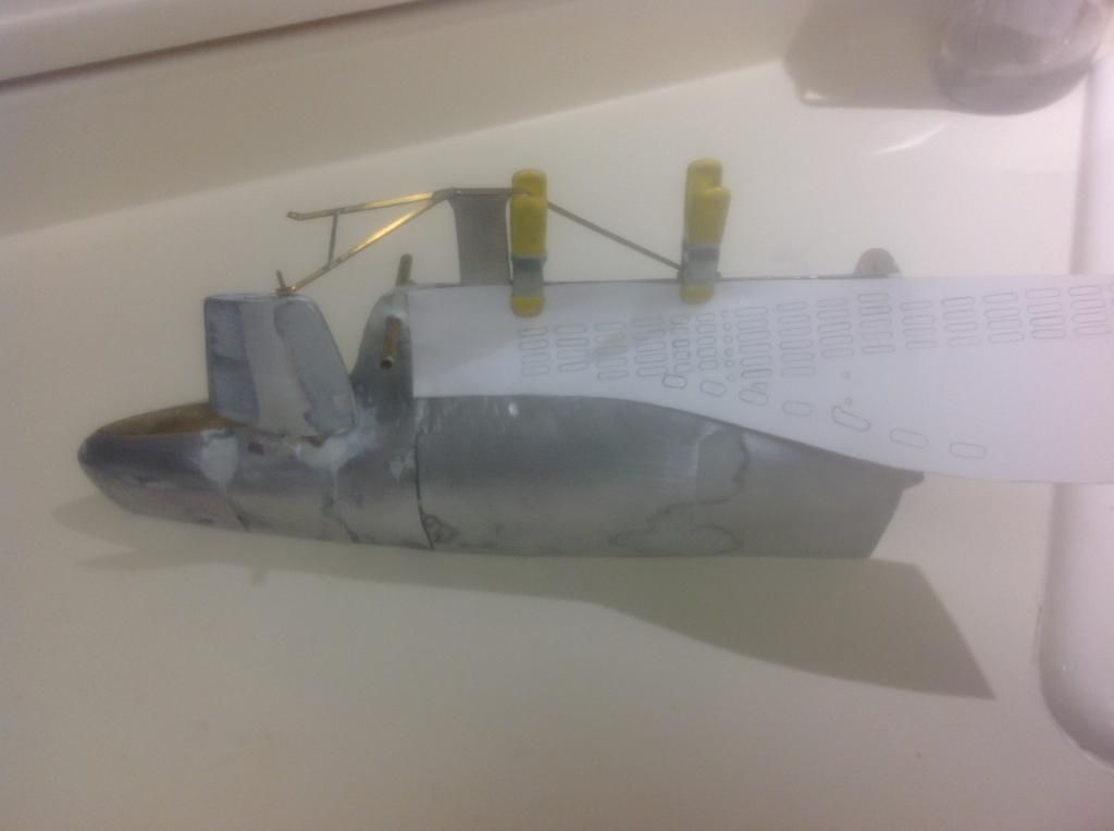

                                Here's a rough test fit...
