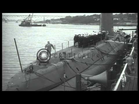

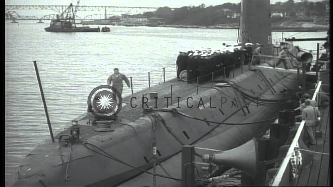

                        Aft hatch is installed backwards. All US submarine escape trunk hatches opened forward. Balancing spring should be facing forward.
                          #177
                          I looked for image of rear hatch.
                          Found it in a 1:39 minutes original commissioning film.
                          The open rear hatch can be seen at 1:00 minute mark and even closer at the 1:37 mark.... be ready to hit pause.

                            Thanks for the reminder....actually I knew this and I have the hatch position correct in my CAD drawings. I just glued it the wrong way around. Fixed it today
