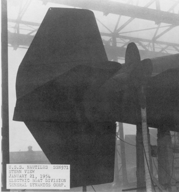

                    The stern is also a tough one, mostly because I'm aware of about three versions. Seems like it got modified it allot of times.

                      Re: New project
                      It was modified a bit, but not nearly as significant as the sail and lower bow. Those went through significant transformation.
                      • drschmidt
                        • Jul 2014
                        • 424
                        Re: New project
                        They changed the bow as well? I'm aware of several changes of the propellers and the original Nautilus had two stern torpedo tubes. I've seen photos of later versions where the tubes were gone and the whole stern section got a streamlined cover.
                        • drschmidt
                          • Jul 2014
                          • 424
                          Re: New project
                          As built with Torpedo tubes......
                          With steramlined cover]http://www.frontiernet.net/~geprot/nautilus%20b.jpg[/img]
                            Re: New project
                            I thought it was the other way 'round....she was built without stern tubes and the tubes were an addition later on?
                            • drschmidt
                              • Jul 2014
                              • 424
                              Re: New project
                              I was told that the photo with the tubes is a skate class boat......
