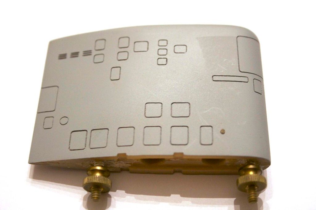

                        Spring always been among my favorites ...... so with the arrival of the first warm days and especially sunny days - I am addicted / dependent for the sunlight like plants - I started working on submarine and see that I have some spore. .... this is what I managed to do today ,
                        Today I gave holes, I gave threads, I filed, I sanded, cut and that's what came out :
                        MARIUS
