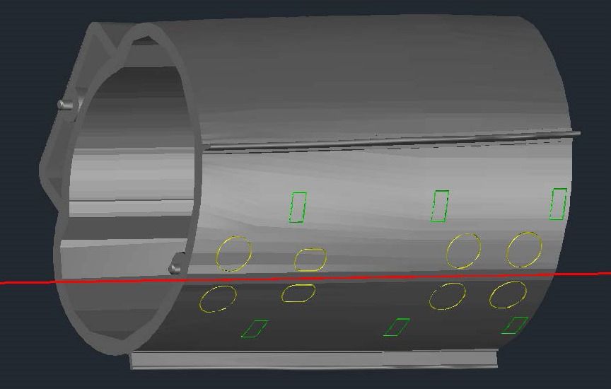

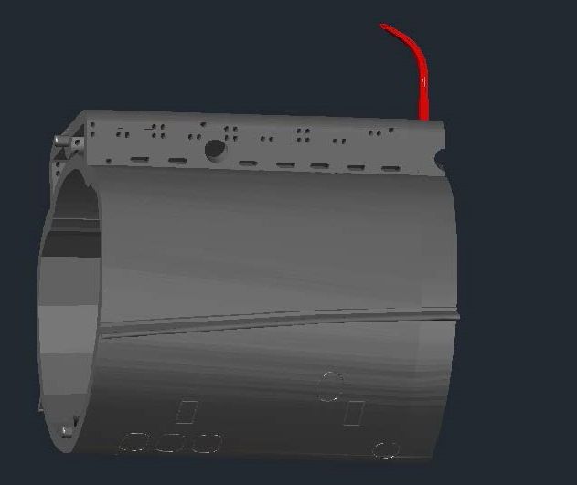

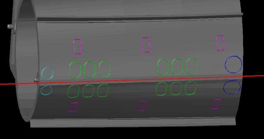

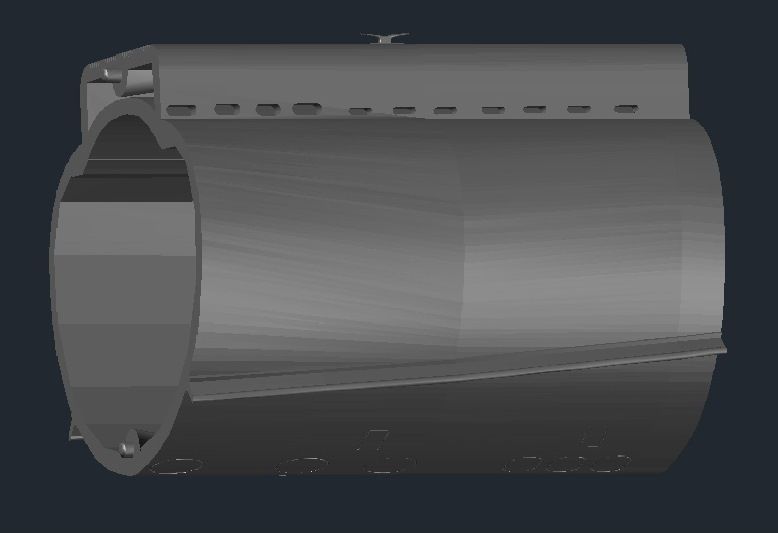

                    While waiting for paint and Future to dry on my diversion, I also made some progress towards completing Batfish. The image below shows Part04 with the projected lines of the bottom Kingston’s clearly seen.

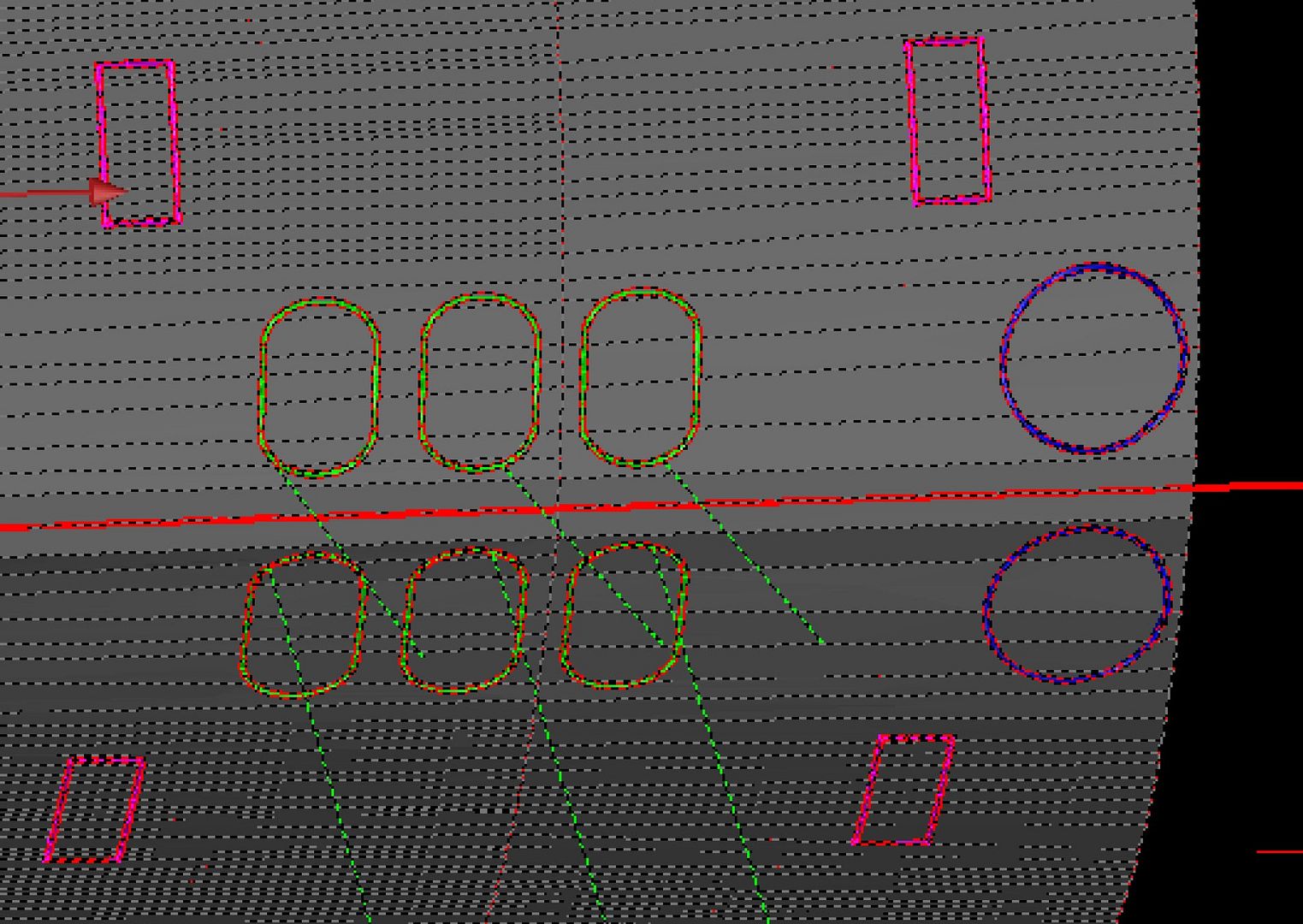

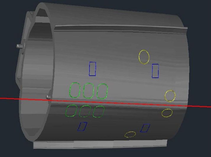

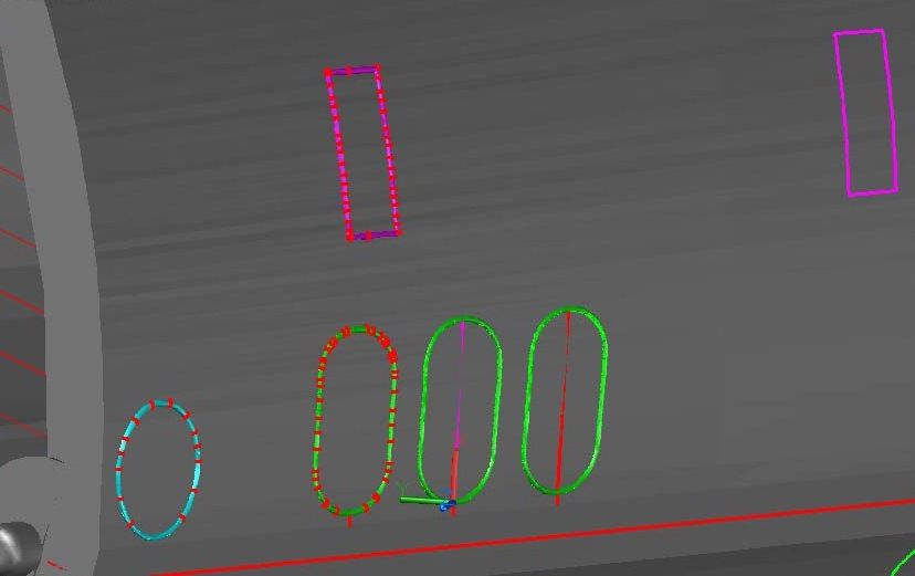

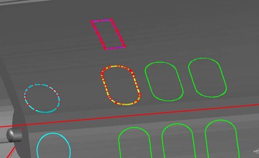

                    I did the small circle, rectangle and first oval as described before. SA you can see in the image below, there were a lot of segments, so it took quite some time to do.
                    I wasn’t looking forward to having to do each of the ovals individually, so I thought I would try copying the one I made to the position for the next one.
                    After I copied it, I had to rotate the top out a bit, but then it worked like a charm.

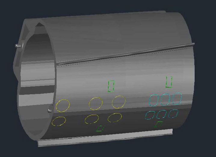

                    I did the same thing for the remaining ovals and rectangles.

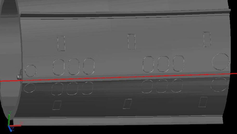

                    Once again, symmetry was my friend, and I mirrored the solid shapes to the other side…

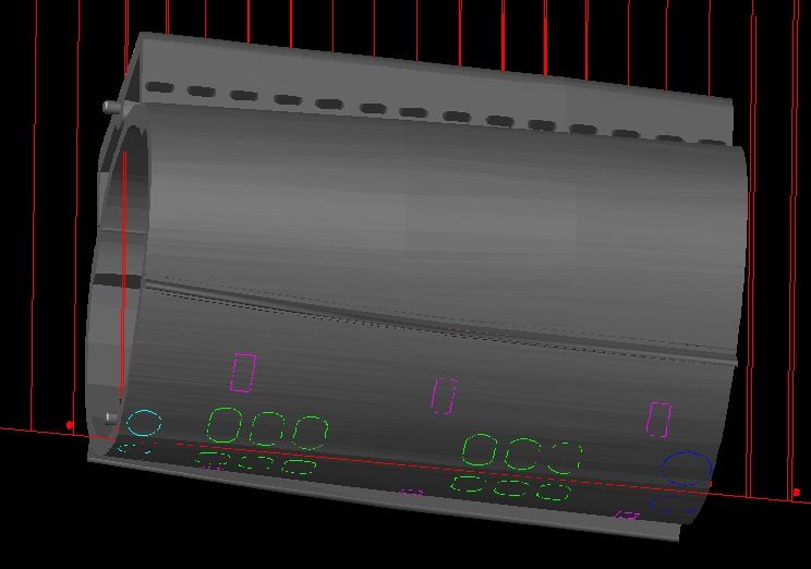

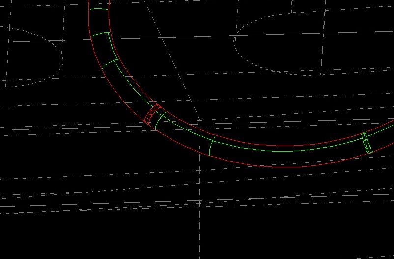

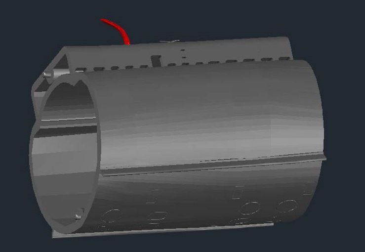

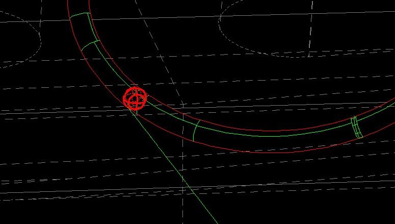

                    …And subtracted them from the part. Sometimes, and I’m not sure that I know why, something doesn’t work quite right and you end up with stray lines shooting into space as seen below.
                    These strays always occur at a node where two segments meet. To get rid of them I draw a sphere with a radius of 0.0041” at the node…
                    …And subtract it. That usually gets rid of the stray line. If not I try a 0.0042” radius sphere and that works. The printer won’t see the difference and the drawing looks neater.

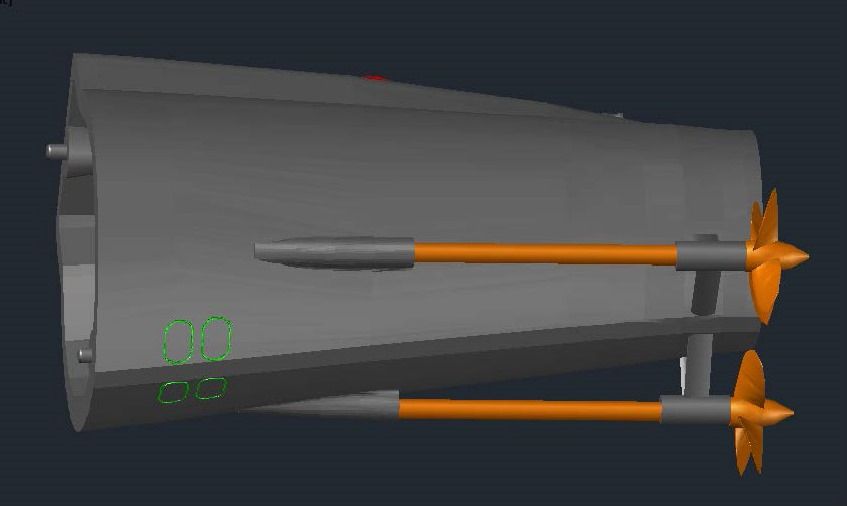

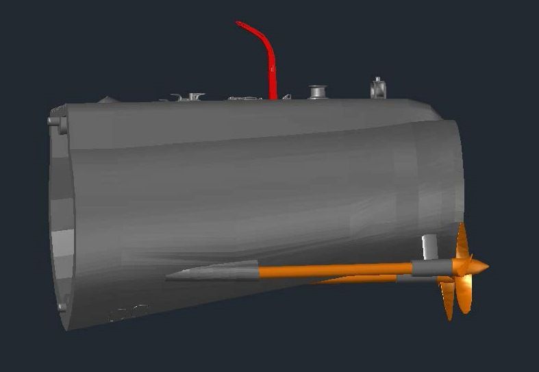

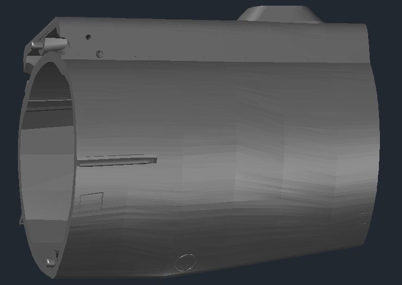

                    The following two images show the completed part.

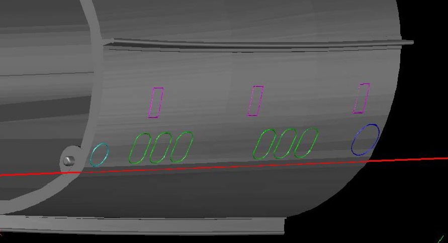

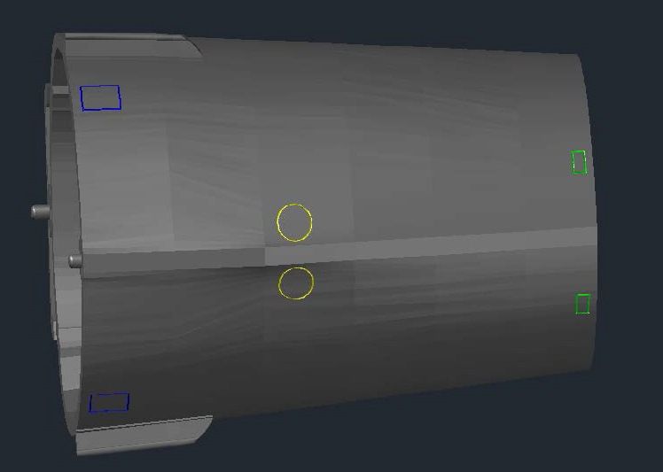

                            The only thing I had left to do was add the Bottom Kingstons to Parts05-09. It involved a lot more of what I already showed, so I don’t show all of the steps. Suffice it to say that there were like a bazillion segments.
                            Here is Part05 from underneath…
                            …And from the side, after I recolored it.
                            Here is Part06 from underneath…
                            Here is Part07 from underneath…
                            Here is Part08 from underneath…
                            Finally, here is Part09 from underneath…
