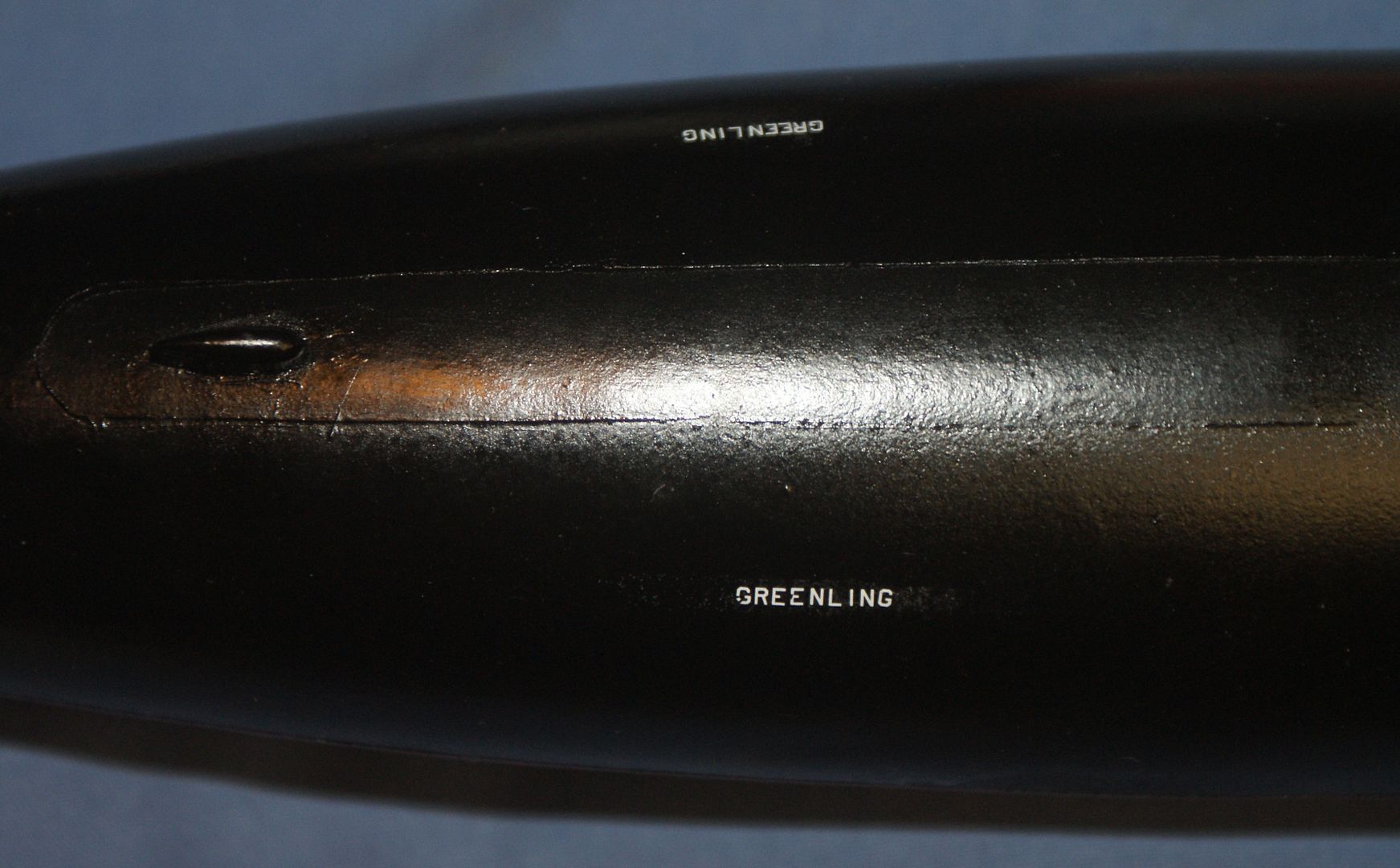

        UPDATE 72
        Well, I’m still bummin’ about putting the sail numbers on in the wrong spot.
        My buddy said that he noticed it too, that when he first got on the ship they were painted on, but were very soon removed, due to snooping Russian fishing trawlers. He said that they then hung them under the sail. I wish I would have thought to ask him. If I could take them off and redo them, I would, but I guess, such is life. Also, it looks like I will be ordering another package of letter decals.
        I put them on using the reverse tape method.
        The port side came out pretty good.
        The Starboard side didn’t come out quite so good. The “ING” is all out of alignment.
        I was thinking that I could just remove it and replace it, but if you look in the photos, I neglected to align the two sides properly, blindly worrying only about getting them in the correct vertical location. DOH!
        This means that I have to redo it and I only have one G left.
        I could just remove the “REENLING” and they would be pretty closely aligned, and I wouldn’t have to buy a whole package for one friggin’ G. But I don’t know. We’ll see.

          UPDATE 73
          After my last post I realized that I didn’t have anything to lose by just trying to add the “REENLING”, and I could use the practice, so that’s what I did, letter by letter this time. As you can see below, the application went so-so. The letters were in good alignment, but the G didn’t go on so well. I think it was scratched to begin with.
          …And it still isn’t quite level with the port side letters.
          So, another set of decals it is.
          Rats!

                I think that part of the problem you are encountering may be that parts of the lettering stick better to the tape you are using for alignment than they do when you burnish the letters onto the hull.
                For overall alignment of groups of letters. one trick is to get some rubber bands with flat sides, carefully slide them over the circumference of the model and adjust them (eyeball & measurements) so that your two sides have a temporary "alignment grid" to place the letters at the same horizontal location on both sides of the hull, so that the beginning and end of "Greenling" are not staggered.
                And I'm still bummin' about the sail numbers.
                We know how this is going to end. You will agonize for a while, and then fix it. The important point will be to have a strategy to fix it with minimal effort and damage.

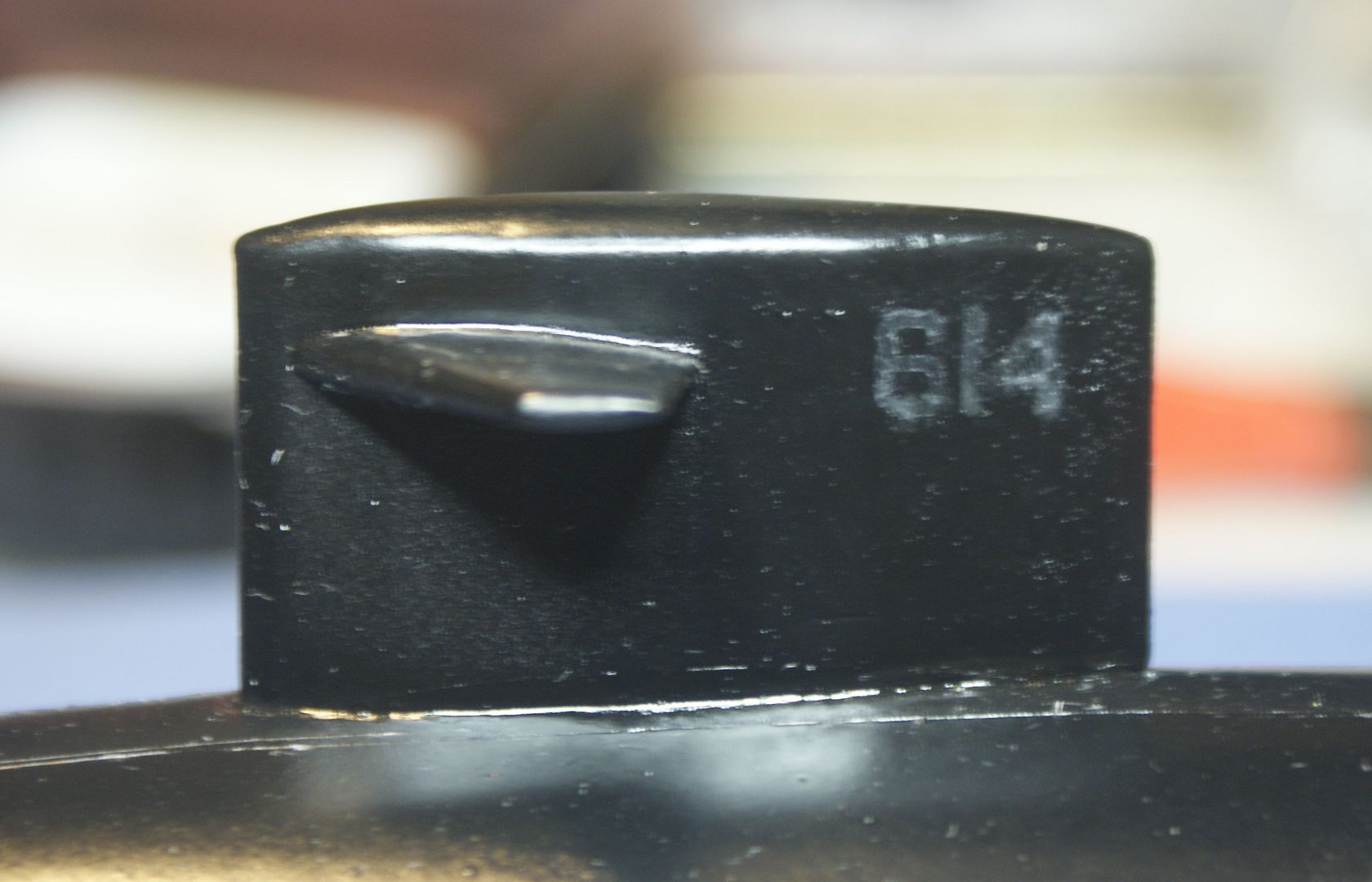

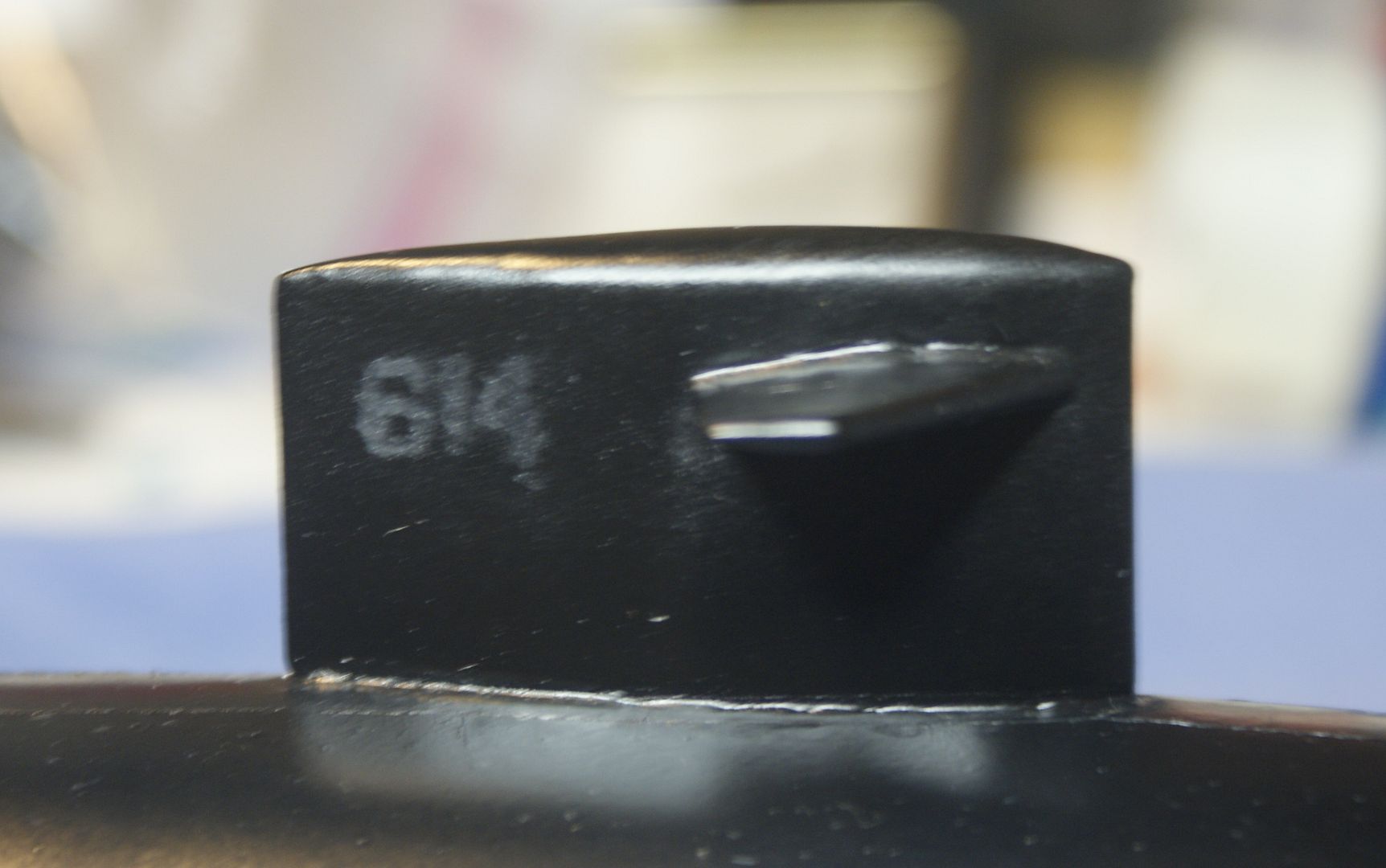

                              Well, I redid the sail number decals to get them (more or less) in the correct spot. I stuck with the tape method, but modified it a bit. Instead of using glass from a picture frame, I used clear plastic from a blueberry container. I think the thickness of the glass made it difficult to keep my reference line in the same place as it was dependent on my viewing angle. The thinner plastic should eliminate (or at least reduce) this effect. I also taped a piece of 10 sections to the inch graph paper to the underside.
                              The image below shows the first number secured upside down to the scotch tape, which was secured to the clear plastic piece with masking tape. The graph paper definitely helped.
                              After I had the numbers laid out, I carefully removed the masking tape from the plastic, cut one side off, just past the number, and trimmed the top to make sure it didn’t hit the sail planes when I was trying to position the numbers on the sail. Both sides went smoothly and the letters went on perfectly. I found that an old paint brush handle, that long since lost the brush part, was a perfect scribe. It was small and hard, essentially like a pencil without the lead, which is often recommended.
                              I did the starboard side first…
                              …Then the port side.
                              I am happy with the way they came out, but of course am still concerned that the old numbers are going to show up, having zip, zero, nada experience with this. I was thinking that, in case they show up very faintly after the clear coat, that maybe I should sand a square area around the letters. Maybe I could live with a slightly discolored square area more than obvious, even if faint, numbers. What do you guys think? Do you think that they are going to show up? Would the squares be a good idea? Should I just resign myself to sanding and repainting? As always, any and all advice will be greatly appreciated.
                              CHEERS!!!

                                UPDATE 77
                                Hi Guys!
                                The decals are all on. Once again I used the reverse tape technique, using the new method.
                                I also used Tom’s suggestion of the rubber band to align the text with the text on the other side of the hull, and I think it came out pretty good. A very small portion of the R didn’t stick, but it wasn’t on the backing either, so it may have been damaged and I didn’t notice it. Anyway, it’s good enough for me I think.
                                All that’s left (I hope) is to spray it with Future again, and then a possible DullCoat. First I have to figure out how to use the new compressor I got, and what pressure I should use. I’ll keep you posted.
