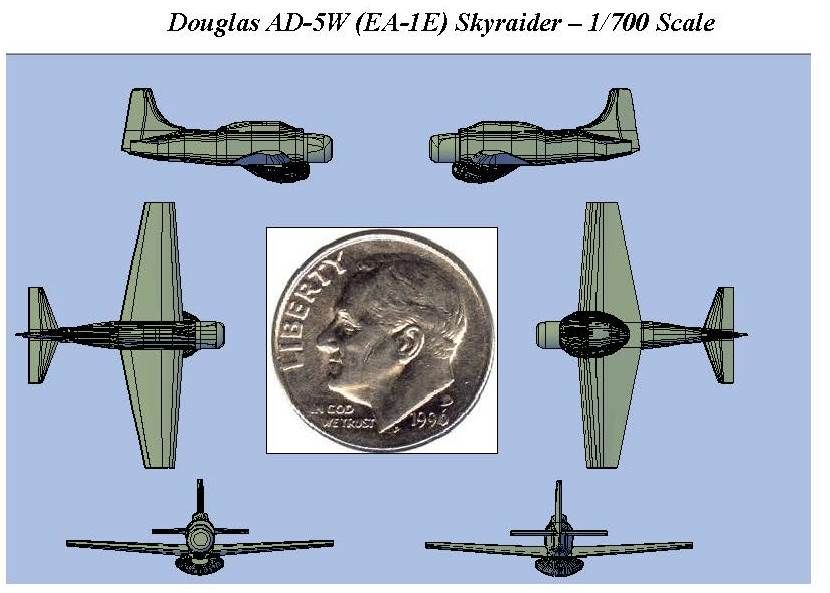

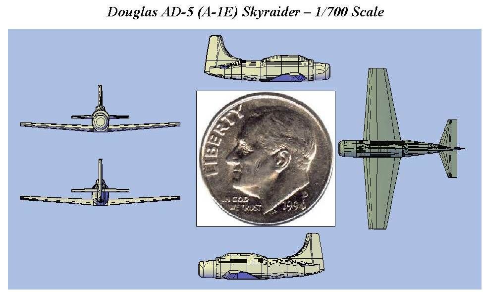

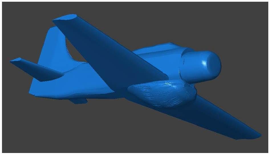

        There’s still hope though. I have been contacted by another individual to make some 1/700 scale 1950’s era aircraft for a build he is doing of Midway. He doesn’t have 3D printing capabilities, but I intend to use the money he pays me to print my parts. So far, I have done two first drafts for him, the Douglas AD-5 (A-1E) Skyraider…
        …And a slight variation on that, the AD-5W (EA-1E) Skyraider.
        The AD-5 took about 8 hours. The AD-5W, which was basically just the dome on the underside, took 6 hours. That dome is such an odd shape it took me several tries to figure out how to do it. I have no idea how they will come out when printed, but I am happy with the way they came out. The guy who is paying me to make these says that he wants 4 or 5, but I don’t know what the other planes are and so far he has only sent me the plans for the Skyraiders.

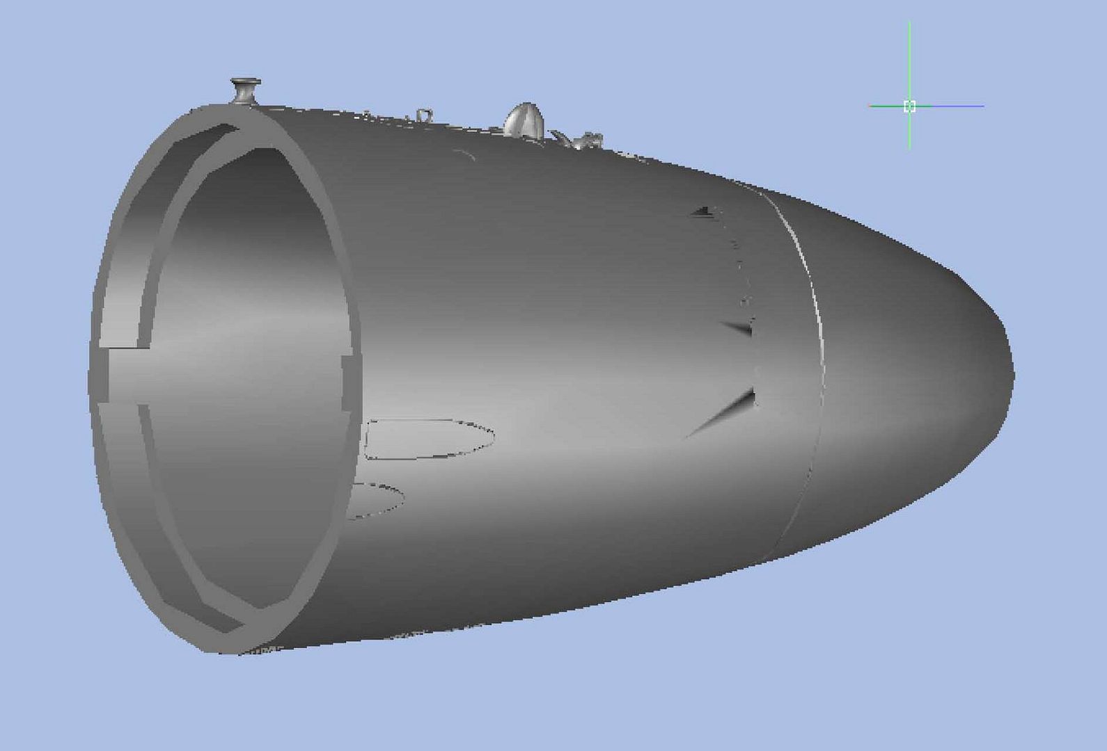

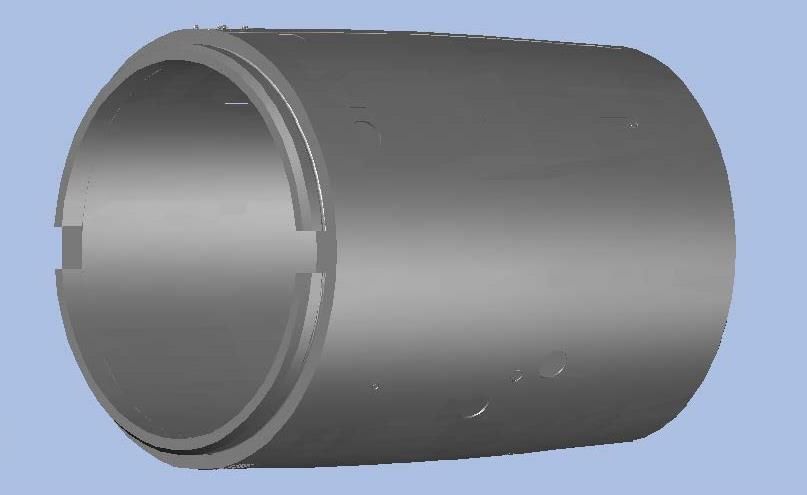

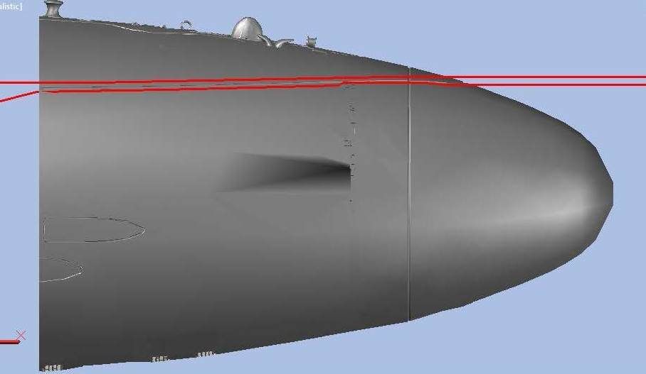

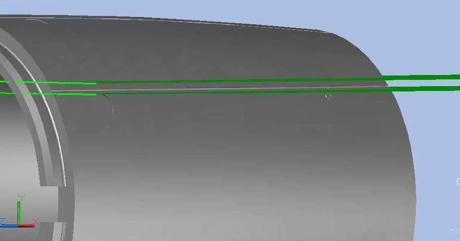

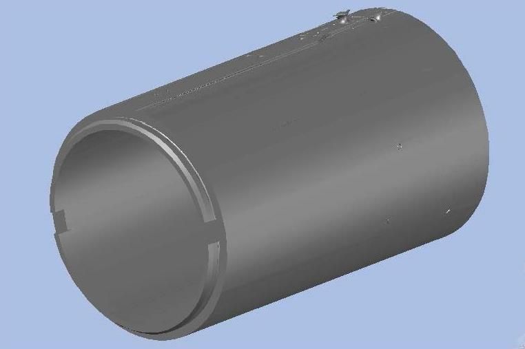

        There has been a benefit to the parts not being printed. You may recall that the hull design I did included an etched line for the waterline that I would need to fill and sand. Well, I decided to see if I can remove them, and was successful. The details are provided in the next 2 posts. I started with Part02-Hull Section 2, because Part 01-Hull Section1 has already been printed, putting whiskers on it for my cutting planes.

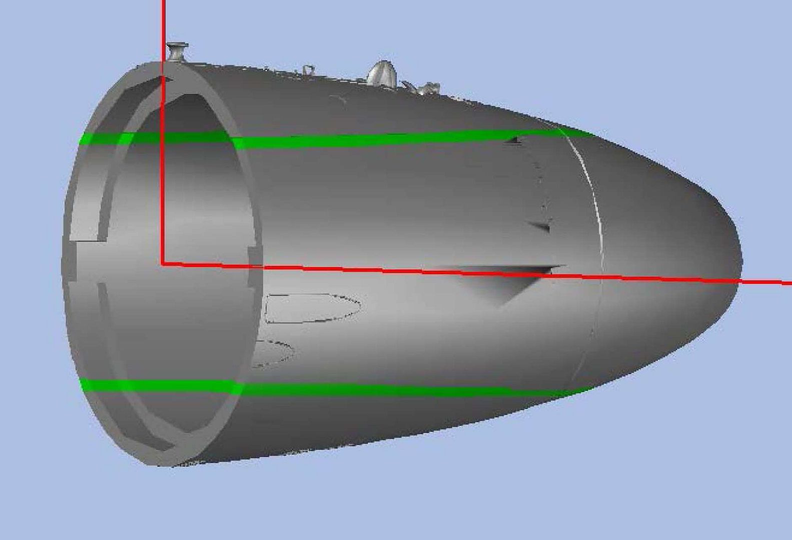

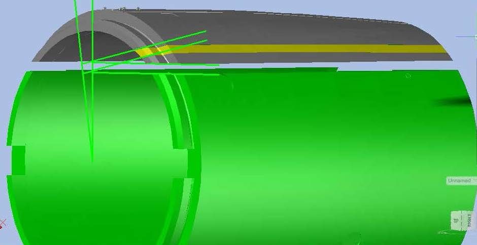

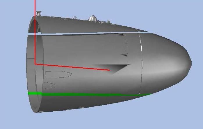

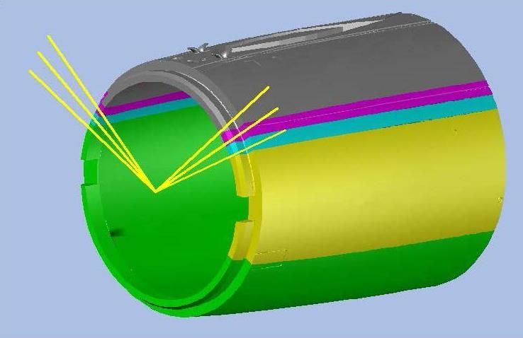

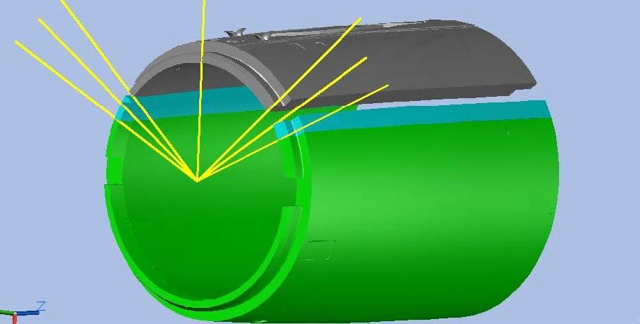

        The image below shows the results of using the whiskers to slice the part. The key is that the angle between the whiskers is the same and the pairs of whiskers are mirror images of each other.
        The yellow segment was joined back to the green bottom and the magenta sections, containing the groove I am removing, were deleted.
        The cyan segment was then rotate/copied to fill the gap.
        The replacement was then mirrored to the other side and everything was joined back together.

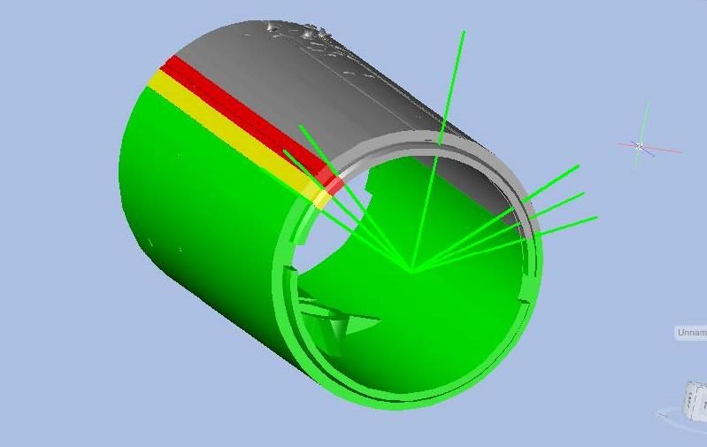

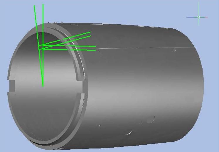

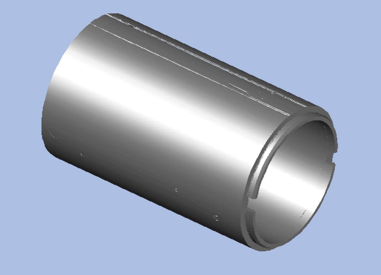

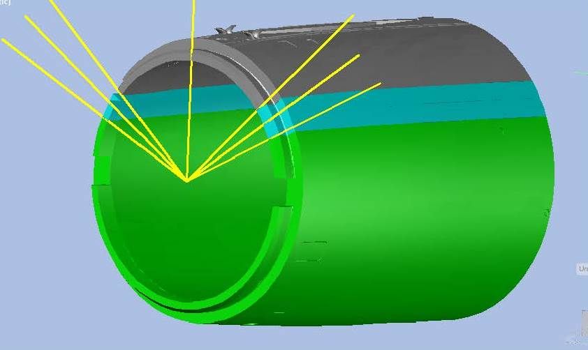

        It worked so I moved to Part06-Hull Section 3 again using mouse whiskers to slice it and remove the effected part.
        Then rotate/copying a clean part to fill the gap and mirroring it to the other side.
        Once again, it was successful, so I moved to Part07-Hull Section 4, again drawing mouse whiskers...
        …Slicing along the whiskers…
        …Joining the unaffected section to the bottom...
        …Deleting the section with the groove…
        …Rotate/copying the clean section to fill the gap…
        …Mirror imaging the clean section to the other side…
        …And joining it all together.

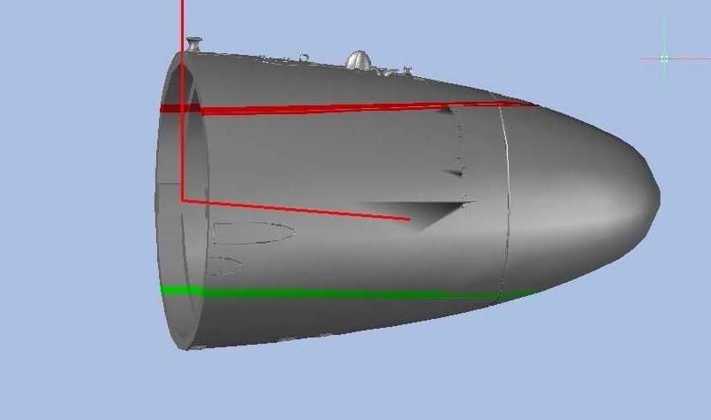

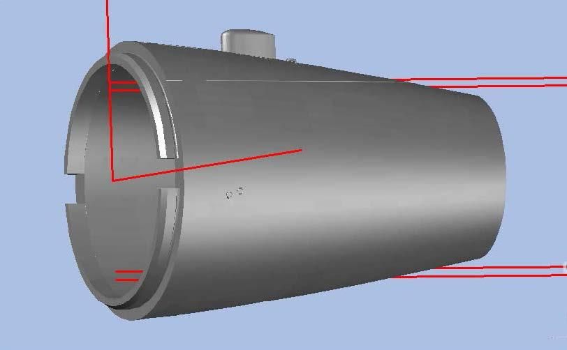

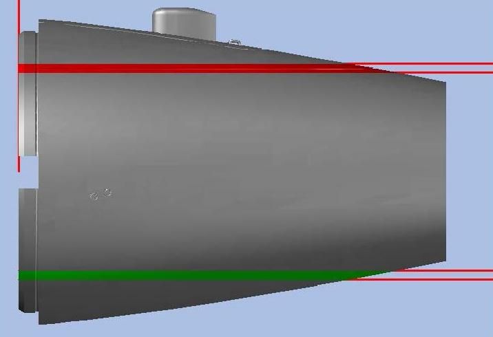

          Just as things were getting kind of redundant and I realized that I only needed half the whiskers, things changed on Part08-Hull Section 5. Whiskers wouldn’t work. In the images below, you can see why. There is an access plate near the waterline groove near the forward edge. So I made a real thin pie slice.
          …When I extruded it, to see how it would look, it didn’t look good. It sliced across the groove I am trying to remove.

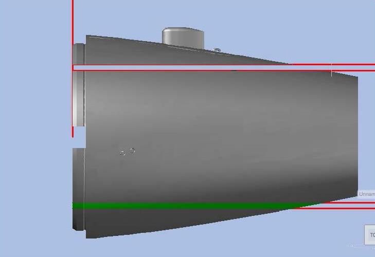

          So, it was time for Plan B, which consisted of using parallel lines instead of pie slices.
          These parallel lines were then rotate/copied to a blank place on the hull…
          …And sliced away.
          I then subtracted the section with the groove on it…
          …Rotate/copied the clean section to fill the gap.
          …Mirrored it to the other side…
          …And joined everything together.

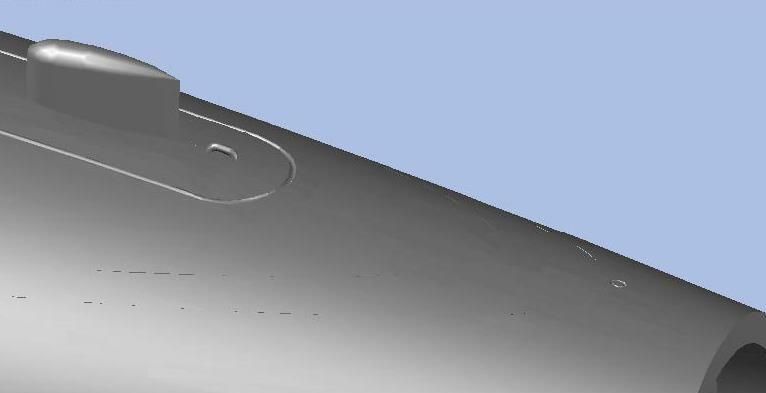

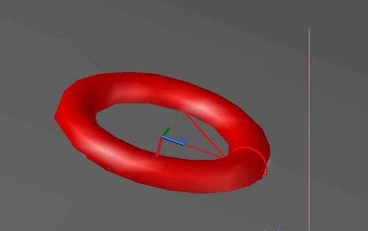

          Unfortunately, I had inadvertently filled a vent hole which required filling. So I moved and rotated my coordinate system, drew the circles needed to clean it out…
          …Extruded the smaller circle along the larger circle…
          …And subtracted it.

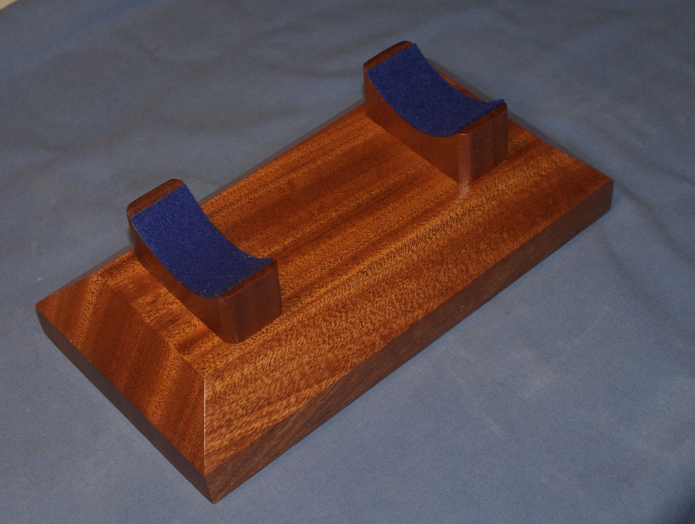

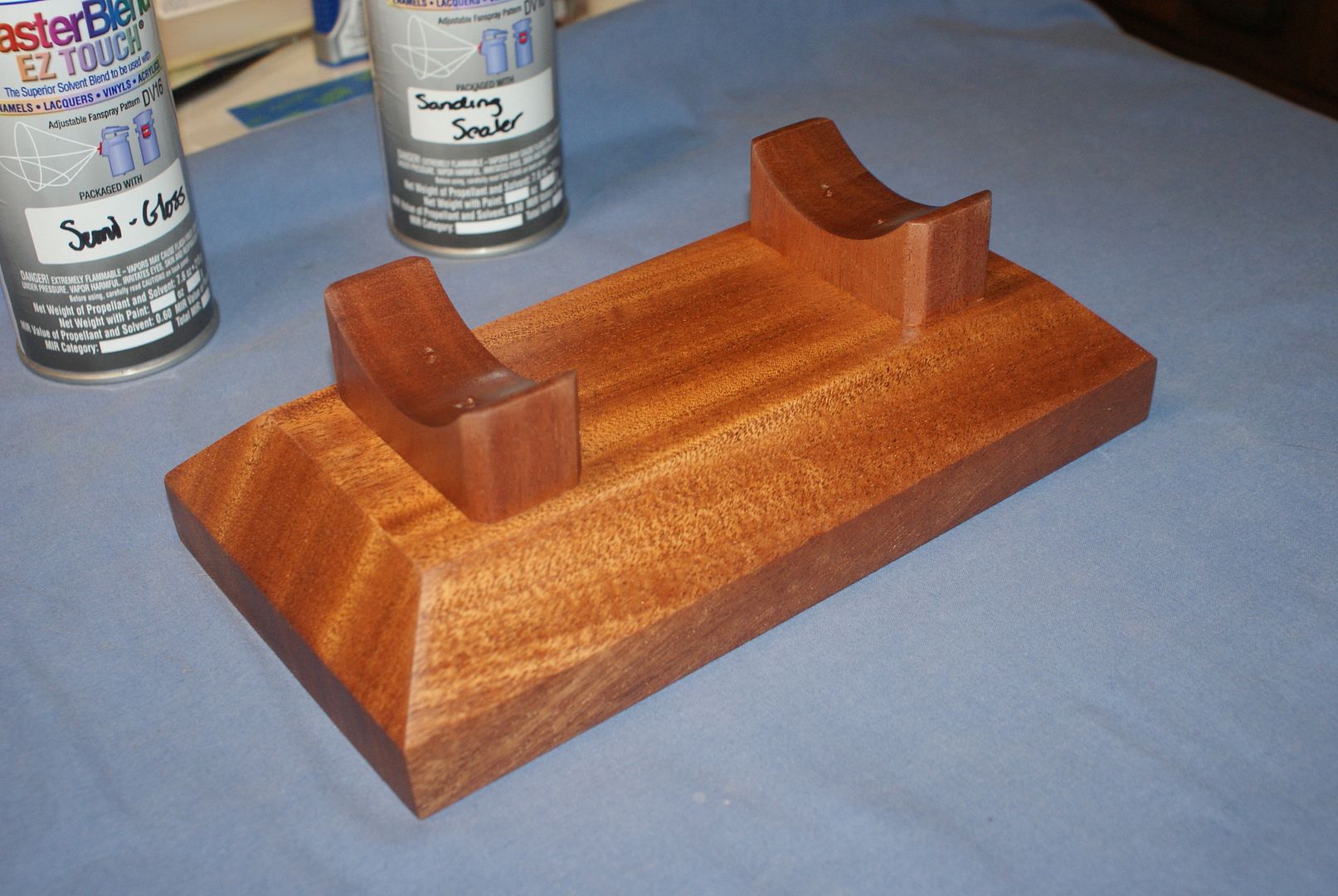

            My buddy finally had some spare time to help me redo the base yesterday evening. Wroyce is a nice guy and a Wizard when it comes to woodworking.
            Several years ago he made a free standing spiral staircase for a rather large house/small mansion that truly is a work of art.
            His shop is nice and it has one especially nice fixture in it, in case you forget where you are.
            We talked about what I wanted and he went to work. An hour and a couple of beers later I had a base that was much improved over my initial design.
            Now it is time for sanding, followed by sanding sealer then more sanding and another shot of sealer, followed by more sanding and several coats of lacquer, sanding between coats. Hopefully the plaques will be finished this week too, so I might actually finish it.

              Here are a few pictures of the base after two coats of sanding sealer and two coats of lacquer (with sanding between coats). I have several coats to go, but I think it is starting to look pretty good.
              CHEERS!!!
